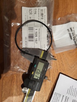

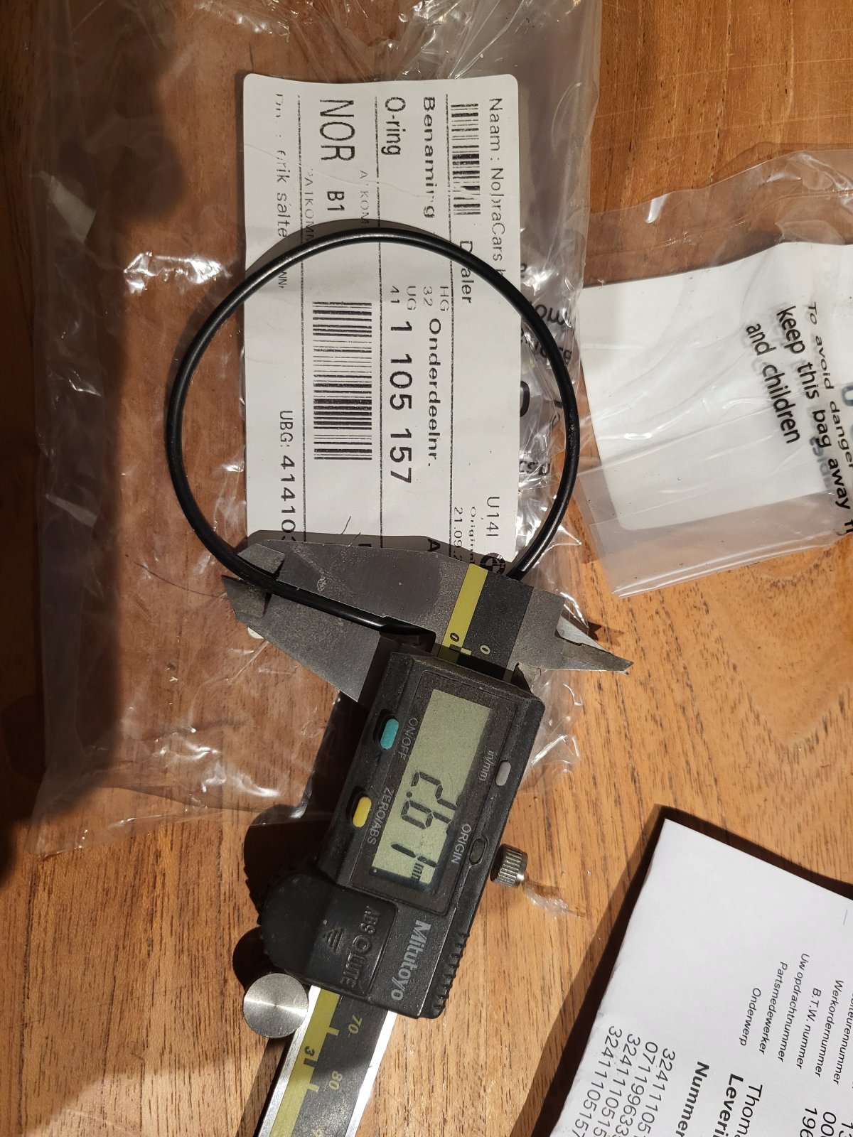

I ordered most/all of the replacement parts one or two years ago when this wonderfull thread was started. I still have them in a bag - I'll measure that one (32411105157) up for you this evening.
Here is the measurement; it looks to be 2.6 mm thick.
The ID/OD can't be measured, as it is sooo floppy.
Perhaps it works as follows: if the O-ring is half burried in the housing (an assumption; needs a check), one could measure the ID of the hole, and add 2.6mm to get the OD of the ring.
Thanks! I'll give it a go and post results with part number when done for the next fella.
Update:
I bought 2.5mm orings from orings.com, they did not have 2.6 or 2.7 in the correct od.
The new oring does not seal the cap. :(
2.5mm is noticably smaller than 2.6 and I believe that could be what went wrong.
The design intent appears to have the cover pushed against the oring, not through it if that makes sense. The snap ring places a squeezing force on the oring that doesn't happen with the smaller diameter.
It is also possible the mating parts are simply old and worn creating slop that a new oring won't fix.
