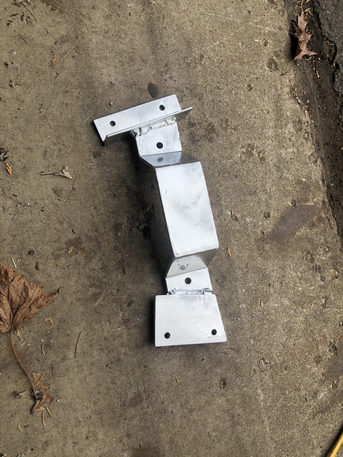

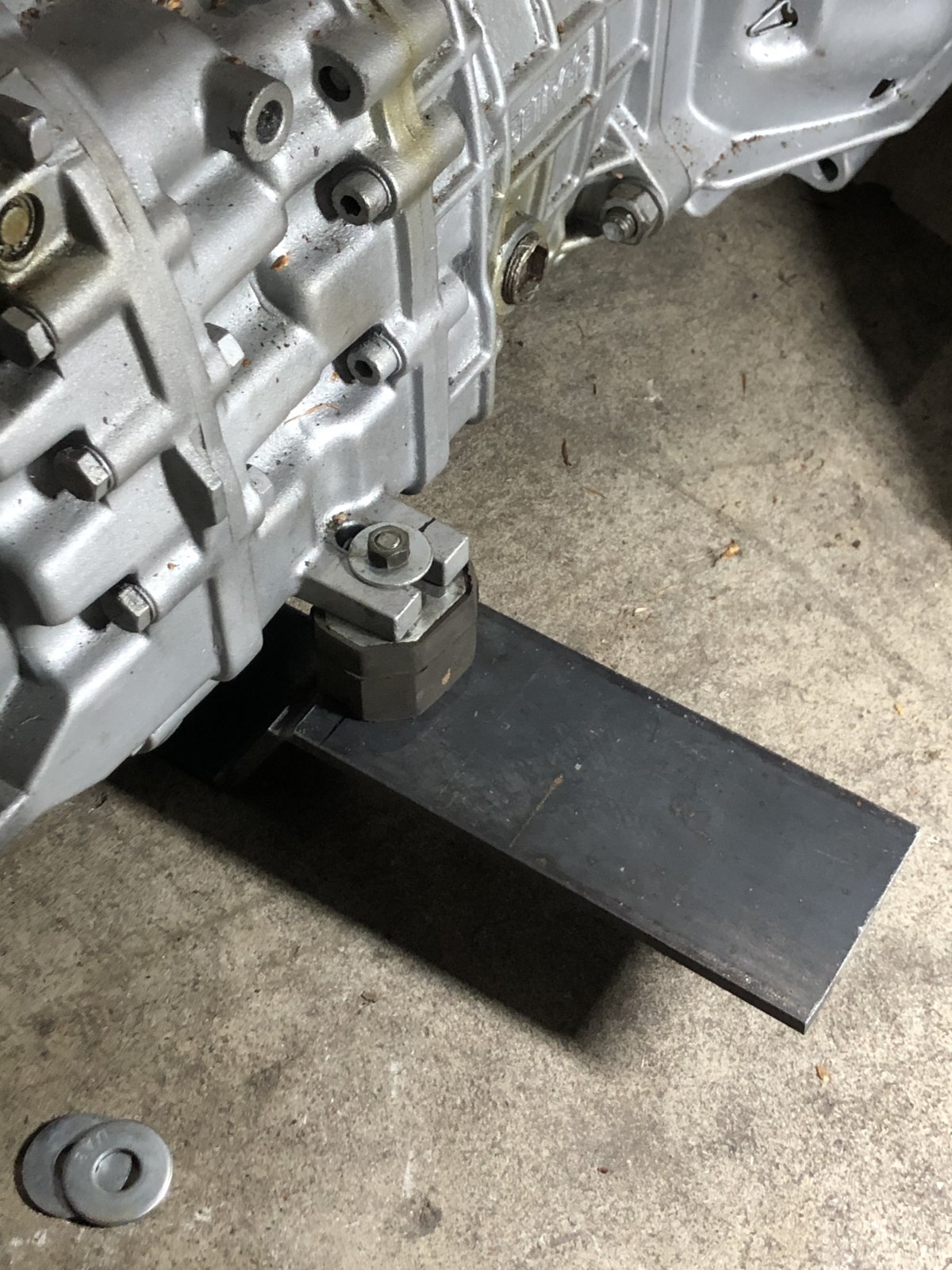

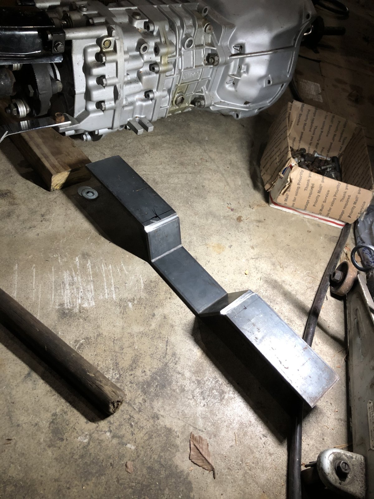

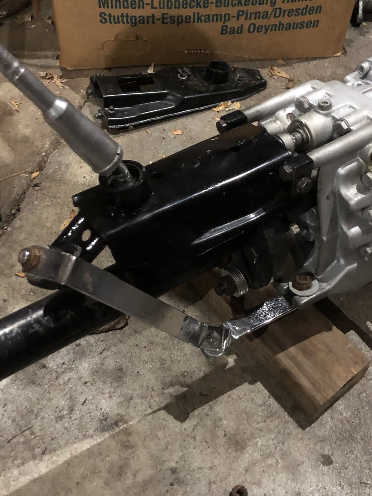

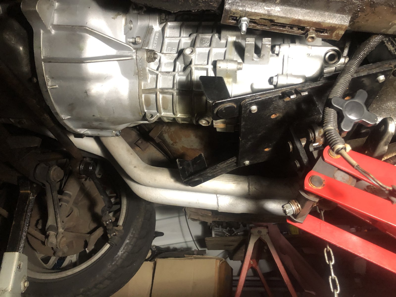

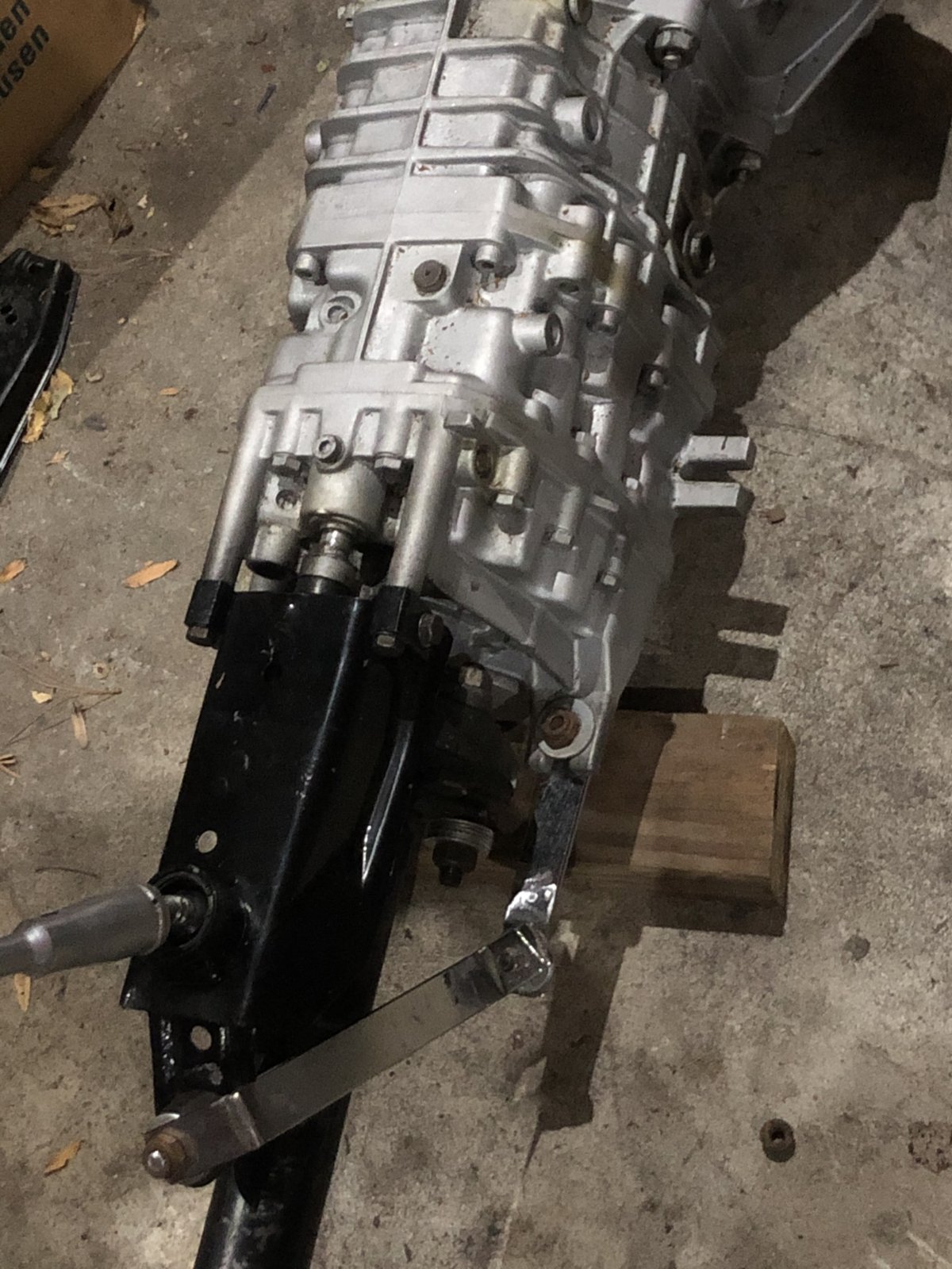

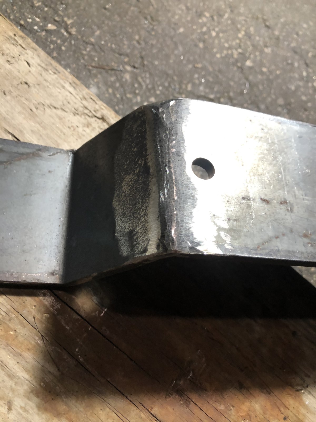

Making mounts for Getrag

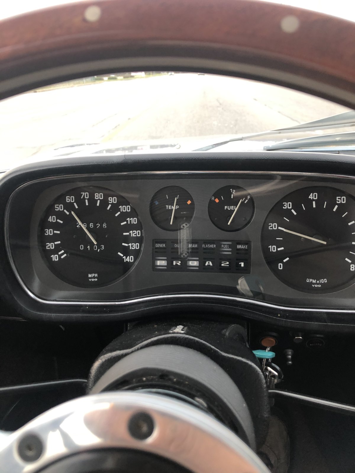

Mounts done... getrag in....all back together...rolling down the road....

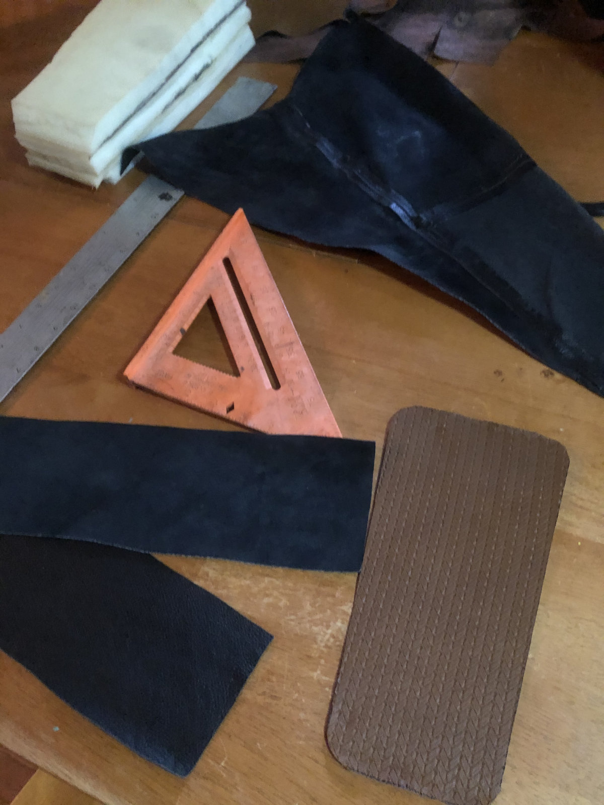

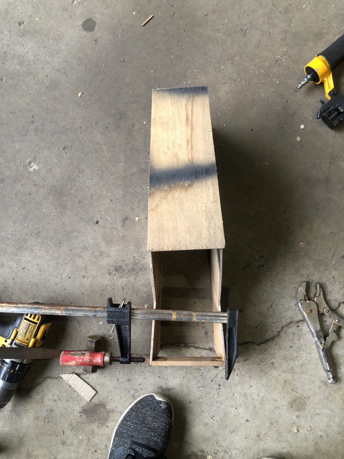

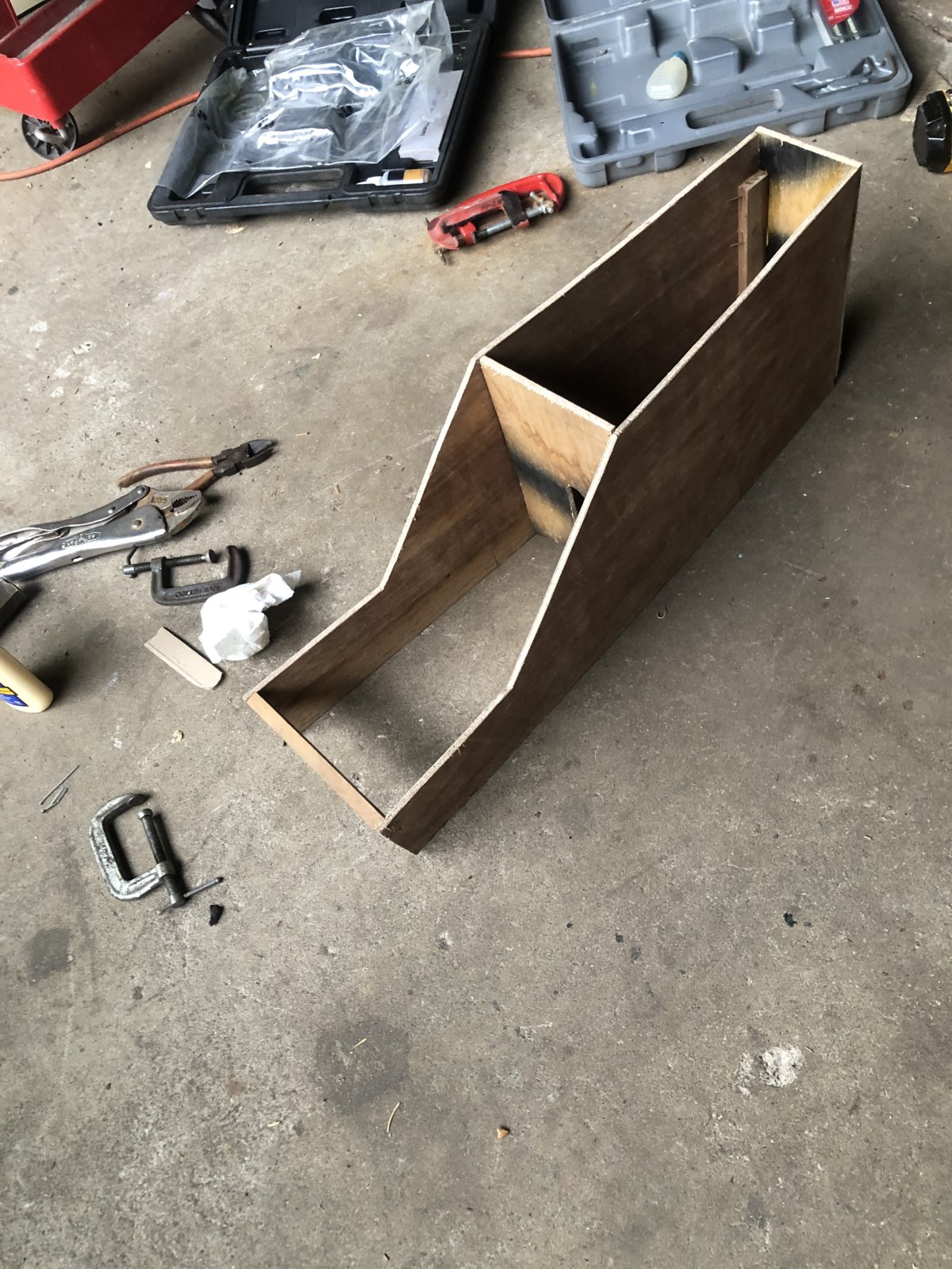

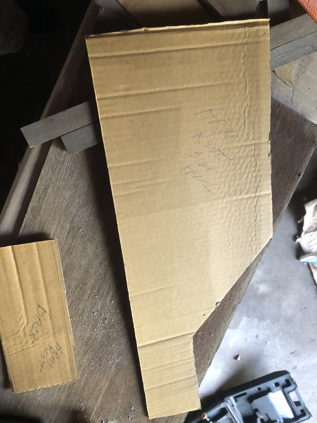

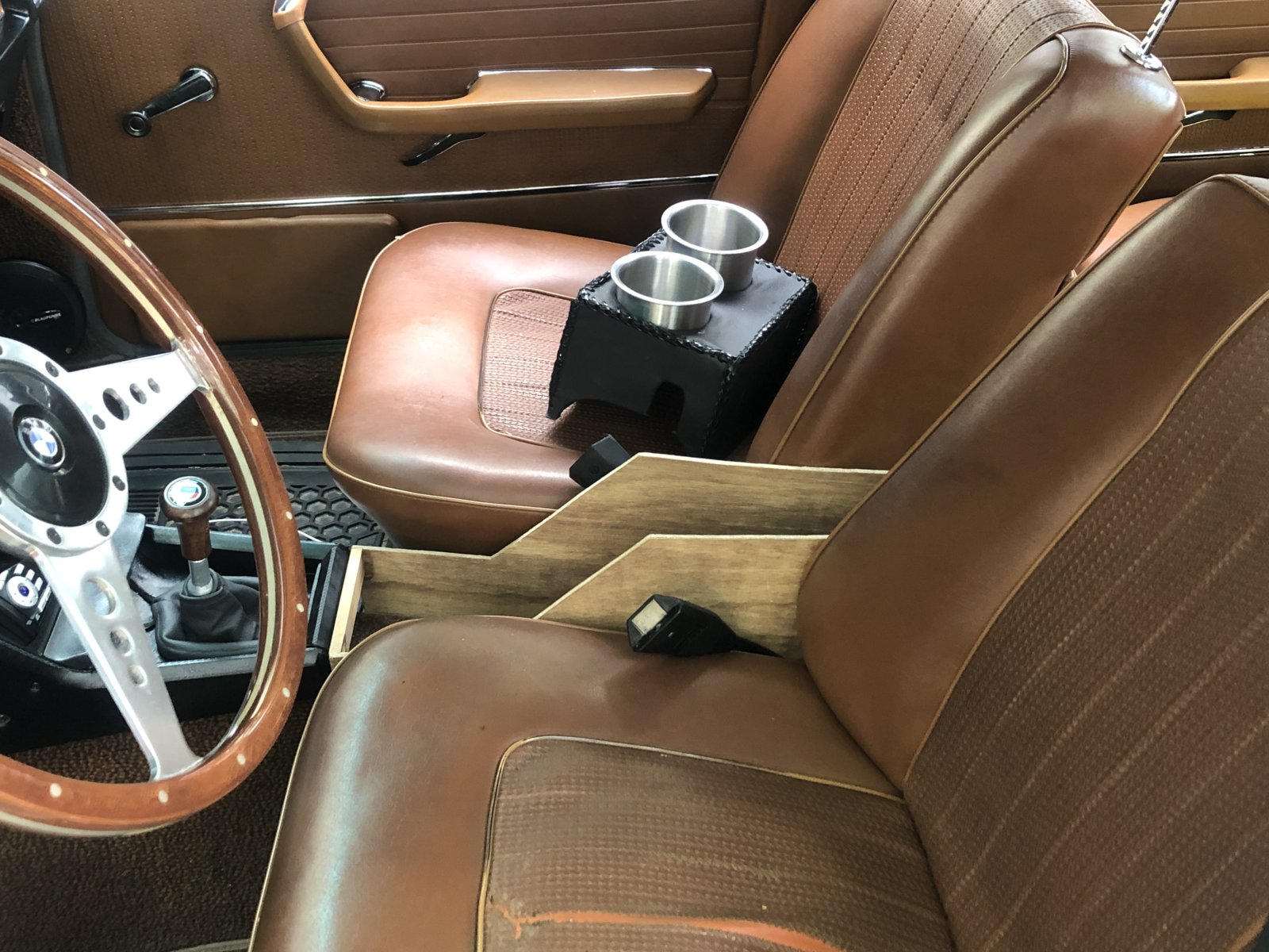

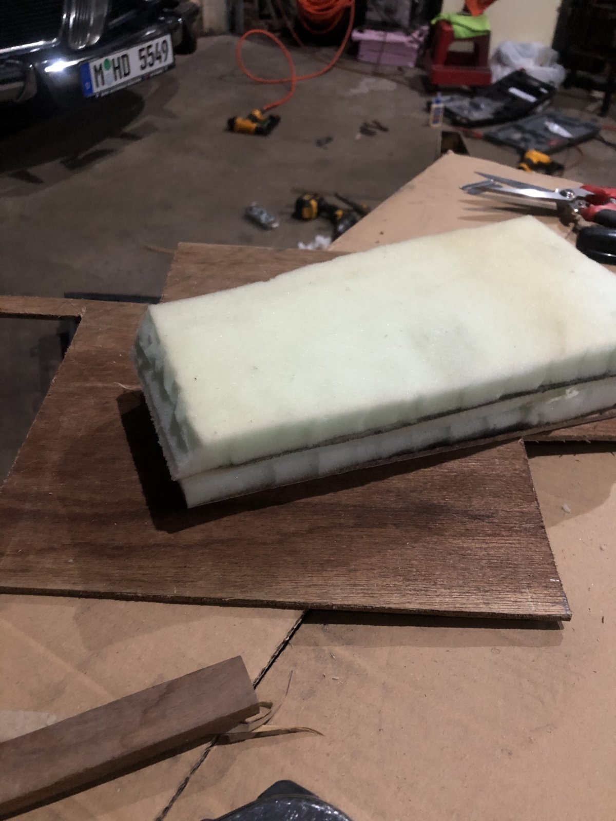

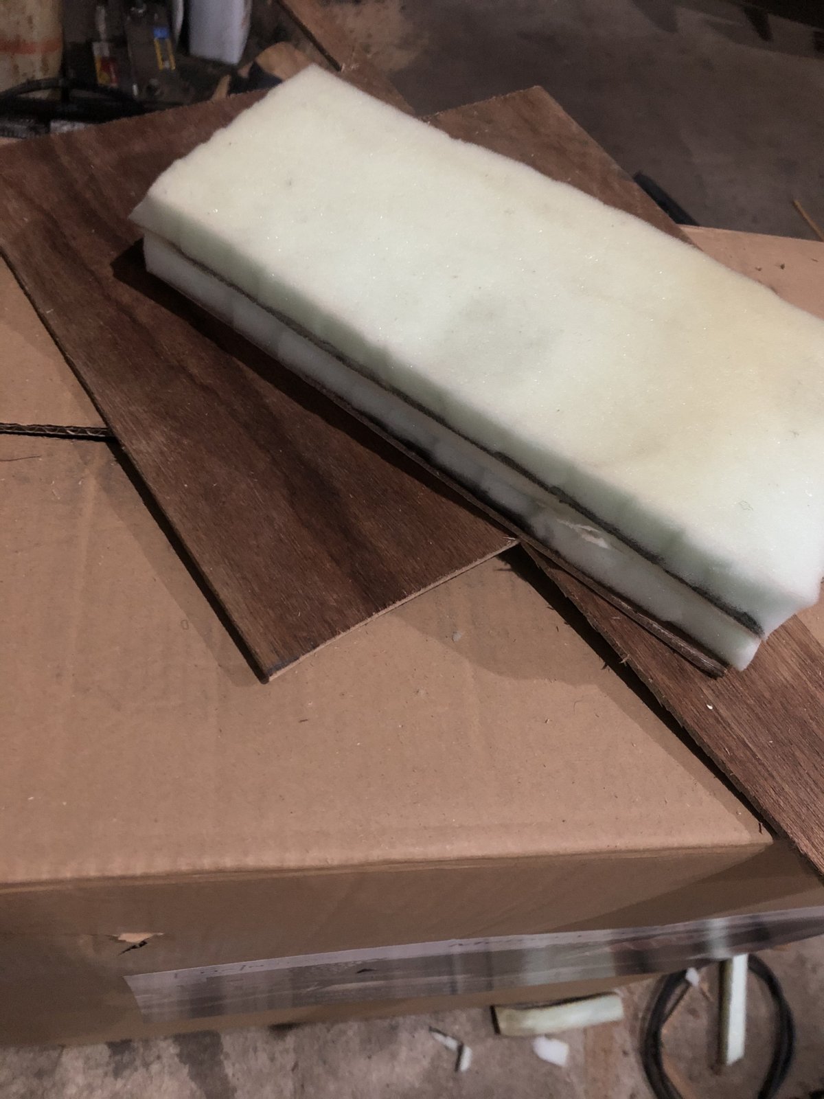

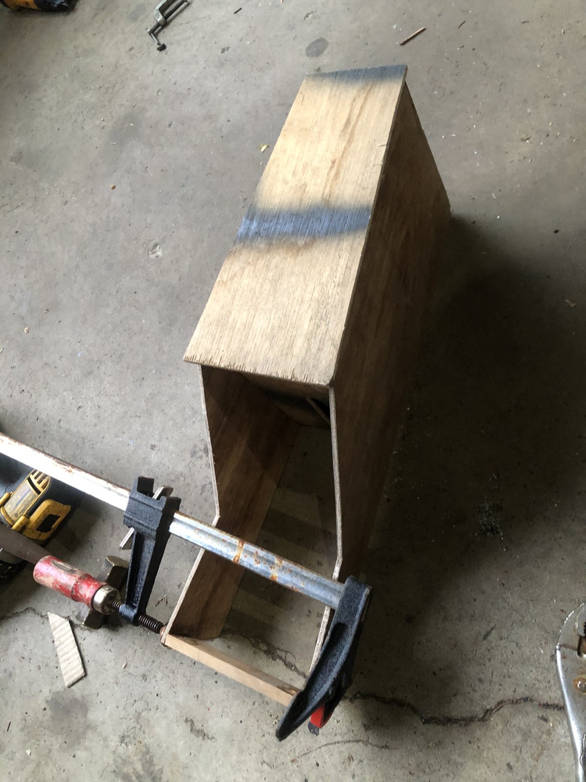

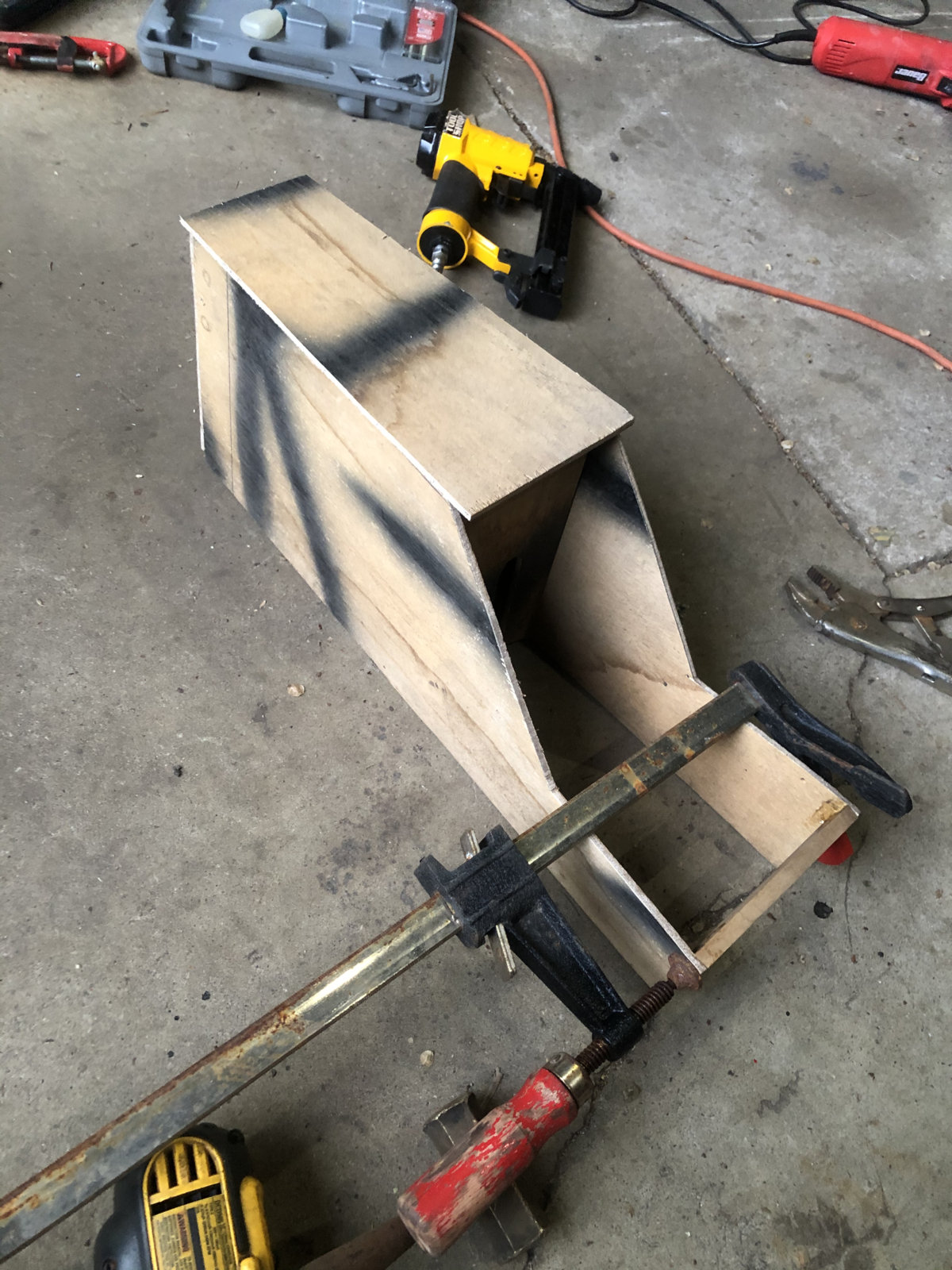

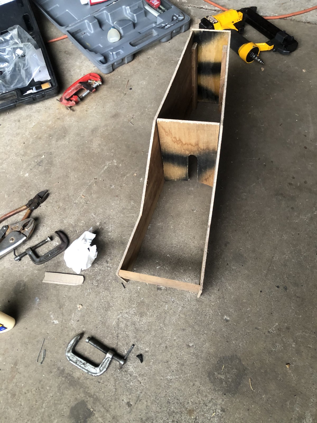

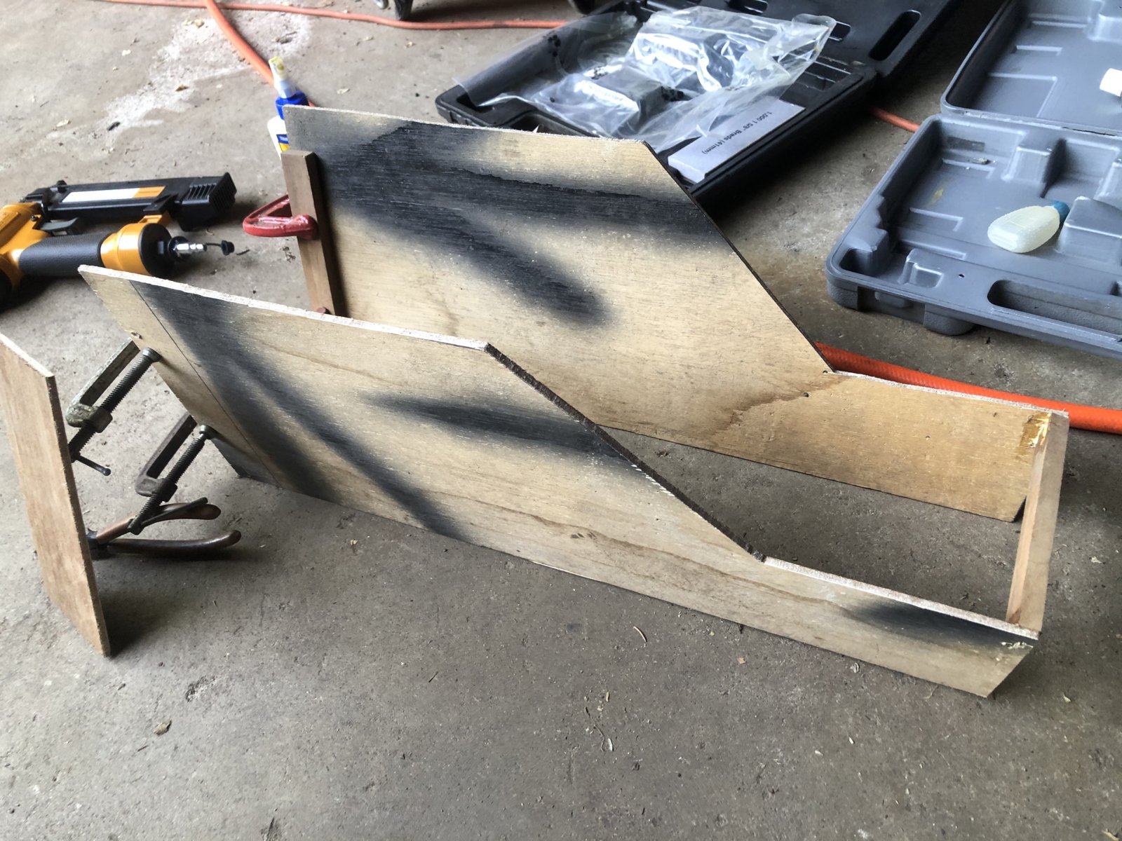

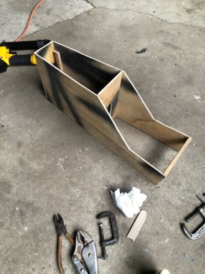

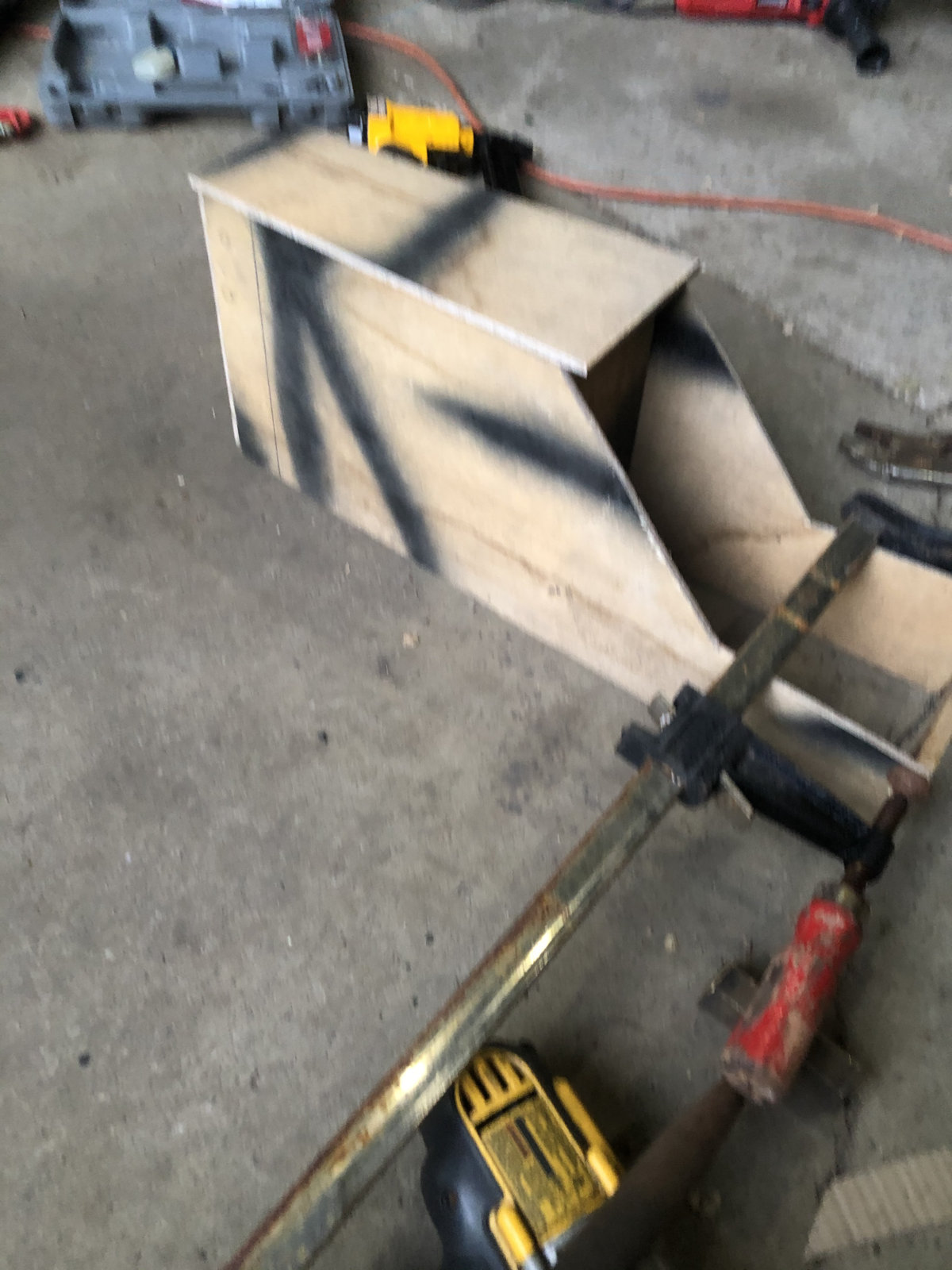

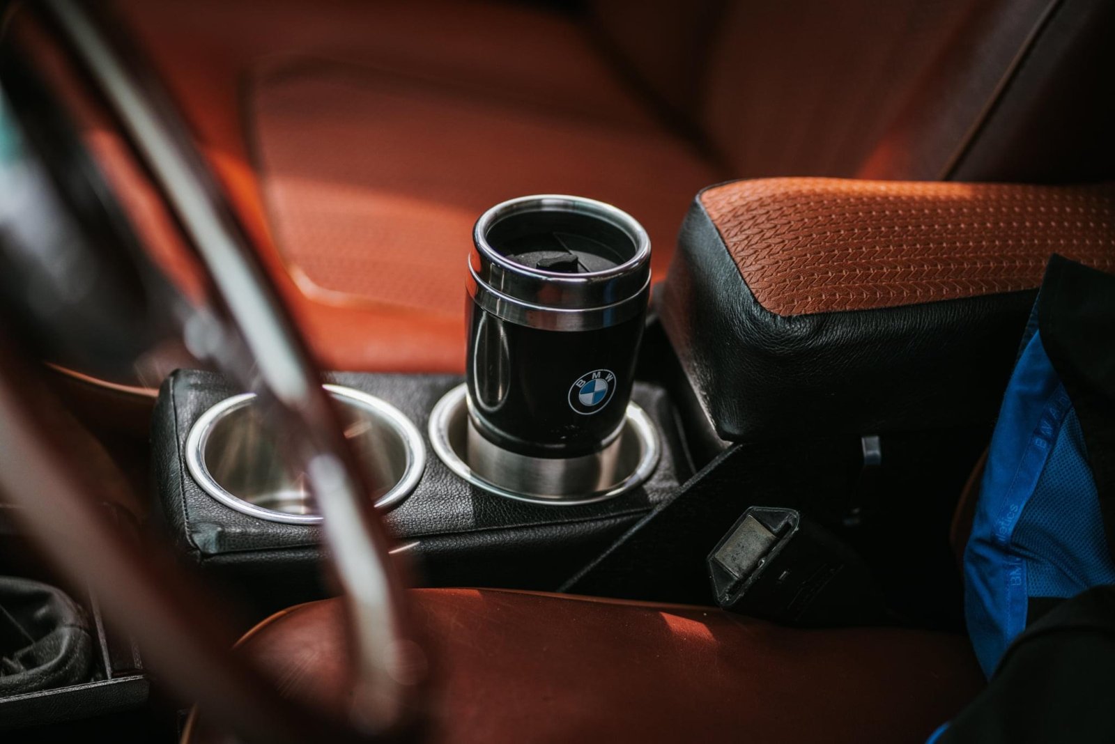

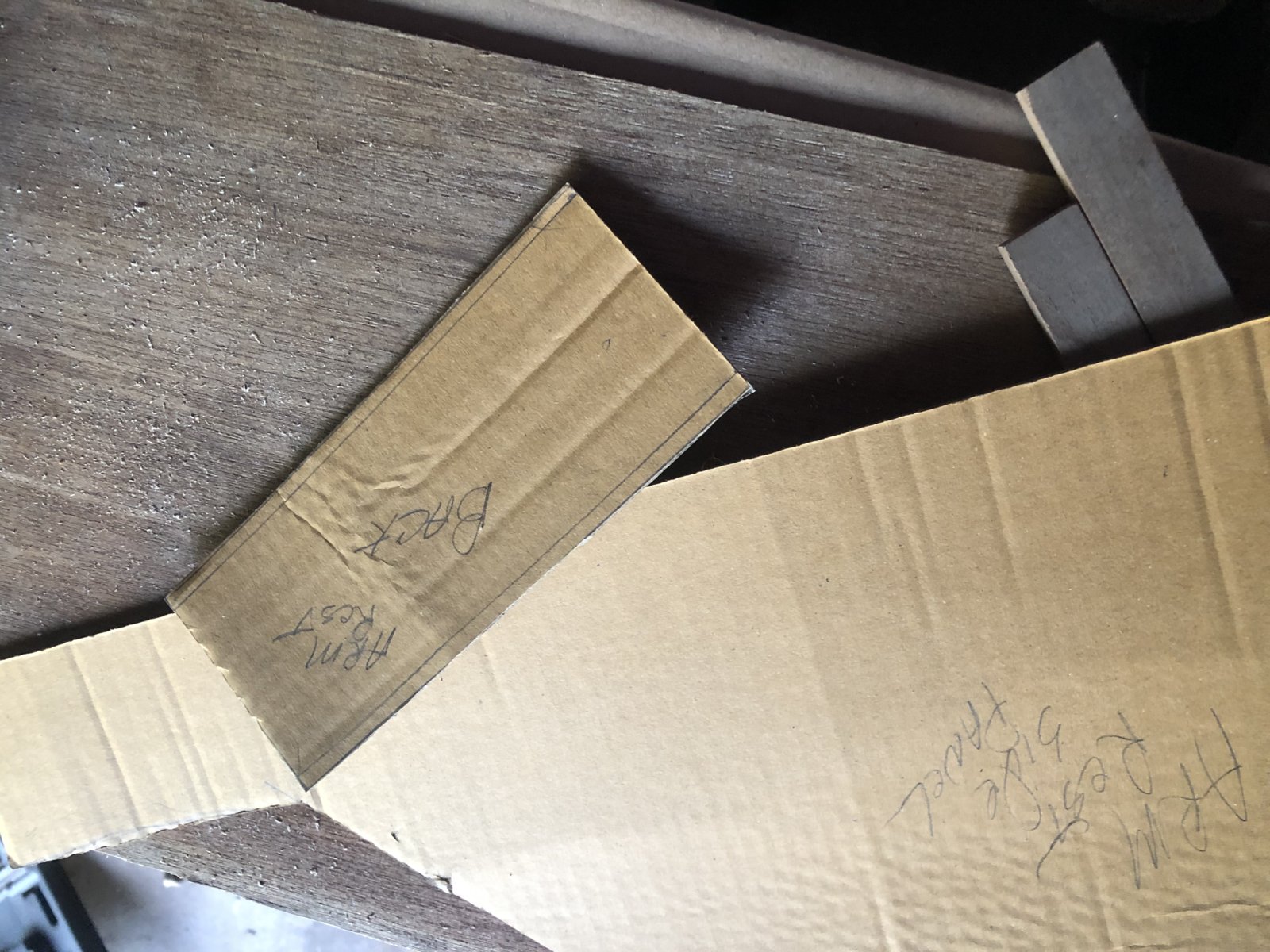

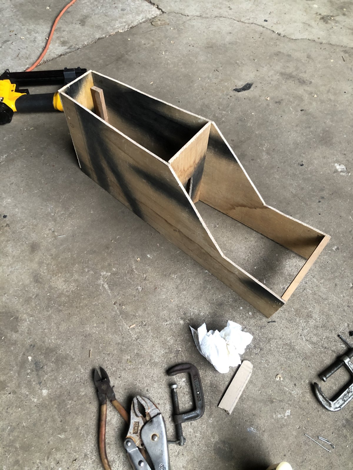

Making a center console/armrest/drink holder.
front section will have a removable drink holder(2), to access the emergency brake handle. Arm rest is hinged to the rear with storage compartment underneath. Armrest has seat center original embossed vinyl with black leather sides. The rest of the console will be sewn black leather covered, including the removable drink holder section.
USB ports will be installed in front angled area of armrest support panel (angle matches a/c control panel angle) and on the rear of console as well.

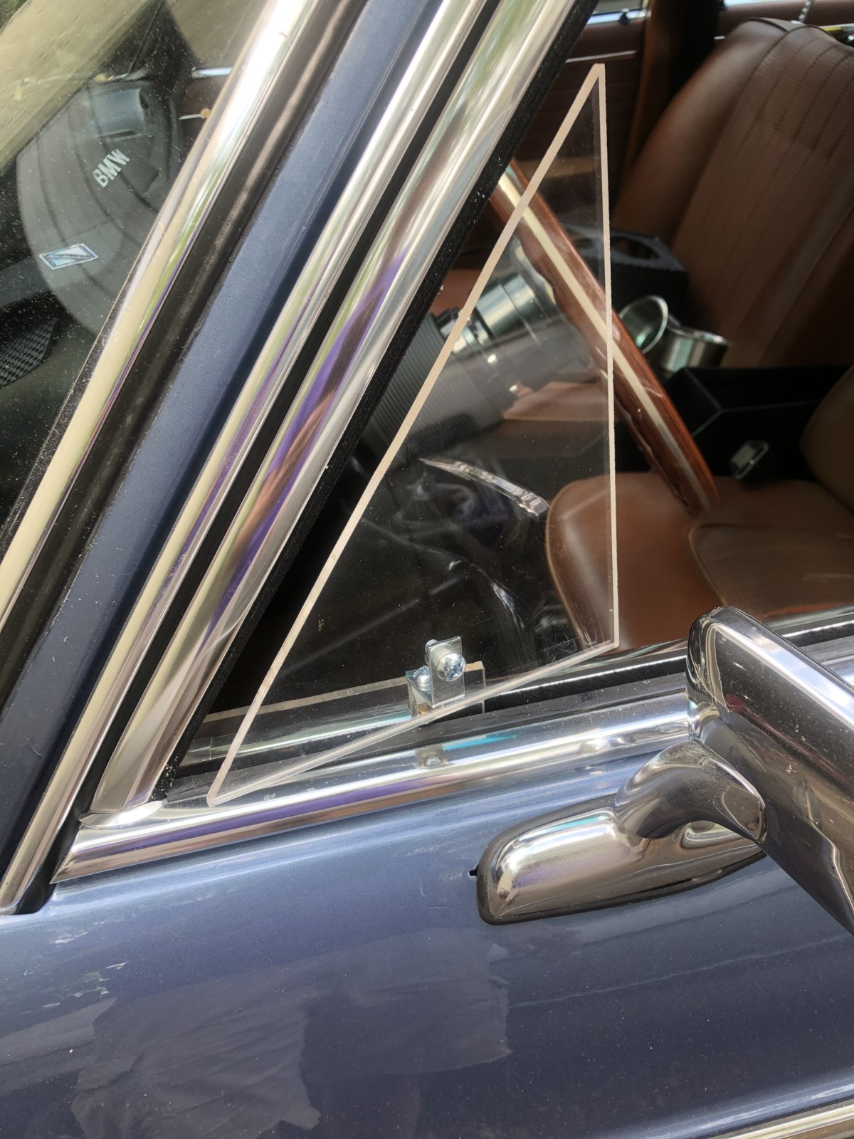

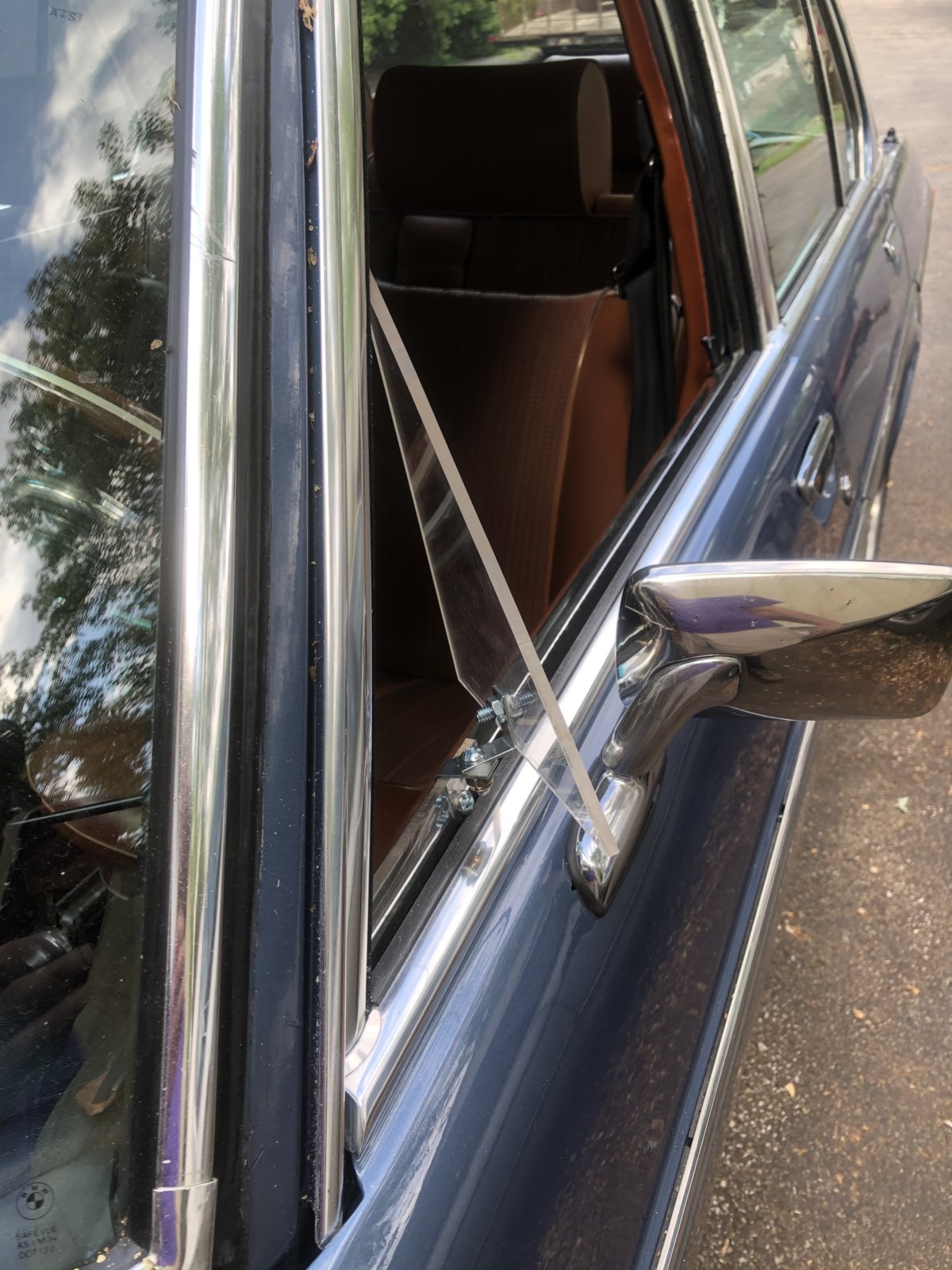

Prototype removable wing windows.
So far stable to 80mph.
Will move ahead on finished design.

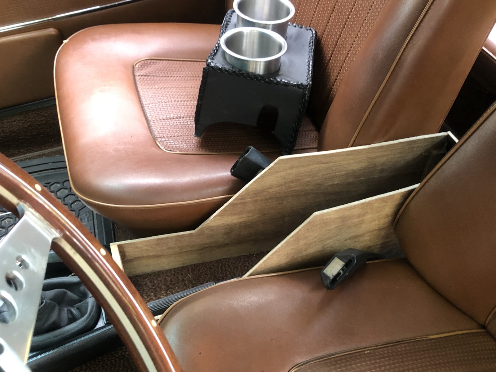

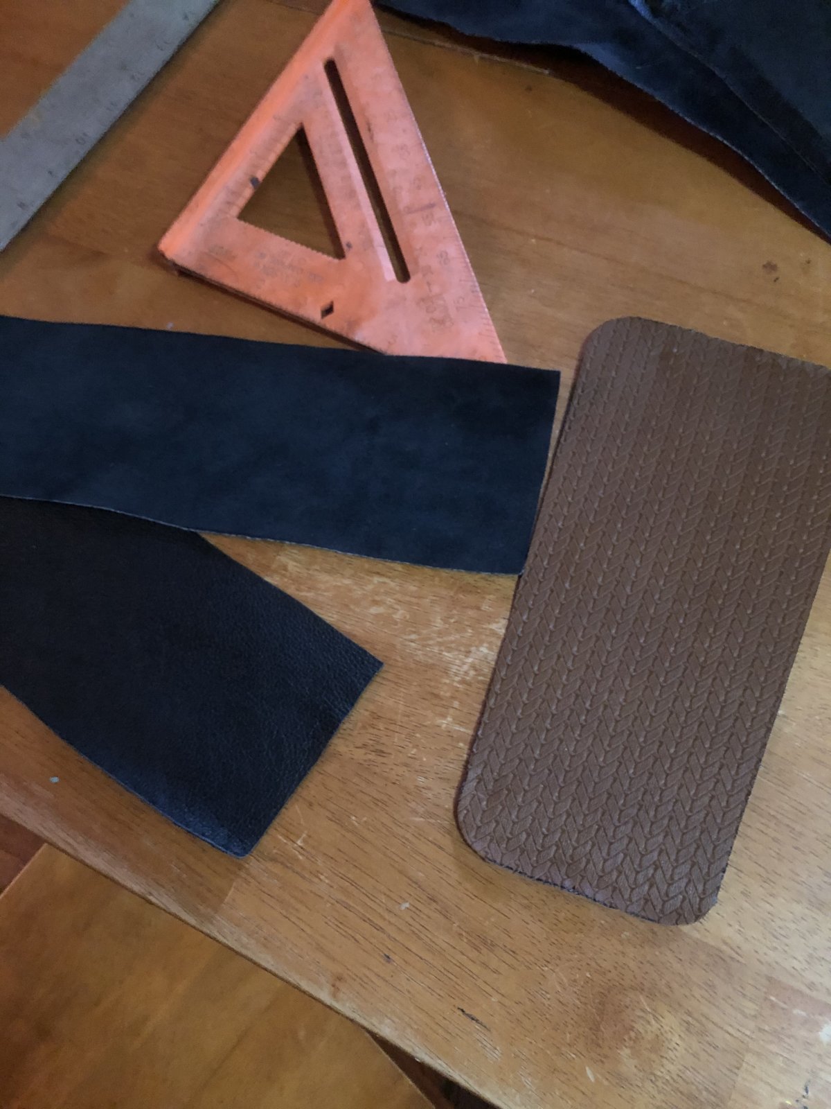

Well removable drink holder section is made. Next will be sewing and wrapping with black leather

Great work. If you get to the point where you are satisfied with your wing windows and care to make more I may be interested in a set.

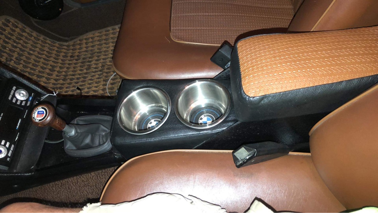

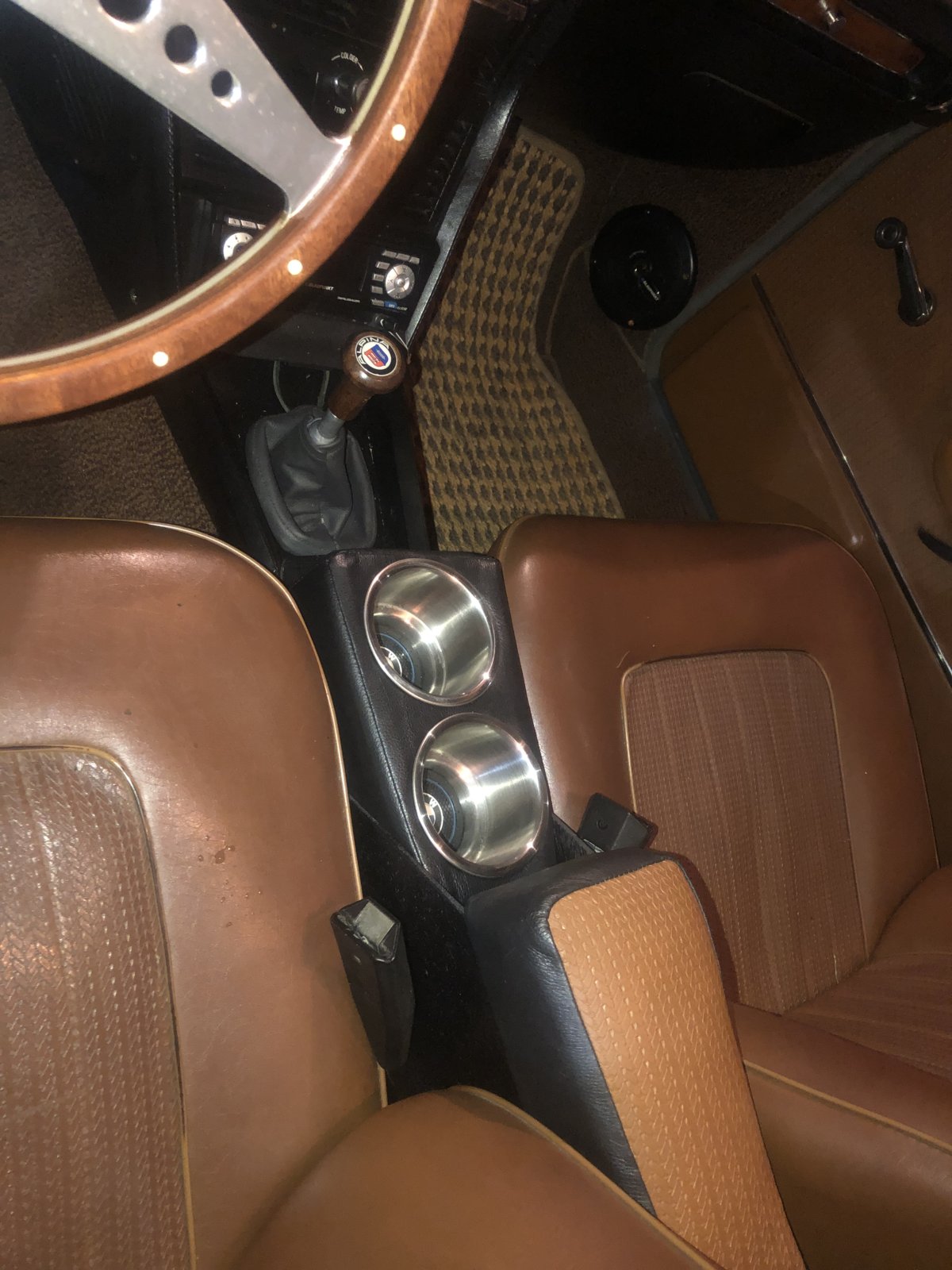

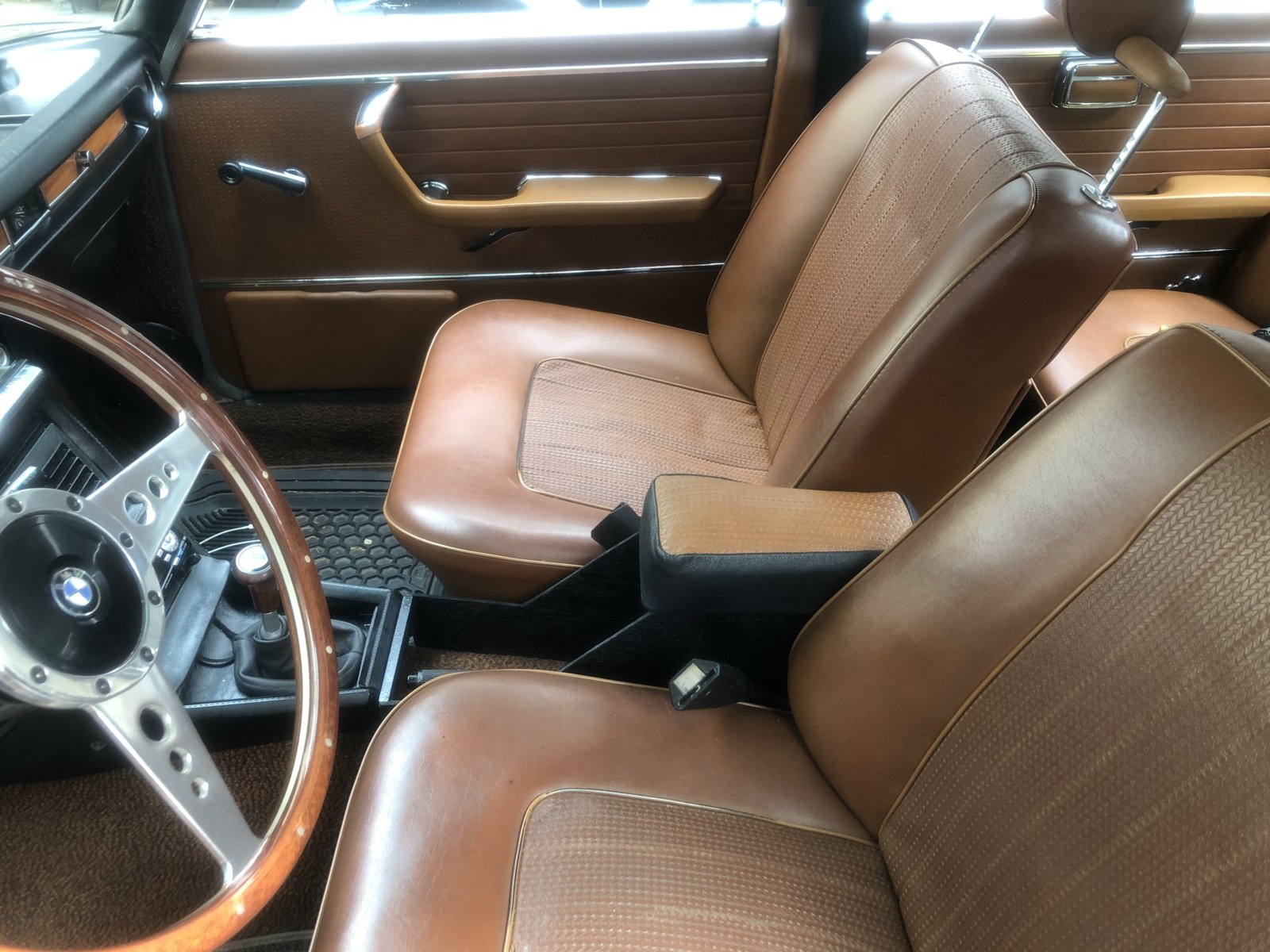

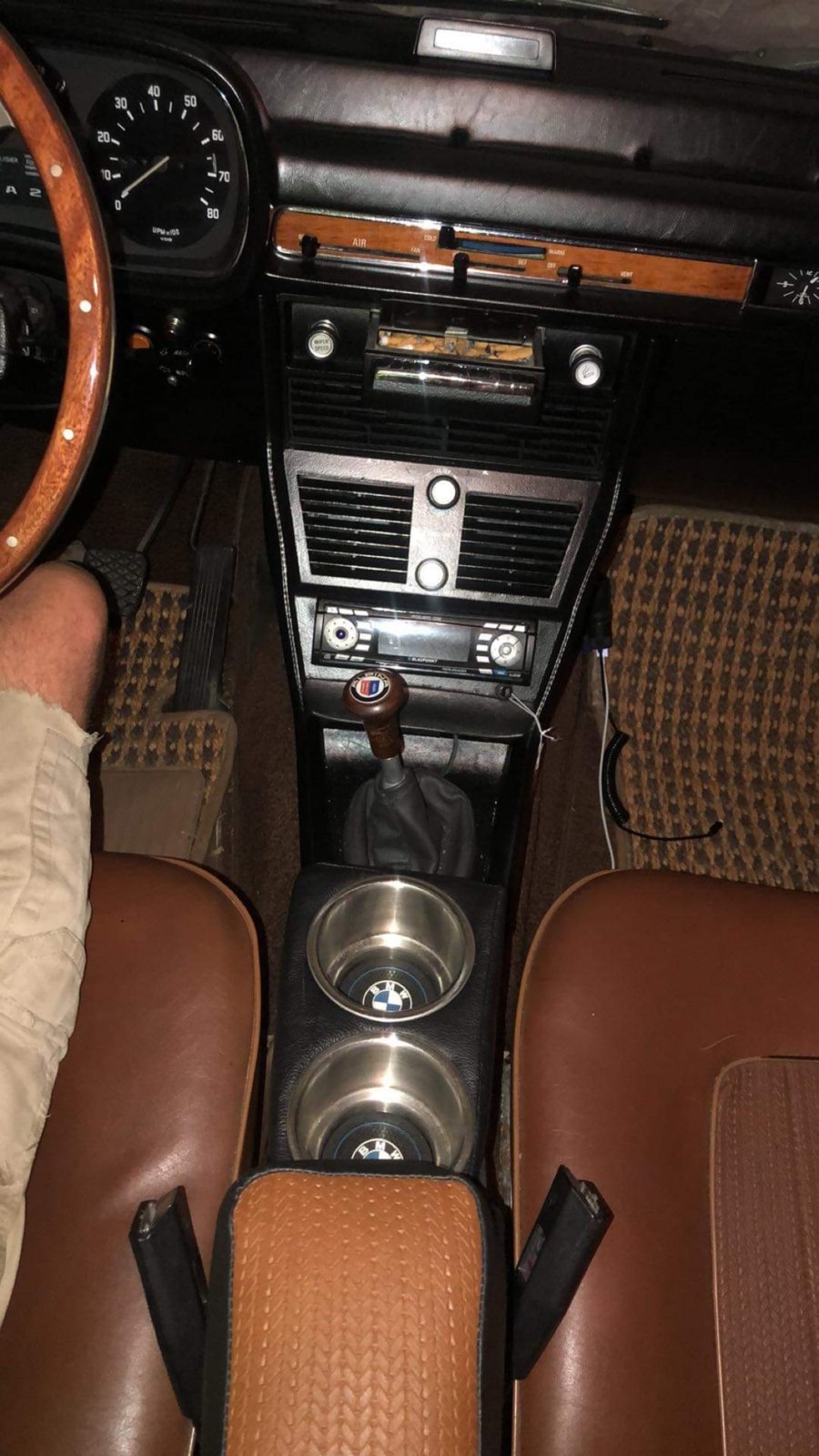

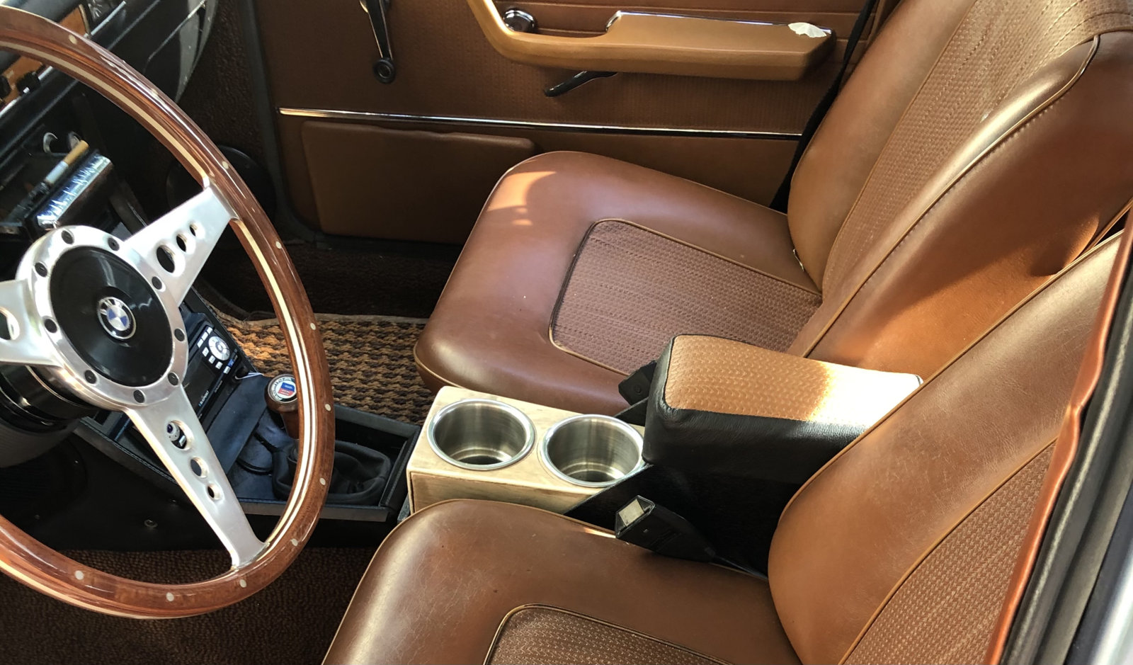

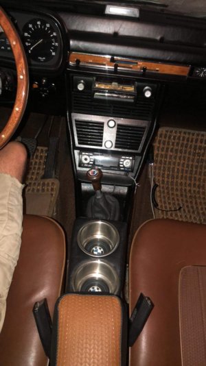

Center console arm rest/removable drink holder.

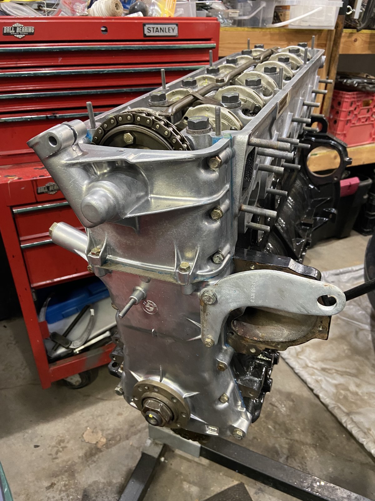

Well with the oil pump and pick up being in.
And the Oil pan being on.
Motor mounts are on.
Accessories bracket is on.
Throttle linkage is on. Next change the flywheel.
Will it at least get in the hole today???

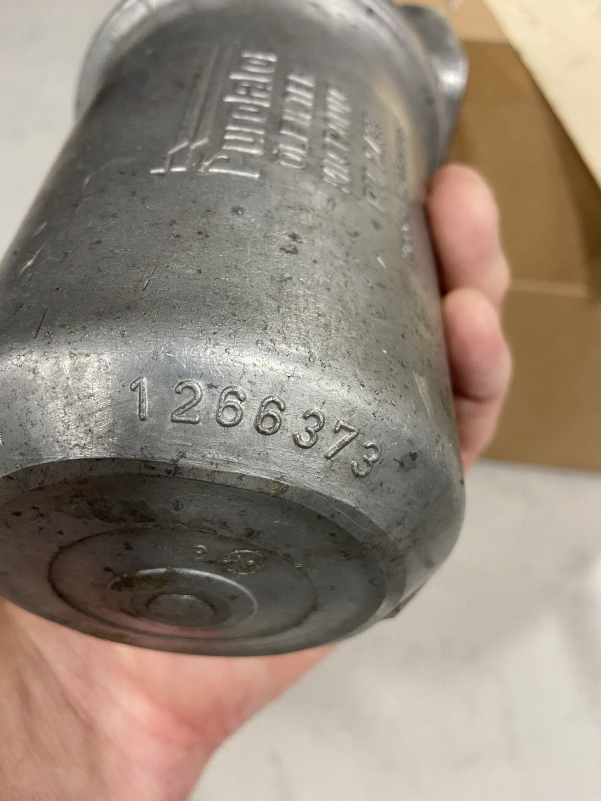

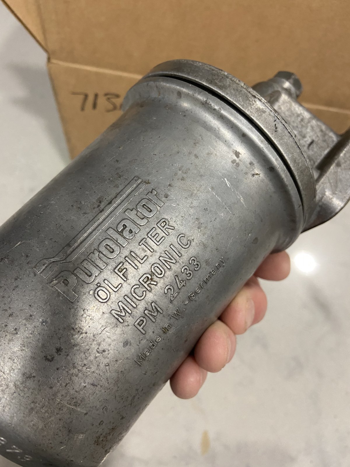

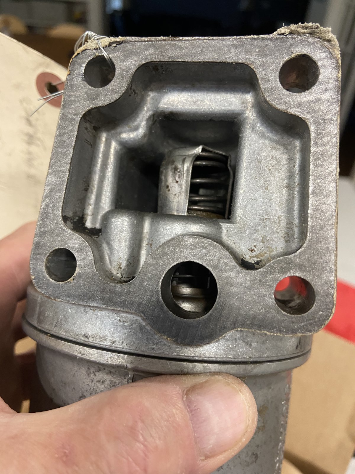

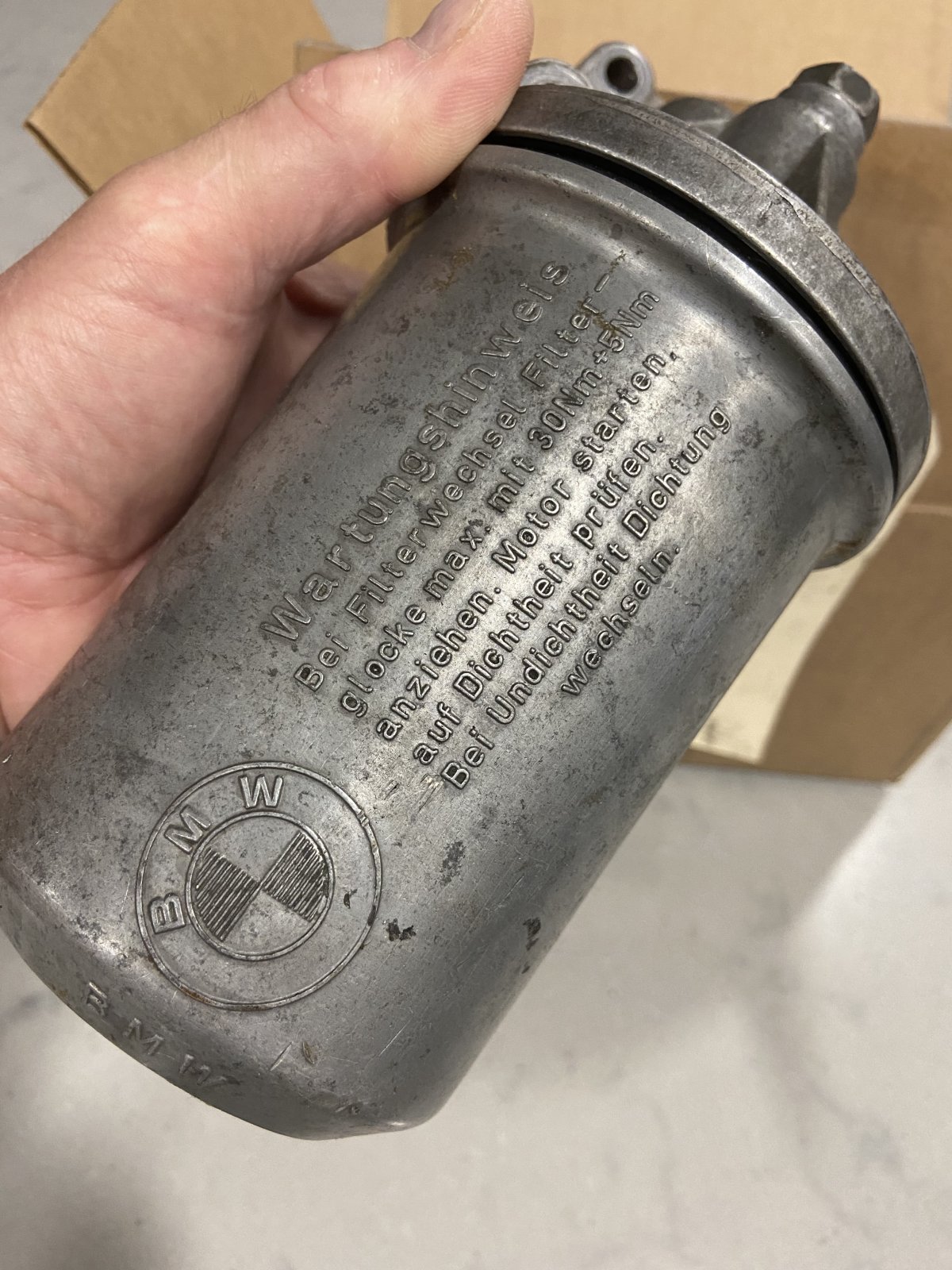

The stock B35 oil filter has a check valve in it. I would make sure there is one in the oil filter you use. I had a top bolt filter with no check valve and it took a while to get oil pressure when I started the motor. I changed to a filter with the internal check valve and the situation improved significantly.
I found and bought a top bolt oil filter housing (‘84 E24). Cuz I’ve forgotten how silly the original E3 bottom bolt oil filter is to change.
How does the check valve work?
I was going to buy one locally for $60 but it did not have check valve. Why do some have the valve and others do not (same part # as far as I can tell)?
