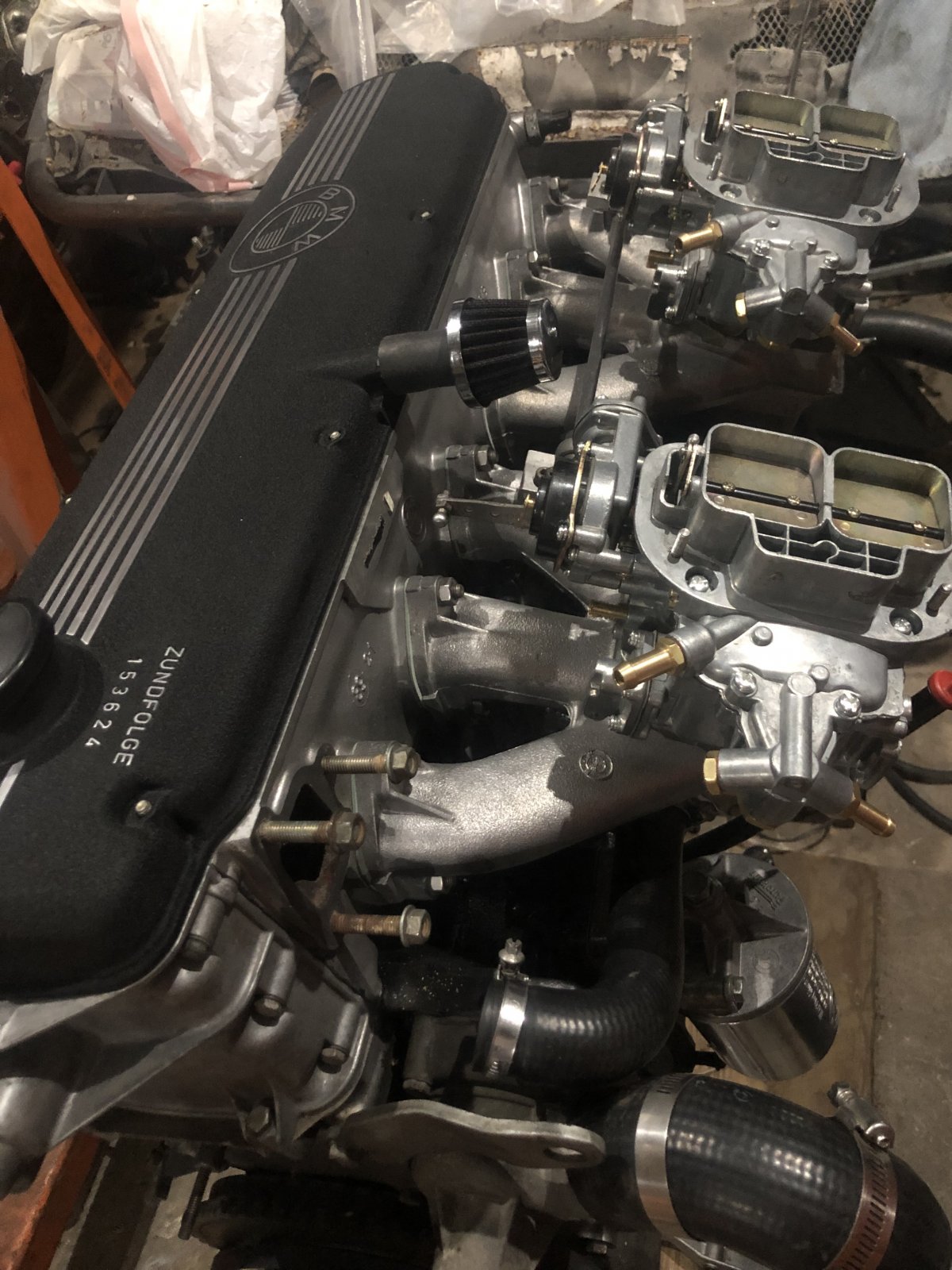

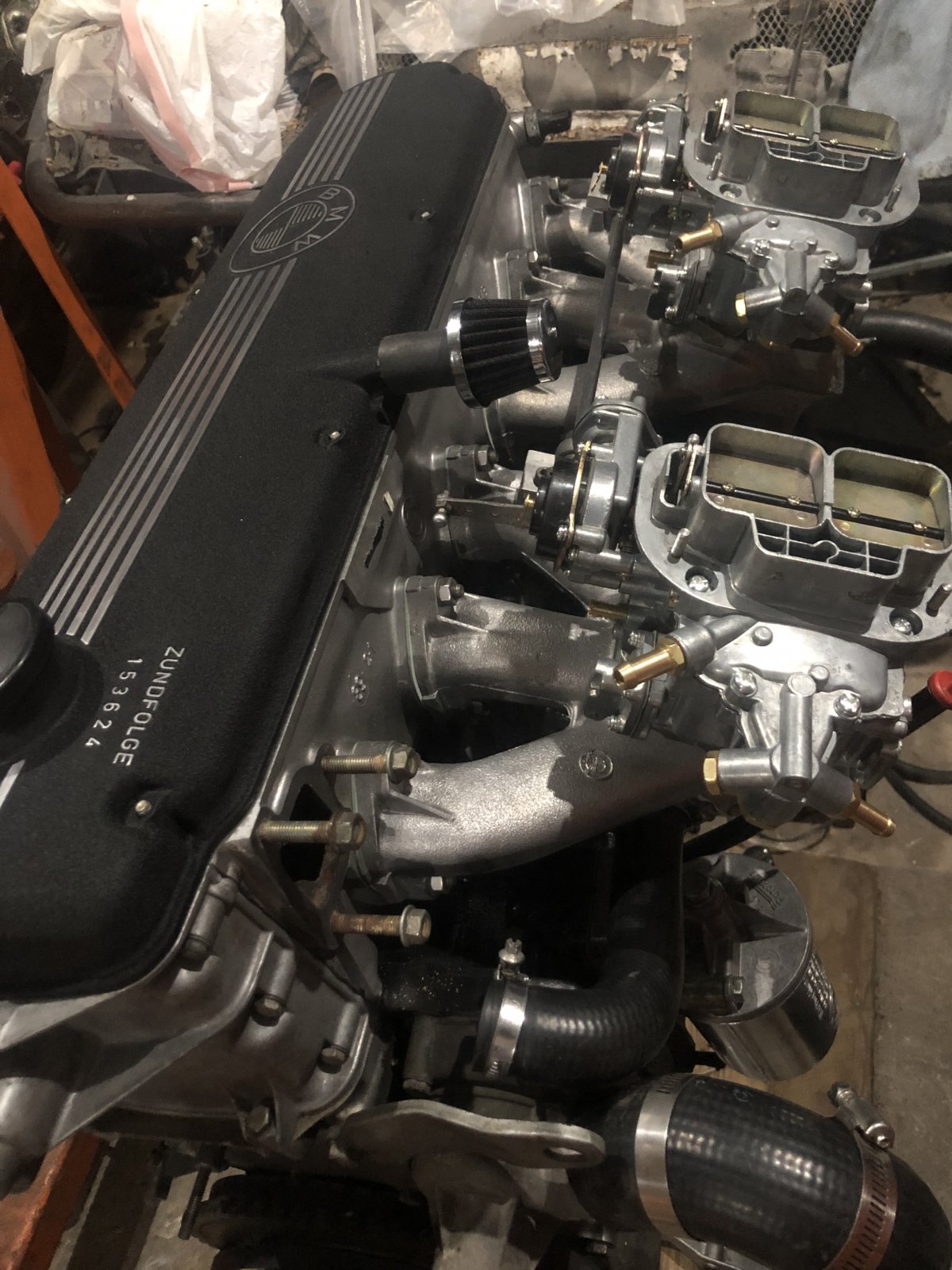

Progress
I REALLY like that valve cover! :cool:
And closer.....
