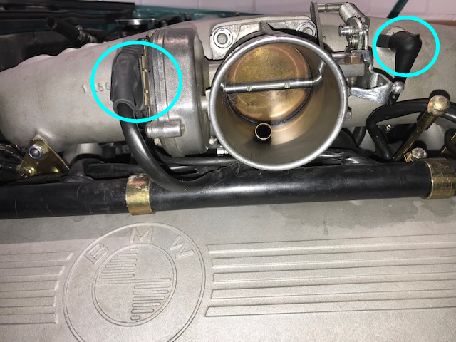

There are only three other inputs for the D-Jet: Air temp and water temp sensors affect the operation, the throttle valve switch affects injector timing(?).
I once had the experience on my '72 MBZ V-8 with D-Jet that the air temp sensor on the air intake was not seated properly after a filter check. Man, my engine went wild, just a you describe: black smoke, barely running, misfiring, etc. I re-traced my steps, found the badly seated connector, and that was it, purring like a kitten.

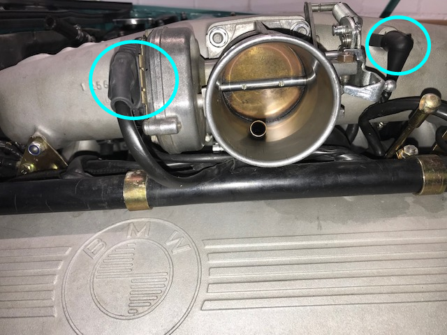

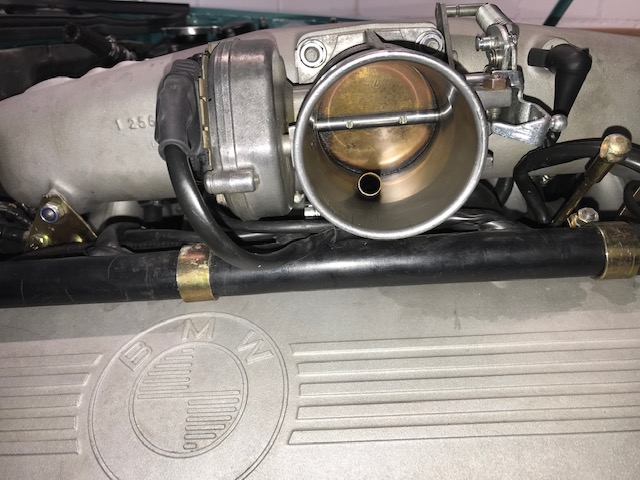

On the #9, I believe the air temp sensor is the sensor to the right of the throttle body. The throttle valve switch is to the left.

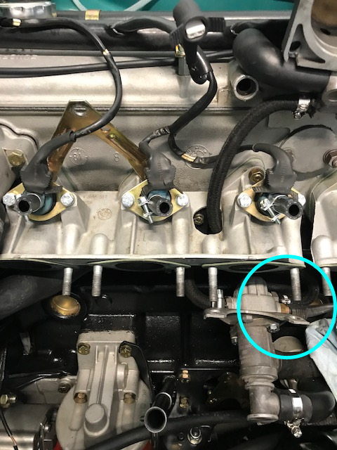

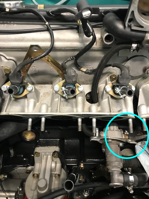

The water temp sensor is under the fuel pressure regulator on the intake side. This affects the cold start circuit:

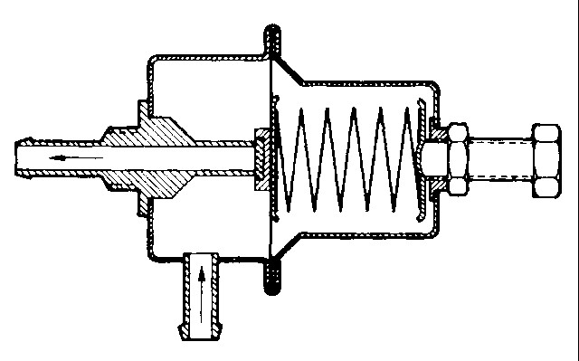

It looks like CSi has nut operated regulator
If the pressure is incorrect the whole system will not work properly but to be honest it is probably someting different.
Adjustments
Pressure regulator Remove hose at pressure regulator and connect pressure gauge to regulator. Operate fuel pump. Pressure should be 28 psi (2.0 kg/cm2 ). Loosen lock nut on regulator and adjust as necessary. Replace regulator if specifications can not be achieved.
Source (also some more about idling):
The regulator is mechanical. It's not vacuum operated. The line you likely removed was the return line back to the tank

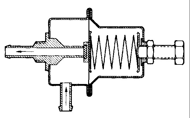

Adjustments
