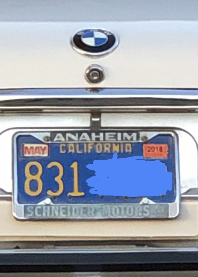

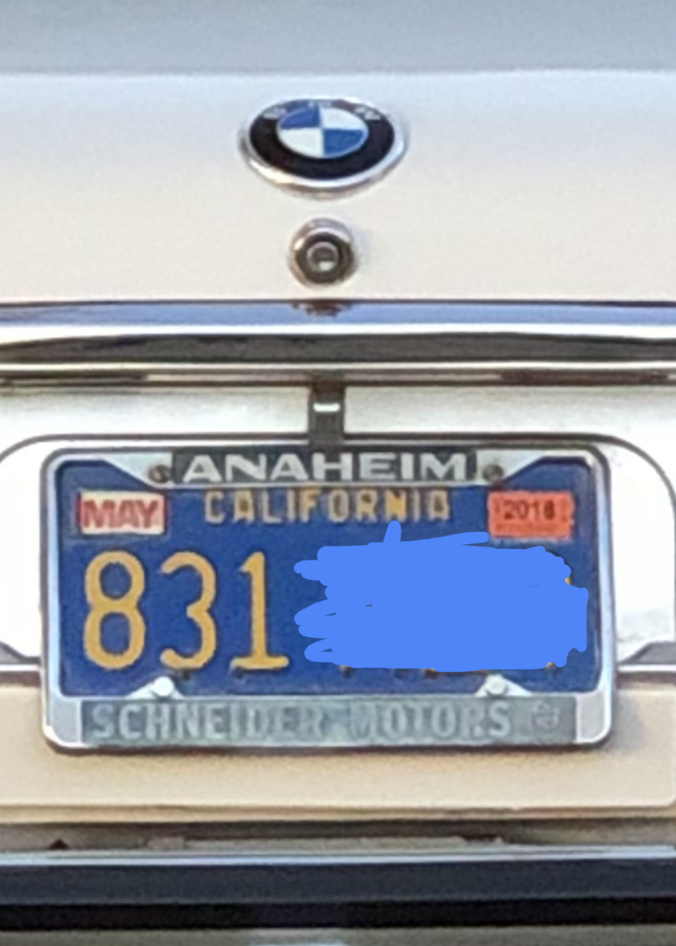

It‘s Schneider Motors in Anaheim.I just noticed your license plate frame, which dealer is on it?
No way! He was a dealer for only 3 or 4 years, I have one on my NK that I restored. Please post a pic.It‘s Schneider Motors in Anaheim.
I used their cleaner once and liked it (pinnacle). Your interior looks like it does not need a deep cleaning so their product might be ideal. Usually when I am starting out with a relatively clean surface, I just use a natural cleaner such as Bronner's and mix a formula that fits my needs at the moment - it has a nice unoffensive aroma unlike some cleaners that have heavy perfume. If you have any biological cleaning to do, I recommend an enzyme cleaner such as scuba diving cleaner - Revivex by Gear Aid. Dawn is best for getting oils out. My next experiment will involve an Oxyclean product designed for black clothing. I have some carpets that need deep cleaning so I plan to try it there.
The letters on your plate will confirm year of issue. CA DMV won’t provide personal data to anyone.Was he selling new BMWs? Could this be where the car was initially sold?
I heard it’s not good to post license numbers on the www so please excuse the obscured numbers...

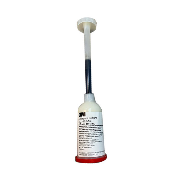

This stuff is amazing, but I do not know how it accepts vinyl paint. For lack of a technical way of describing it, the sealer is two part similar to epoxy products, but cures like a flexible rubber. Color is a bit more gray than our dashes. I am going to try to mask a crack, fill with the product, apply an epoxy primer (with a flex agent if I'm feeling thorough) and then top coat with a matching vinyl color.
If not used for the dash it is amazing for other patching
3M™ AC-350 Class B Aerospace Sealants | Aircraft Spruce
3M™ AC-350 Class B Aerospace Sealants 3M Aerospace Sealant AC-350 is a family of intermediate density, fast-curing, polysulfide fuel tank sealants that provides outstanding resistance to aviation fuels and petroleum chemicals.www.aircraftspruce.com
Original plate issued in 1970, very cool.
Absolutely!Neat! It must be among the first of the blue plates issued.
