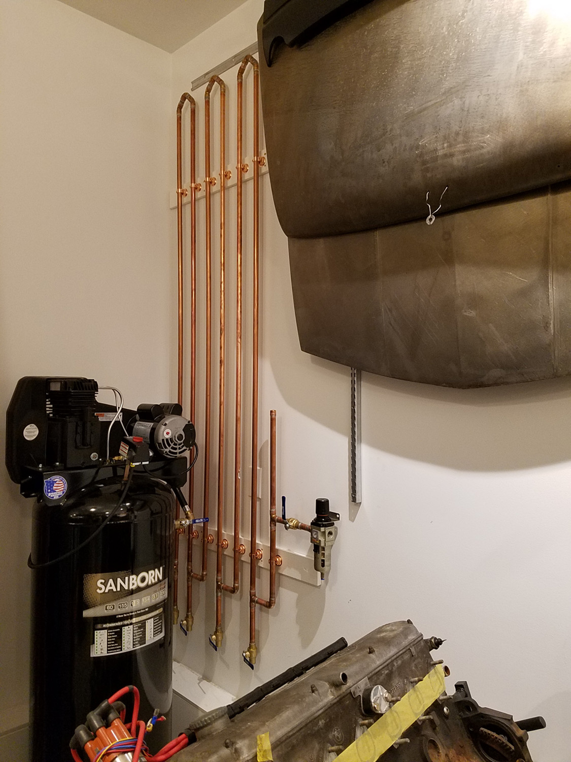

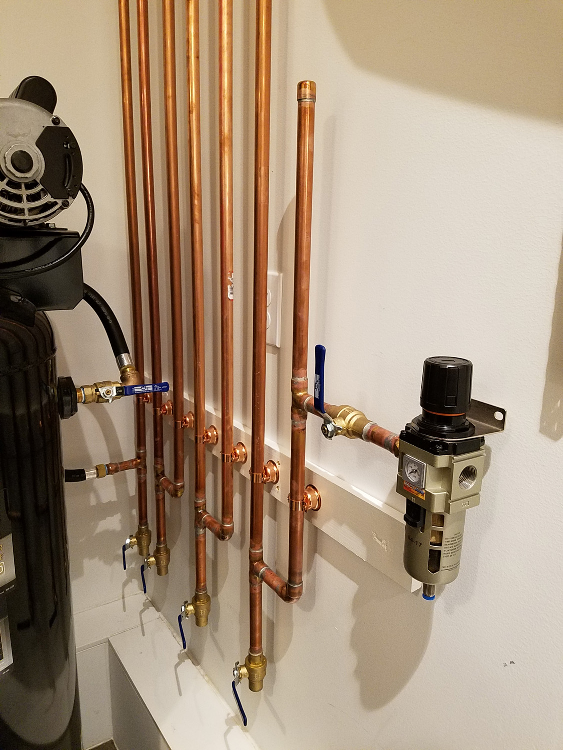

I have to report that I haven't been spending enough time on the car, but there are some good reasons. One is that I hadn't installed my compressor yet, and it is hard to do work with air tools without... air. I have a fairly inexpensive compressor, but I'm hoping it will serve my needs. I have an autobody friend that laughs at it and tells me it is woefully inadequate. But I'm hoping he is speaking from a full time, multi-person shop perspective. I wanted to achieve a level of reasonably dry air, so I built a, uh, pipe organ. :D The theory is that the hot compressed air cools as it passes through the 45' of pipe and can be drained from valves at the bottom of the runs. The internet says this works. Whether it does or not, it sure looks cool!
