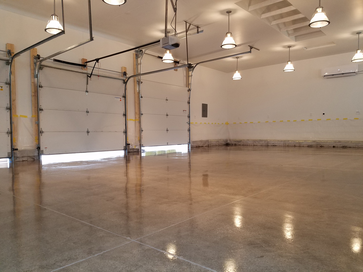

For the floor, I called in a favor from a decorative concrete company. Monday and Tuesday they were here grinding the floor. And today they are putting an industrial 2-part urethane finish on the floor. And let me tell you, WOW! Here's a pic with the first of two coats. They are out there putting the second coat on now, which will have "sharkgrip" mixed in with it. This is a virtually invisible texture that provides a great deal of slip resistance.

It's probably not as bad as these photos suggest, but this is what happens when you have your floor done with "favor" pricing. He said he'd "buff them out", but I don't that is a real thing here. They put the second coat on a bit too soon, and the first coat was still tacky. He ended up in his socks in an attempt to not mar the surface. But towards the end his socks were sticking more and more. It's kind of funny, really.
Really? He's a pro at this? Maybe the smell has cost him too many braincells.
Golf shoes with metal cleats. Keeps you right above the floor and the new product will fill in the little spots disturbed by the cleats.
A friend had his garage floor done with the whole epoxy and multicolored flakes. It took over a month for the organic vapors to dissipate though he didn't leave it open for very long.
Oh well. The floor will work just fine even with some foot prints. Just call it "Custom" and if anyone mentions it, tell them it is the signature of the artist.
And this is why I end up (and enjoy) doing my own work myself. The garage was too big a box for me to build with any reasonable schedule expectation. But this floor issue reinforces what I see on our project sites every day. I don't have words to express my true feelings on this.
Oh, I'm sure you could come up with some words...
Floors are easy to screw up. My spiked shoes didn’t come on time. I missed a few strips of clear and never applied them. You can’t really see them but it really bothered me at the time. Not as much as my crappy flake application though. Still looks good, and will hopefully be a bedroom, office, and laundry room in the next few years. :D
I sympathize Stephen. We all chase perfection, and I agree, sock prints or similar are not what you wanted. But in a project this size, we all make some compromises and, more importantly, assumptions. Like the quality of a "favour" job equals that in a full price deal. Never happens. But really, you have a great structure that will soon be filled with much more important stuff and the "prints" will quickly fade into "the most interesting story of the 'Nest build" . Put together a slide show/power point /or similar of the choreography needed to complete this new building that will house your hobby and project, and the "feet" will disappear into the many "steps" needed to guide this project home. ;) Mike
