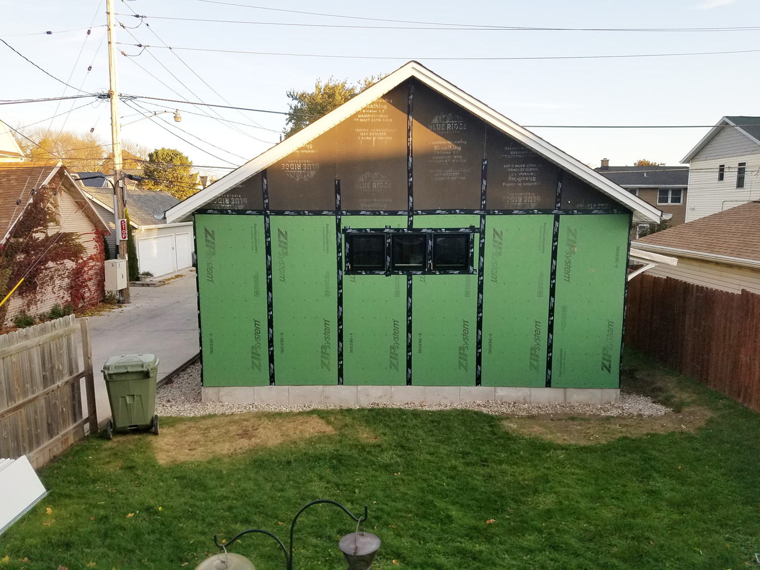

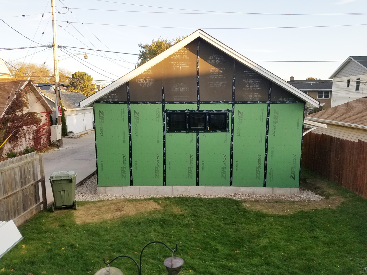

You can also see the fascia work is nearly complete on the main roof, and the half-round gutters are installed (albeit a little wonky). I'll need to get up there and tweak their position a bit... The half-rounds were an indulgence on my part. They are terribly more expensive than standard "K" gutters - which I can' stand. I'd put the half-rounds on the house and wanted to carry that detail through on the garage. I just learned that the custom colored, prefinished siding will not be delivered until November 5. The things I choose to upgrade...

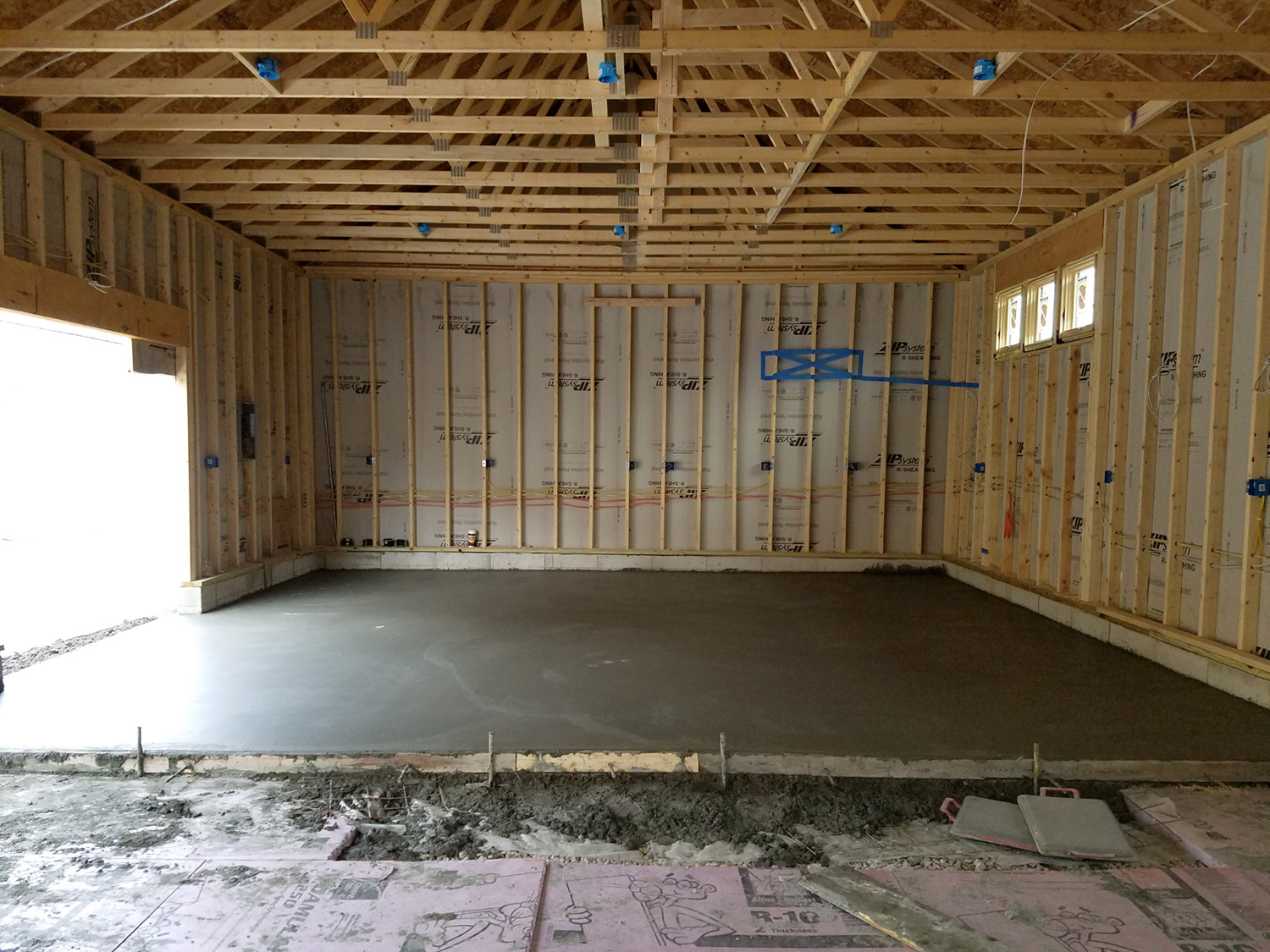

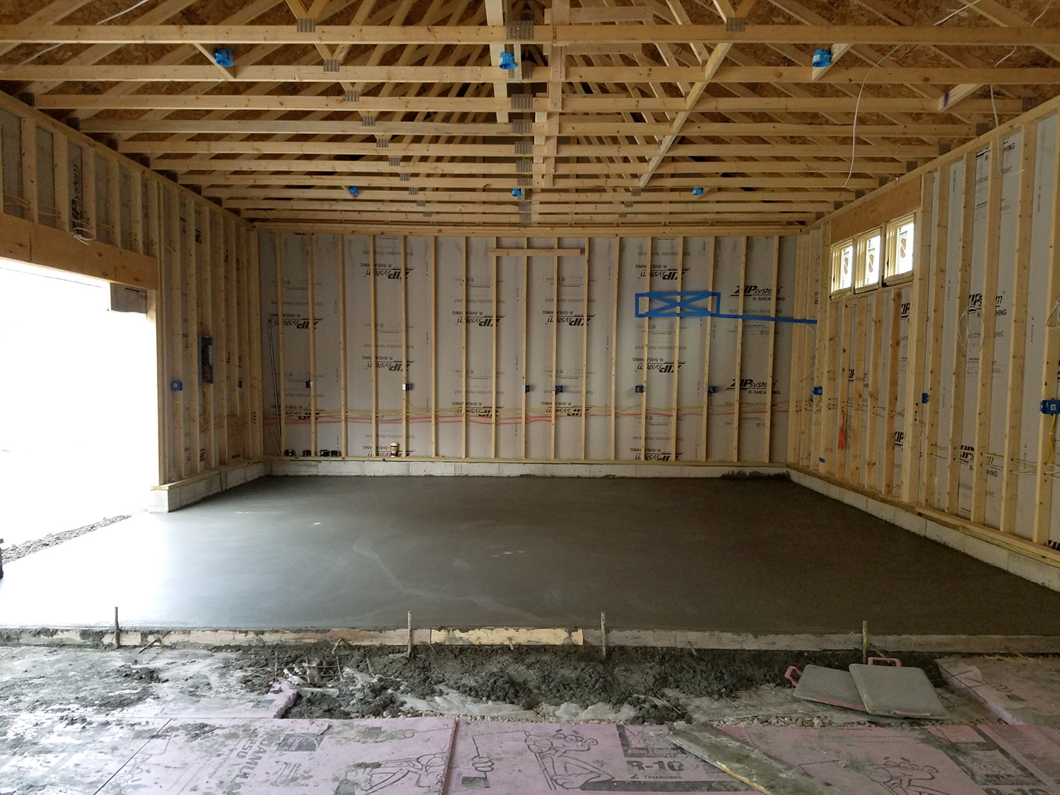

Oh boy - big update today, and directly related to the mayhem alluded to above. Yesterday the concrete crew was there prepping for the interior slab. I'd communicated both in drawings and in conversations what we're after, specifically noting some of the requirements for the 2-post lift. The control joints can't be within 2' of the posts, and I'd laid out the joint pattern thusly. However, the GC told me they weren't pouring yesterday so I could communicate the joint layout this morning. Because of that, I didn't leave the office to check on the progress yesterday. Please note that I'd already agreed to a few thousand dollar increase to cover the work associated with laying out the rigid insulation, reinforcing, and some other details that I hadn't initially discussed with the team. I am happy to pay for the scope I add.
Well, when I got home last night I immediately saw that "something" was lost in translation. There was a curb formed up right where one of the lift posts will go. This condition would have left the shop overhead door at a different elevation than the other doors - not to mention something for us to trip over every day. I called the GC, he called the sub - as of last night they were going to walk off the job. WTF? :(
This morning I wrangled everyone on site and we discussed the situation. Carefully navigating feelings and pride, I explained that regardless of how they got there, this isn't right. They agreed to stay, and are busting hump all day so the 3pm concrete pour can remain as scheduled. They need to pull up much of the rigid insulation and reinforcing, scrape out several inches of gravel, re-compact it, and re-set the insulation and reinforcing. I offered to buy lunch. In fact, I expressly asked "what can I do to help with this?". No response. Then I turned to the GC and asked: "would it be better if I stayed there all day and pretended to help, or leave (I was supposed to be in a meeting 2-hours away today)." He said it'd be better if I weren't there. That's when I said I'd at least bring in lunch... And I sent someone else to the meeting as I want to be close by.
Honestly, the world we live in is where we have to spoon feed the trades so they will stay on your project. While I think absolutely everything about this is wrong, I am glad the work is getting corrected and done. Well, maybe I should wait until tonight to confirm that. :oops: More later.
Quick update - I stopped at home a few times yesterday. Rather, I ran into the office a few times, and worked from home most of the day - although I tried to limit my presence out in the garage to as little as possible. By 10am they were almost finished re-grading the gravel base course - it was looking good. At noon I brought the crew $74 worth of pizza and beverages. I think this bought us at least $95 or $100 worth of value. ;) The concrete trucks arrived at about 3:30. It was a little cooler in the afternoon and evening, and the crew didn't order any special admixtures for the concrete to accelerate its setup. I am happy for this, as a slow cure typically results in a better result. But the crew was there until about 9:30pm smoothing out the slab. This morning, I have to say it looks REALLY good. They only poured half of the slab - they told me they can't do it all at once because their crew is too small. The second half is scheduled to pour at 2pm today. If the rest of it looks as good as the first pour, it will be a very good weekend!

What I did not mention above is that, after a few meetings in the morning, I spent the day yesterday putting my carpenter hat on. The crew is insulating today, and I needed to add some blocking in the walls for things that will be attached later. While doing so, I discovered that they'd installed other blocking incorrectly - so I fixed that. Then I noticed that there were more than a few locations where the exterior sheathing (plywood) wasn't nailed to the studs! There were rows of nails that "missed' the studs and I could push on the walls to a gain of a good 1/4" of flex. Honestly, I don't know how any of our projects get built - we don't typically spend this kind of time inspecting every nail. I am a little angry that I "had to" fix these things myself. Yet, I am honestly pleased that I am building the garage - hands on - in many respects. So I have that. The day concluded with a chat with the builder about some "extras" that the concrete guys want to charge. Fortunately, I have photos and records of everything they are claiming and can push back significantly on these items. But unfortunately, this type of friction on my small time builder probably causes a lot of stress on their business - and I don't want that to be reflected on the remainder of this garage build.
