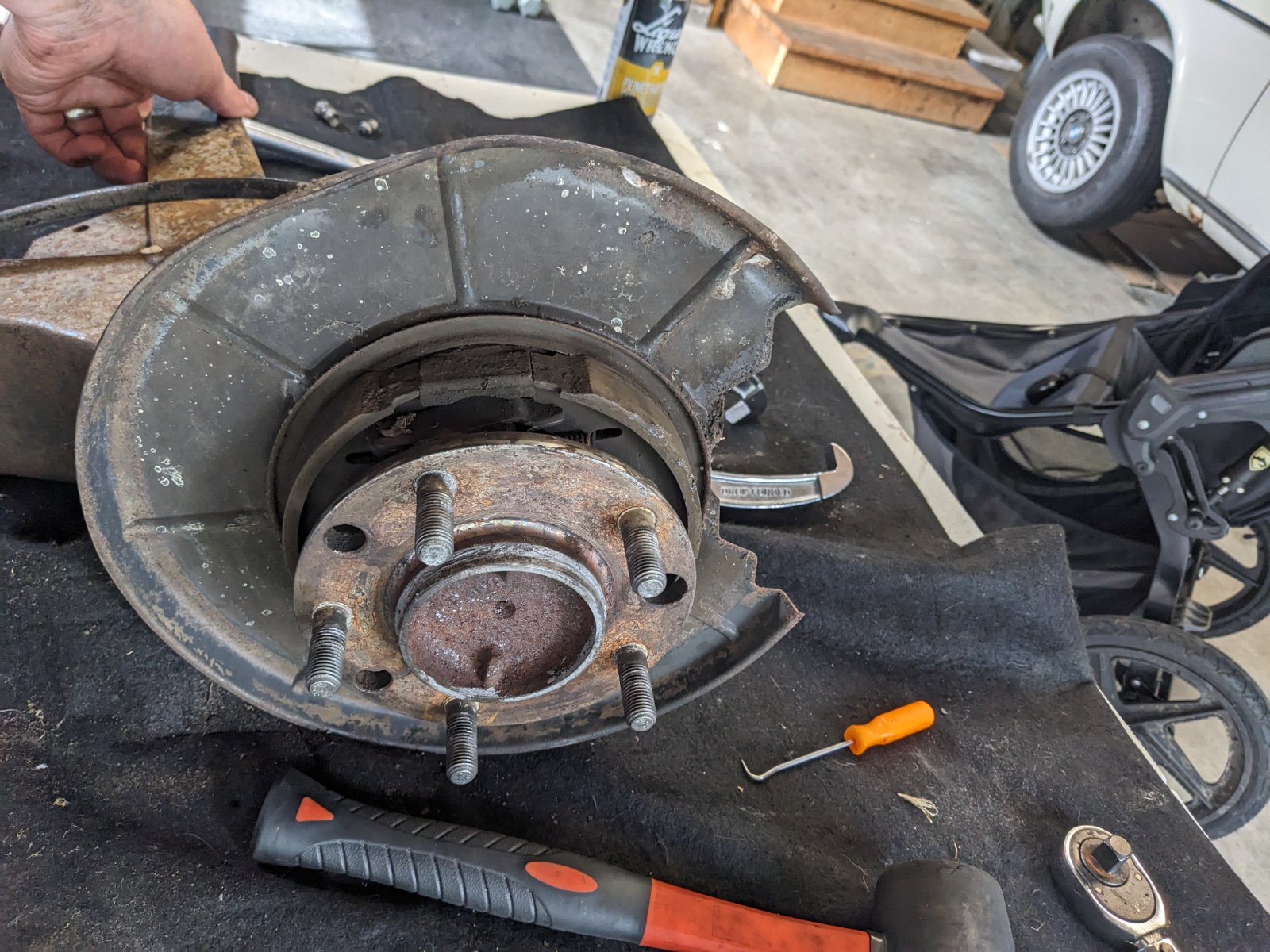

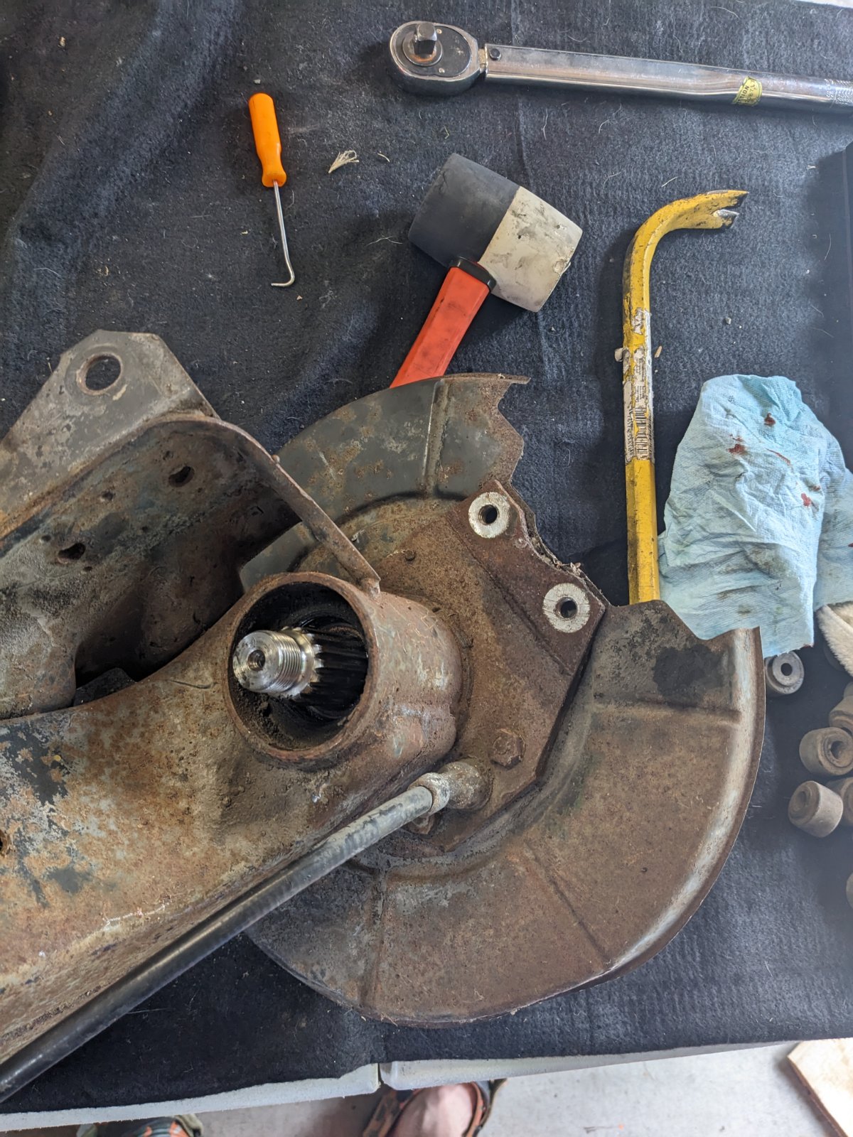

Inner bearing and seal in. Was not without a couple new battle wounds though...blood blister and laceration
