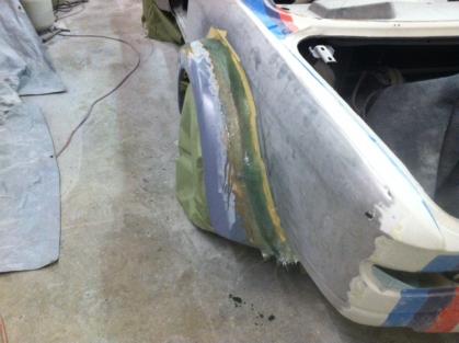

Those il-fitting parts are being beaten into submission. The rears are about done. The fronts are still in process, then the front air dam will be fitted.
I think they are going to work fine, provided we don't have to add too much bondo. It's a little like watching sausage being made- as the old saying goes.
More sausage!
The fender flares are fitted, and now it is time to fit the front air dam.
