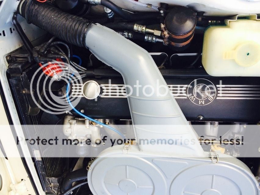

please add a little description of the car, year, model, variations,...

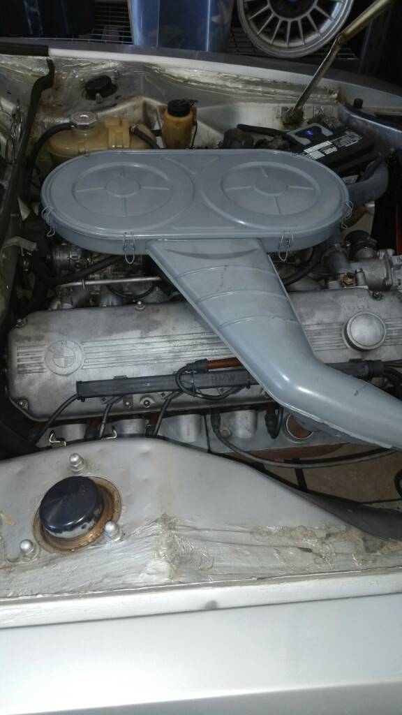

a 1973 3.0 CS Automatic (Borg Warner) with stock zenith carbs, original fan, engine bay with original insulating material (never removed). Cover of wiper motor is present and even a kit for radio interference suppression. Sealings are all original. Also a Walloth & Nesch Domstrebe.

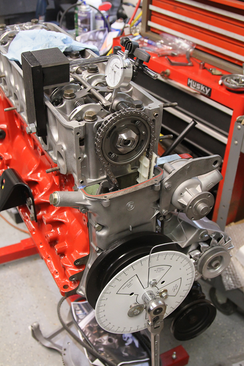

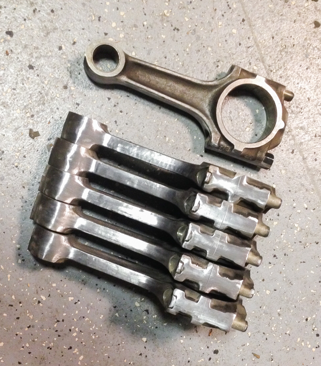

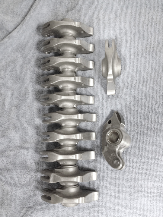

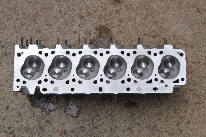

1980's 3.5 block. Stock crank with lightened rods. B35 head with Paul Burke 10.5:1 pistons.
All the rocker arms were blueprinted with double springs and bigger valves by 1mm.
Titanium retainers.

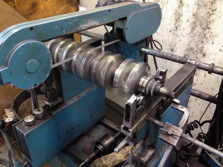

Complete balance including flywheel, pressure plate and balancer.
Using a Paul Burke #2 cam. Not the hottest but driveable.
Some minor cleanup of the ports.
Triple 45 DCOE's with electric fuel pump and 123 Distributor.
Hasn't been on the dyno yet.
Approx 250 HP.

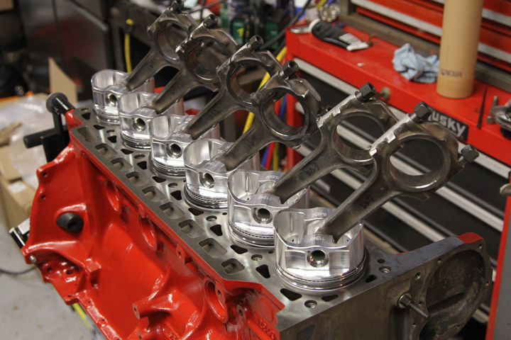

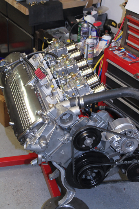

m90 block bored/stroked to 3.8 liters
94.5mm RaceTek pistons
142.5mm Carillo H-Beam rods
s38b38 90mm crank
e21 intake runners
port matched intake manifolds
Paul Burke n21 cam
Megasquirt fuel injection
Alpina b10 headers
1988 m5 s38b36
85 super eta harness and kdata megasquirt
Euro snakes
m5 ac and alt.
w/11:1 pistons
1986 535i overdrive 5 speed
alpina 3:91 lsd
Titanium retainers.
Approx 250 HP.
