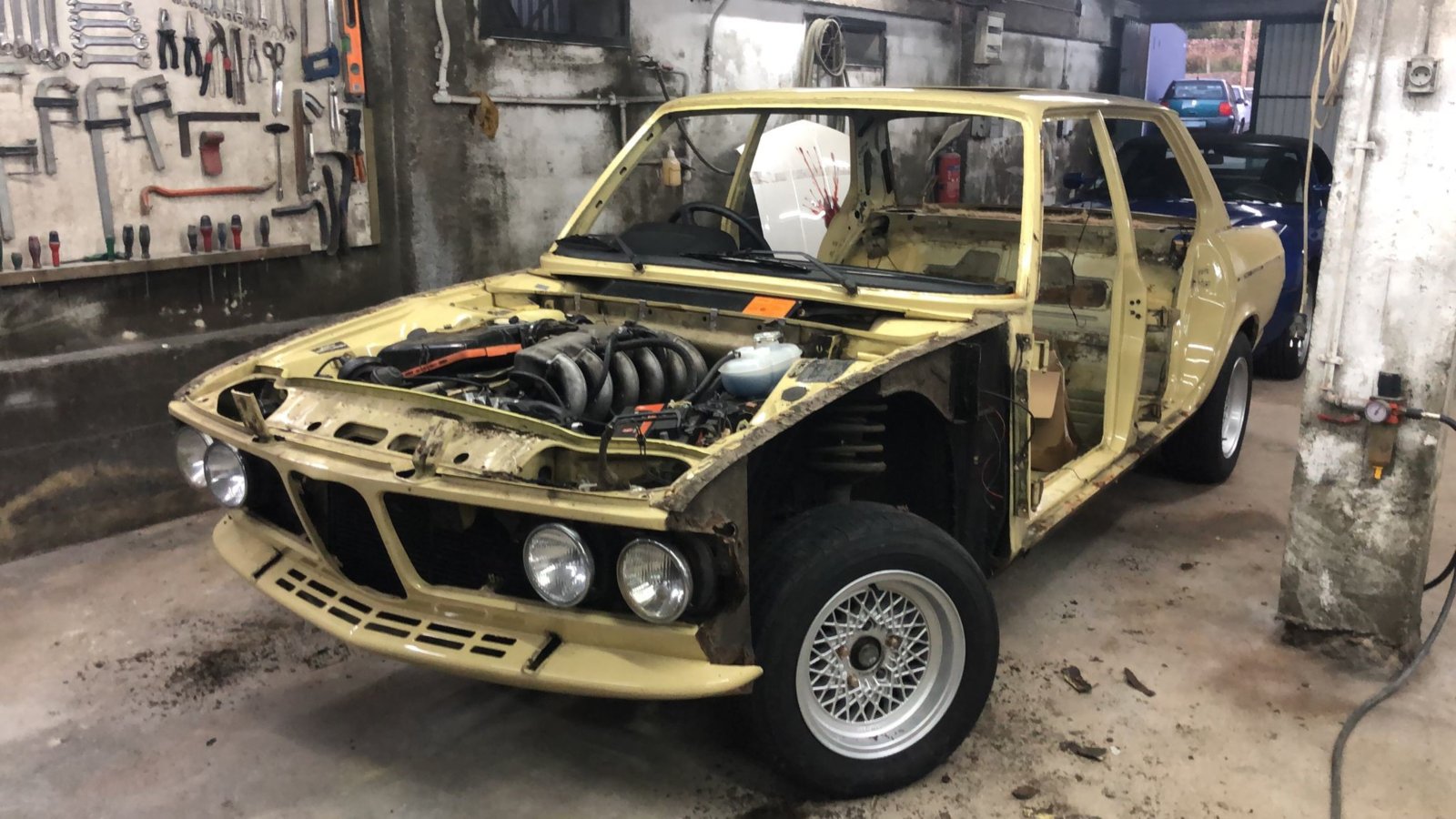

So, the strip-down began. I started this work off at home, with the idea that the car would go to the bodyshop for the more involved work. Whilst it actually looks pretty good in these photos, appearances can be deceptive....

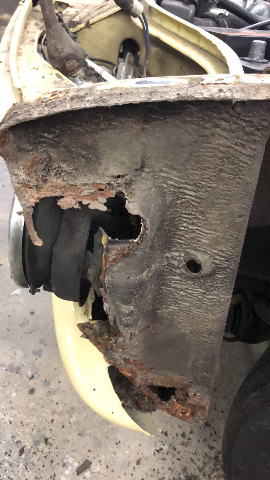

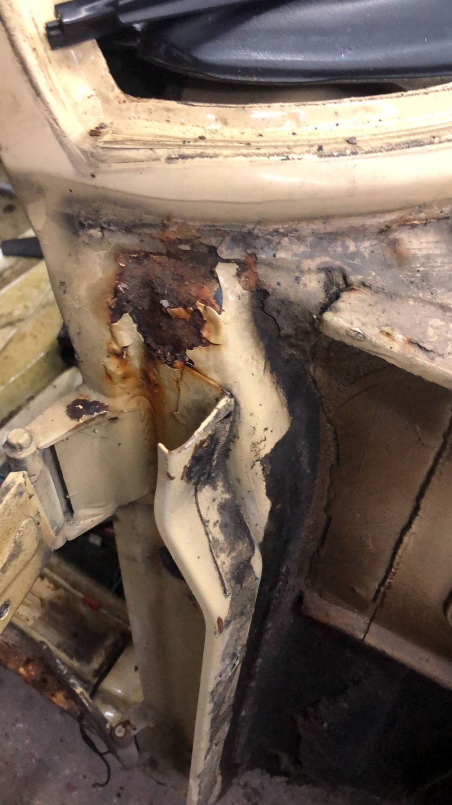

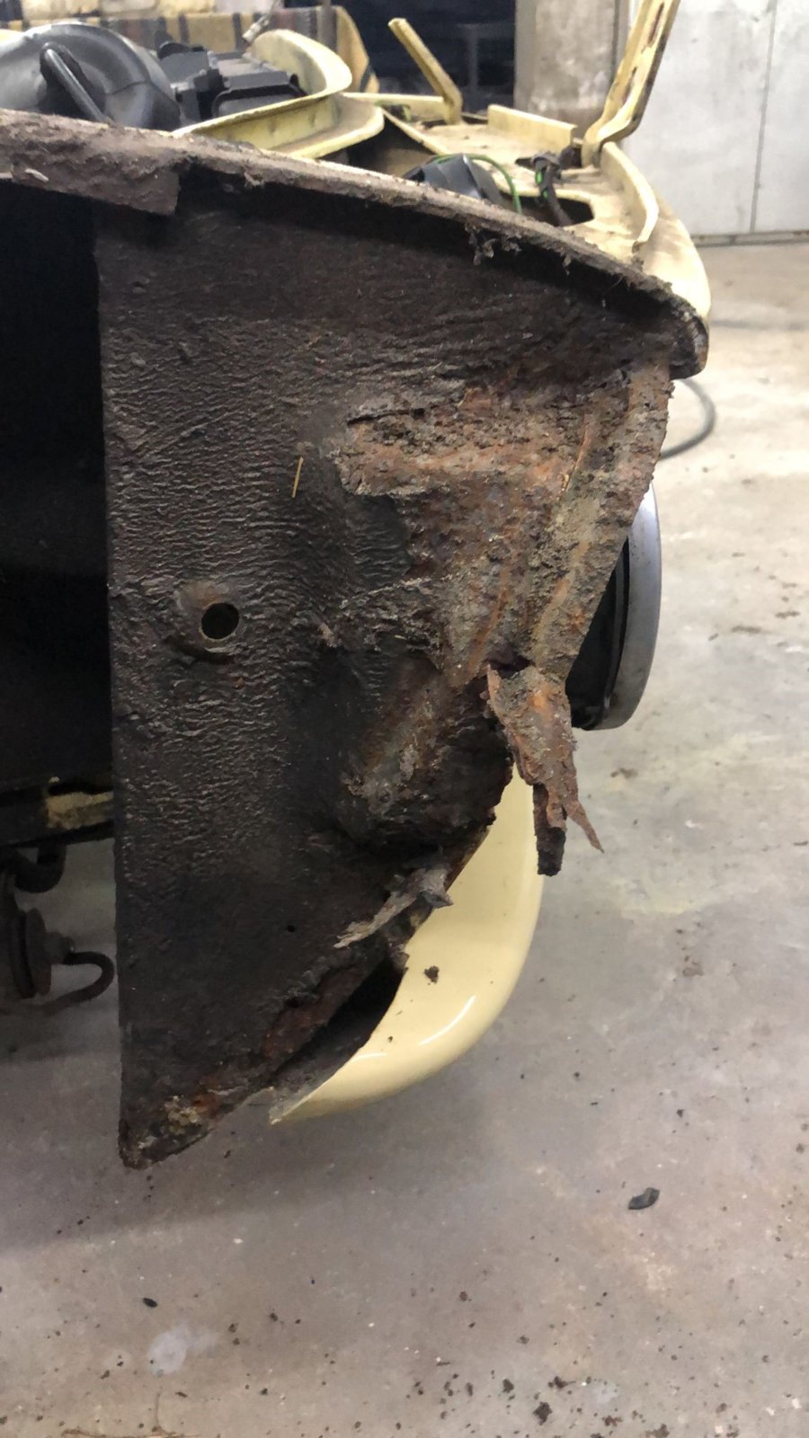

Before the shell was blasted however, there was some immediately apparent rust in some of the usual places:

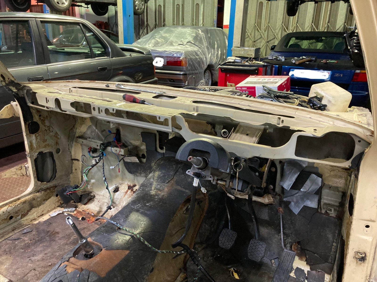

And then we got to the dashboard. Very fortunately, this was in really good condition and the screen surrounds were very nice. I had been a bit worried about rust here, and you can also see on the kick panels where the metalwork had been butchered some time in the 1980s to fit some very 'fashionable' Pioneer speakers:

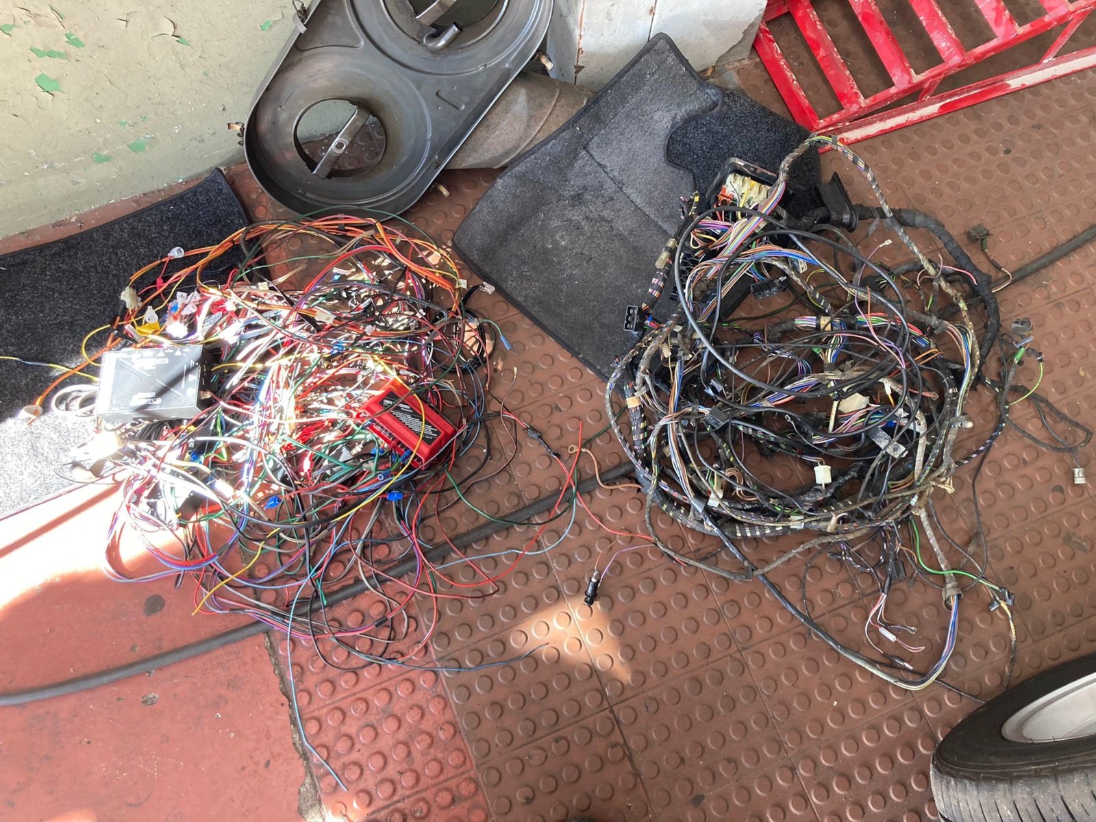

On that subject, the car ad been fitted with the typical mid-80s in car entertainment system; a Pioneer head unit, speakers and amp. In addition, an alarm system and an occasionally functioning central locking system contributed to a lot of extra wiring. As I want to return the car to standard specification, all of this is going to go. In the photo below, you can see the original wiring loom on the right, and the additional wiring on the left:
Very common, cars used in 80's and 90's were full of different wiring. I'm recalling my friend removed three alarm systems from his E36 convertible after he bought it. The car was also carrying OEM, factory installed one.

On your aircleaner lid are snappers, made from wire. These are often replaced with later ones with bend metal strips. Someone will want them.
Would you care to sell me the old original harness? I'll scavenge some connectors, earthen loops, spades and wires (specific color) from it.
Wow, four alarm systems. I guess the previous owner was rather security conscious…..

That isn’t my air filter housing in the pic; it’s from a carburettor car and mine is an L Jetronic 3.0Si. I guess that part just happened to get in to the photo! No decision has been made on the wiring loom just yet; it’ll either be restored and reused, or a new one made. I’ll let you know if the old one is not going to be retained.
Car stealing was a big problem in 80's and 90's.
That time, to be able to get a discount for car's insurance you have been forced to have two (one despite OEM if available) anti-theft protection systems (mechanical, electrical)
Other story is car electricians prefer to mount new, than play with old system and dismantling cost time = money. :)

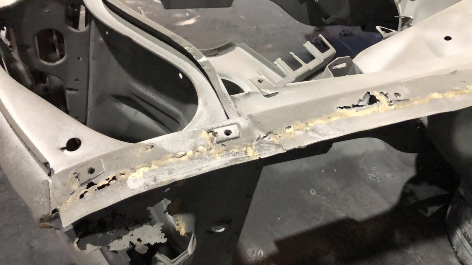

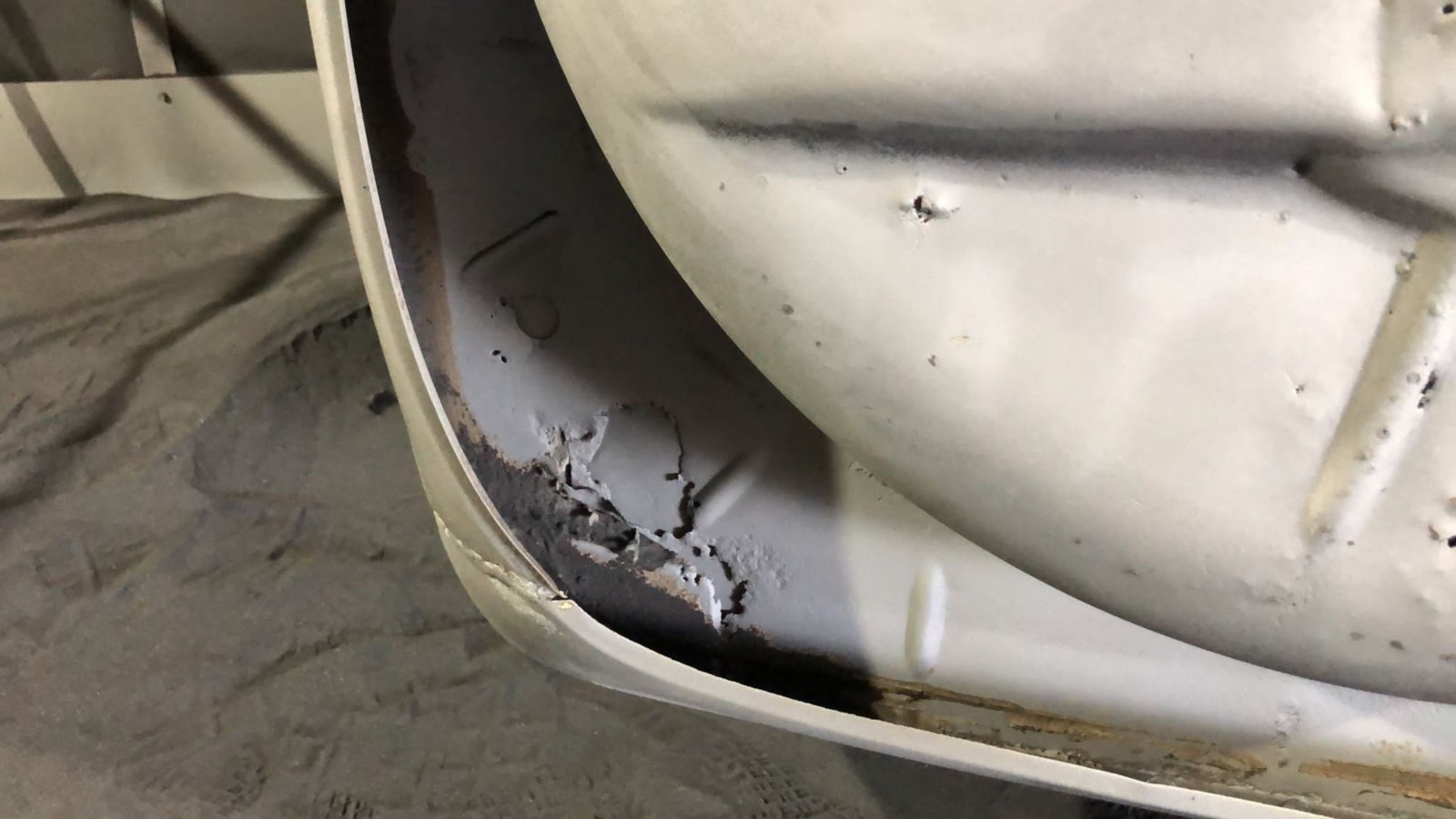

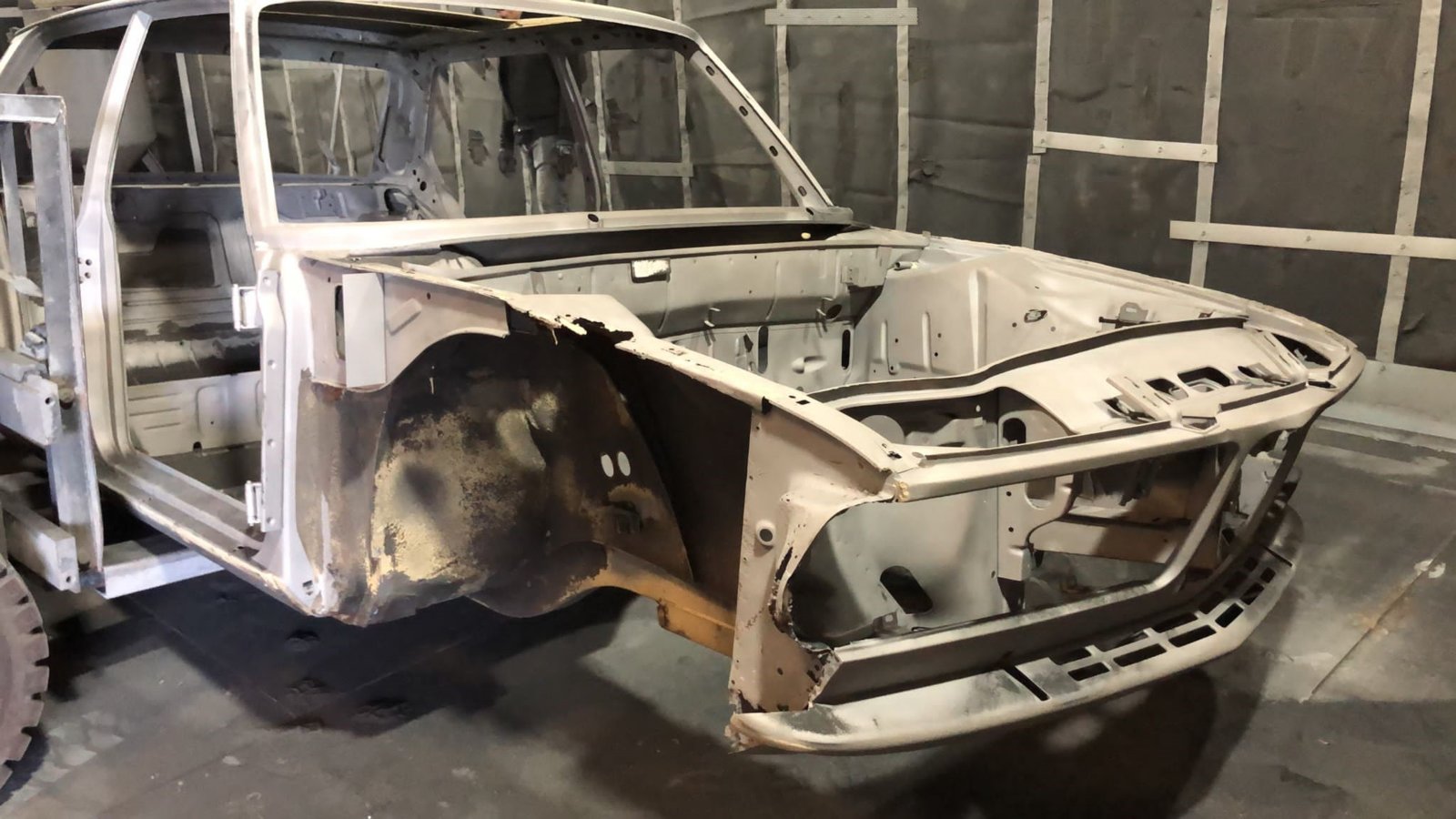

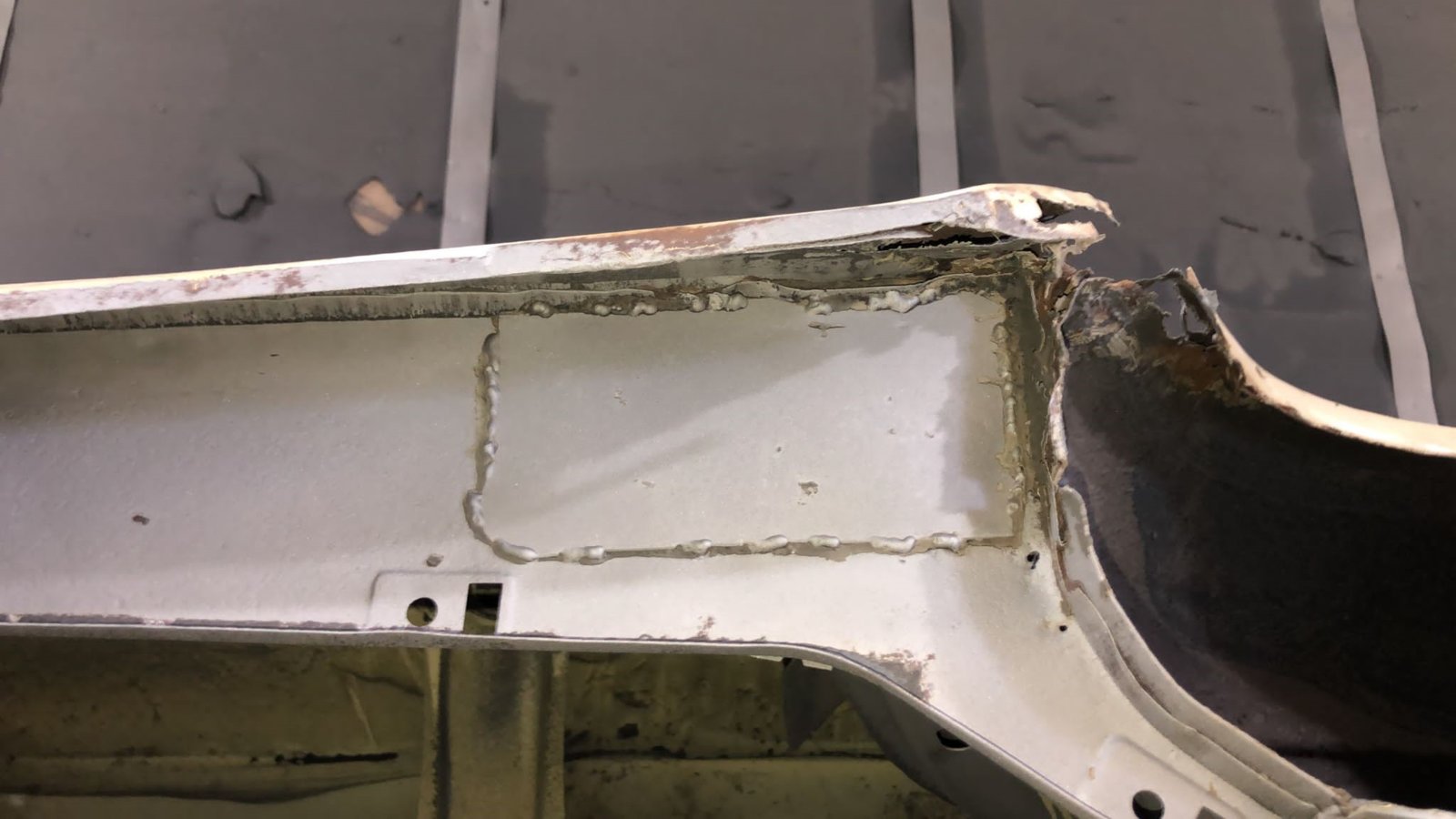

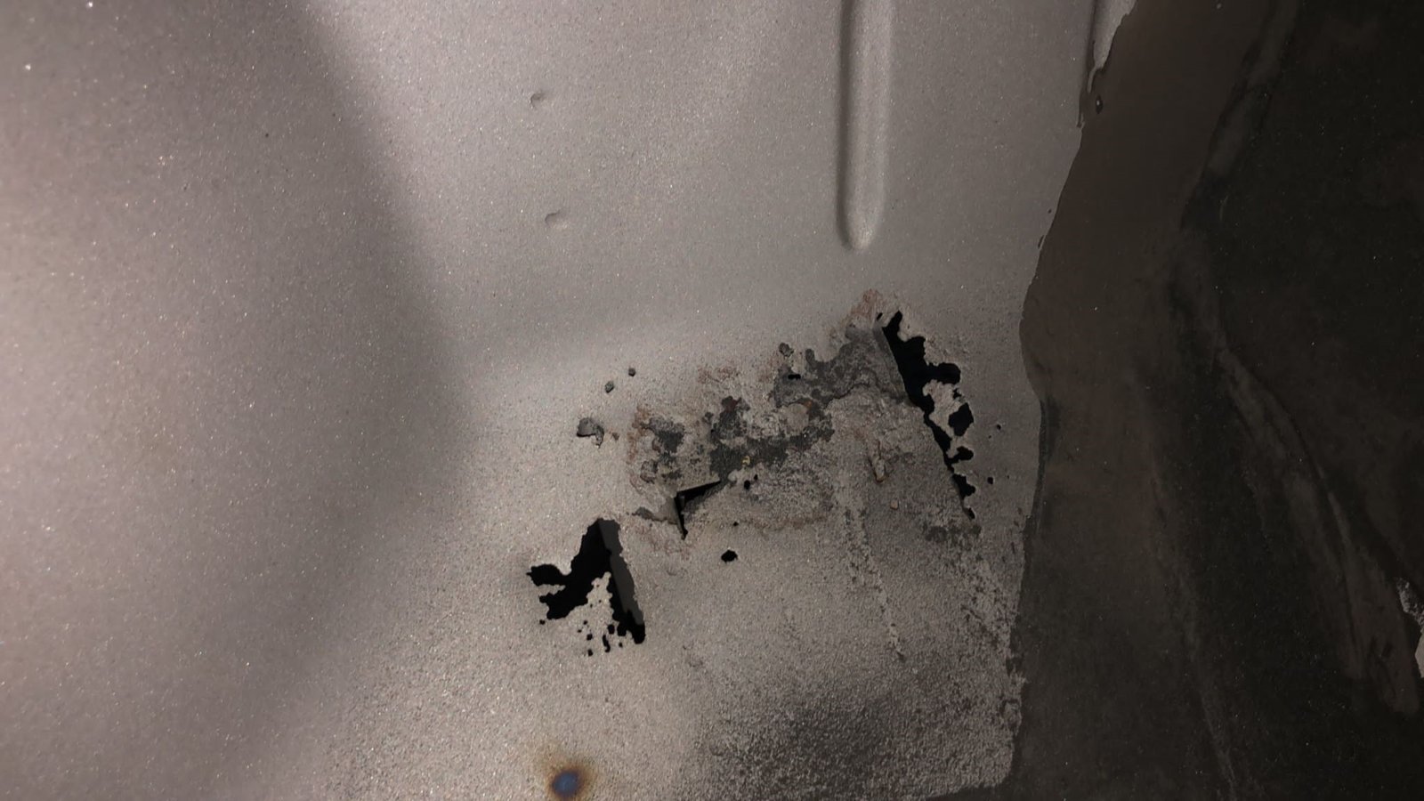

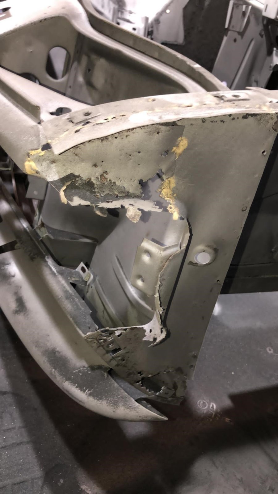

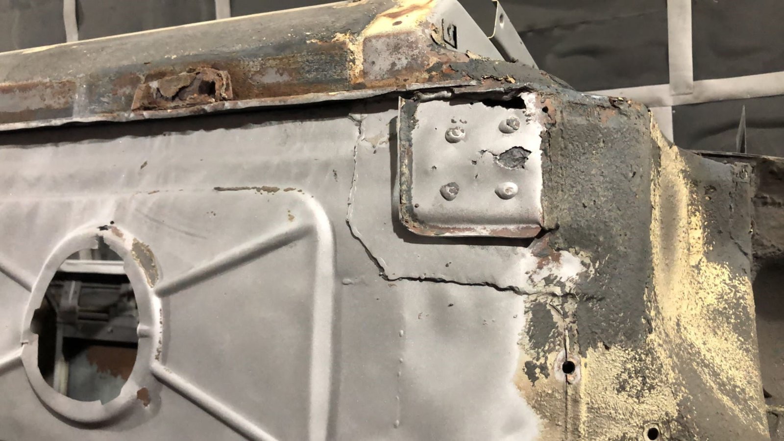

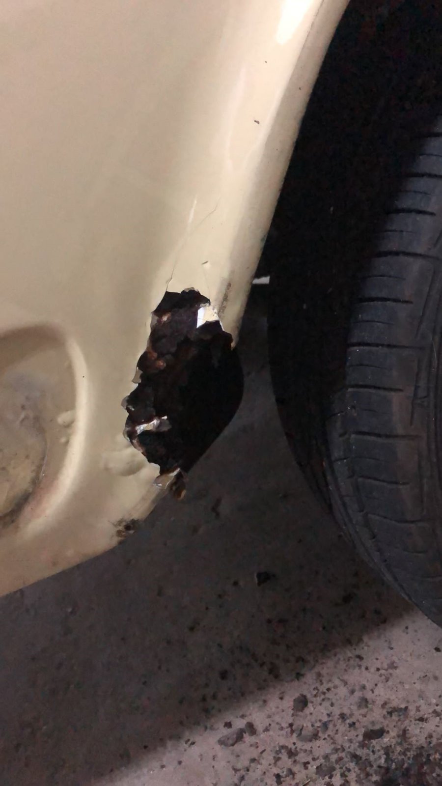

I was really curious to see what the shell was going to look like when it came back from blasting. Despite the expected horrors of the terrible welding in some localised areas of repairs, the general impression was that it is a really straight body. There is no evidence of any previous accidents, and my feeling that this was good, straight, original car was confirmed when it was placed on a Celette jig and found to be exactly to factory tolerances.
Nonetheless, it was immediately apparent that some repairs were going to be in order:

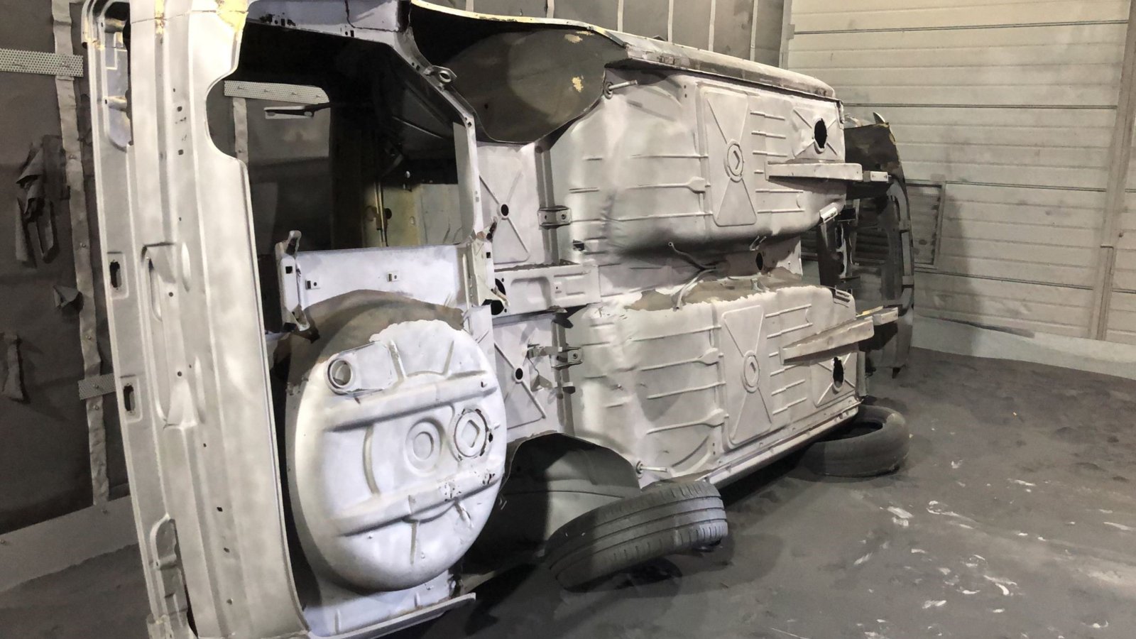

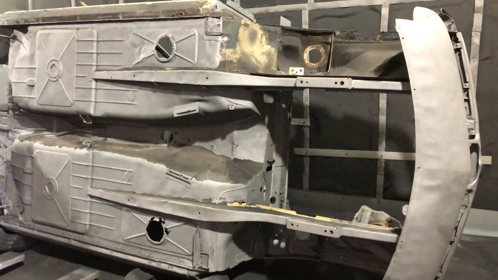

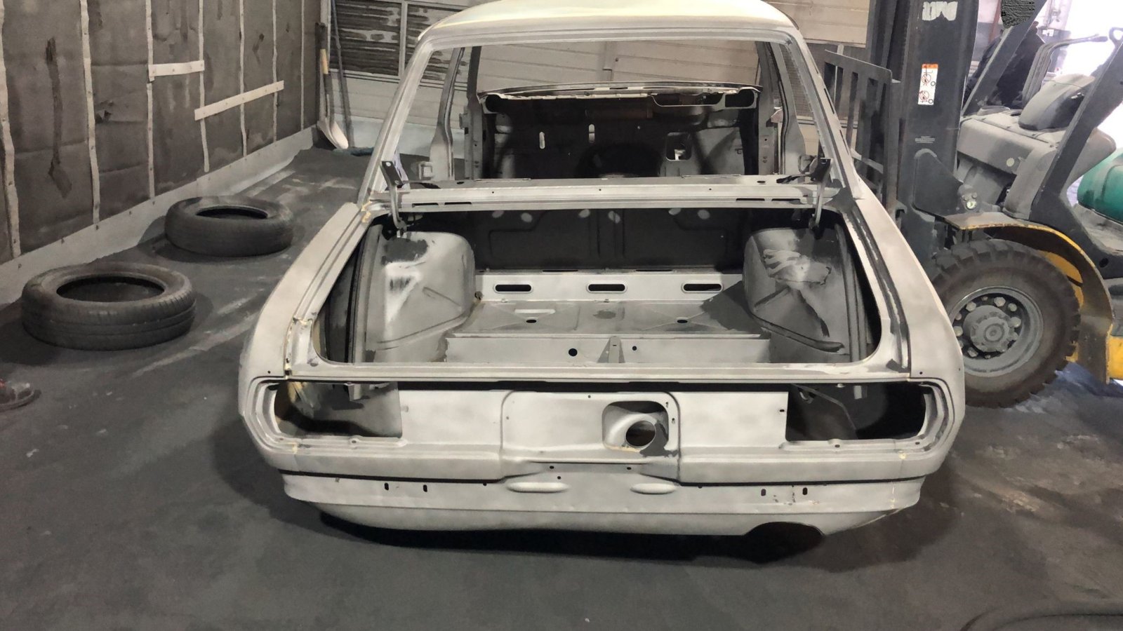

As you can see below, even when it was partially blasted (before the process was completed) the shell came up really well and it was apparent that on the whole, it was pretty good:

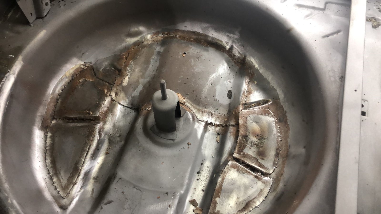

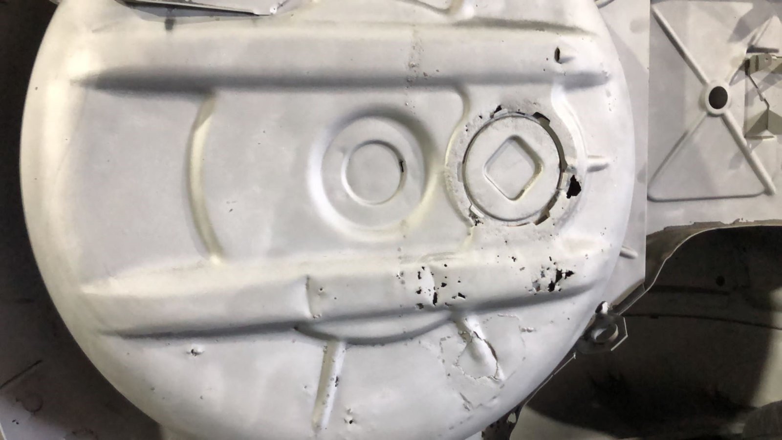

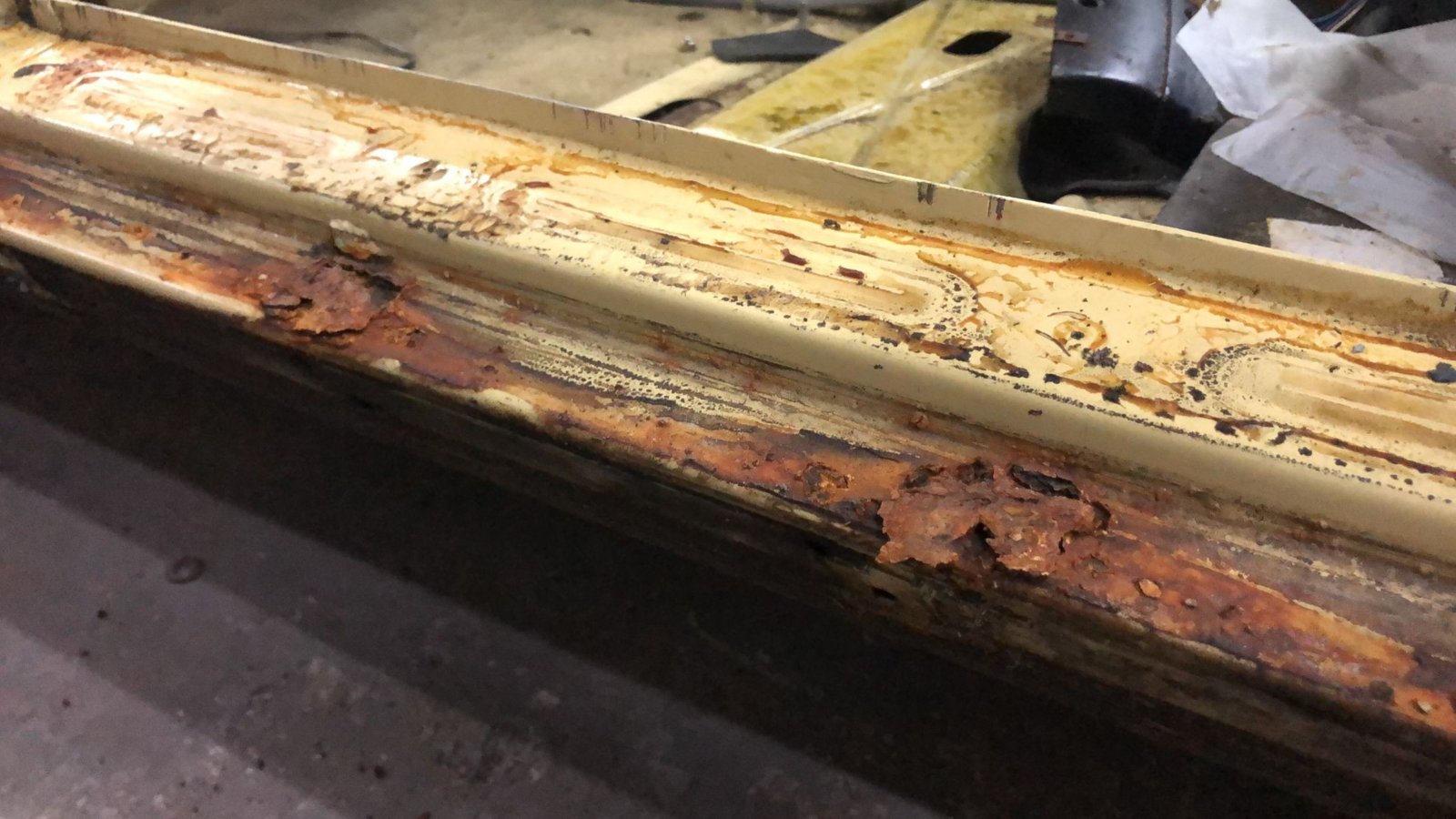

The boot floor was, however, a different story:
I'd love to know who thought that this was a good idea:
View attachment 134845View attachment 134846View attachment 134847View attachment 134848
View attachment 134850View attachment 134851View attachment 134852View attachment 134853View attachment 134854
