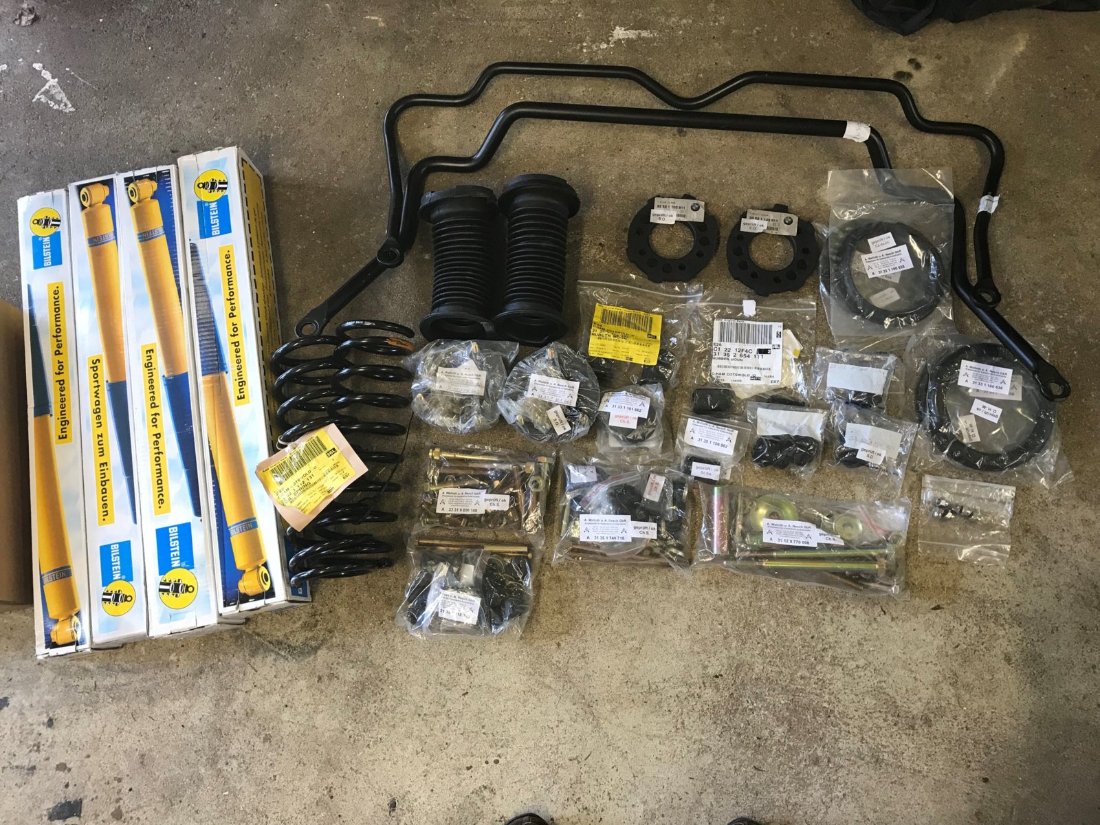

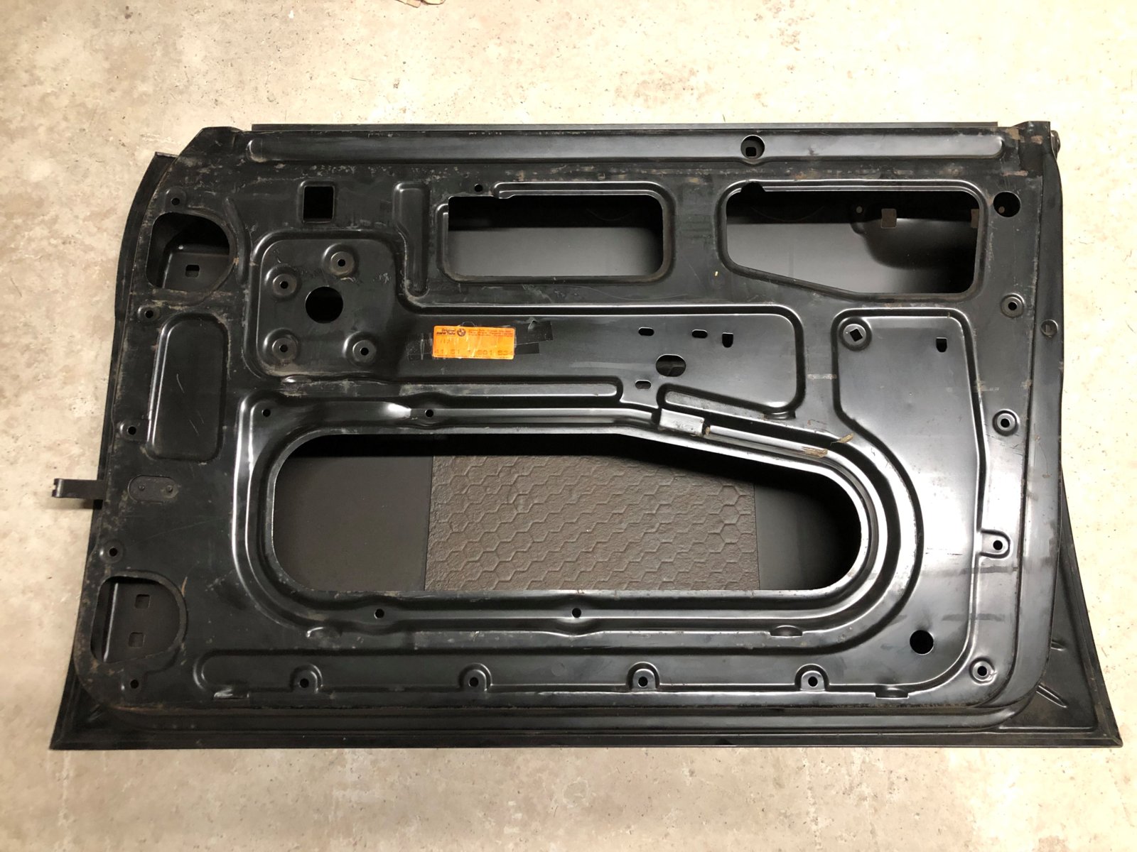

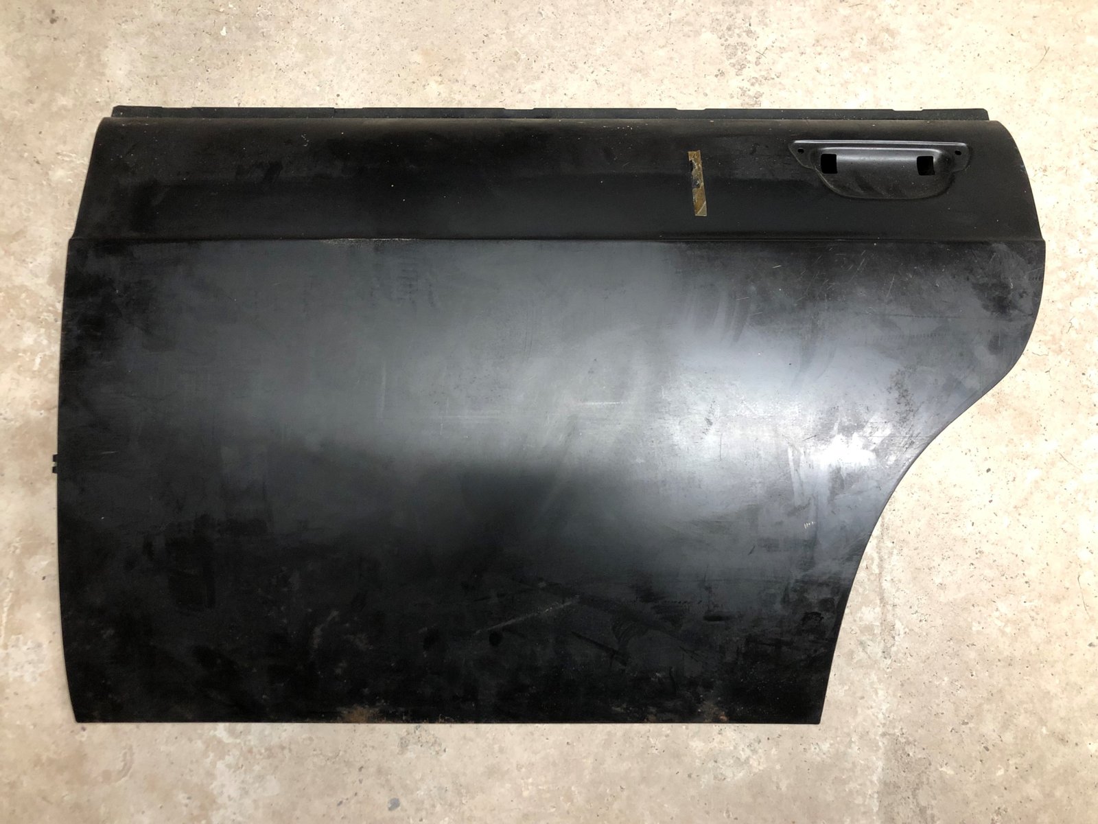

Not long after I bought the car, I started collecting the parts that I thought that I'd need for the restoration that I knew would be forthcoming. One recent jackpot was finding 3 NOS genuine BMW doors, and one very good used one to compete the set, as well as new suspension parts. I've decided on Bilstein dampers all round, and E12 M535i anti roll bars (front and rear) and front coil springs, and stiffer 3.3Li rear springs:

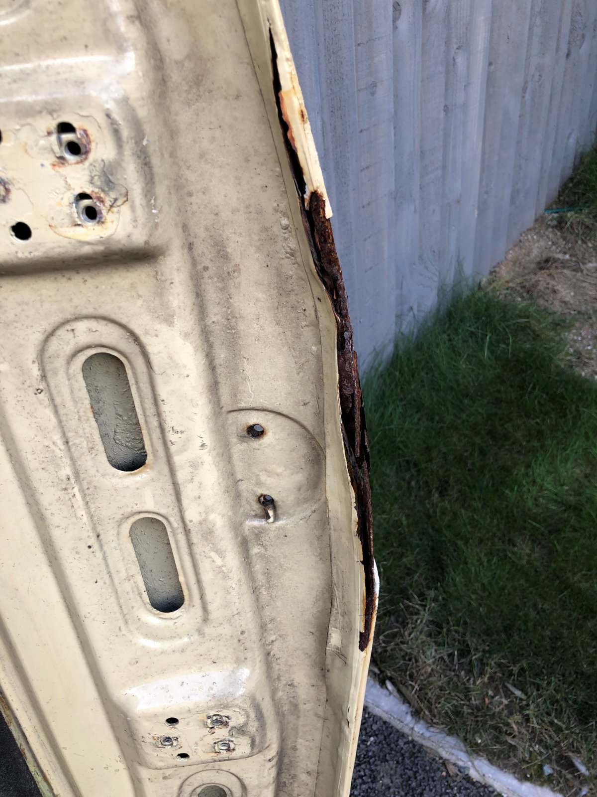

I must admit that I couldn't believe my luck when I found an excellent second hand bonnet that was being used by an art teacher to instruct her students on how to use different types of paint on different surfaces. Whilst it was covered in many layers of paint, it was in fantastic condition and was an absolute bargain.

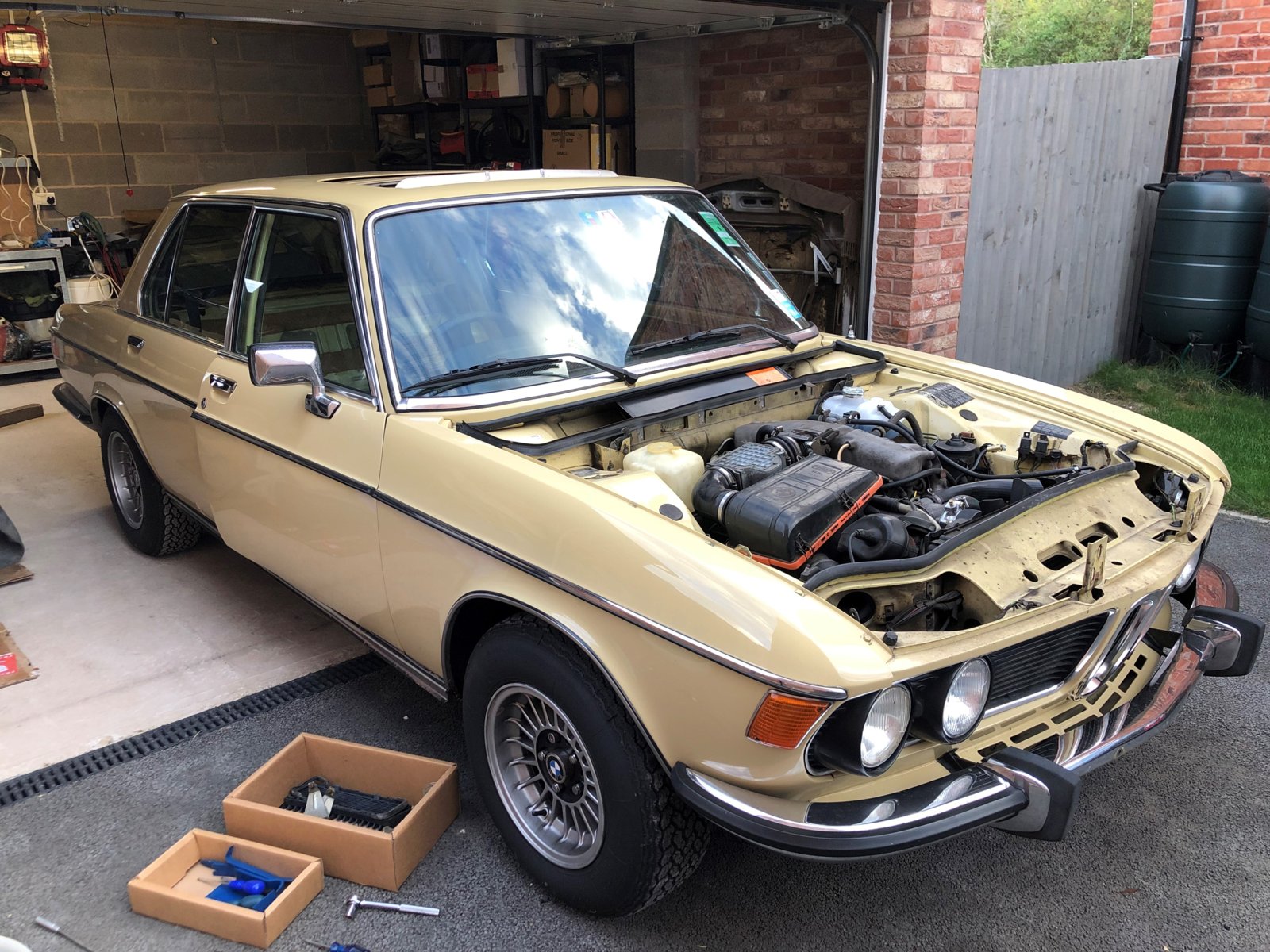

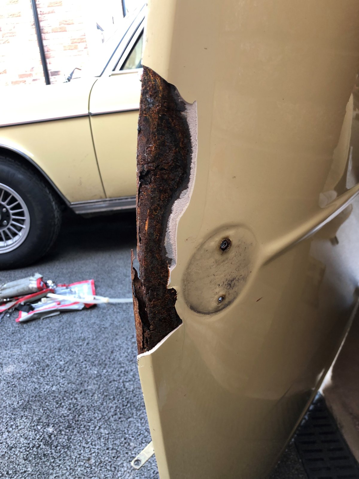

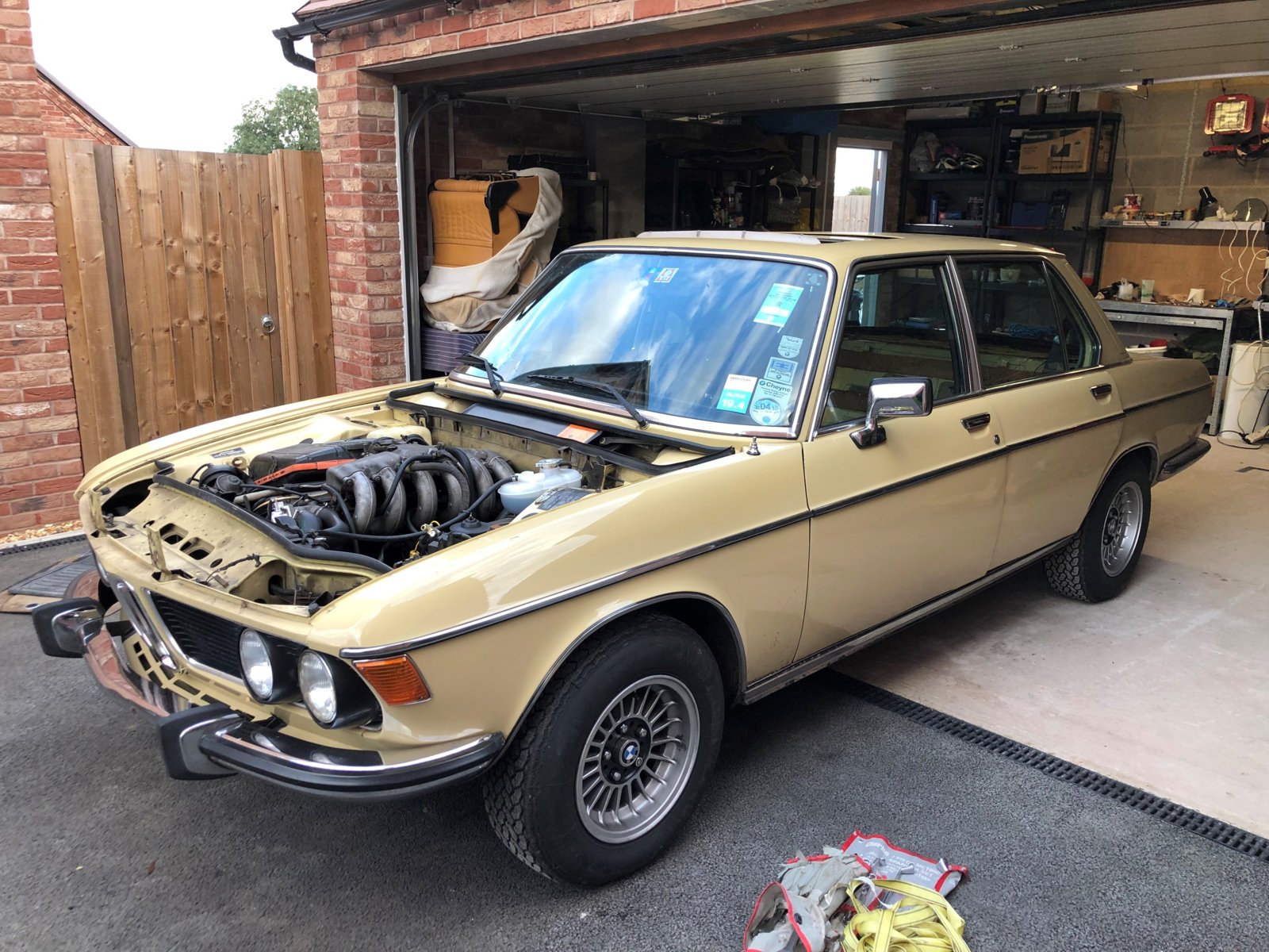

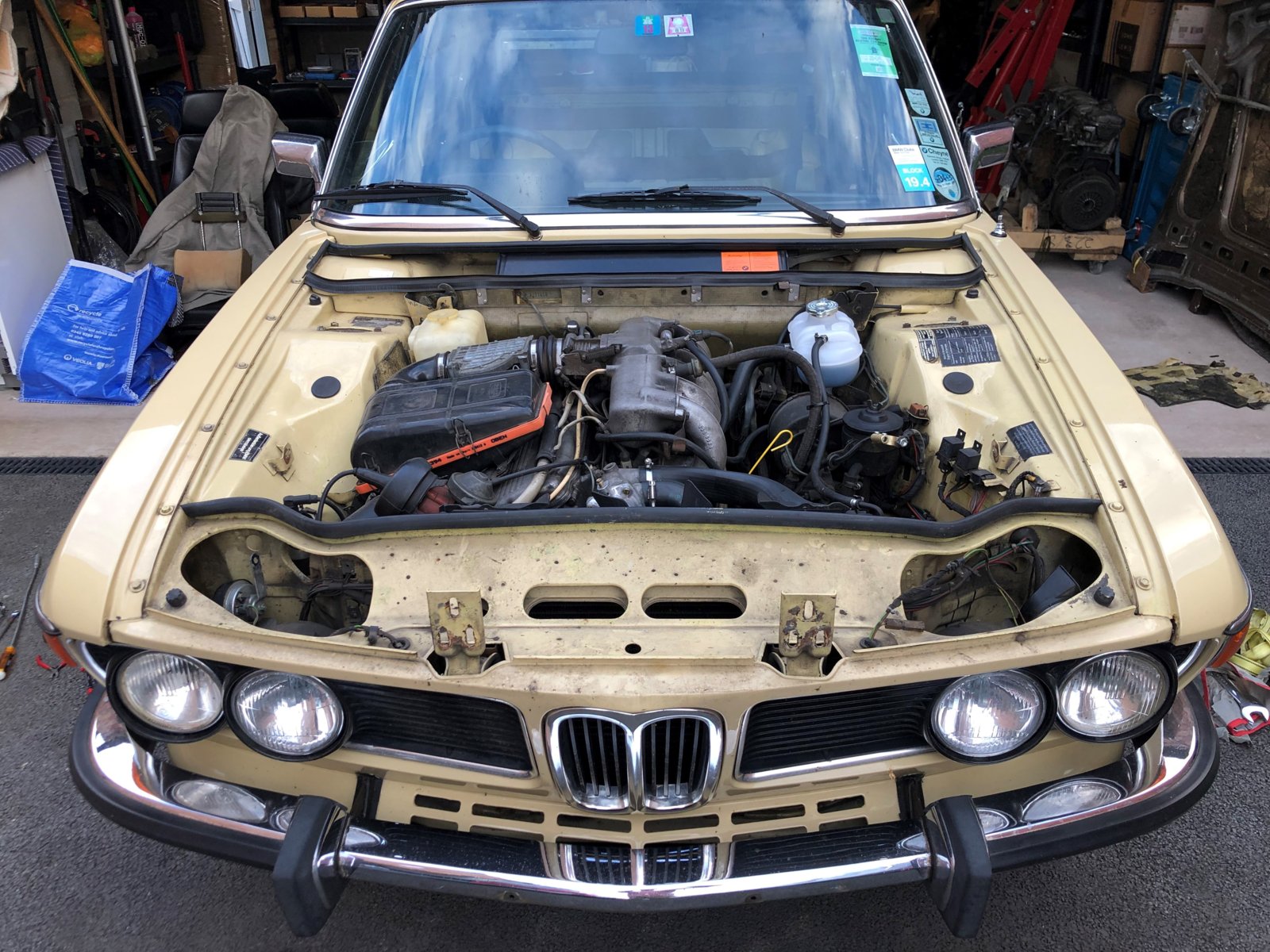

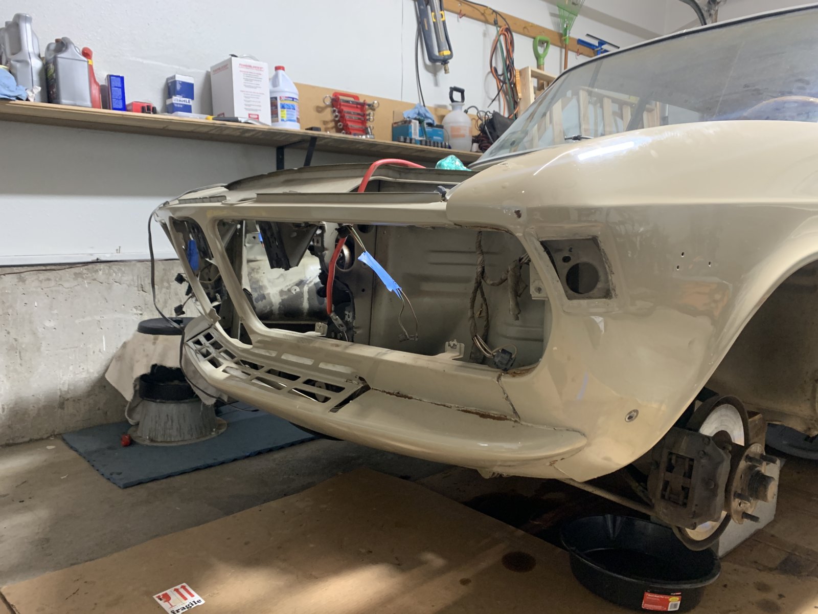

So, the strip-down began. I started this work off at home, with the idea that the car would go to the bodyshop for the more involved work. Whilst it actually looks pretty good in these photos, appearances can be deceptive....
You can see here why I was so pleased to find a really good used bonnet:

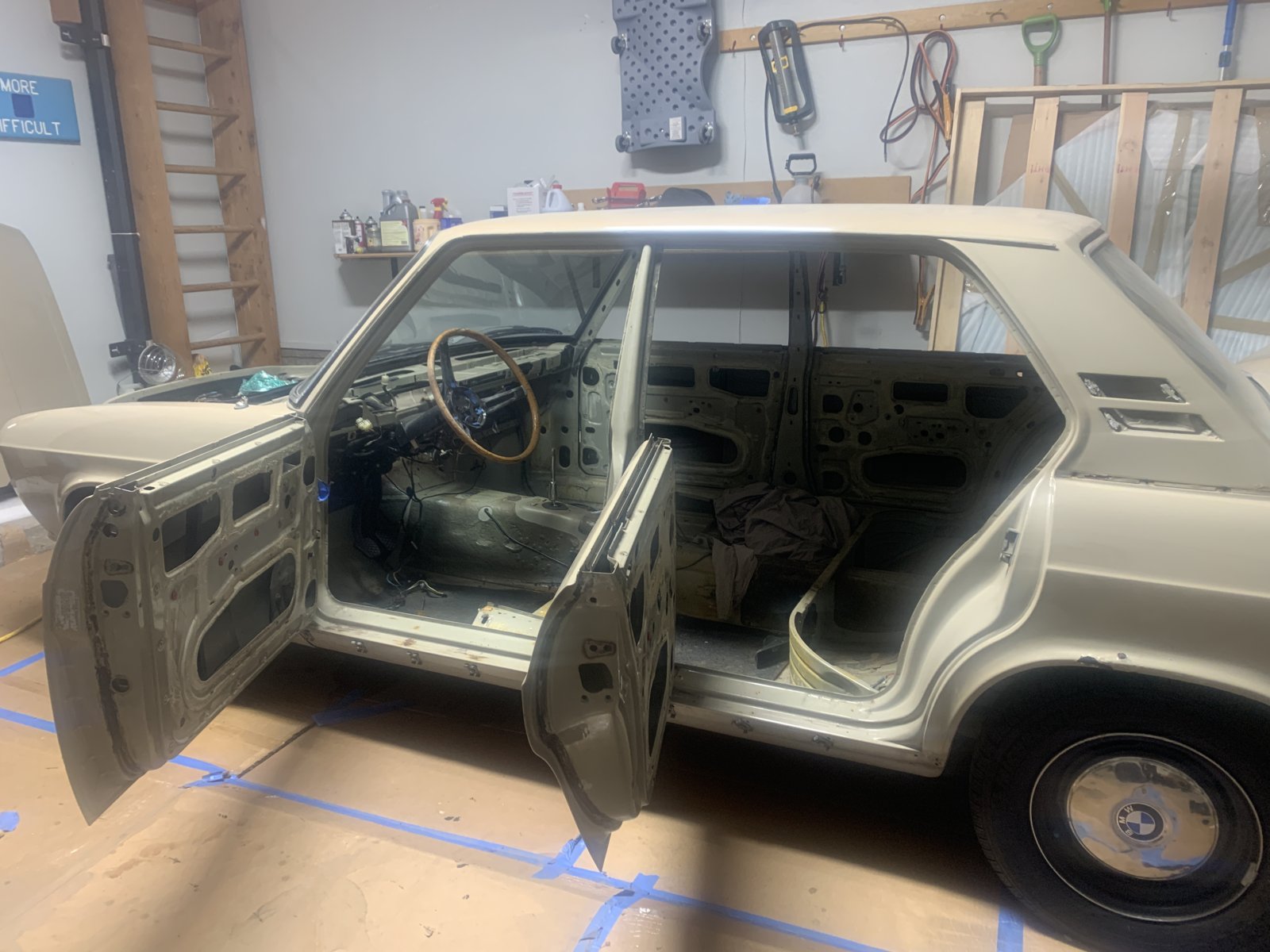

STATUS: Getting it down to mechanicals. Virtually no rust so far, but anything rubber ,plastic or cloth is dust. Put in order at MM for 3700 Rally M30 Engine,Ultimate 262 4 speed and Side Loader 3.15 Limited Slip. Says it will be bad ass.
Still undecided on wheels and tires. probably stay with 14's. Likely changing color to Agave with tan leather.

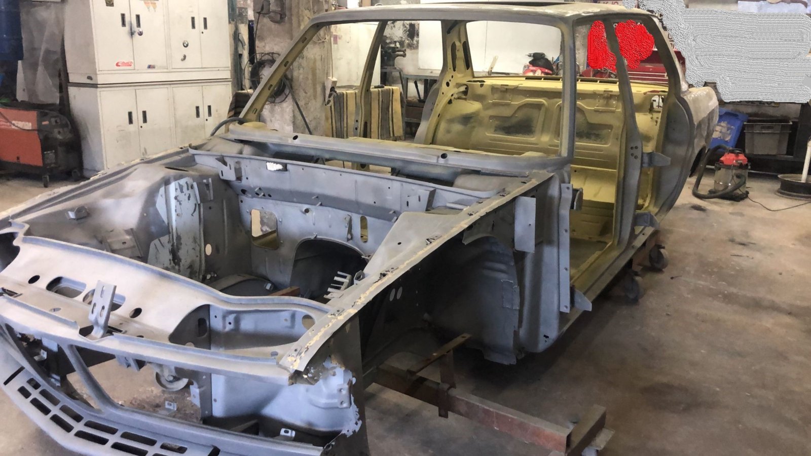

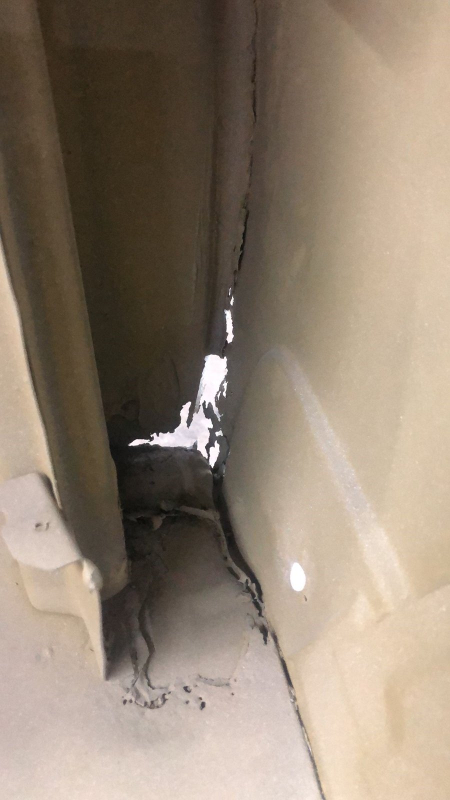

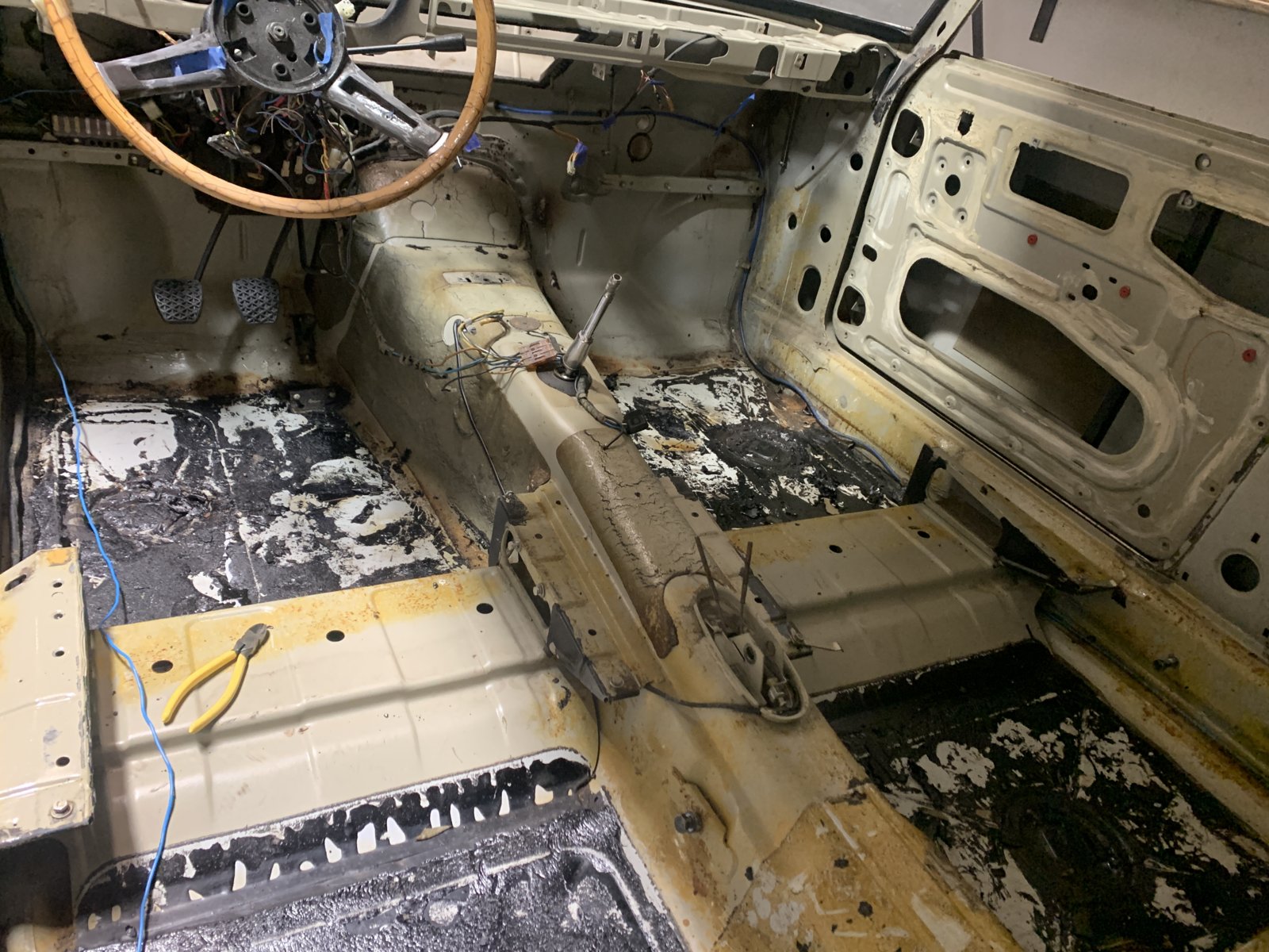

So, once the shell had been fully blasted we were able to fully examine the extent of corrosion as well as badly executed previous repairs. As you can see, the tops of the inner wings had suffered quite badly, but the inner wings themselves were actually pretty good

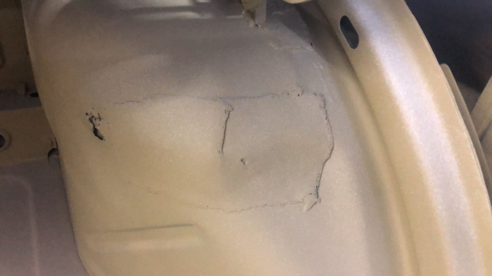

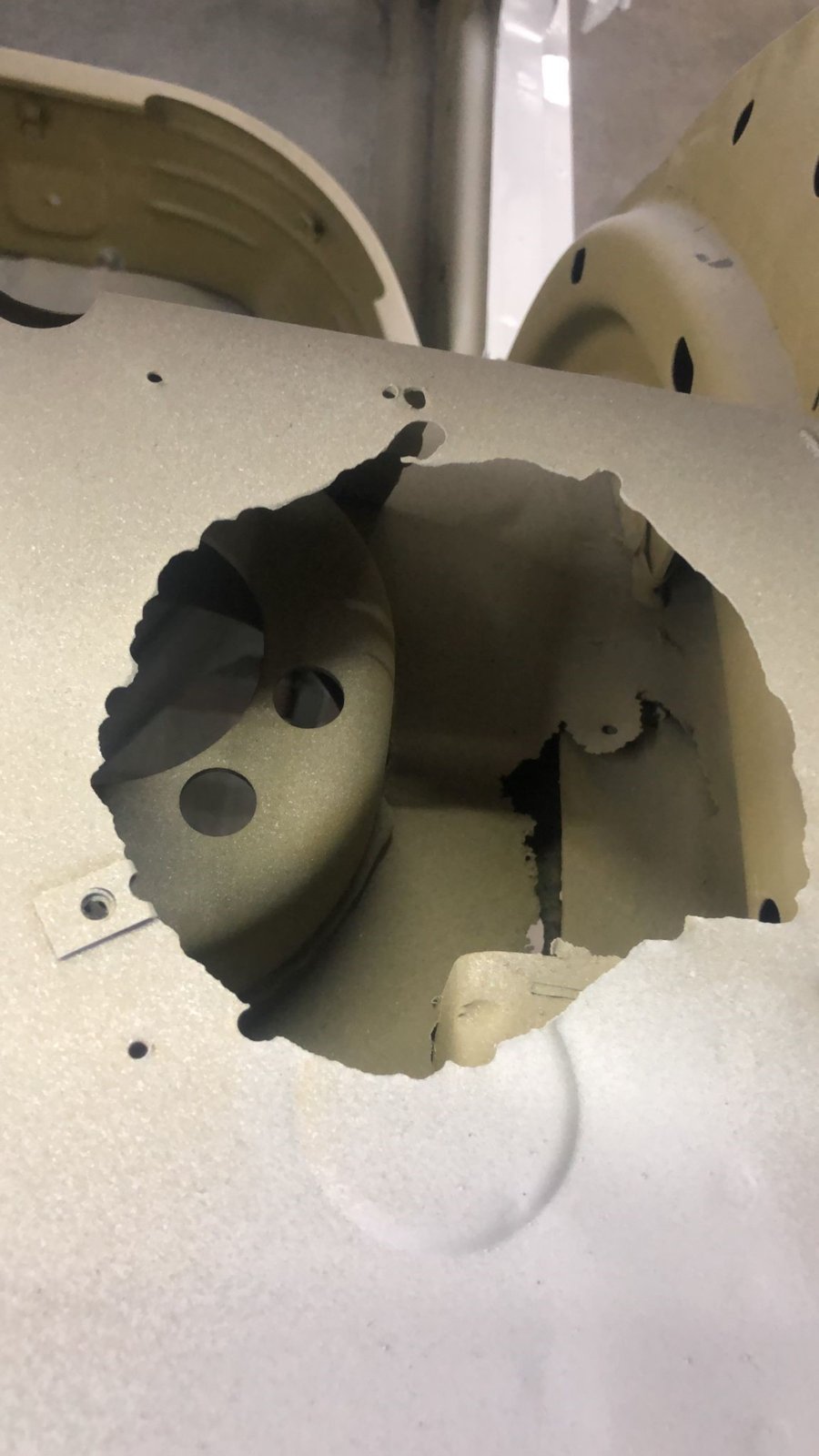

As with the kick panels in the front footwells, some Pioneer speakers had been fitted on the rear parcel shelf. Whilst these would have been the height of style and sophistication in the 1980s, they look really out of place now so they will not be re-fitted. The rear parcel shelf had been cut roughly in order to fit them, so this is another repair that will need to be made:

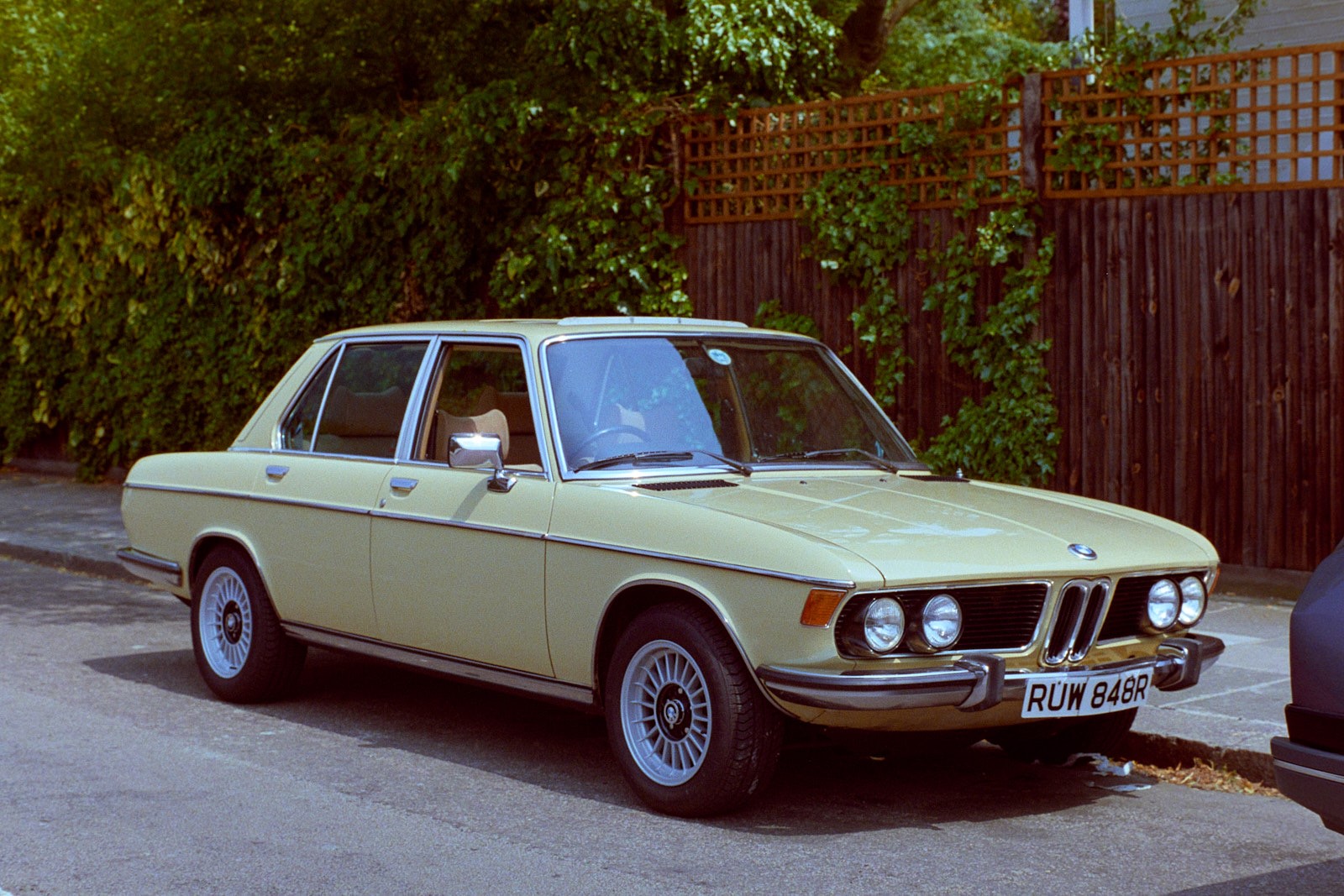

As I previously mentioned, I am very lucky that my car's long term owner and his son took many, many photos of the car during their 18 year tenure of ownership. This has been SO helpful in terms of identifying original features etc. These two photos from the mid 1990s are really helpful however; they are currently acting as my reference point for how I want the finished car to look. Note the 7x15 Alpina replica wheels. I still have these, as well as some 7x14 Alpinas with 205/70 Michelin XWX tyres, as well as a couple of sets of Mahle wheels. I need to decide on wheel choice but there are plenty of other more pressing matters to deal with first!
I love the look of the car here:

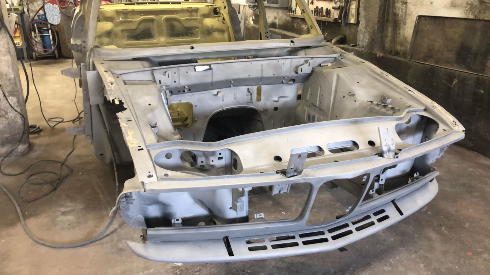

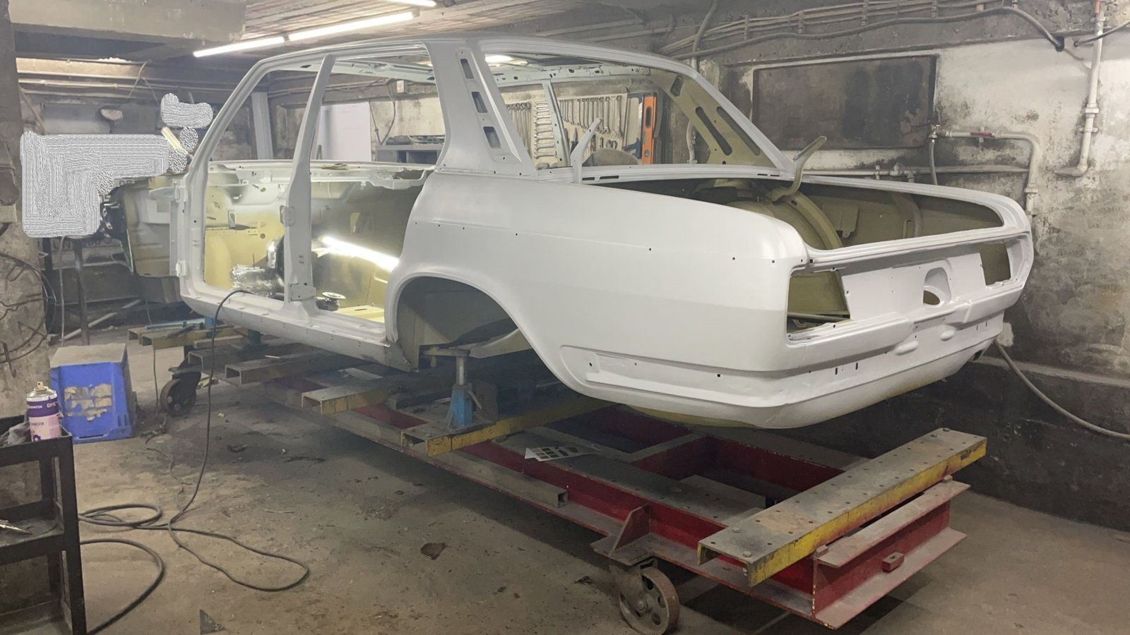

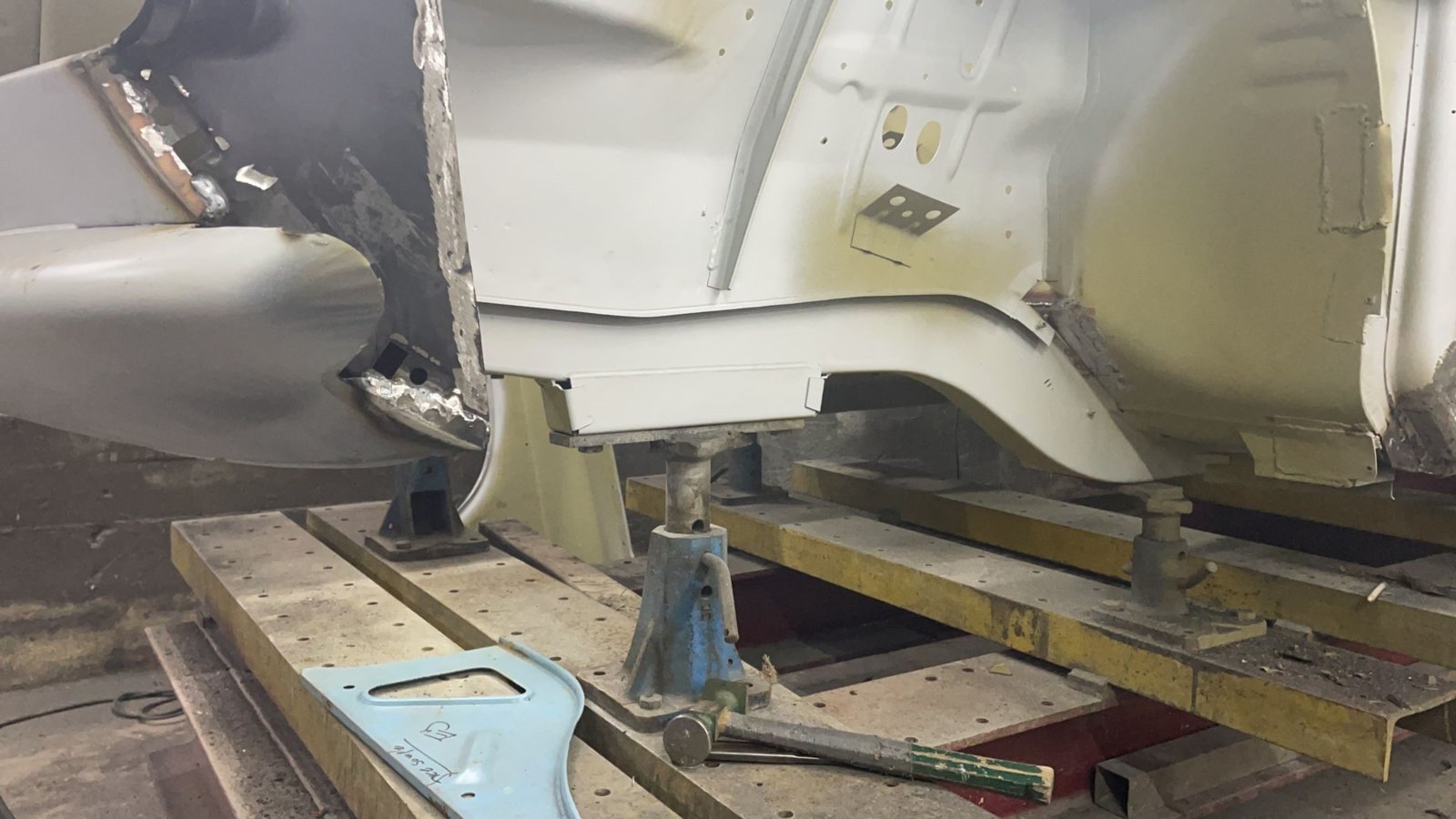

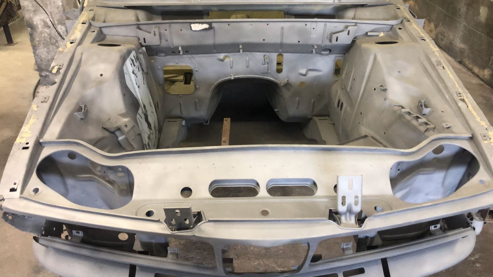

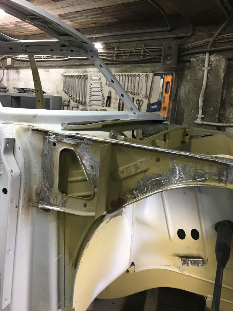

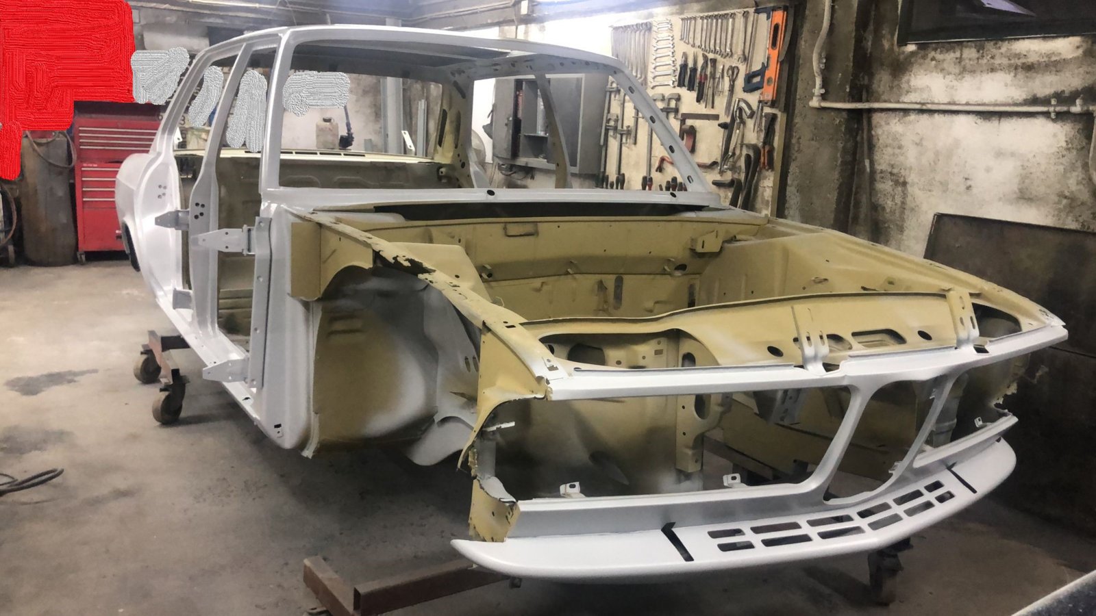

So I've realised that it's been far to long since I updated this thread, and in the meantime, lots of progress has been made. As I mentioned before, the car was mounted on a Celette jig and found to be exactly as per factory tolerances. I was really pleased with this, as well as the fact that there is no evidence of any previous accident damage. Nonetheless, there was some rust to deal with:

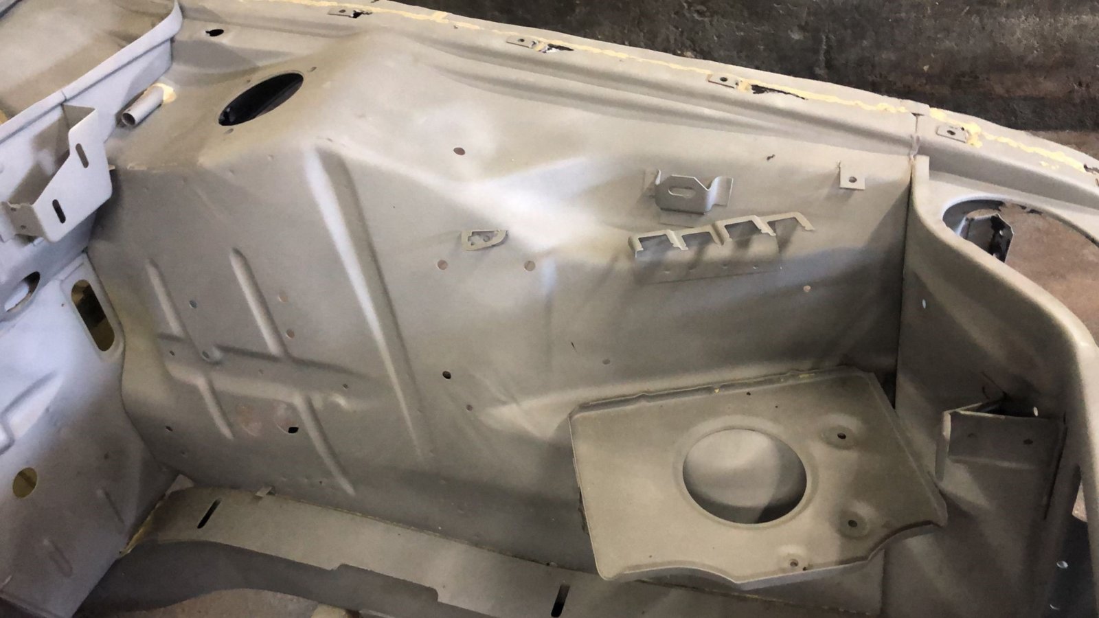

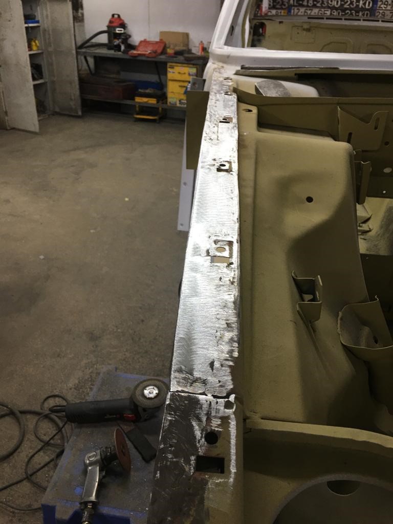

Firstly, the usual rust had been found in the inner wing support panel, so a new one was fitted:
Then, a new inner wing top was fabricated from scratch:

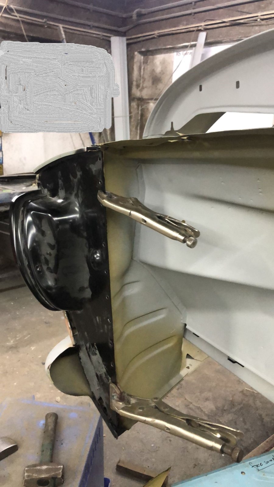

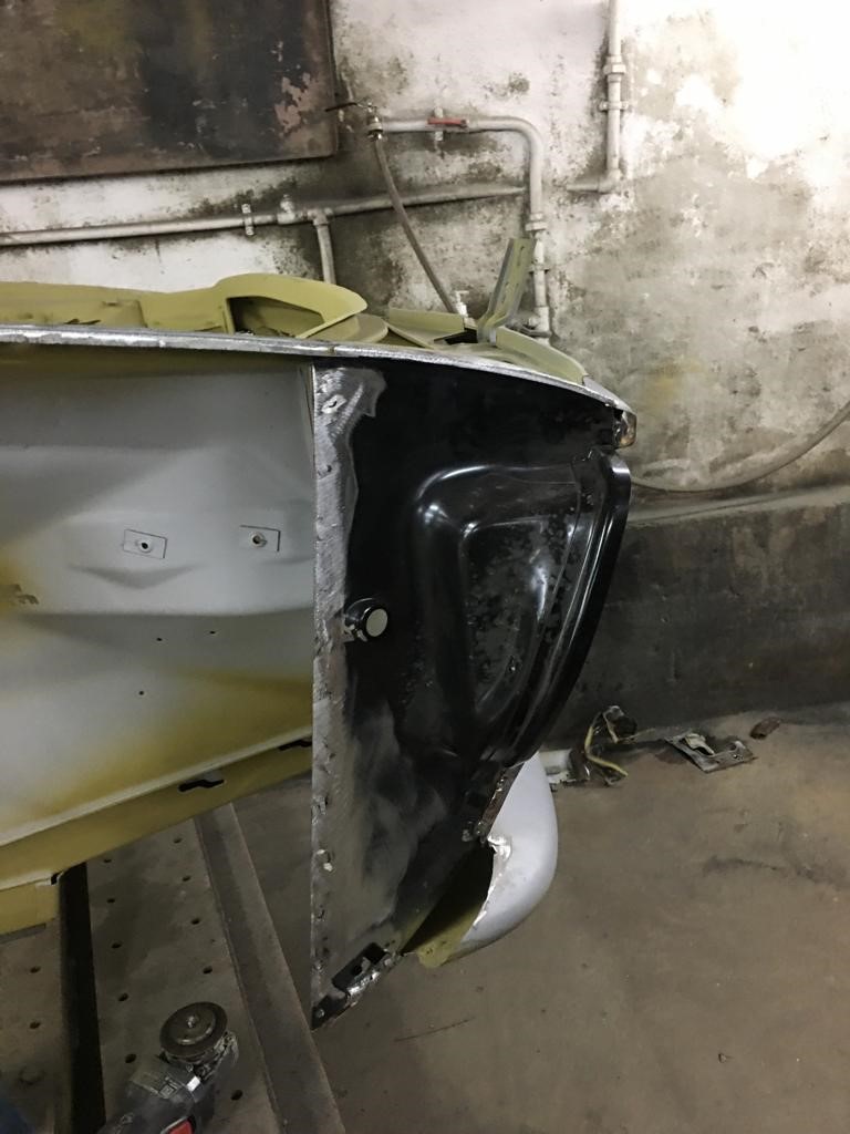

Unsurprisingly, the headlamp bowls on either side had rusted out which is a very common E3 weakness, due to the fact that dirt and water thrown up be the front wheels collects here and starts collecting in all the nooks and crannies. Fortunately though, these panels are still easily available new:

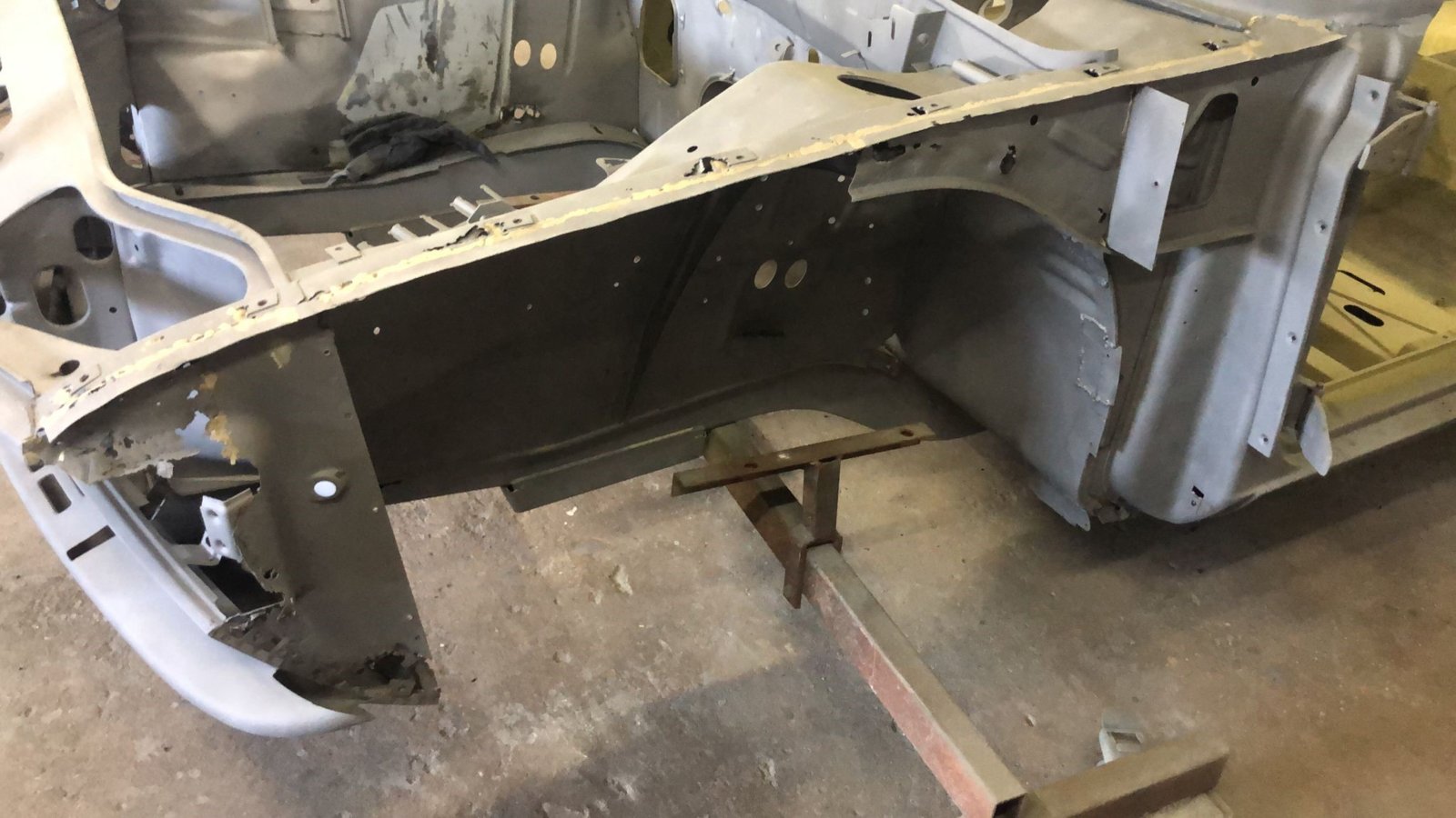

Quite a lot of work was required in the passenger side wheel arch area. You can see evidence of previous poor quality repair work on the right hand side of the photo; it looks a bit like a welded patchwork quilt:

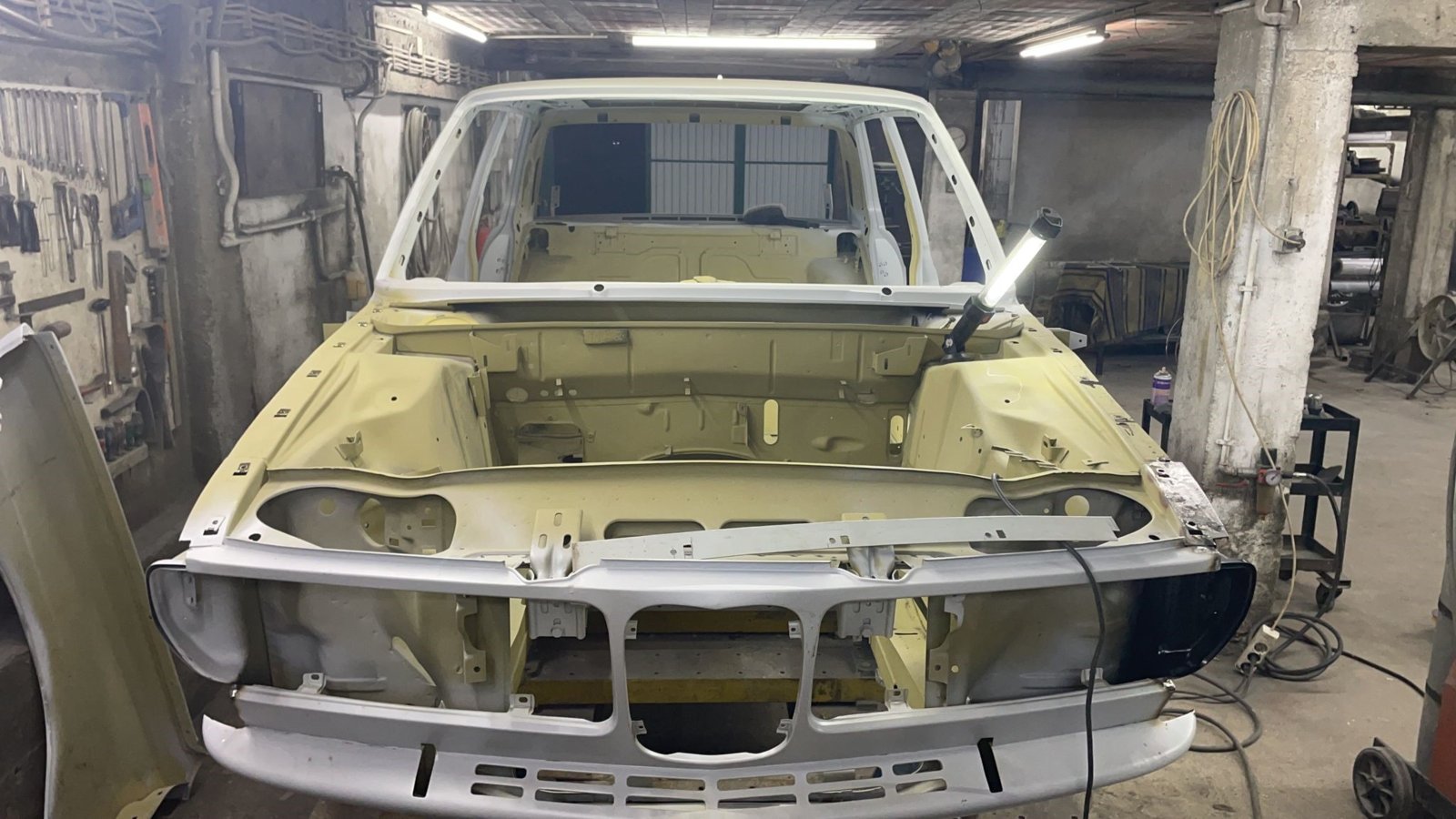

So, after a lot of time and effort, the front of the car is beginning to take shape:

Nice job! Celette is a useful tool (?)
I am preparing the restoration of a e9 and wandering if I buy a second hand Celette.
I think they come up for sale every now and again. The jig is one thing, but the specific mounts are another thing to find. But yes, a great tool to check that your bodyshell is straight and true.

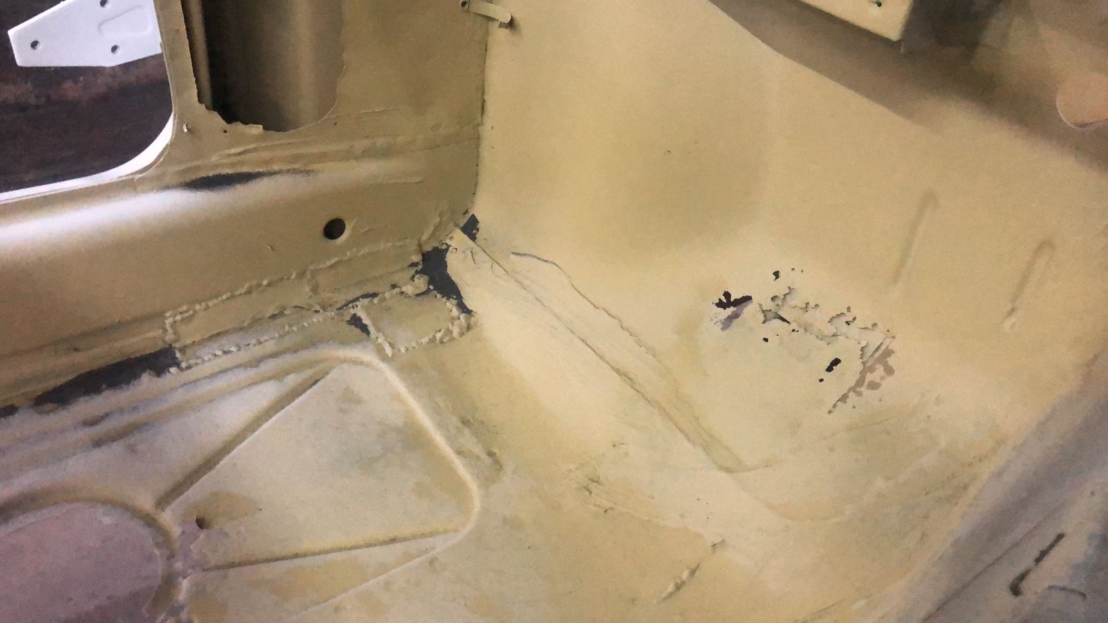

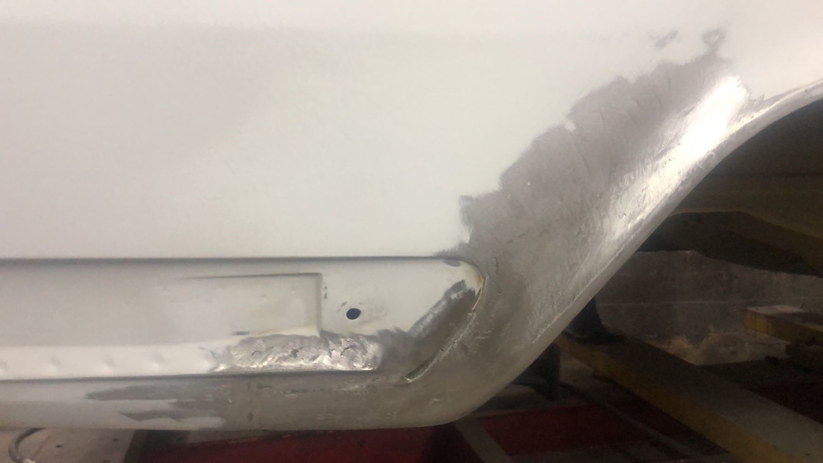

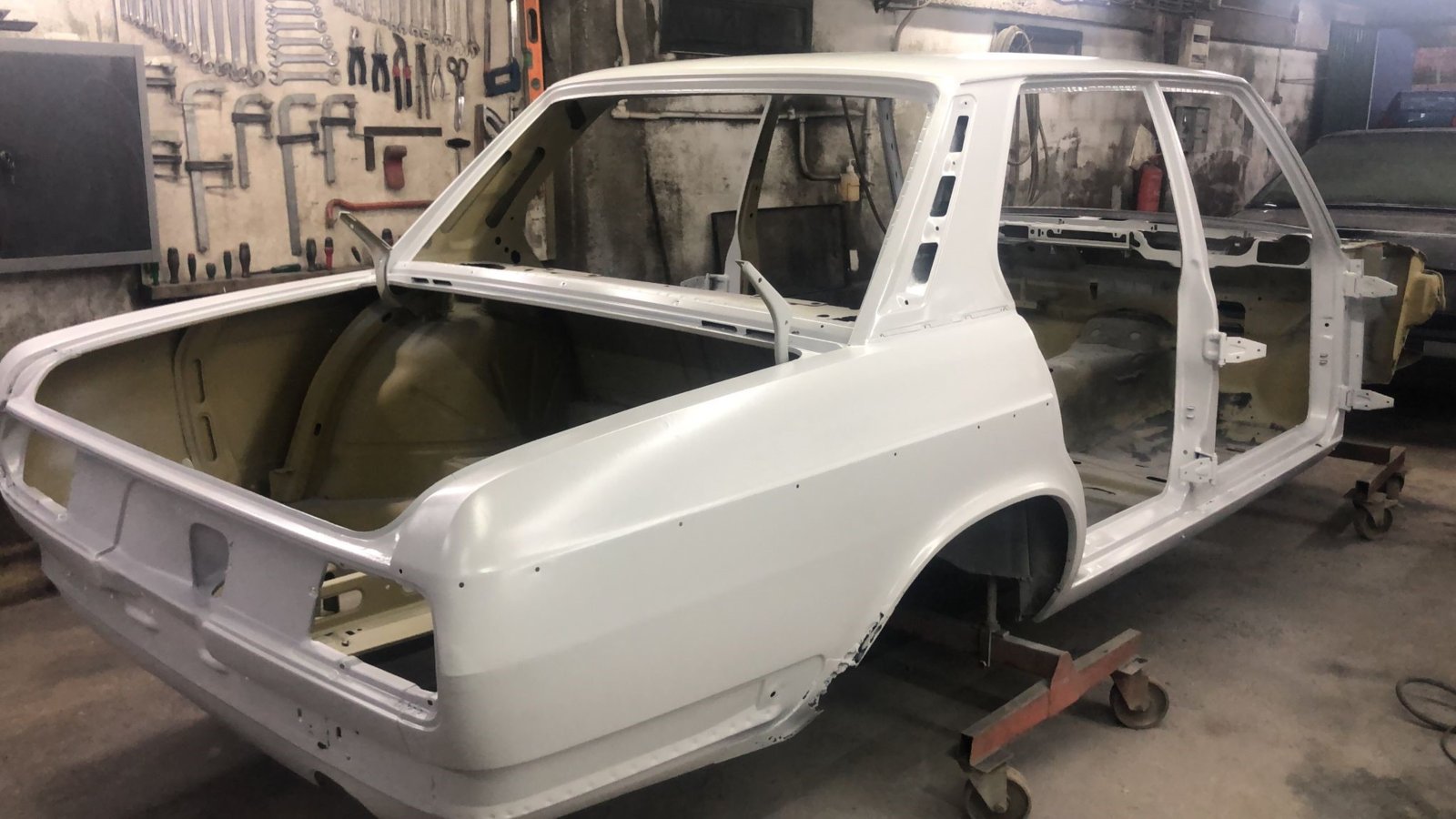

So, the front of the car was coming along really well, so it was time to turn attention to the rear. I think this is where the worst of the previous repairs were carried out, so things got a bit more involved.

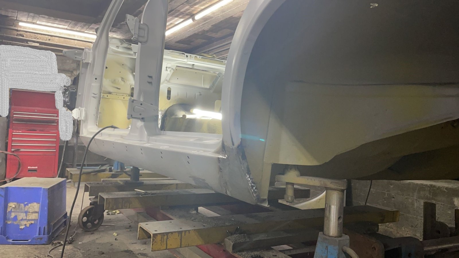

Very fortunately, the lower parts of the rear quarters were very sound so they didn't need any work, but the edges of the arches and the ends of the sills did:

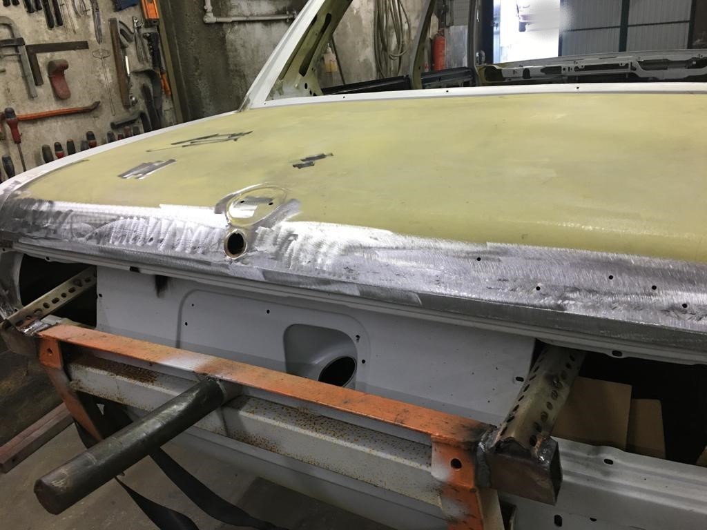

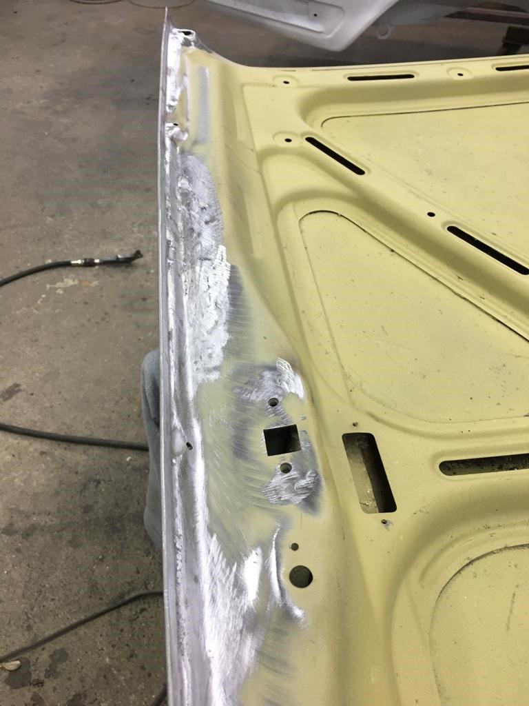

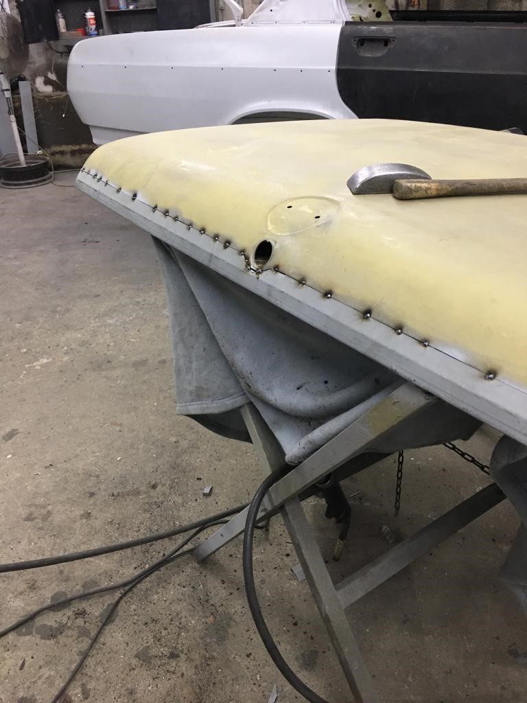

One thing I had started to notice was small areas of bubbling rust on the bootlid. This is a notorious E3 rust trap, and as is often the case, once you see bubbling on the outside, things inevitably are not good on the inside. I hunted high and low for a NOS bootlid, or at least a good used one. I couldn't find a decent one anywhere; those that were for sale were no better than mine. So, some fabrication was going to be needed:
