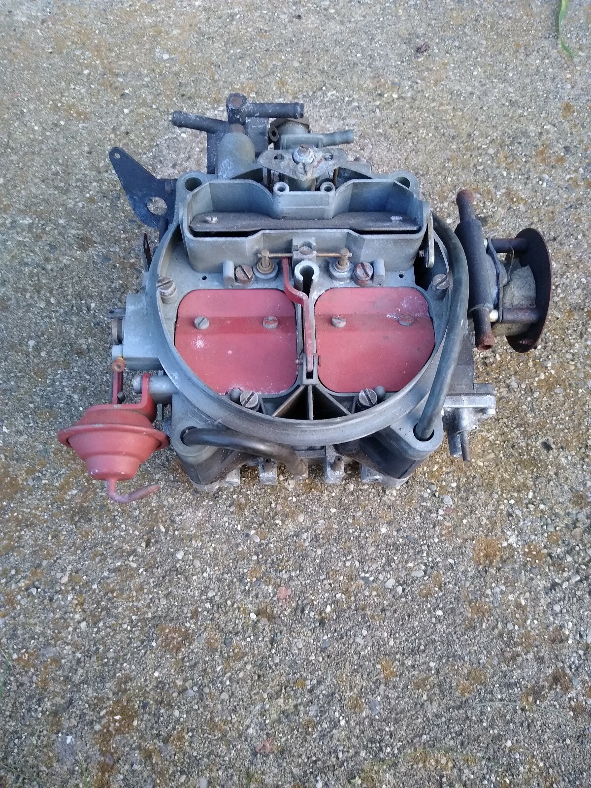

One big problem with using a square bore 4-bbl carb on the spreadbore BMW 4-bbl manifold is the obstruction of the mixture path.
