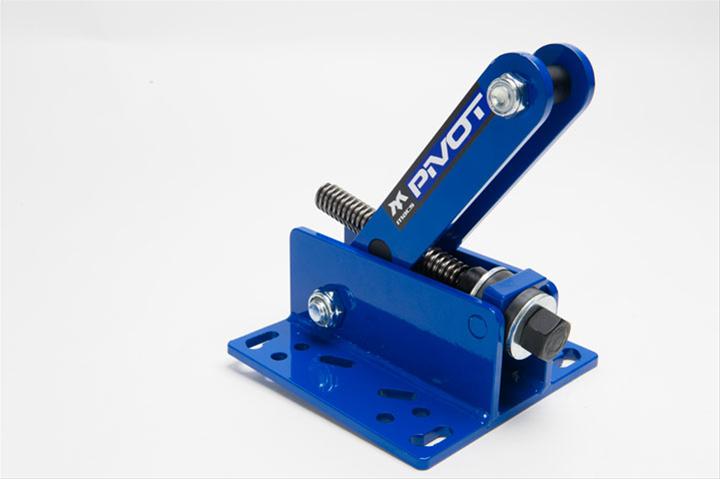

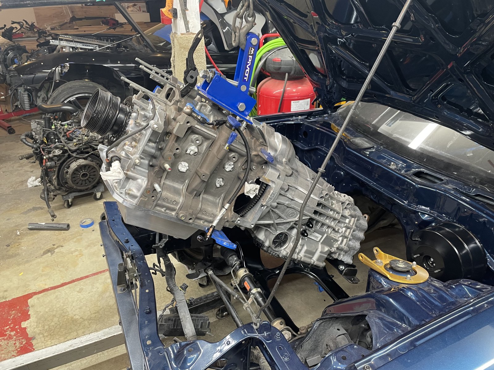

Might be tricky to mount up, but when my buddy and I dropped his new (admittedly tiny) rotary engine, we used a pivot tool. You just crank on the bolt and adjusts the engine angle, and can tweak as you go. Pretty nifty. Fortunately we have an ongoing tool exchange. :D
Yes that is indeed a Getrag BMW six speed DSG:
Edit - Link:

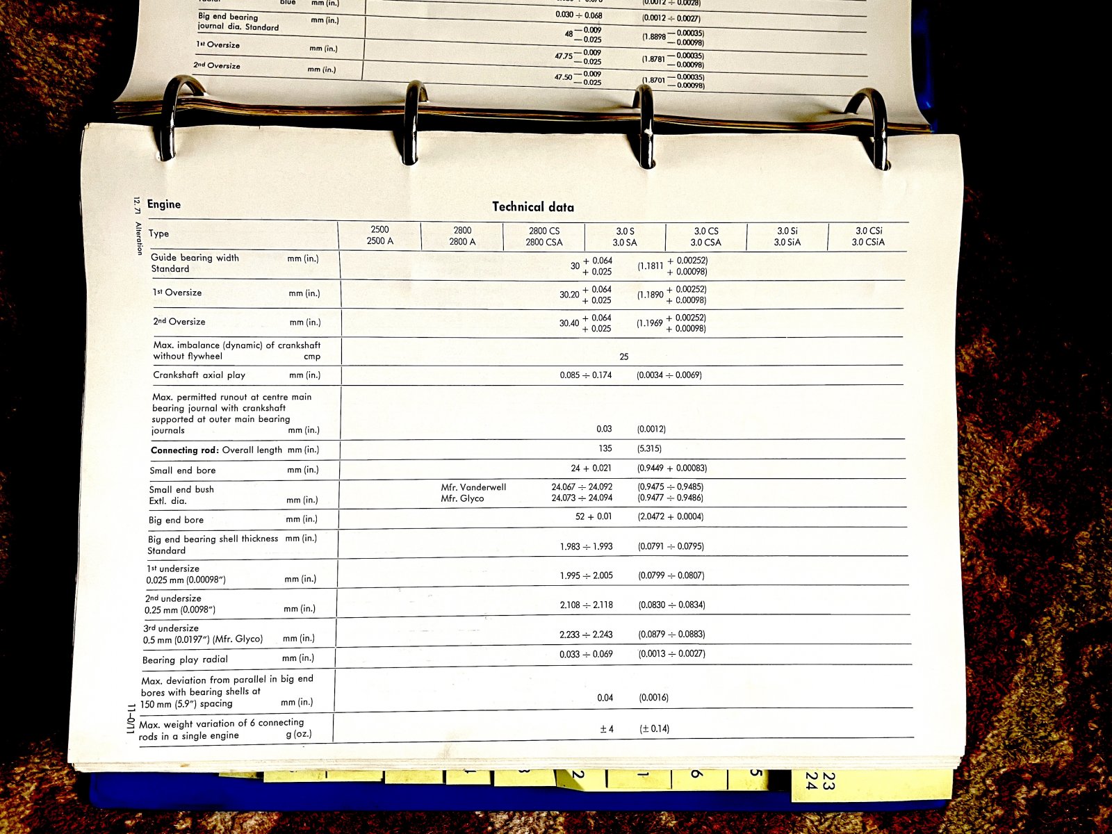

The Blue Book doesn't list a spec for con rod big end side to side (thrust) play. They just list the radial play which is the internal bearing clearance (crank journal to bearing shell)
There should be an official spec for thrust clearance and perhaps one of the M30 engine builders here have it.

If you find a spec, don't confuse crank shaft thrust (front to rear movement of the entire crankshaft) which is generally set when the crankshaft is installed...and con rod thrust, the side to side movement of each con rod on its crank journal.
