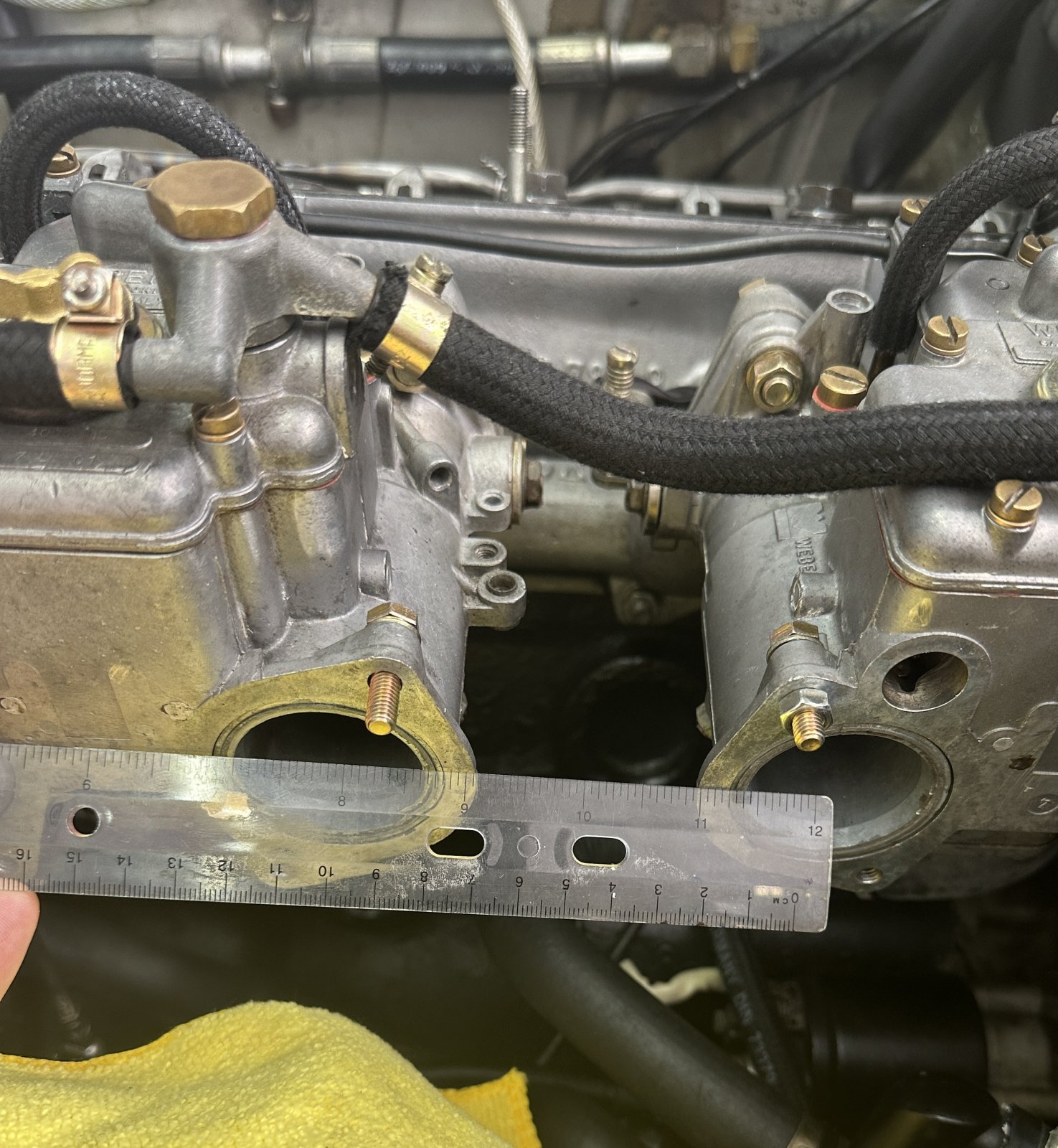

It’s not the depth thats a problem its the angle down from the spark plug hole. Its easier to move the magnet and camera around when it’s at the bottom of piston travel. But when I feed the magnet down the passageway of the head, through the plug hole, the angle down to the passenger side of the cylinder is proving difficult. I did turn the engine over in each cylinder while looking at the camera and saw nothing in there moving around. Am working on a vacuum attachment now. Will also feed the camera down the intake manifolds later. I’m wondering if the missing nuts on the carb inlets are a head-fake and I have something else going on entirely.

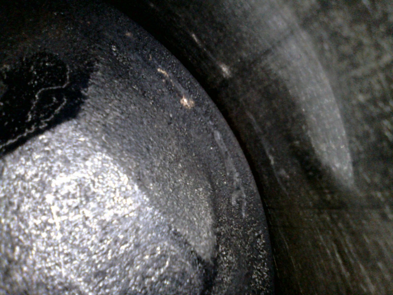

The only sign of trauma I can find is in #5 cylinder. In order for the nut to make it into this intake is for it to fall straight back for about 3.5 inches. Possible? I guess in a "magic bullet" sort of way:

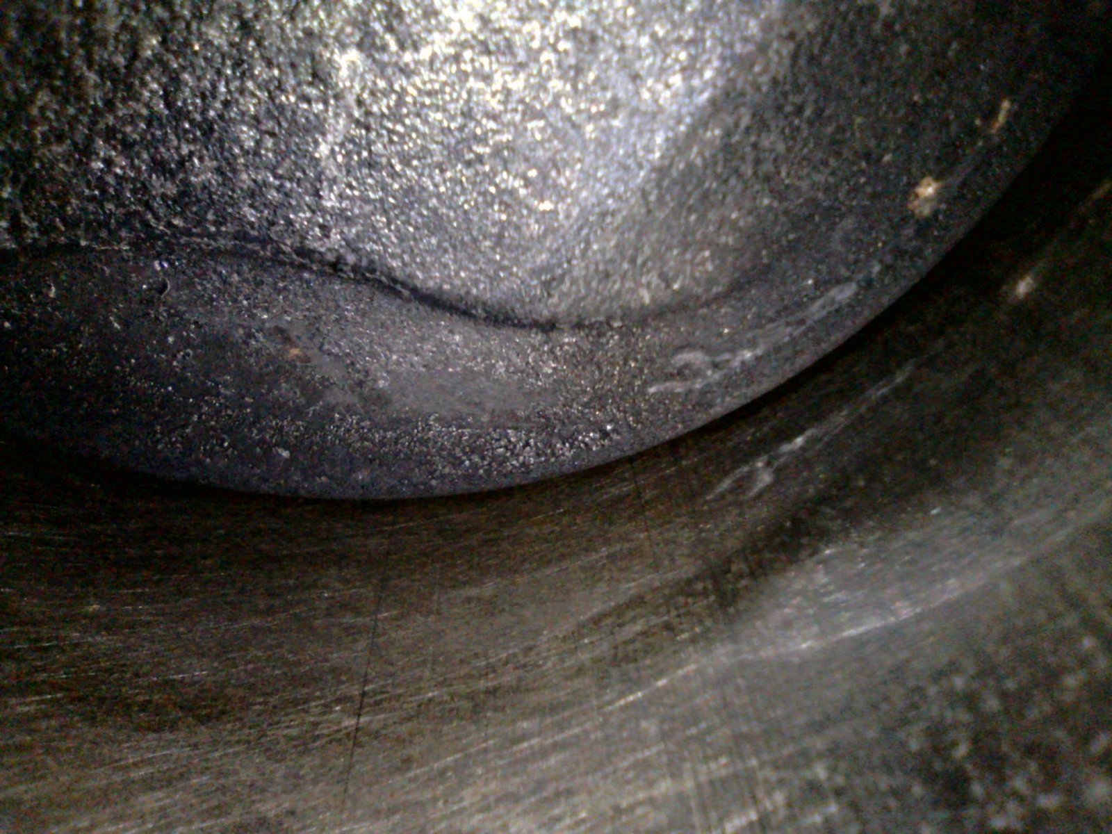

Here's a look inside, note the fresh looking marks on the top of the cylinder, and the condition of the cylinder wall. Keep in mind, I drove about 1/4 mile with the noise so I would think there would be more nastiness than this:

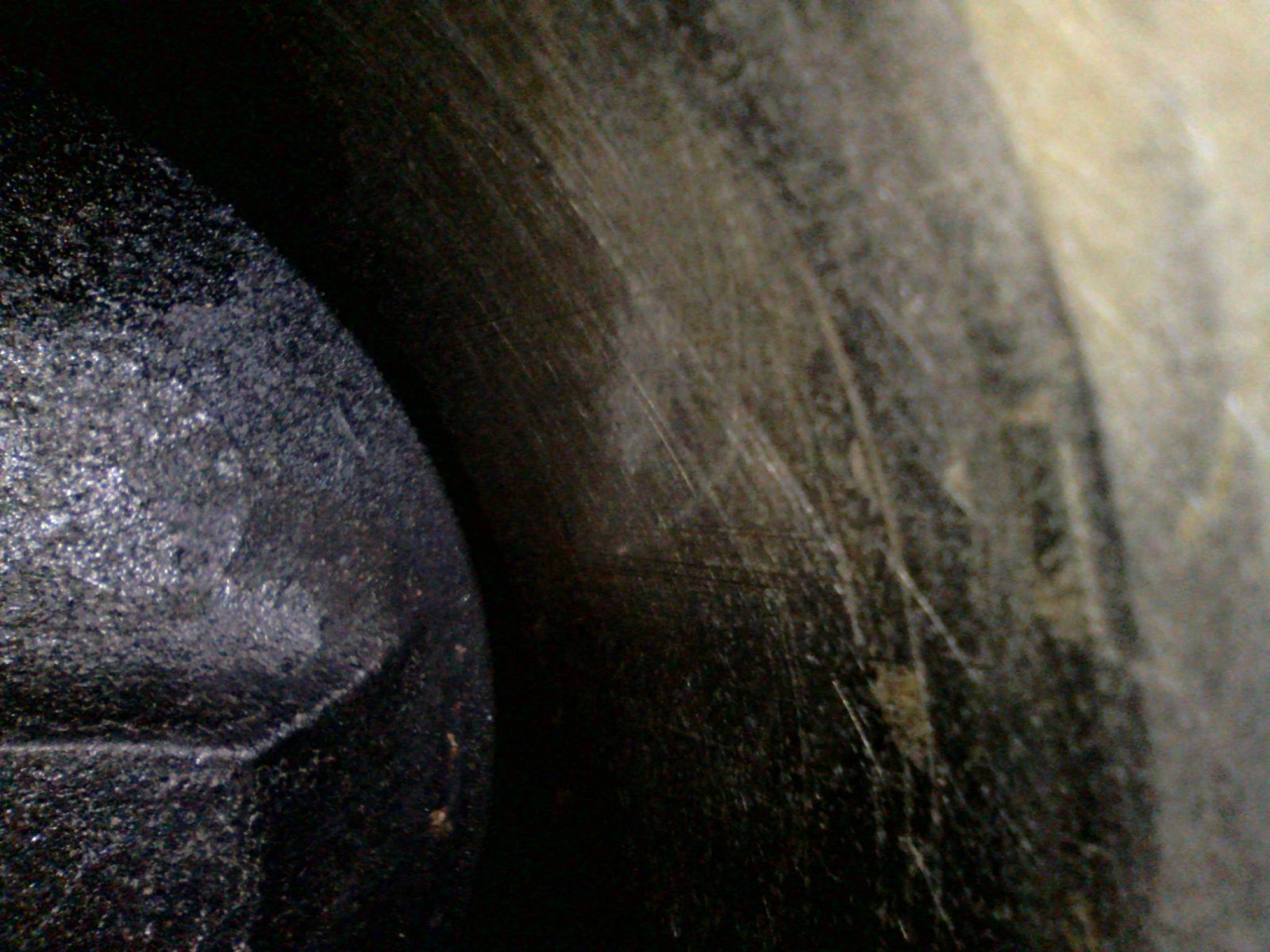

I have scoped and magneted it thoroughly with no luck. Maybe I chipped this with the magnet probe. Thoughts? It might be time to put the valve cover on and start it up again.
Piston looks more like a 2” scrape which would be hard to do with a loose bolt.

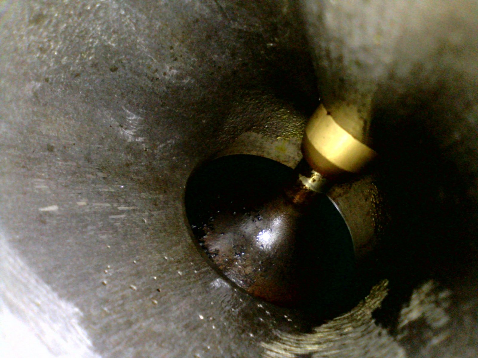

Can u position the bore scope so it can see the valves? How about turning the eng over by hand so that one intake valve is wide open and have a look down the carbs and intake at the intake valve seat at least a bit of it I don't see anything on the top of the piston that is hitting something, nothing embedded into the top of the piston.

I will do this for the exhaust valves tomorrow, I checked all the intake valves, they move freely and look like this:
