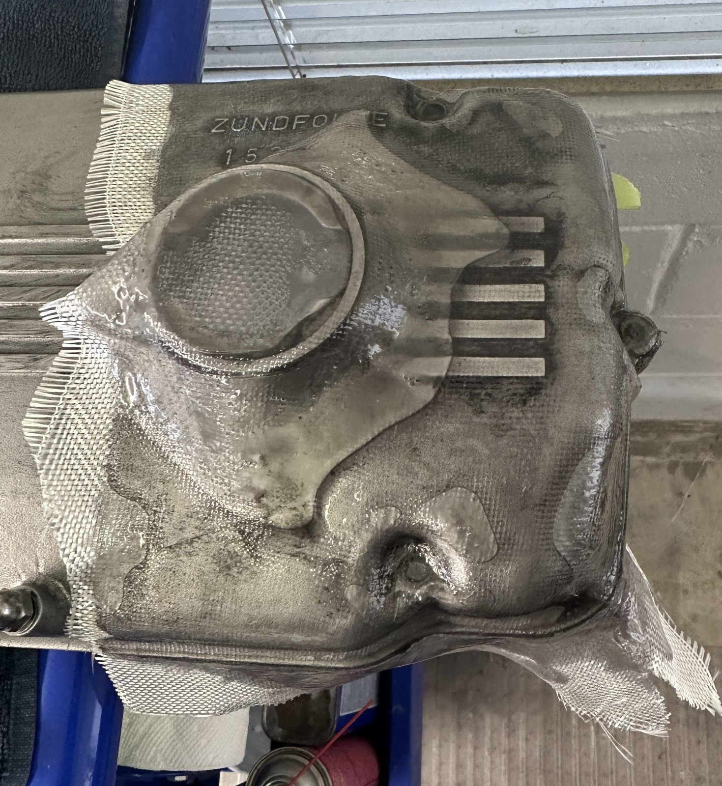

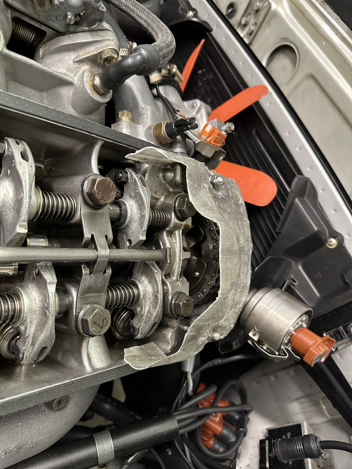

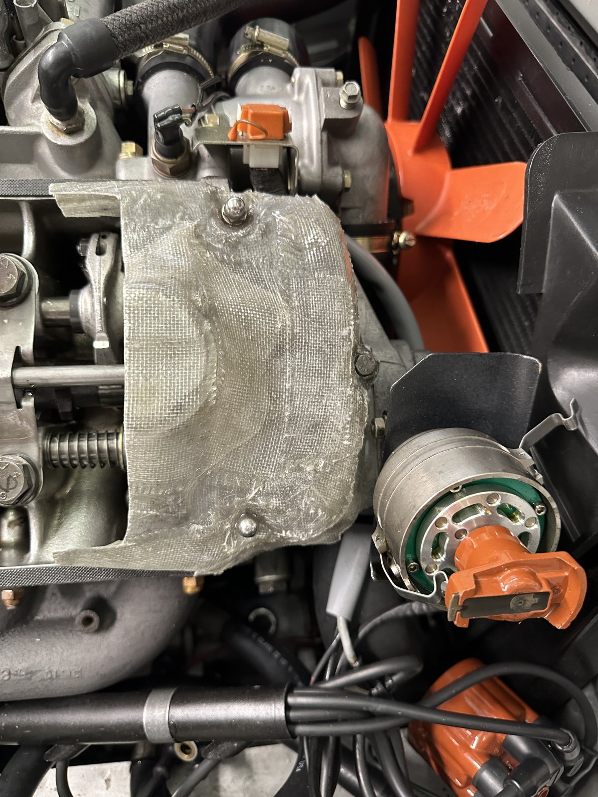

Yes I have been having nightmares about your mentioning this, I don't see any evidence of this on the piston tops but it is top of mind. I'm going to start it back up without the valve cover on after my fiberglass oil shield is ready.
