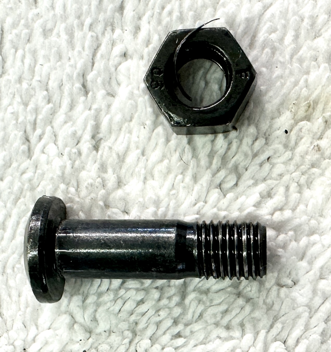

UPDATE: I decided to check valve clearances AGAIN and #2 exhaust valve was way out - I could slide a .15 feeler gauge through it, I normall keep the valves at .10 so I adjusted back to that. However I noticed when tightening the 10mm eccentric nut it wouldn't tighten up to my liking, like it was half-stripped. So I pulled it and found the nut to be stripped:
So now to replace this then try running it again.
Question: could a rocker at .15 make this much noise? It plays into the symptoms of not making noise until at least close to idle speed. Update in due course...

Good find (even if it is not the cause of the noise, but maybe?).

Just read up on this adventure...man, what a roller coaster ride! Sorry you're having to deal with this.. It does sound very much like valve clearance..the thing that gets me is how perfectly rhythmic it is, not at all like something bouncing around. Hopefully that clearance adjustment fixes it, but it very much sound like valve train noise, to me. Staying tuned to see if it's cured!
That bolt looks pretty beat up as well. It could easily be the noise, the concentric will move around and at some time , be in a position where it is at the right clearance and be quiet for a second or so. How does the rocker and rocker pad look like? Do you need a new bolt and nut? Heading to the US tomorrow AM and could send a couple out to you Let me know

I've checked the sprocket and chain guides which are new from my piston job a year or so ago. @Ohmess I believe you are referring to the tensioner arm which yes, the first time I left the original in, then when I did the chain guides I altered one of the new crappy ones per Don's suggestion to get it to fit the tensioner piston angle correctly. I put a new nut on the eccentric bolt and it is tight now but I went ahead and ordered genuine BMW eccentric bolt and nut for the long term. While I wait for those I will start it up tomorrow to see if the noise is still there or not.

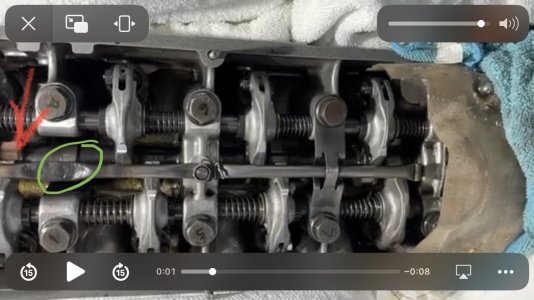

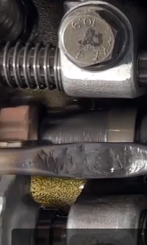

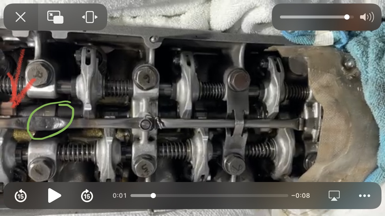

Is the cam lobe on #4 exhaust darker than the others? Don't see as much oil splash on that one also.
Why is your oil spray bar , all beaten up ?
And then what is the rusty or copper looking item moving around
Is it possible that your oil spray bar is blocked and due to lack of lubricant something is slightly seized on the rocker shaft ?

You can go to "settings" in the last video and change the playback speed to .25. To me, it is clearly going with the valve train.
Maybe push hard on each rocker while the engine is running and see if you can find the offending one.
Why didn't I think of that!
Slowing the video down is interesting. It does seem like it is on pace with the valve train and one of the exhaust valves is right in time with the knock. Reality is that a stethoscope (even long screwdriver or rod up to the ears) might help to pinpoint.
