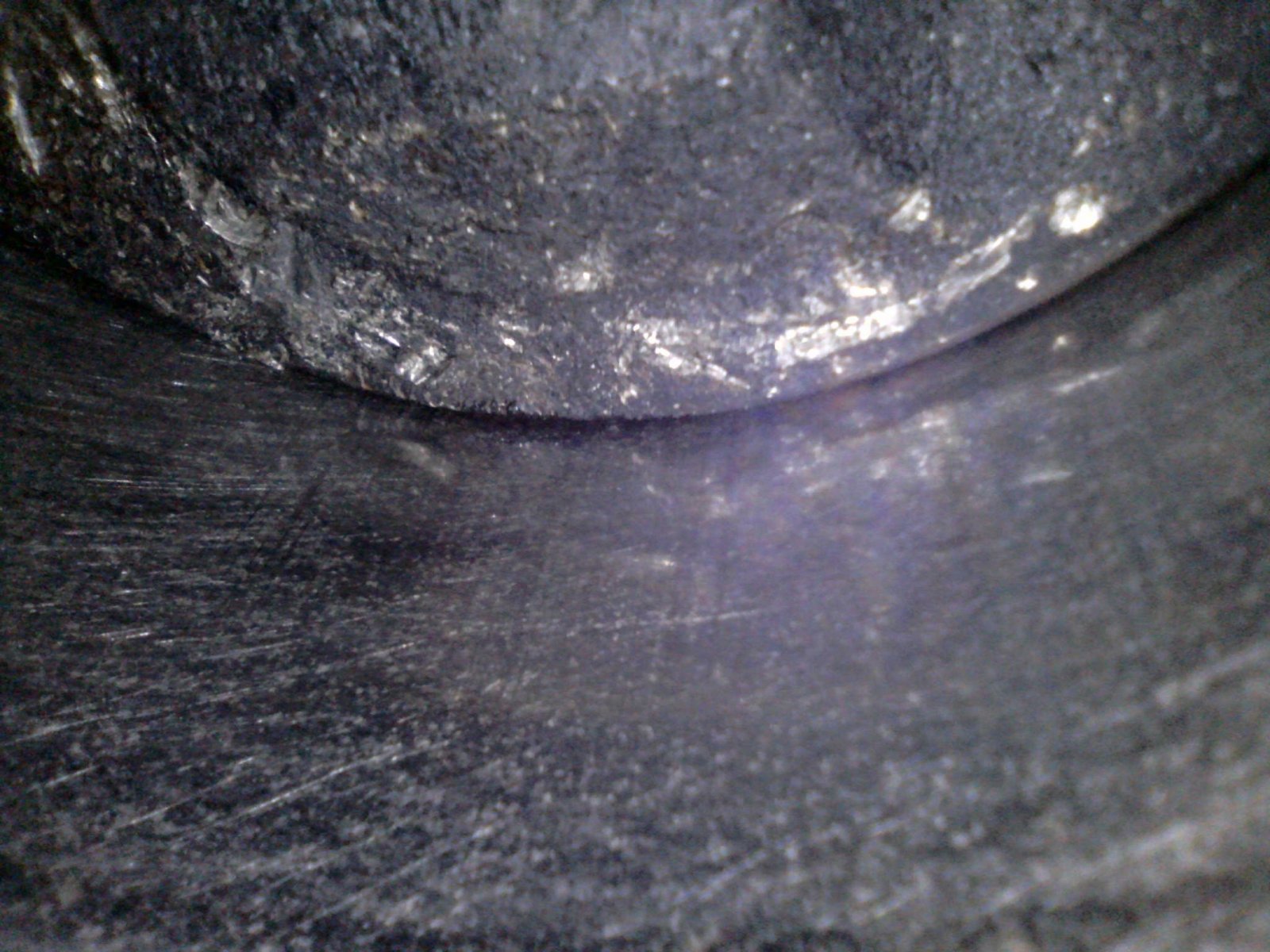

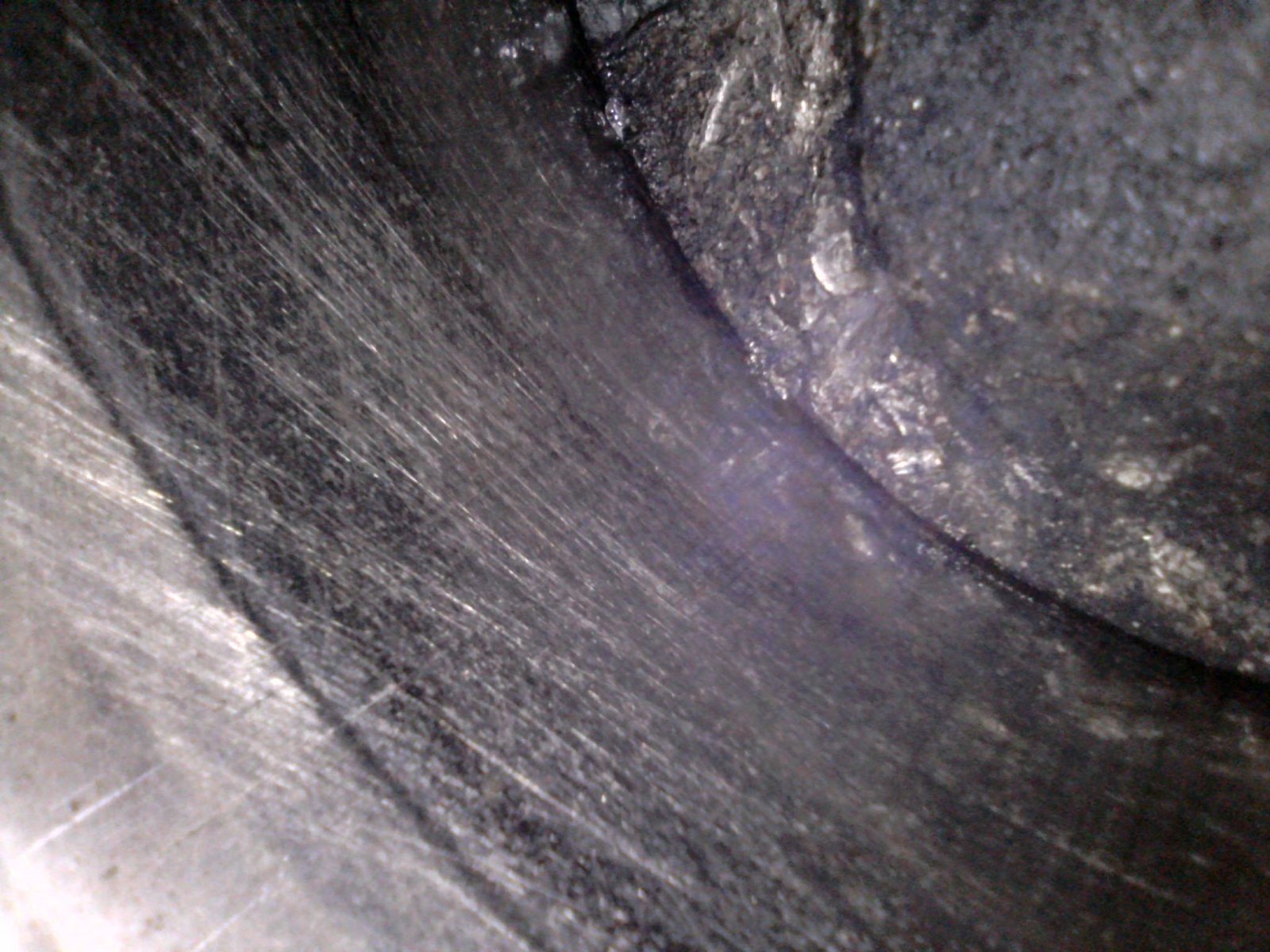

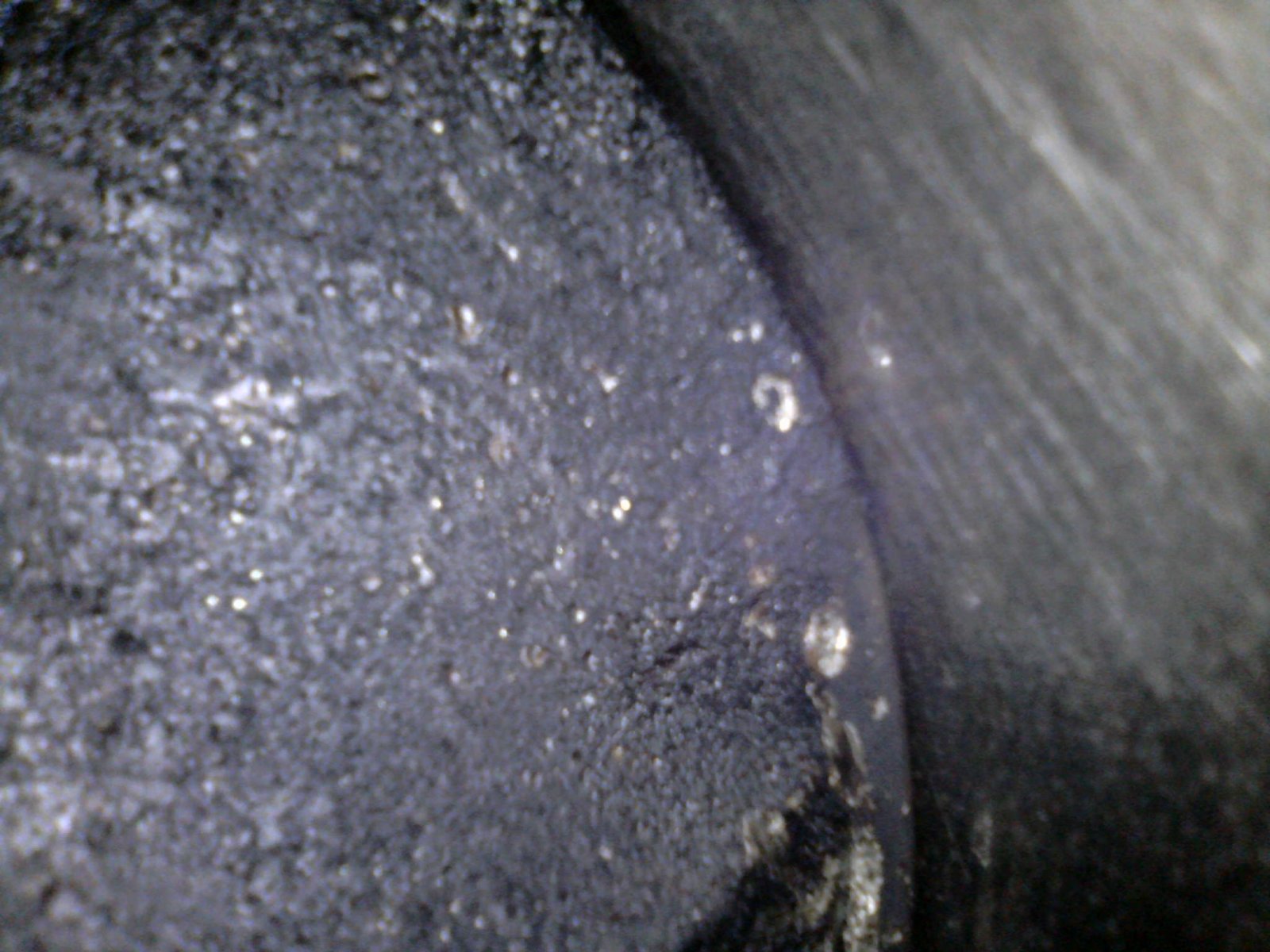

I scoped the cylinders again today, I must have missed this (or made it worse during the diagnosis phase) but cylinder #2 is showing signs of trauma:
