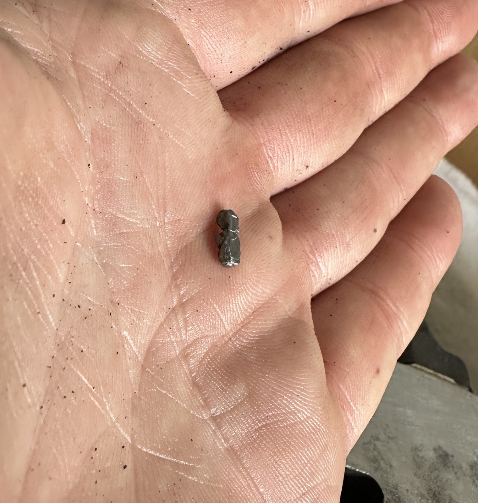

So the good news is it wasn't an m6 nut from me leaving it on a carb and falling in the throat, but a piece of metal did get in while driving sans air box. So I feel stupid but not THAT stupid. All you bareback trumpet sidedrafters take note. Here's the culprit:
Piston:
and the head. Toast.
Fortunately I am in the trustworthy hands of the Man From San Fran. I will acquire a fresh head, and the block comes out next to rebuild the bottom and install new pistons. This concludes this thread, next up, the rebuild thread :cool:
