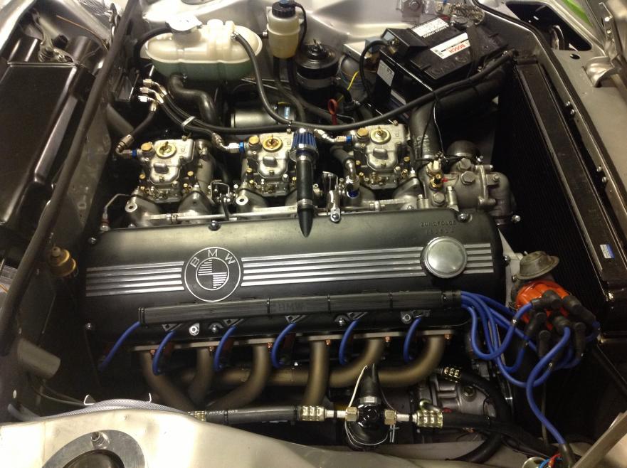

It's hard to say, they certainly look better! As for performance I don't have anything to compare against since once I limped the car home 10 years ago, my restoration journey began. I'll soon trade the joy of restoration to the joy of driving it! My first drive was last week and it was a thrill to say the least! Here's a pic of the nearly complete engine bay w/new Stahl installed...

Beautiful. I had stahl headers on my 2002 with dual side drafts. This is just that must better. Jealous.

Sorry to hijak, but what is that cool looking fuel hookup system you have for the Webers?

Nice engine room Tom, I'll add, what fan are you running?

Thank you / fan / fuel distribution
Thank you all for the compliments...
@Nicad: I have to thank SFDon for the fan suggestion. It's from an '88 E30. I swapped it in place of the original condensor fan. They're plentiful at PickNPull for $30/ea. Wired it up with a relay and coolant temp switch to trigger it - also tied it into my A/C circuit for dual purpose use. Working well...
@Stevehose: I went with a 3-port fuel distribution block in order to channel the fuel independently to each carb as opposed to running them in series. I felt running them in series could lead to a starved 3rd carb compared to first two. Likely not the case but I like the way it turned out and now feel like each are balanced and pulling equally.
@RSPorsche: Well said... I consulted with Korman (Carl) and also with Jere Stahl himself to come to the 1-3/8" option as being the best for my situation. If running DCOE45's and a hot cam, they probably would have leaned towards 1-1/2". They both said bigger isn't always better when it comes to headers. For spirited street driving, balance and throttle response below 3500RPM range, 1-3/8" was my choice.
