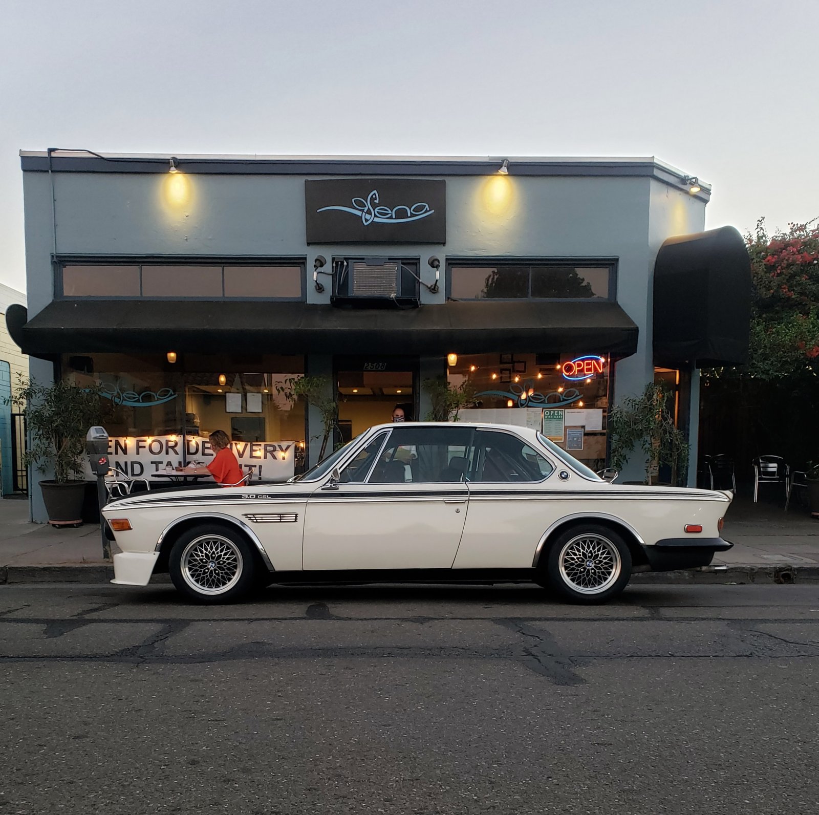

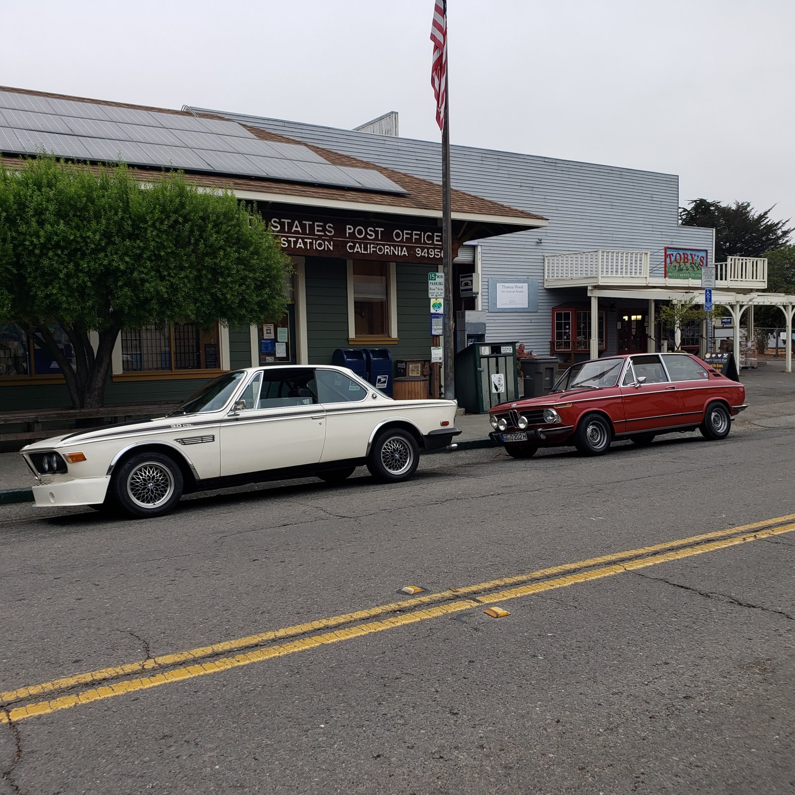

Yup, that pic is pre swap of the cut springs. Once I started driving it it dropped even more as the rubber spring bases started to fall apart and the bases were already the thinnest ones made. I basically stopped driving it because it felt like it was running on the stops almost. No compliance at all. I got the H&R progressives and Spax adjustable and have only done one drive. Love the compliance but the front springs are loud due to spring binding with the coils so close. Trying to figure out next steps. Here's the stance now. Probably at least 1.25 inches higher but a world of difference in ride quality... Sans the front spring noise...

No, not directly. I just got everything on so its still settling in. It drives much better than before with just the cut springs...
