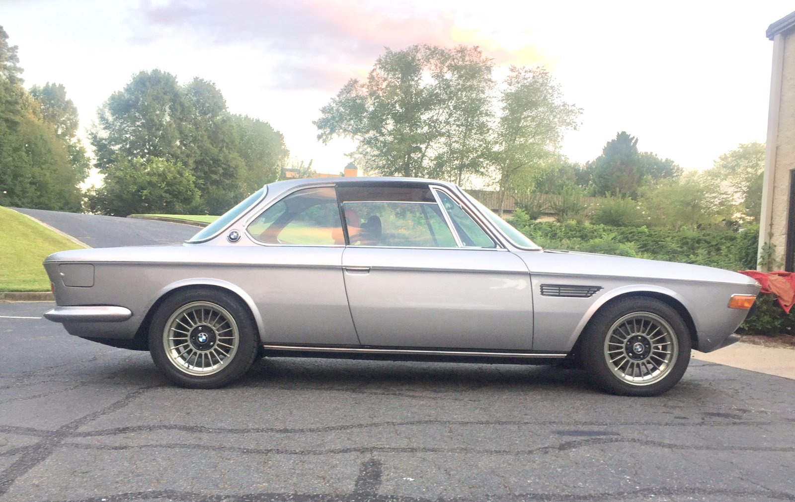

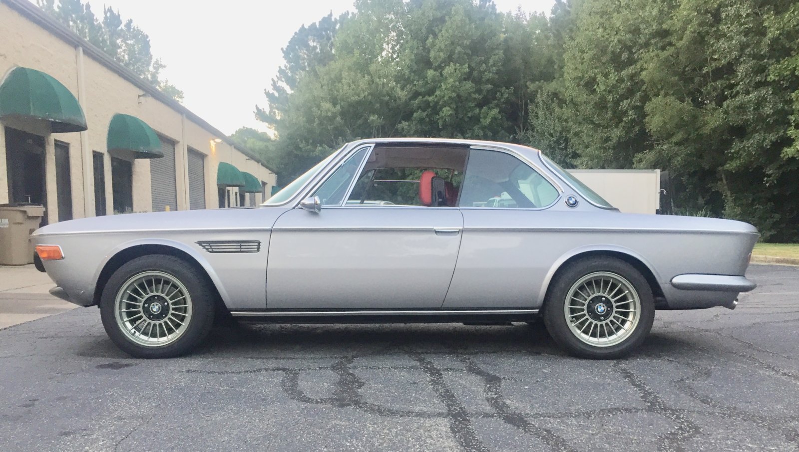

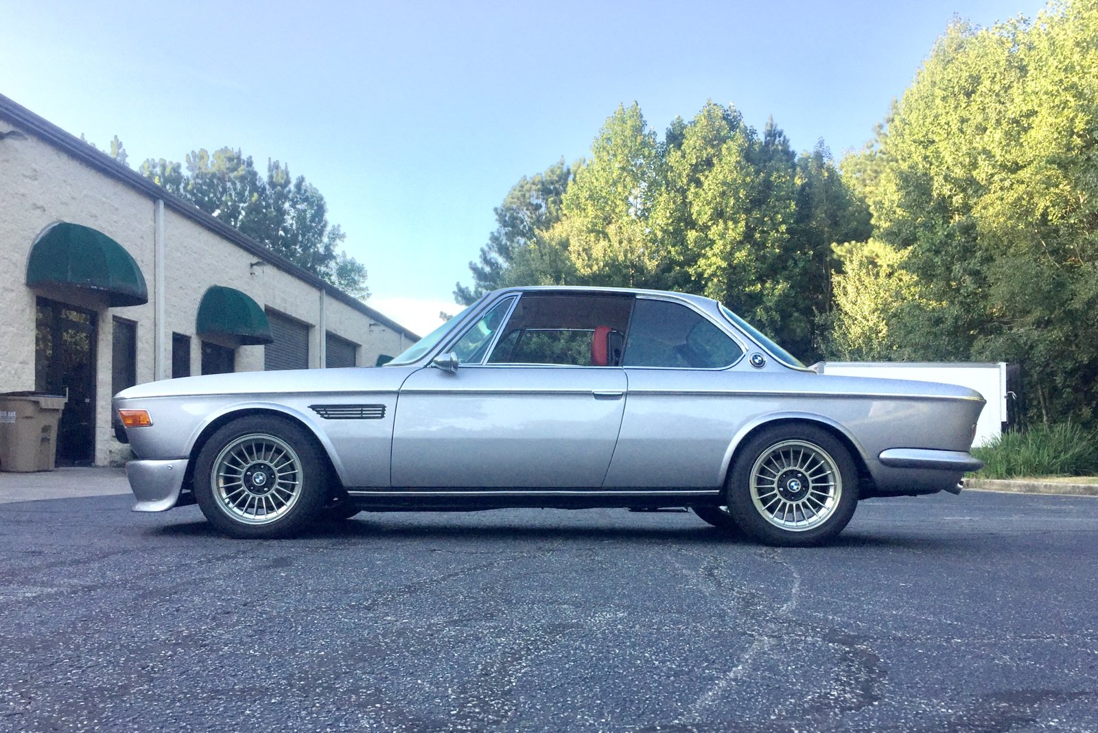

Patton
813
696
Atlanta GA
Number 1:
Number 2:
Number 3:
I’ll give ya’ll the spring combinations after a few of the votes are in.
Have fun.
I hope the information on springs/spring rubbers will be helpful for others.
RP
yep, the wheels need more lug nuts.
#1 too low especially in back
#2 a bit high up front
that leaves #3, though I'd be concerned when turning into driveways
My thoughts exactly. Thanks all for your votes!
If this will help, here are the parts used:
1 : Nelson rear spring, no rubber. Factory spring up front, one coil cut, top and bottom rubber, 1/2” total.
2: Nelson front and rear, with top and bottom rubbers on both (1/2“total rubber).
3: Factory rear, one coil cut, both rubbers, 1/2”.
Factory front, one coil cut, rubbers removed.
Like Forrest Gump, I’m tired now, I think I’ll go home.
I‘m going to leave it at picture 3 height.
Hope this may help someone with a future build.
RP
