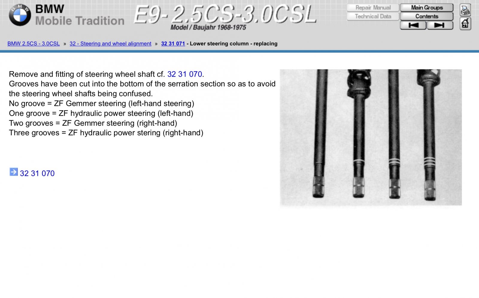

I have now, and in the process of rebuilding 3 manual steering boxes.
On my Coupe it has P/S, and would like to enquire, what about the steering shaft?
Do I require a longer one, from another manual?
Thank you.
Regards,
Alberto
Ideally another shaft from a manual steering car (same model) should be the correct length. Install the steering box first and then measure the length required and match that with the shaft you have. A metal shop will be able to adjust the length if required.

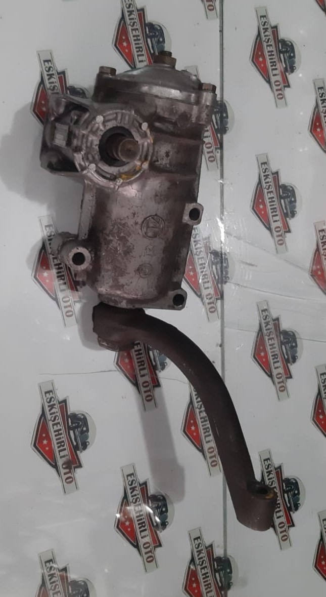

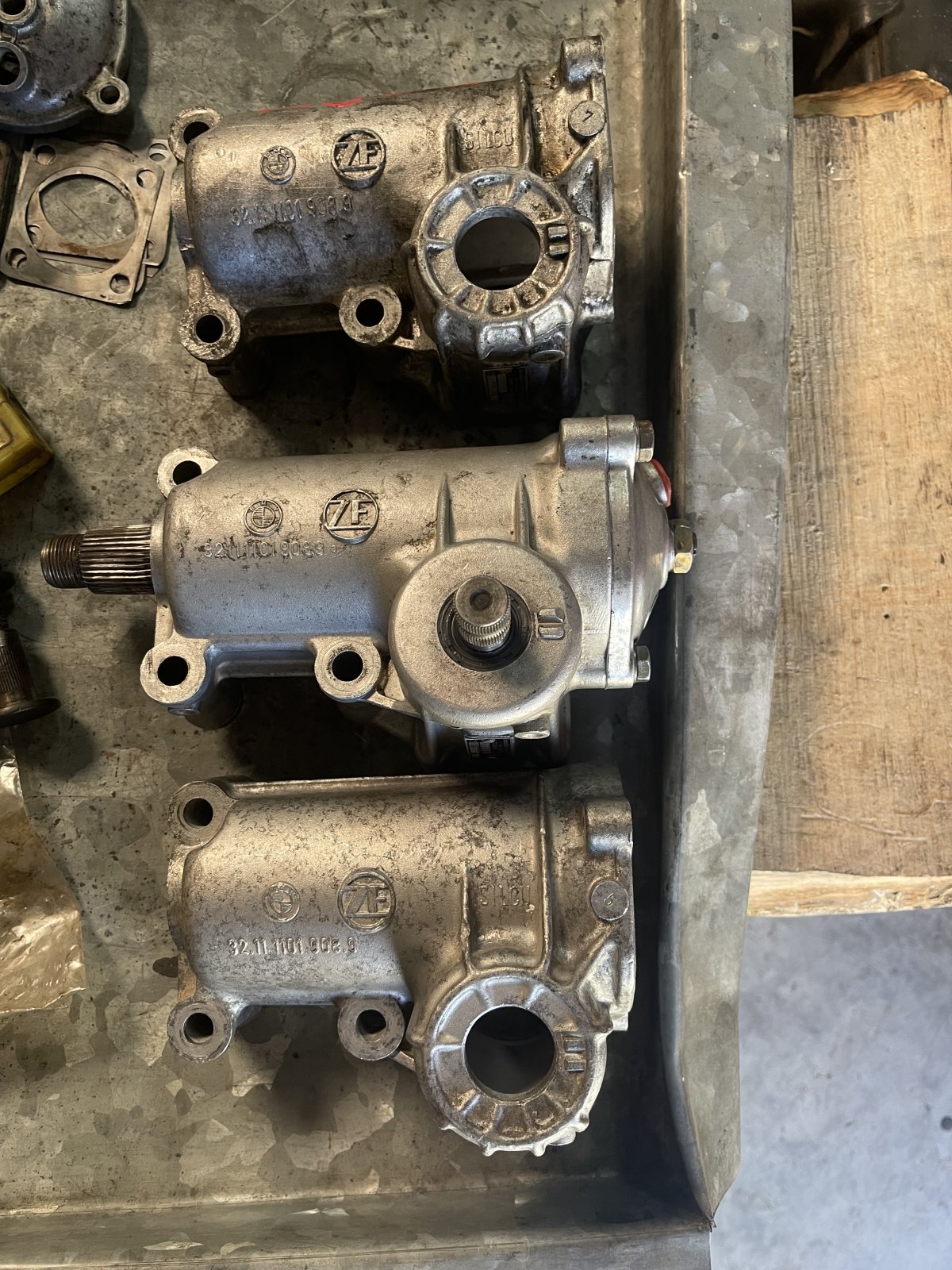

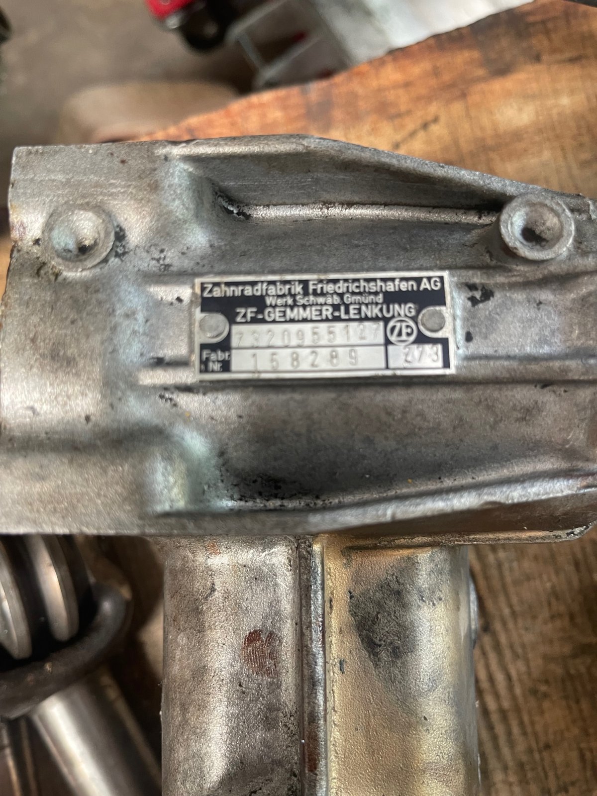

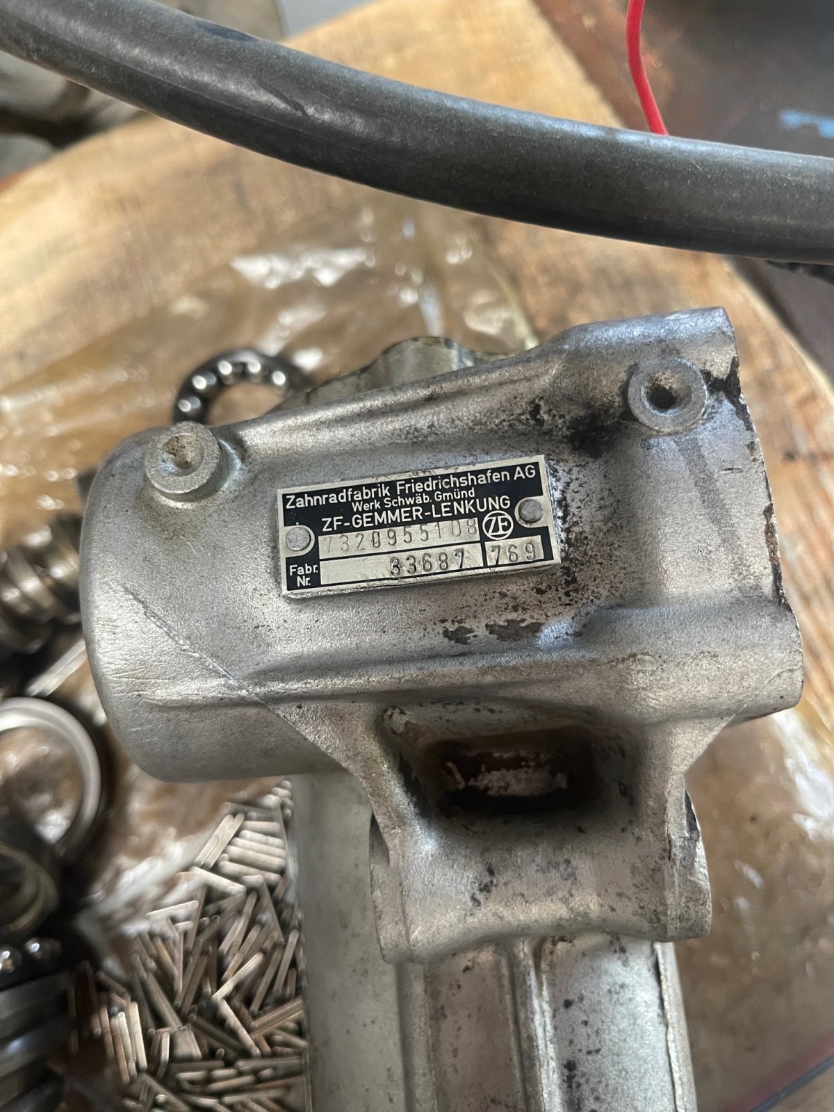

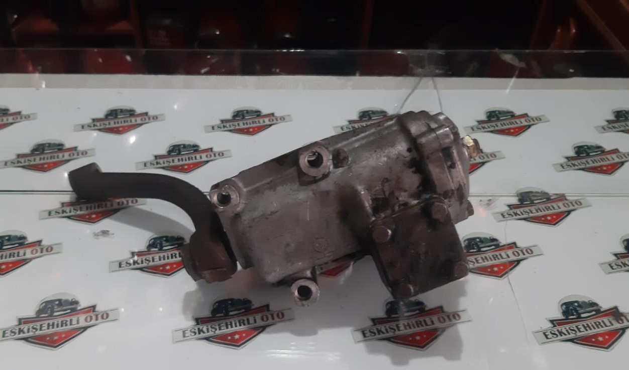

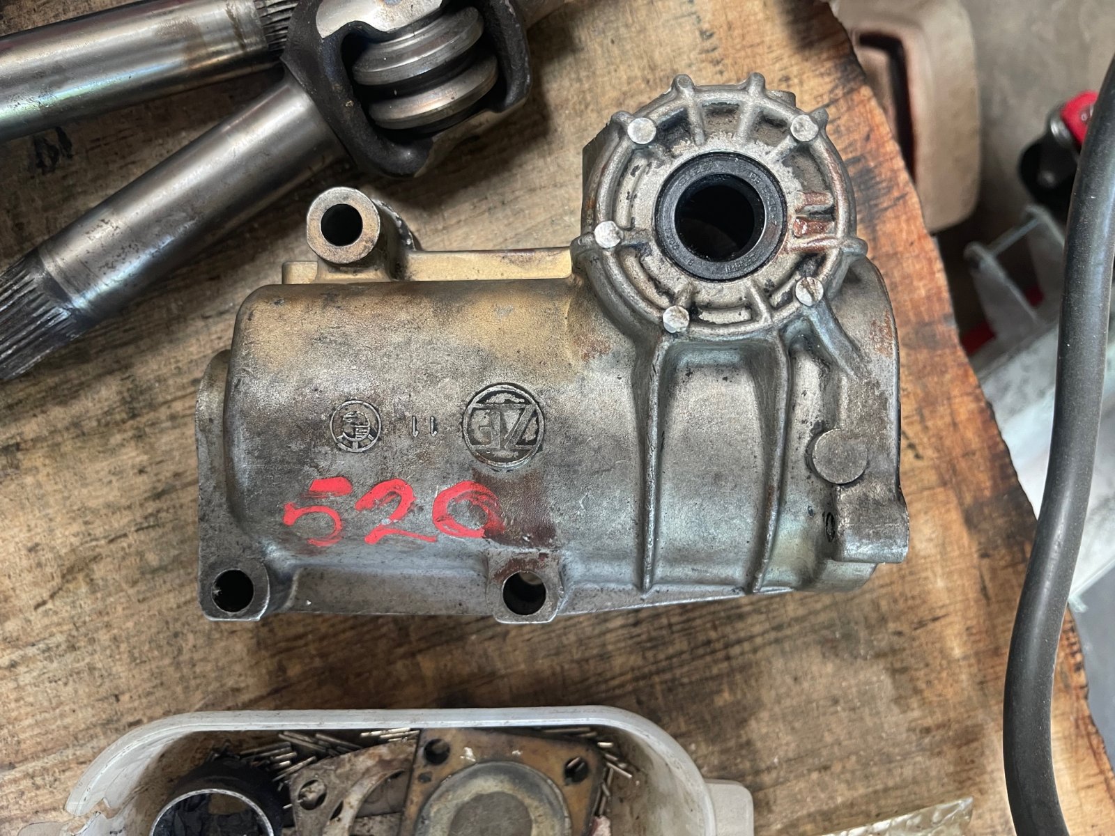

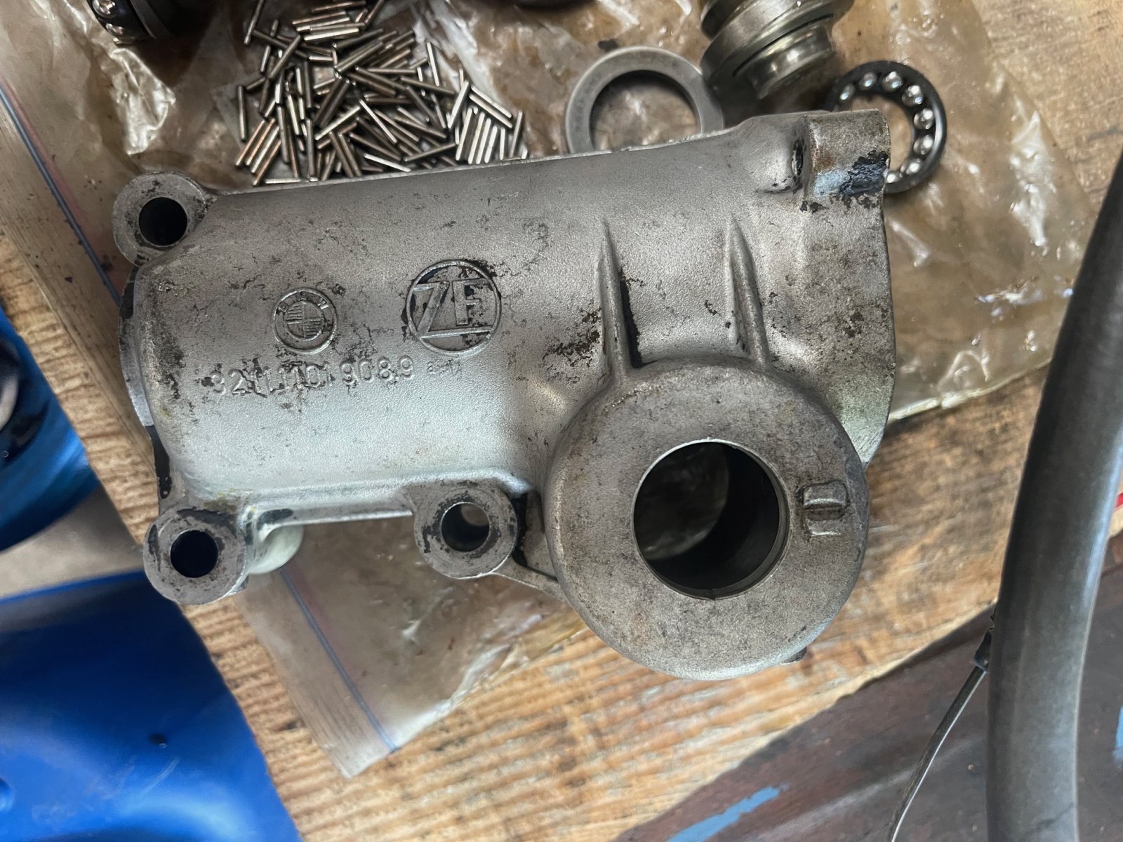

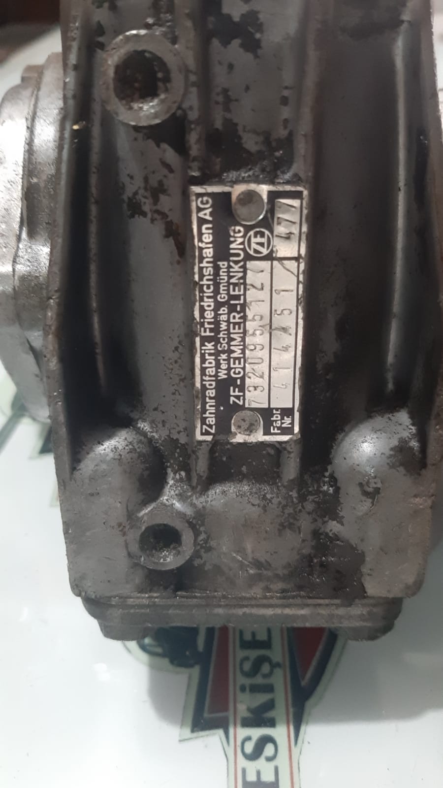

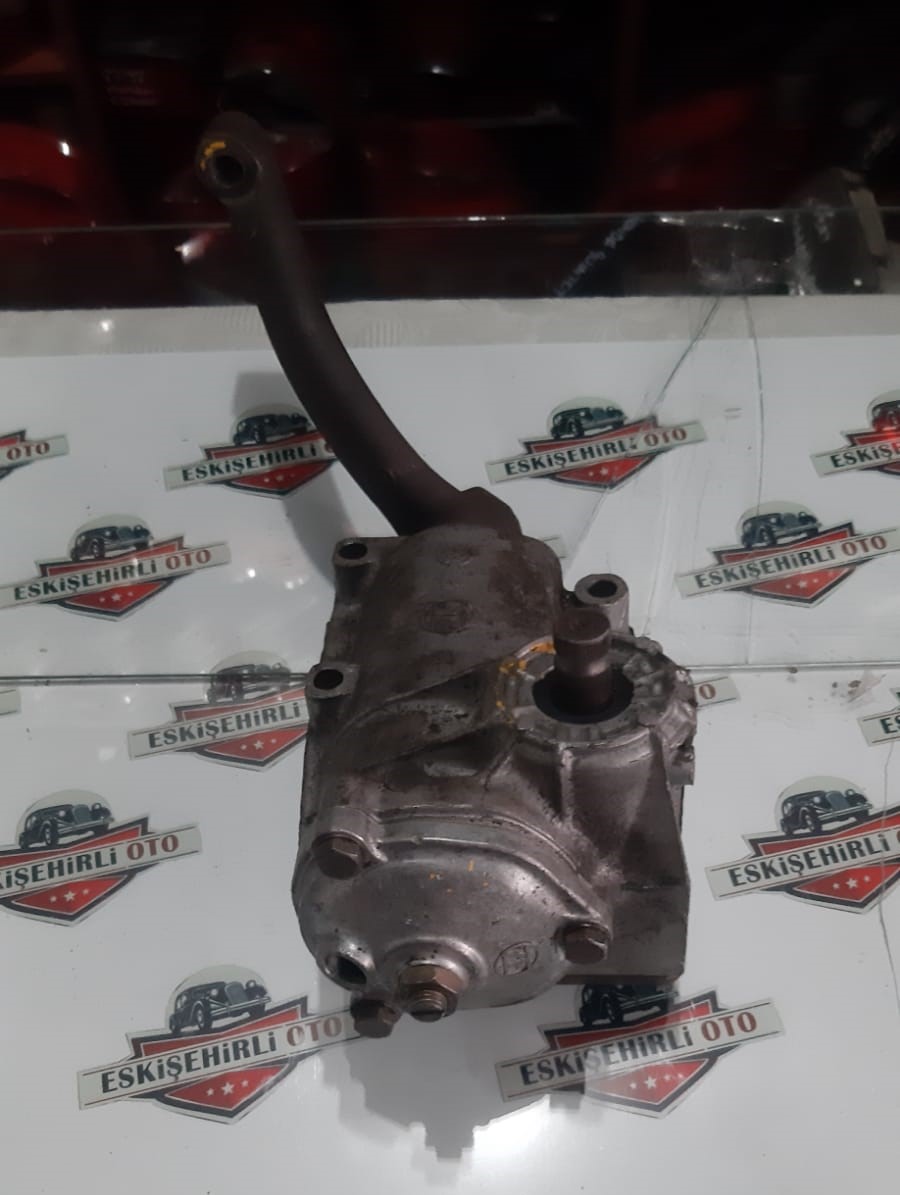

You can only use the 108 in a E3/ E9. You also have a 127 if I see the number right……per my records (amateur) 129 would be for a RHD…. (I don’t know the 127 type).
Compare the 2 casings to see if there are differences.
You are right about the RHD, how it would get here is a mystery as only LHD for us. Actually against the law the have a RHD car here. :rolleyes:

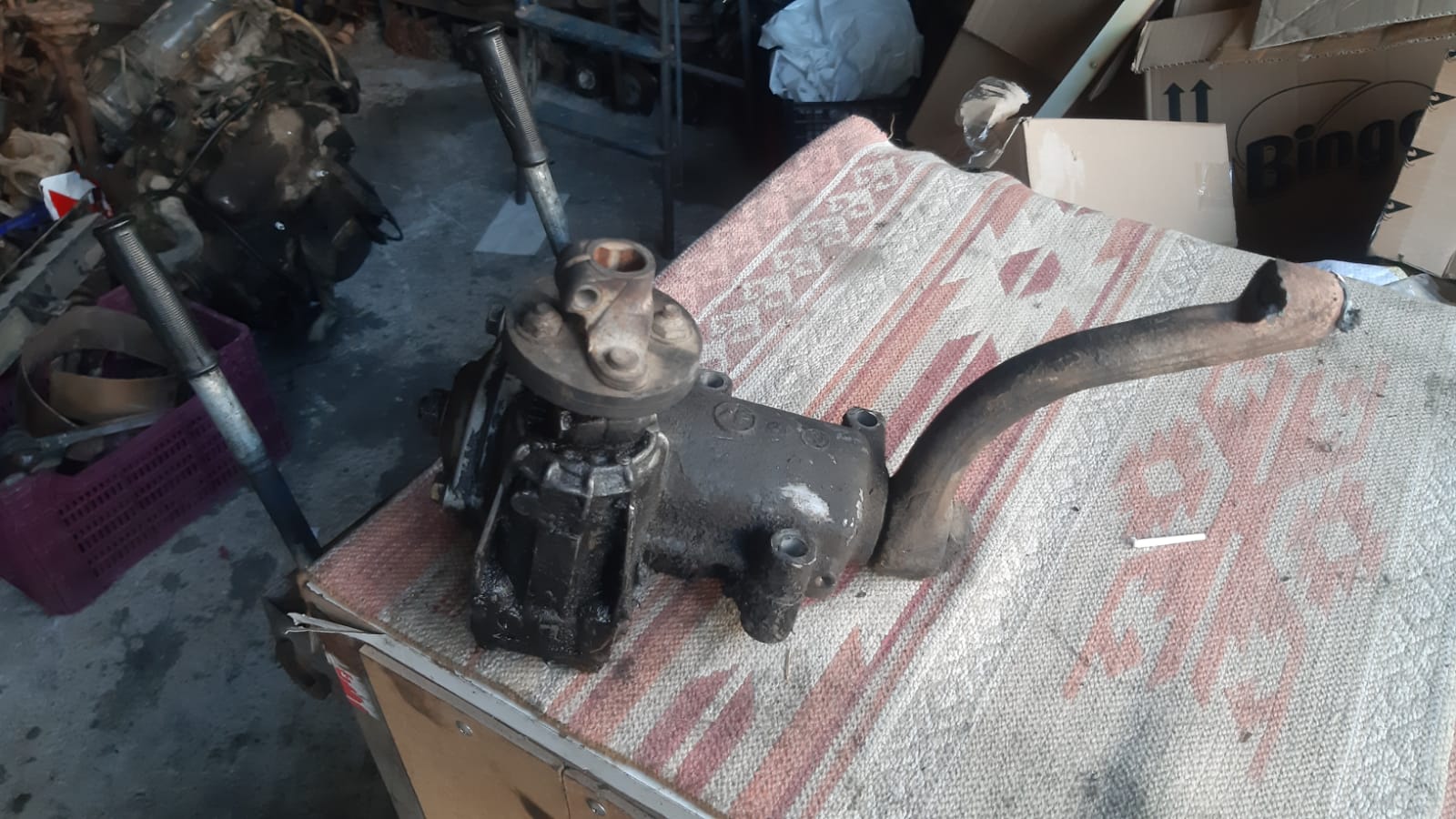

I also have a 3rd one, no photo here.

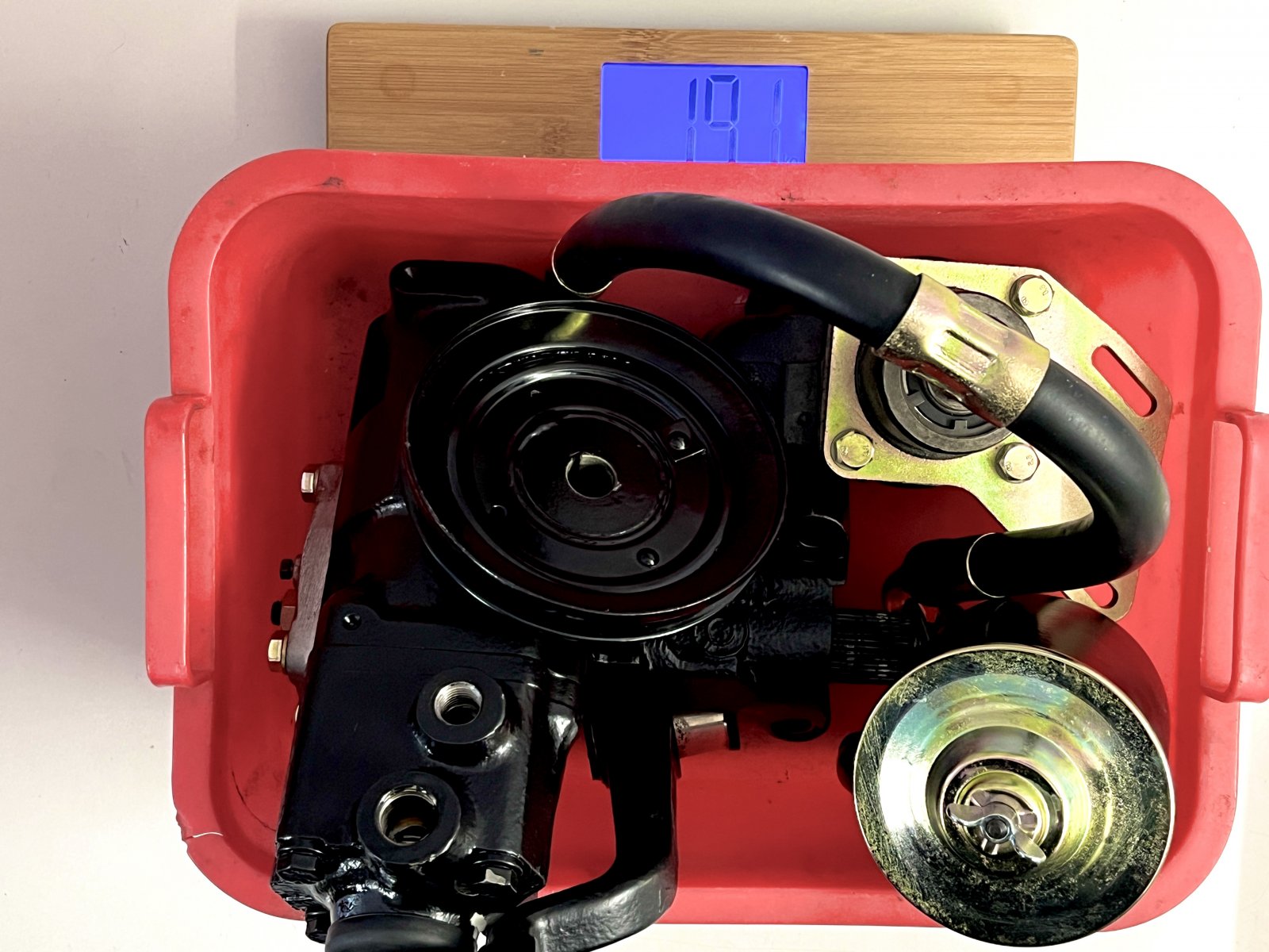

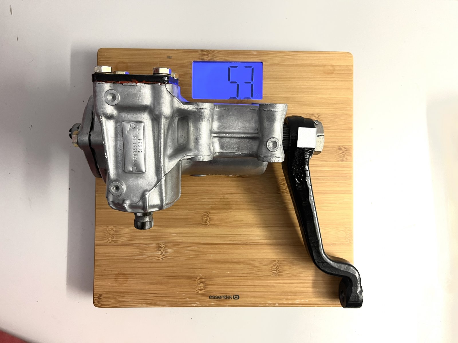

Something else interesting worth noting in this thread is the staggering weight difference between manual and power steering set ups. I measured a 13.8kg saving without fluids. Just for reference, that’s a better weight reduction than fitting an aluminium CSL Hood!
By the way, on the topic of steering shafts, am I right in thinking I can use my late model steering shaft (with telescopic adjustment) to fit the manual steering box?

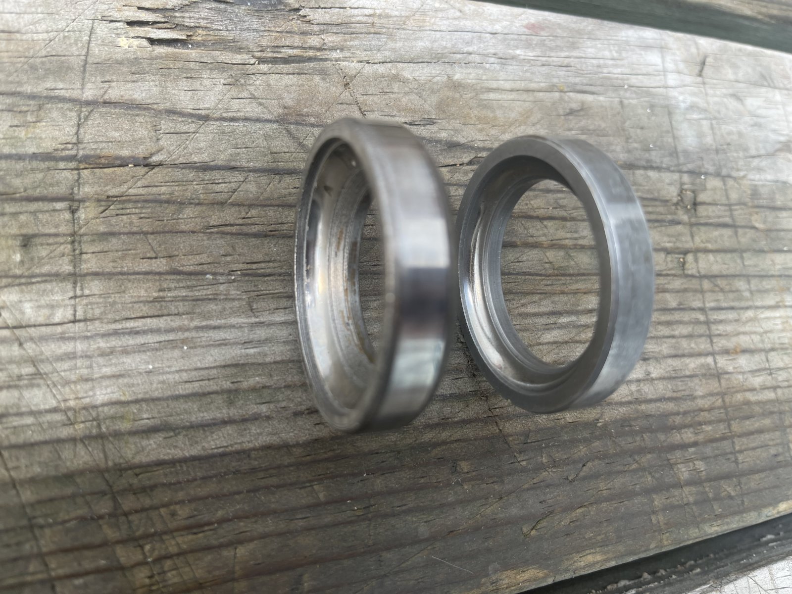

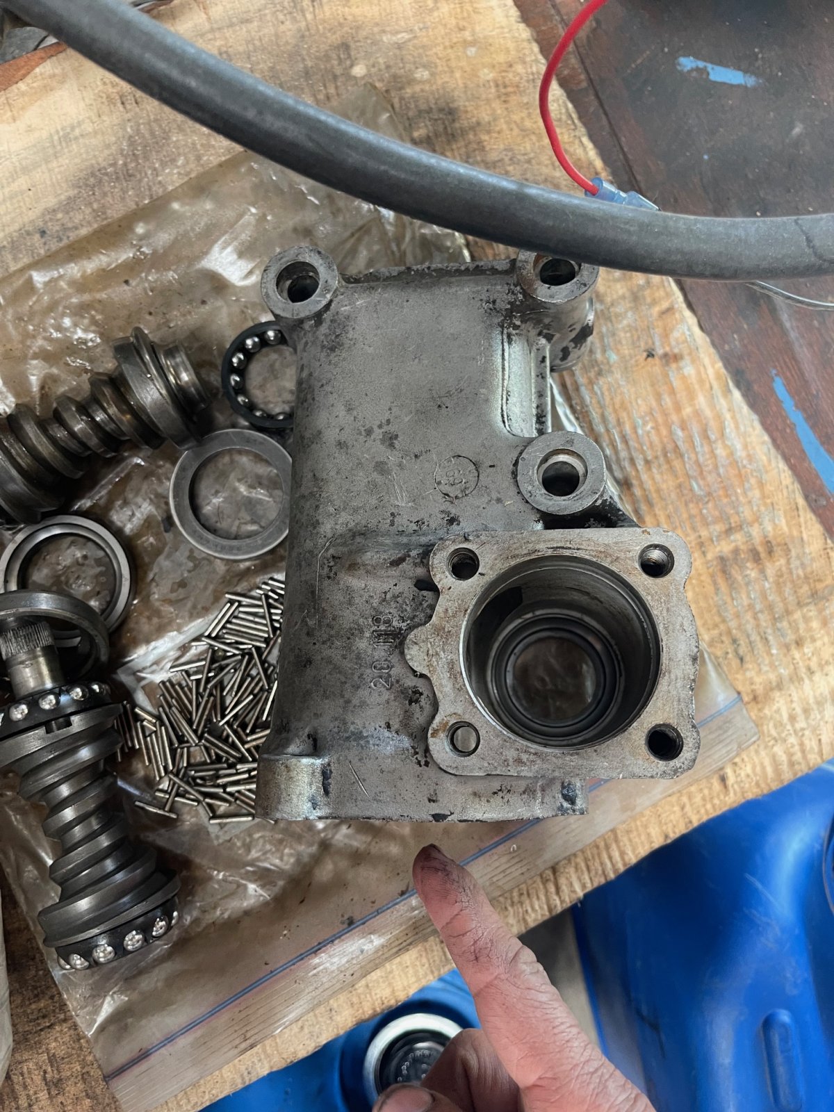

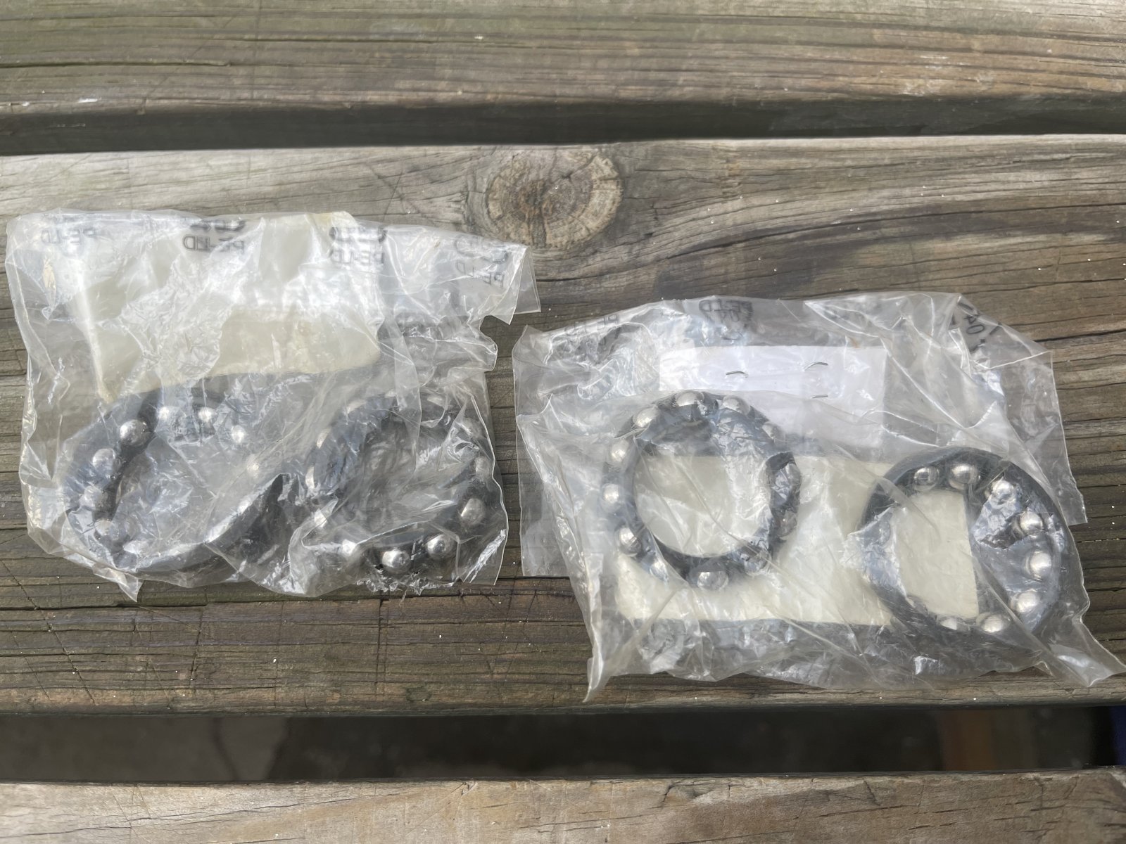

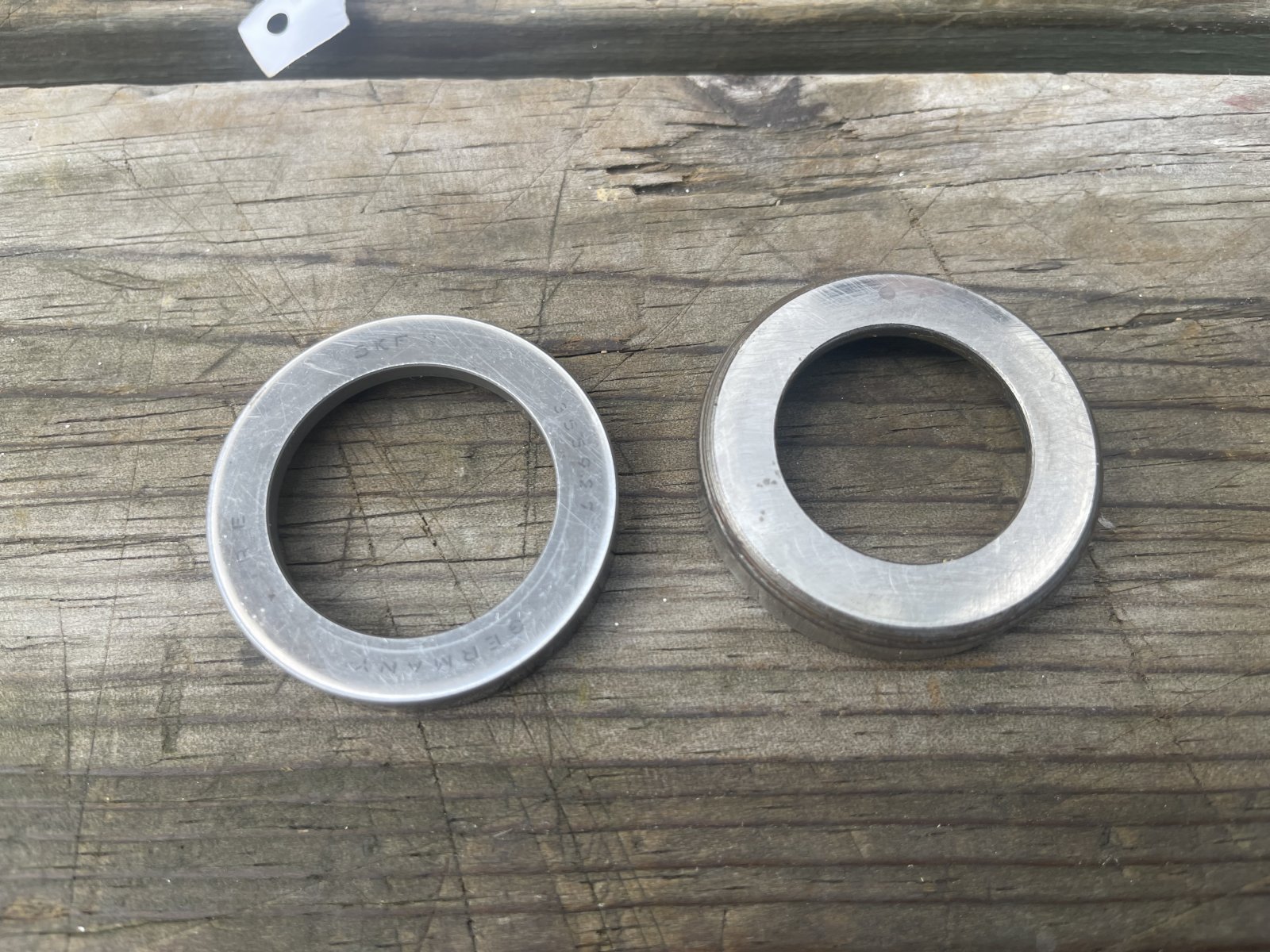

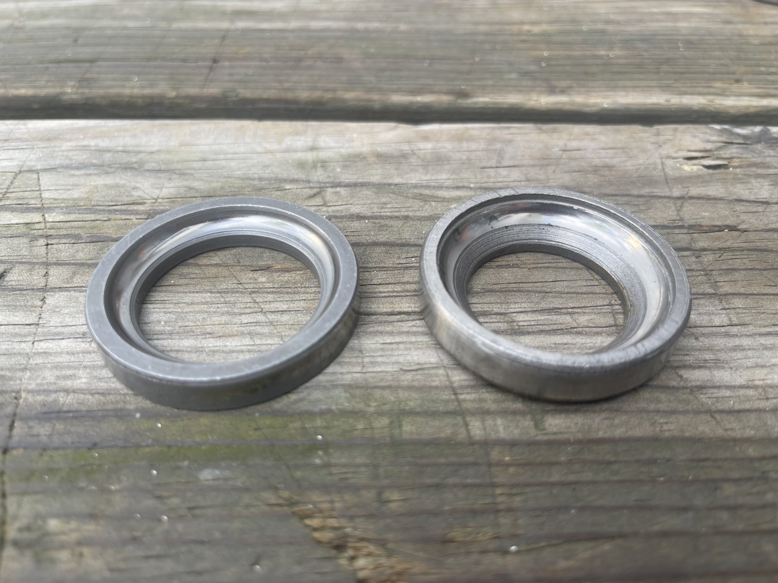

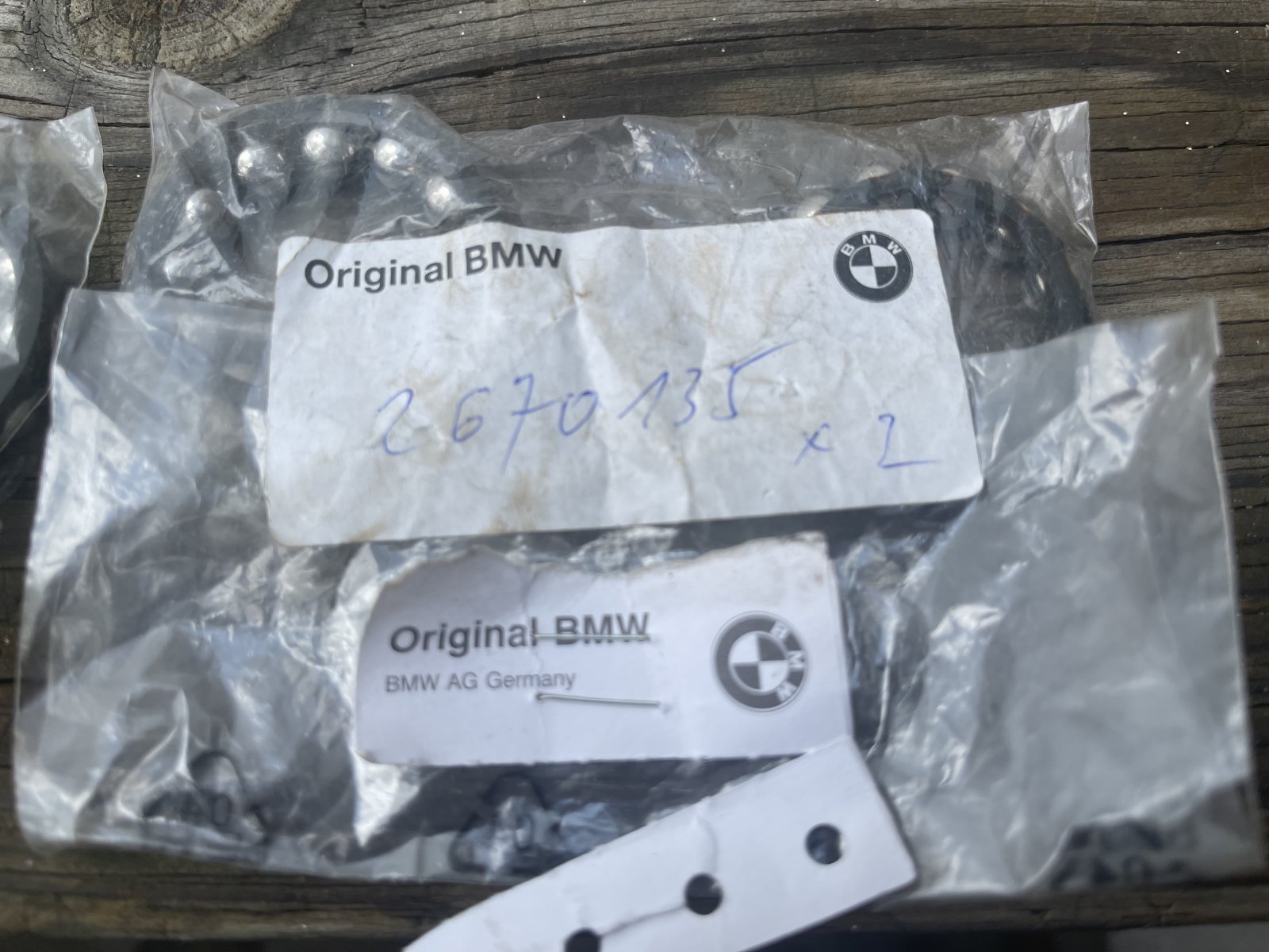

For one of them, I am missing the large bearing cup... the bearings I have.
Anyone have one?
Regards, Alberto
