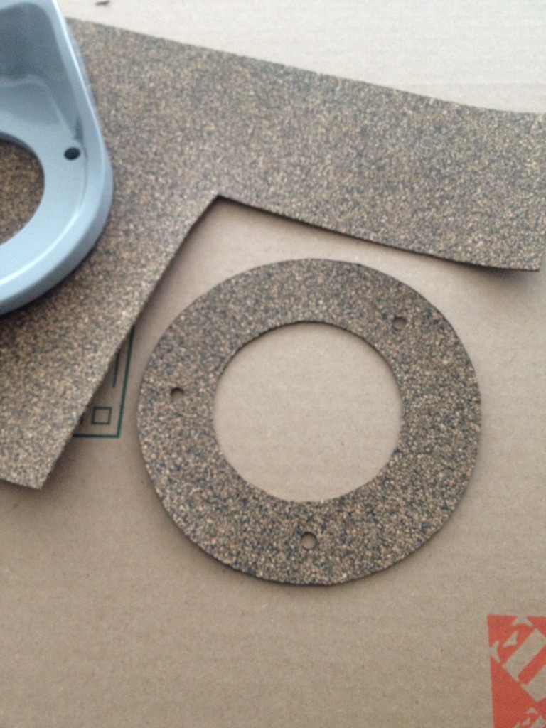

have received mine last week, just bought some thin rubber sheets to use as 'gasket' for the bases. hope to post some pics when all installed. thanks again champ-Andi! :p

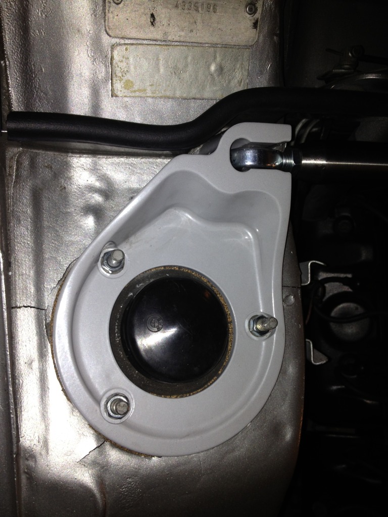

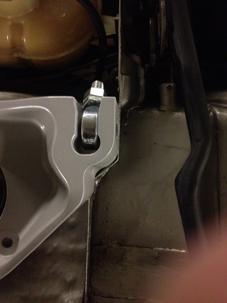

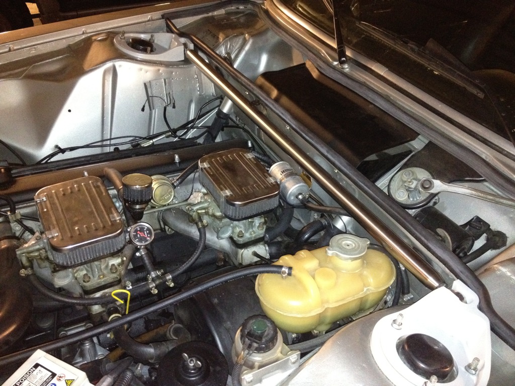

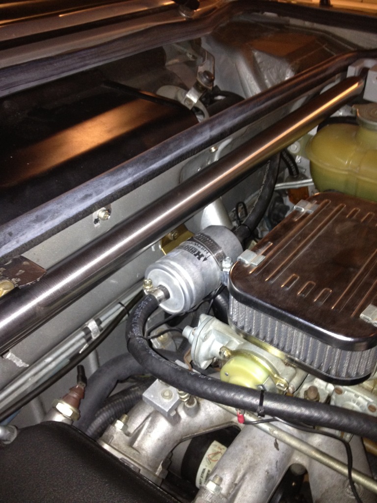

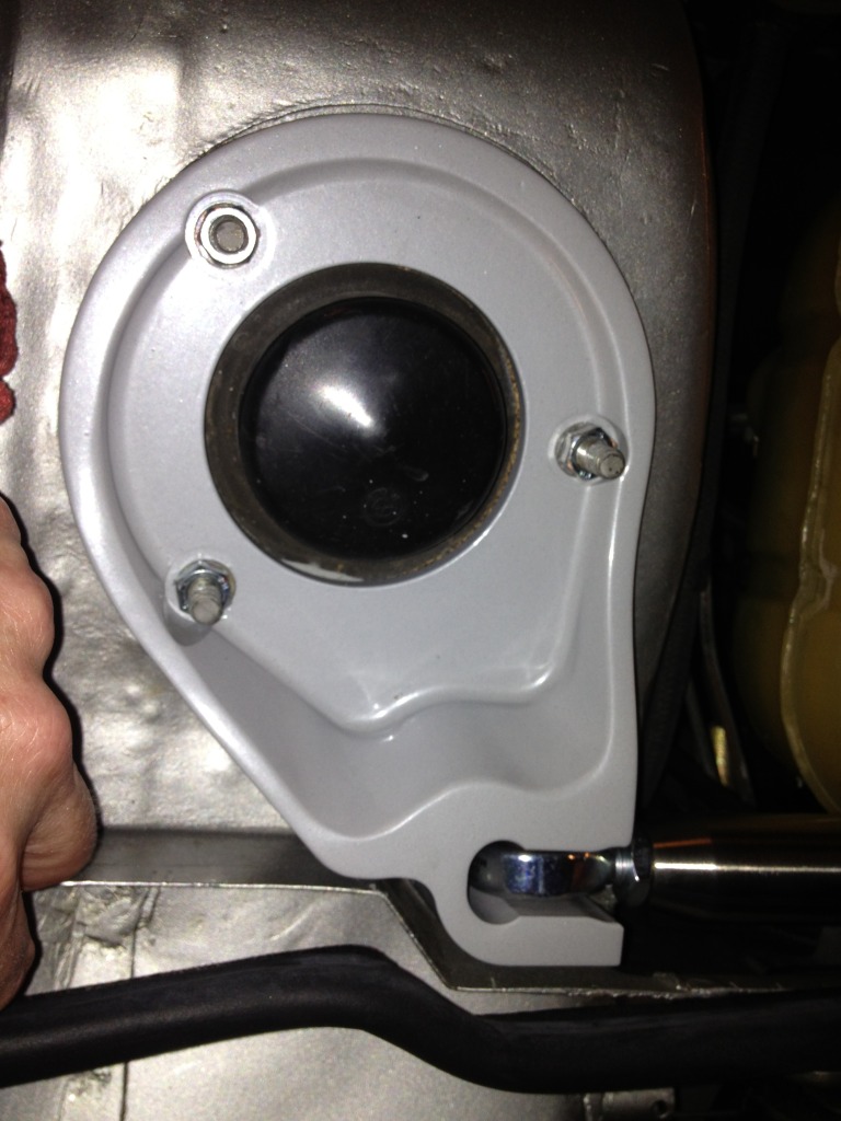

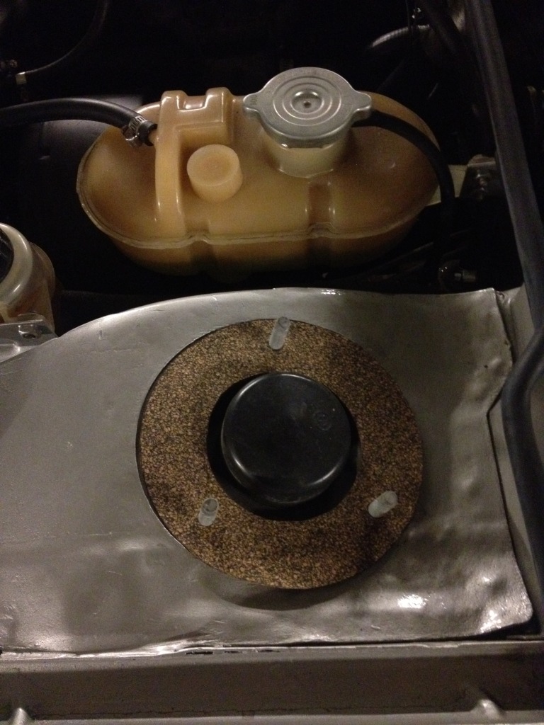

I started to install the strut this weekend.
As you can see below, I started by making a gasket.
I still have the sound deadening material, so this may have been unnecessary.
The passenger side mounted very easily, but the drivers side was a tight fit.
It took a little persuasion to get it on.
I was glad to see that my fuel filter wasnt in the way.
I still have to cut down the studs to use the cap nuts, but that will have to be next weekend.
Really happy with the quality of the part.
Thanks Andi.

Arrived here Friday night, a work of art! Thank you should go on the coupe when shes back from sfdon this spring. Will send pictures when installed. Rum

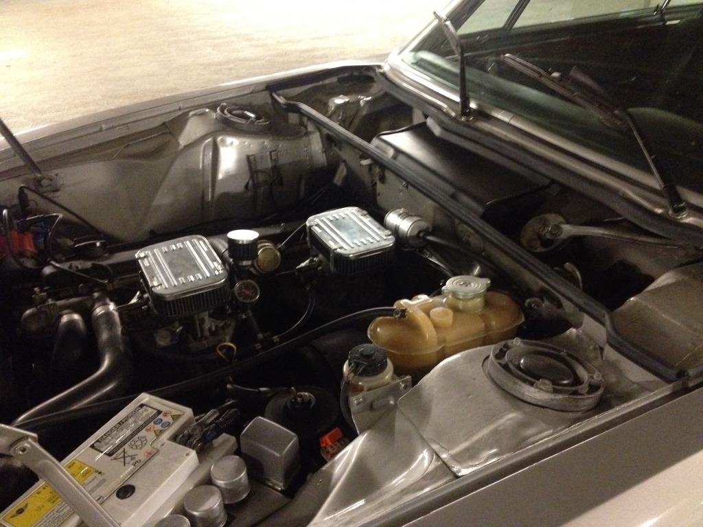

Thank you David!
Great pictures, nice work, I´m so proud !

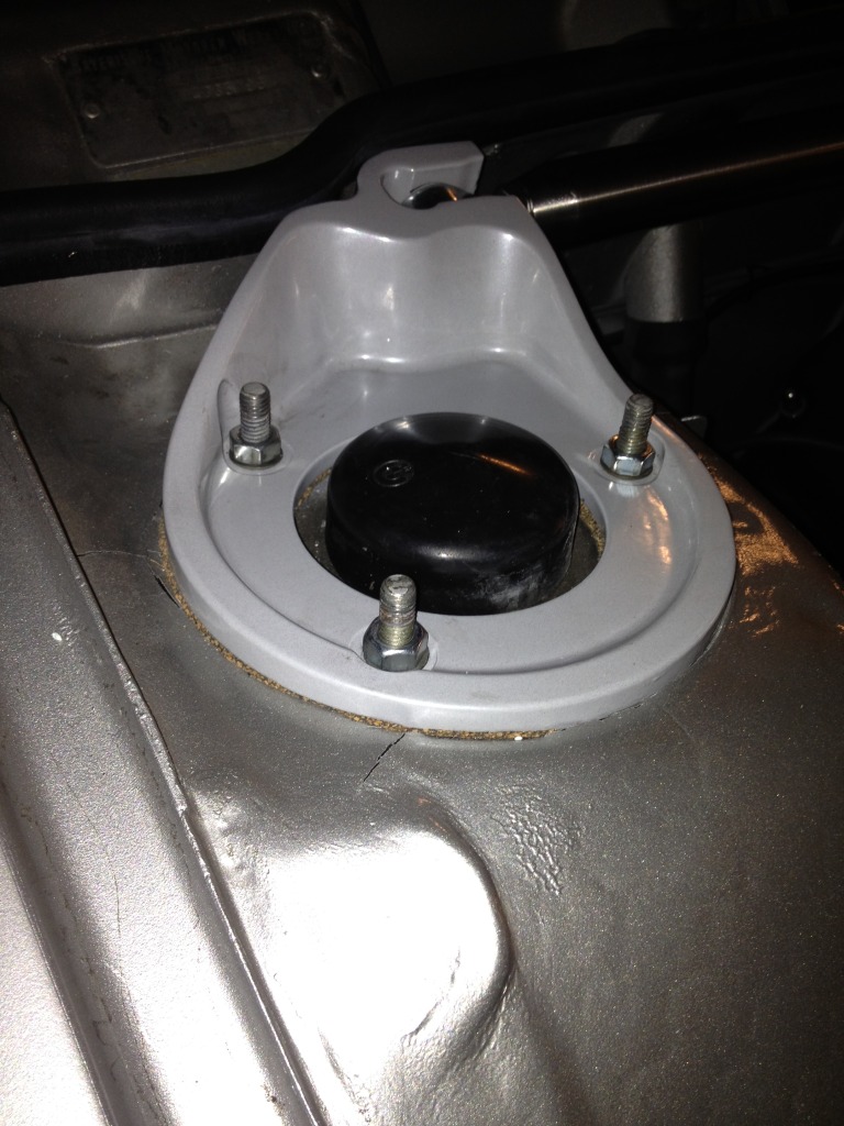

Thanks David,
I purchased and installed Andi's first run....cross bar I built myself. At that time the suggestion of a gasket under I do not recall. As you see from the photo I had some deflection which caused the tar paper or sound deadening to crack. So some sort of gasket material is recommended. Let me know if the cork holds up before I proceed. Any advise to repair the paper damaged?
Hi
Im afraid I dont know how to repair the material that covers the area around the fender. I "think" it's an asphalt like material. It seems like removing the entire section and then replacing a new piece would do a fair bit of damage, but I dont know of any options. Maybe a heat gun would remove it without too much damage.
