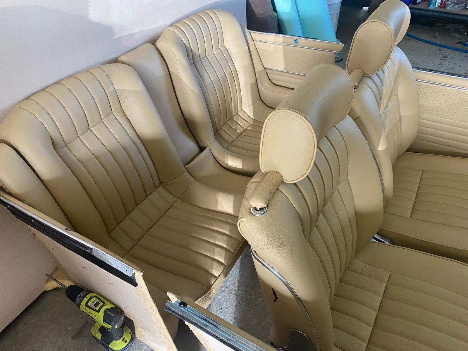

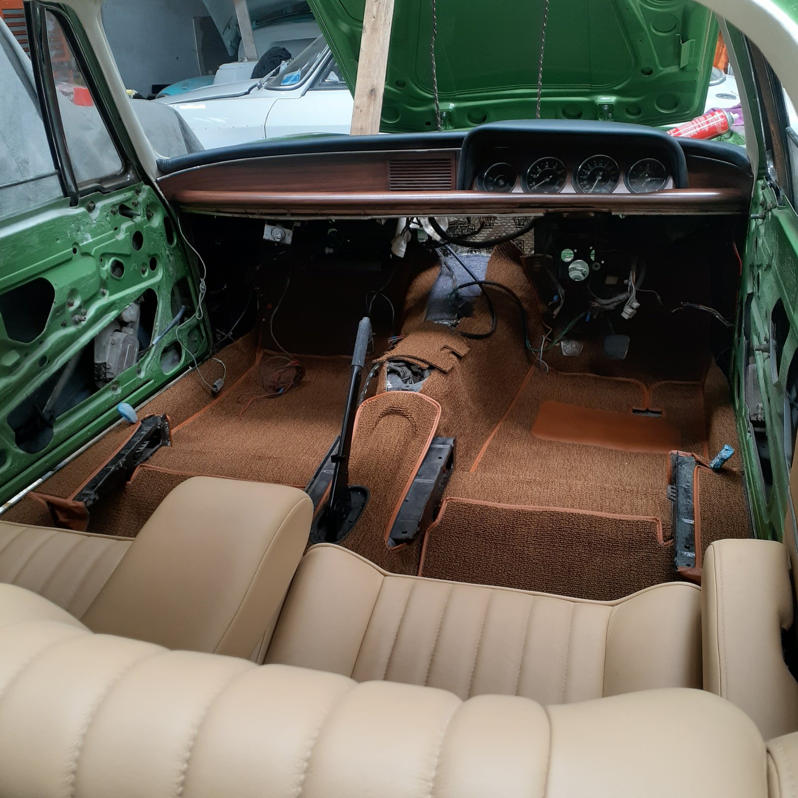

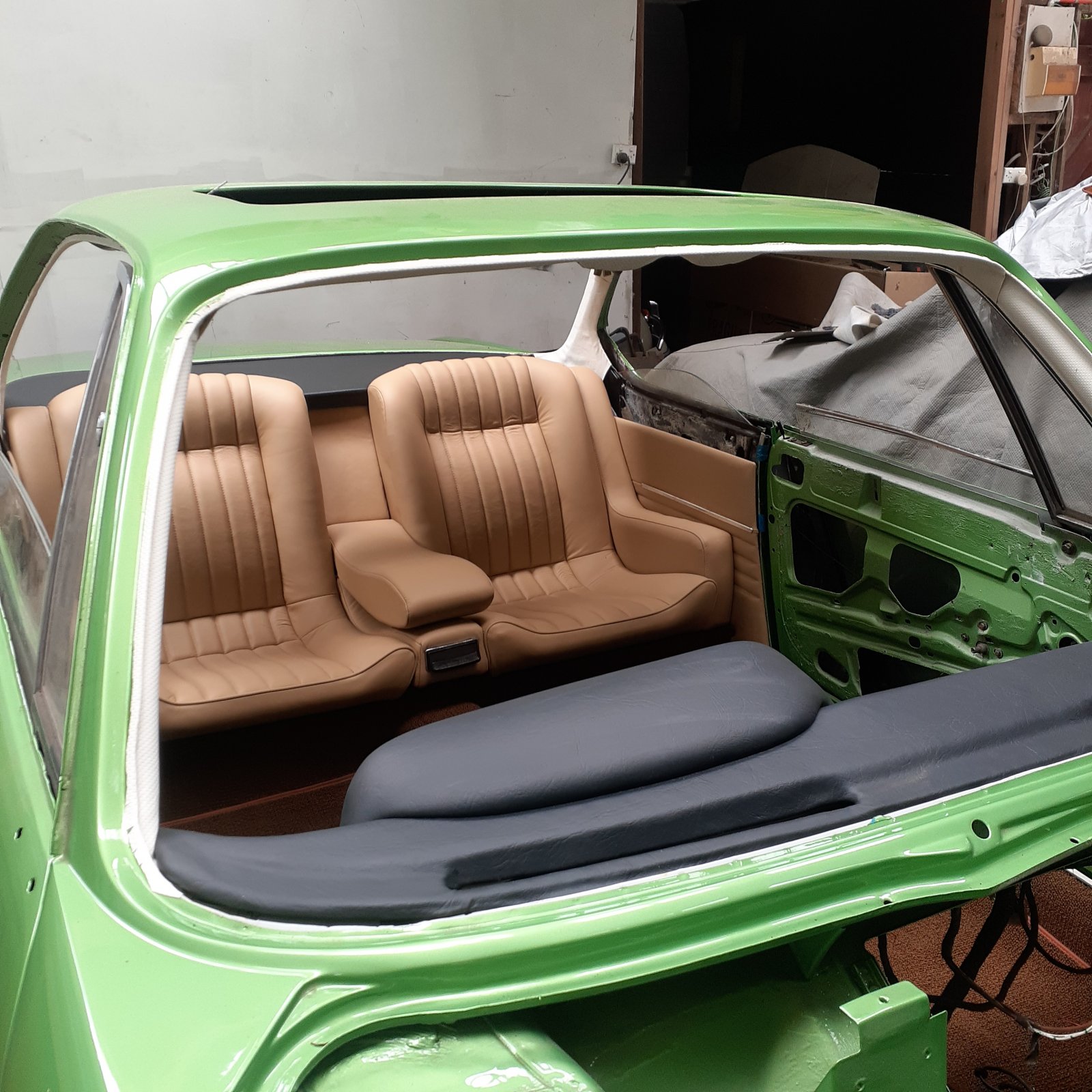

I have just started refitting the interior after the headliner was installed. got to get clips for the door cards, does anyone know the correct ones.

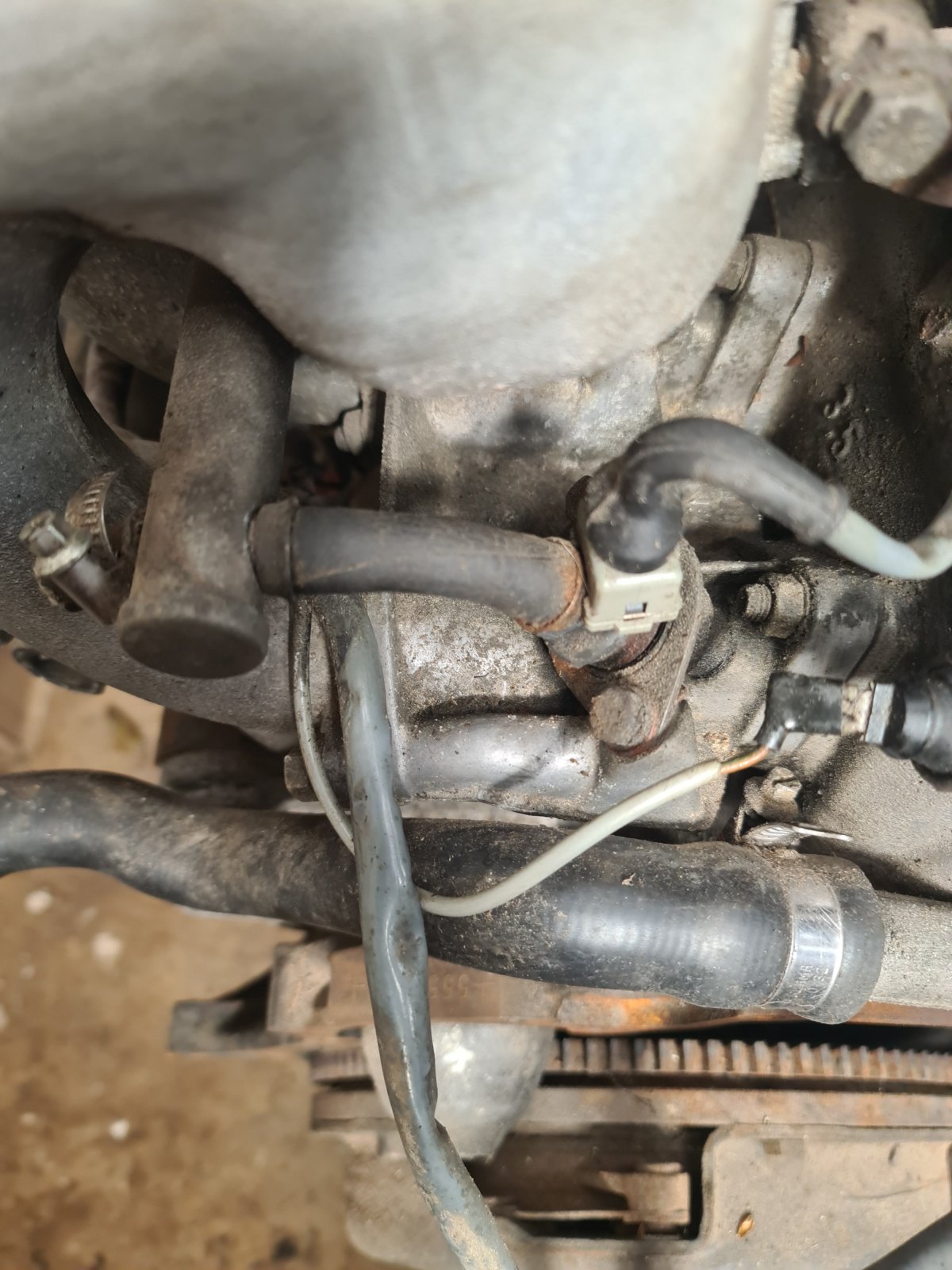

Its been a while since my last post as I have been concentrating on finishing a few other cars but now back on this. front and rear screens about to go back in after the trim surrounds come back from polishing. I am about to install the 3.5 motor and 5 speed but want to refurb the hoses and lines on motor before it goes back in.
Can anyone tell me where I can get these fuel lines replaced as they are somewhat cracked

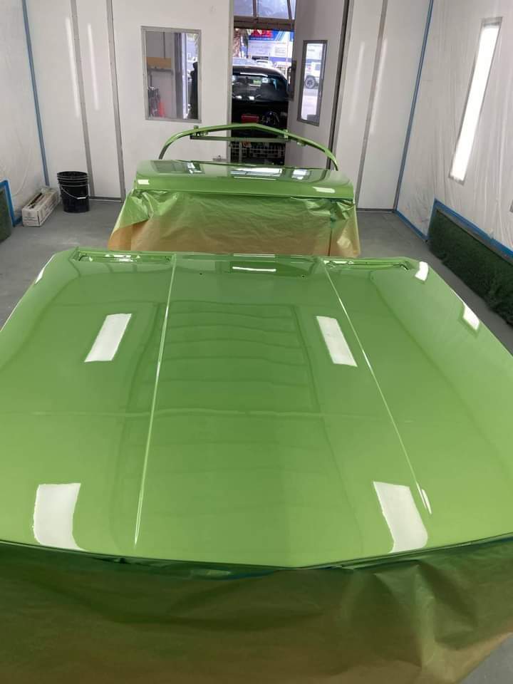

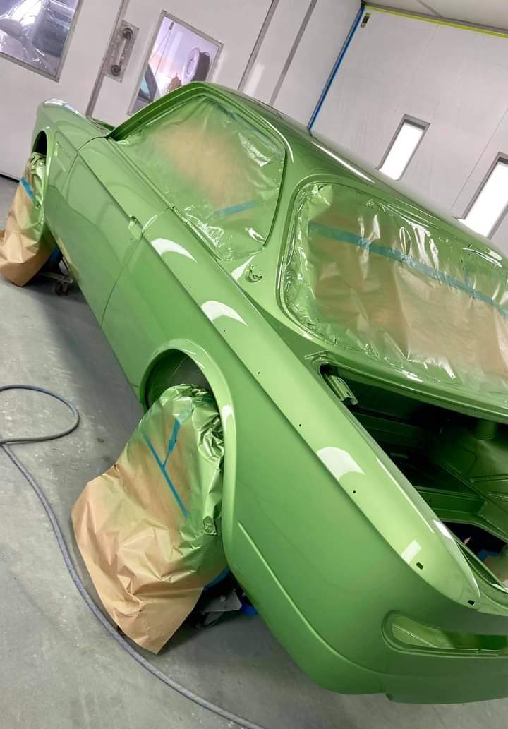

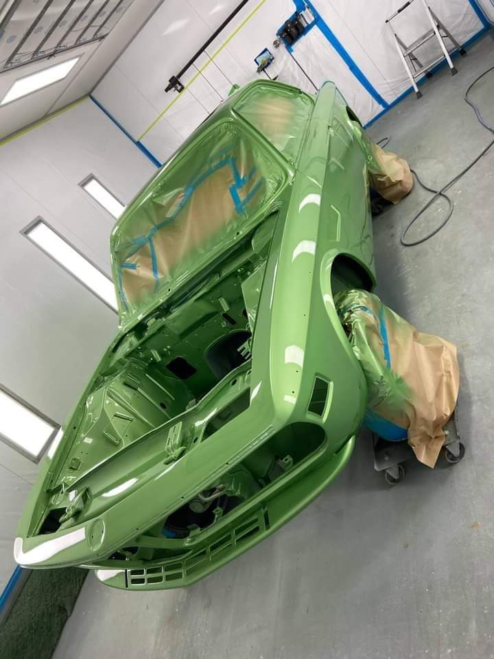

Which paint manufacturer? Looks like Glasurit which is what I used, pops much more than PPG.

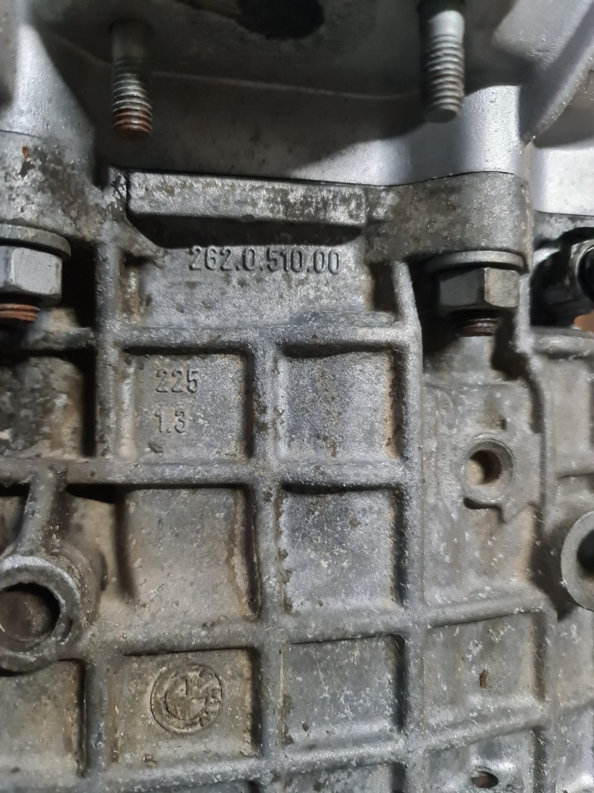

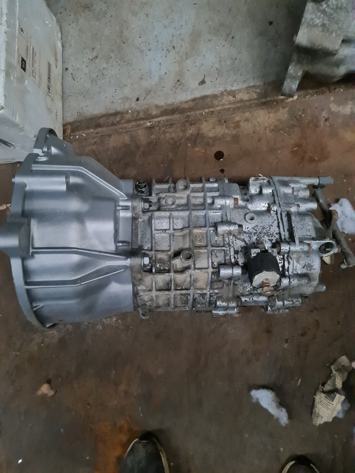

The original type fittings are fine but hard to remove without destroying the hose. Is your Getrag a dogleg or o/d? I have an o/d box paired with a 3.25 diff great cruising but a bit tall overall to make the most of the m90
this is the box I have. haven't checked what it is, maybe you know

so I use clamps on the hose as opposed to whatever the current fittings are
You can get all the correct high pressure FI rubber hose and 'fuel line clamps' or 'solid band hose clamps' from Super Cheap Auto in Melb. Also I tend to go through once or twice a year to tighten every clamp I can see in my engine bay as a precaution to ensure I dont have a fire. It's amazing how these clamps do get slightly loose over time.
