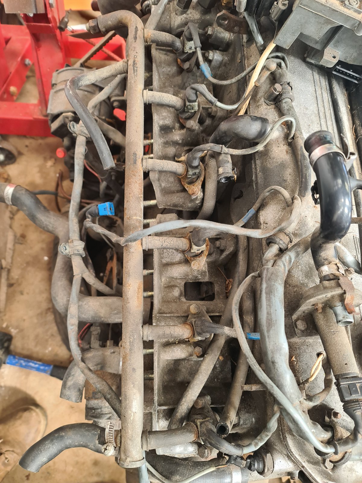

after a bit of advice. how do I get the old fuel clamps off without causing any damage to the injectors

Judicious use of a Stanley knife, slit the hose lengthways without going right through, then they will tear with a bit of persuasion

can I reuse those clips or am I better getting conventional ones.
haven't worked out how they actually hold the pipe on.
You can reuse them if you want. I think they apply pressure around the hose base which keeps it tight on the barbs when fuel pressure is there. I used hose clamps to avoid the removal saga if there was any adjustment to be done mounting the rail and pressure regulator. I didn't have an induction system till I visited the wreckers a few times
I reused the clamps if that's what they are called.
I need to replace the seals while they are off. wallothnesch have said I need both, is that correct.

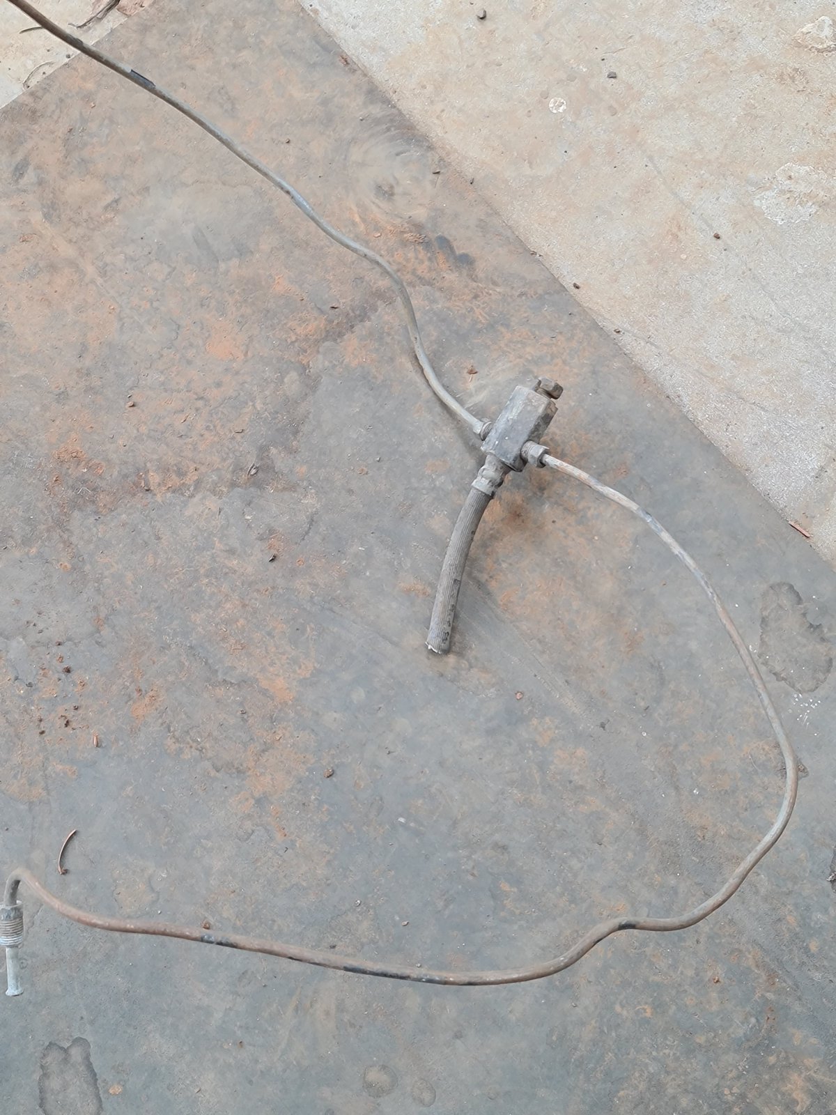

another question that hopefully someone can help with. I am running the rear brake line. I think it runs down the tunnel, is that correct and is this the correct union as this is what is in my old parts

You need both rubbers, large is body of injector mount, small is to seal the injector into the manifold. They are available here, the small seal available from EFI solutions
or similar in Melbourne, I tried to use aftermarket body mount rubbers which were a fail, got genuine article through BMW Melbourne, ( in stock in Deutschland ) not ridiculously expensive when you consider no freight charge, but takes a couple of weeks. Don't recognise that brake union, the rear line comes off the booster, down the left side of tunnel, into the pressure limiter, hard line out either side of that, into flexible hose, then back to hard line into calipers. I see a flexible hose used to supply the pressure limiter in the blue book, mine is a 71 2800cs (with a disc brake rear end) , and the manual does not have rhd brake info so maybe different depending on year or lhd/rhd

thanks for the info. it may be thatsome one earlier in the cars life changed the pressure valve. I will have to look out for one or get an after market one.
I got the brake line in ok.
I do have an e3 si and that appears to have the same pressure valve. I will copy the brake line runs

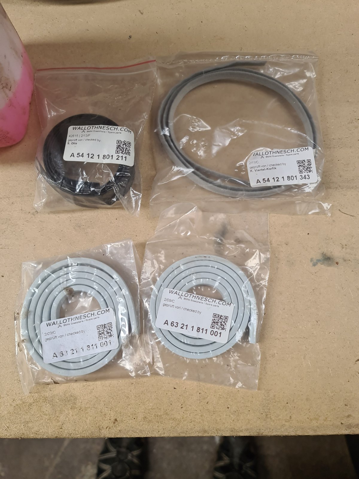

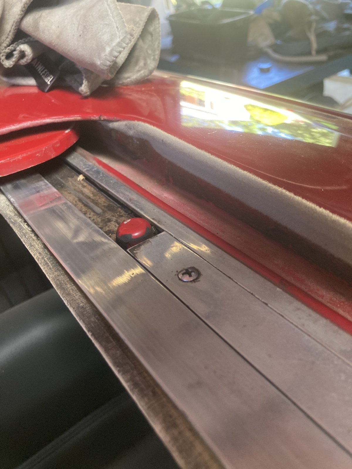

moving onto re installing the sunroof. I bought the seals from walloth but can't work out whether they fit to the actual sunroof panel. hoping someone can advise.
I have attached a photo of the pieces

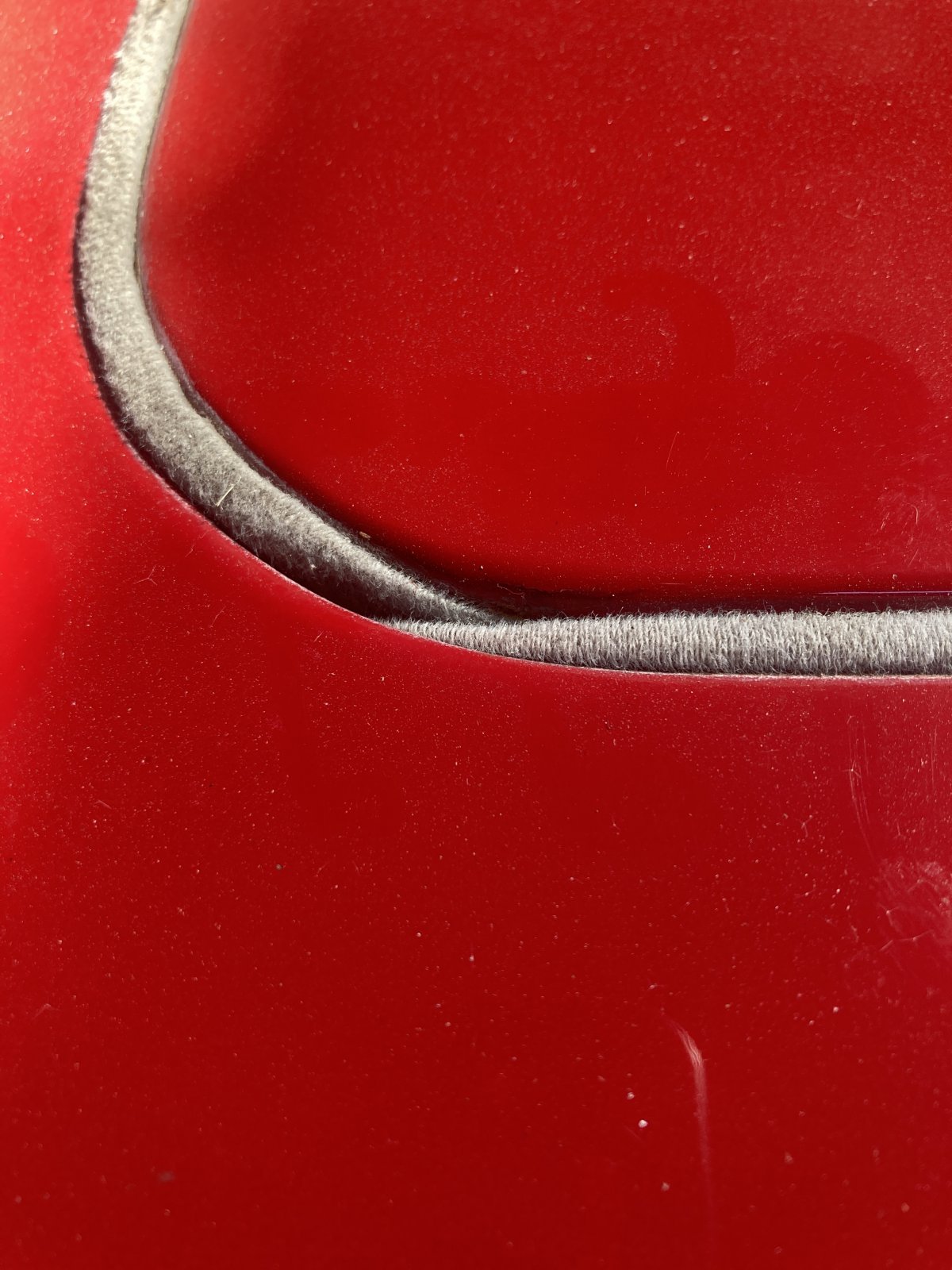

Make sure when you glue in the sunroof seals that they are below the metal of the sunroof and the surrounding roof lines. Then when you wipe or polish the paint,you will not wear out the tops of the seals.
