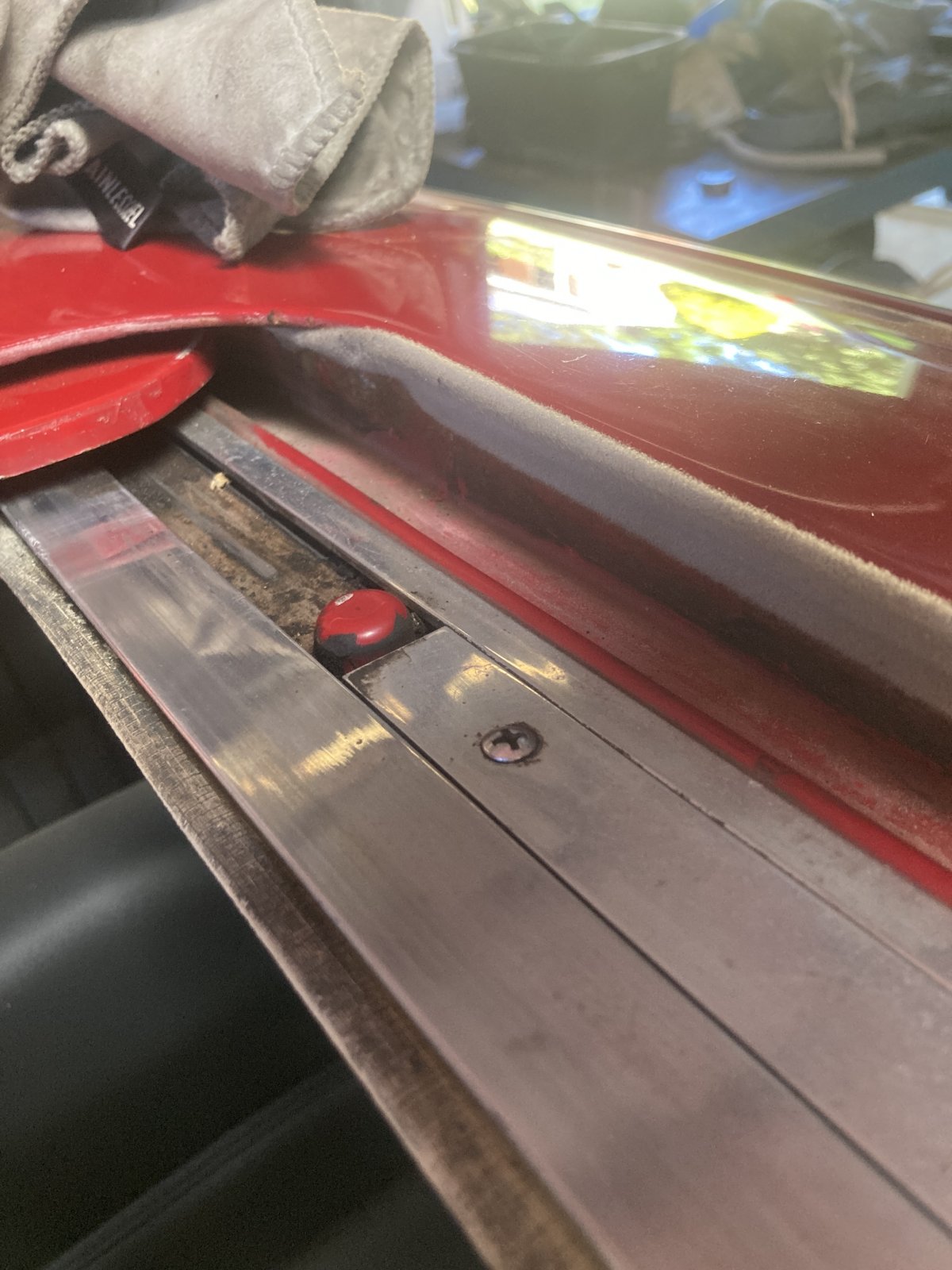

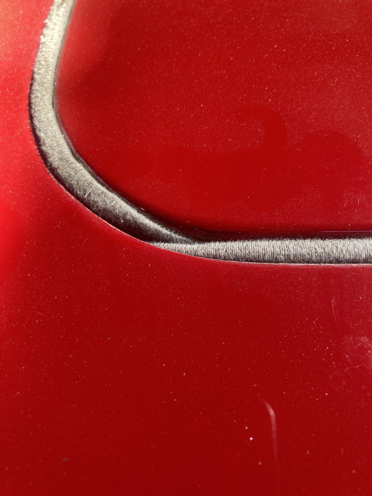

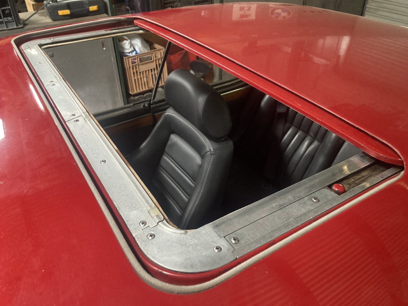

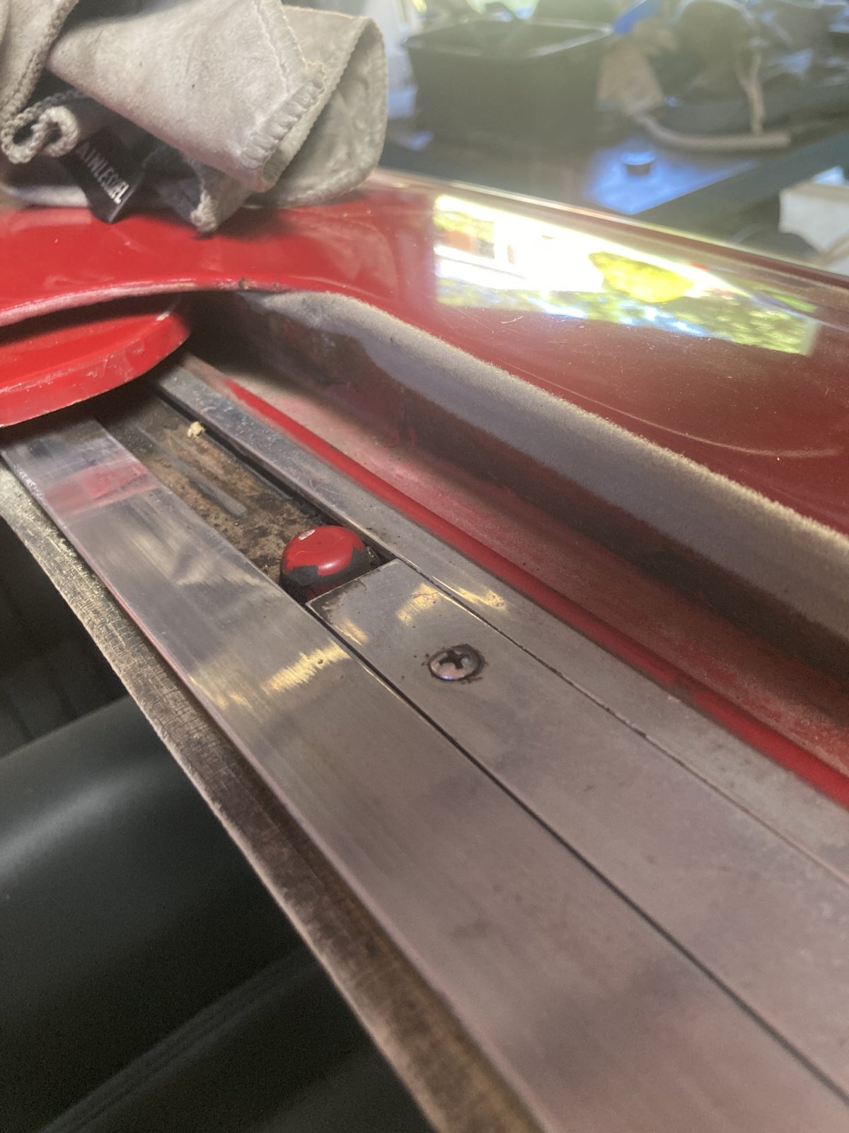

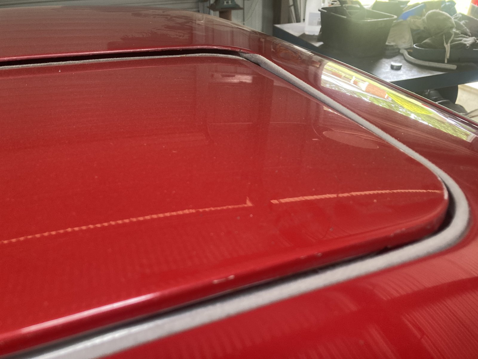

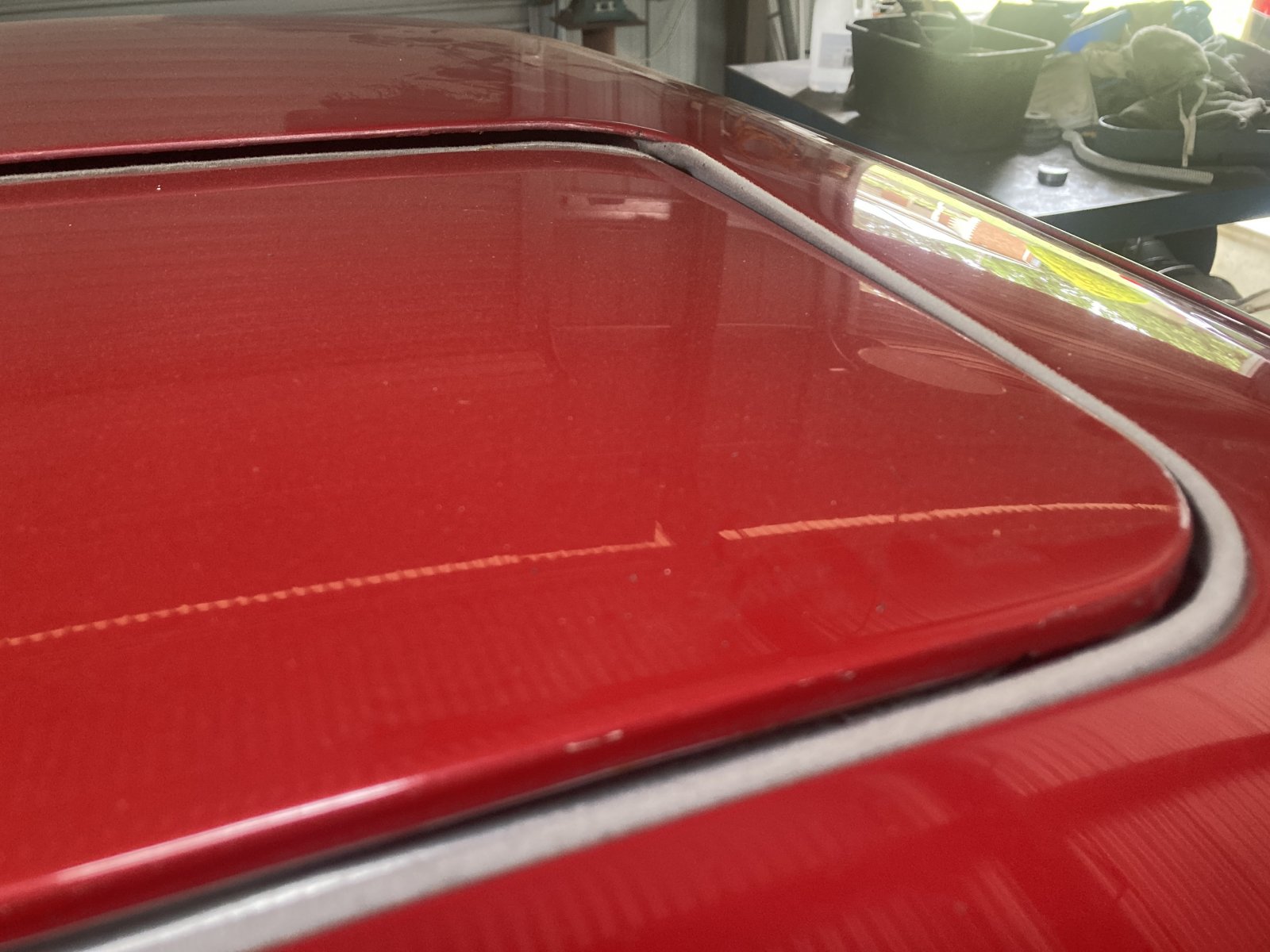

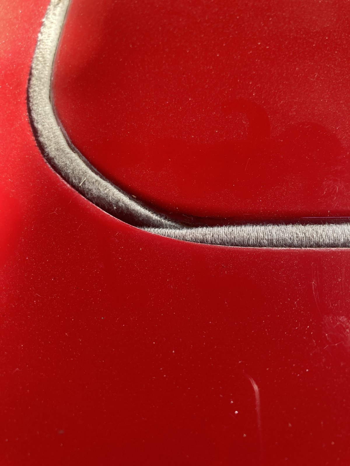

Should be one long one which slopes into the cavity on each side and one shorter one on the back edge of the sliding panel which slopes down after coming round the back corners to overlap the slopes of the long piece. Mine is not quite right, I replaced the long one as it was way too high when I got the car, but its still a bit high. Didn't replace the rear one which requires removing the panel, but I think it doesn't come far enough round the corners. IMG_1259.JPGIMG_1260.JPGIMG_1261.JPG

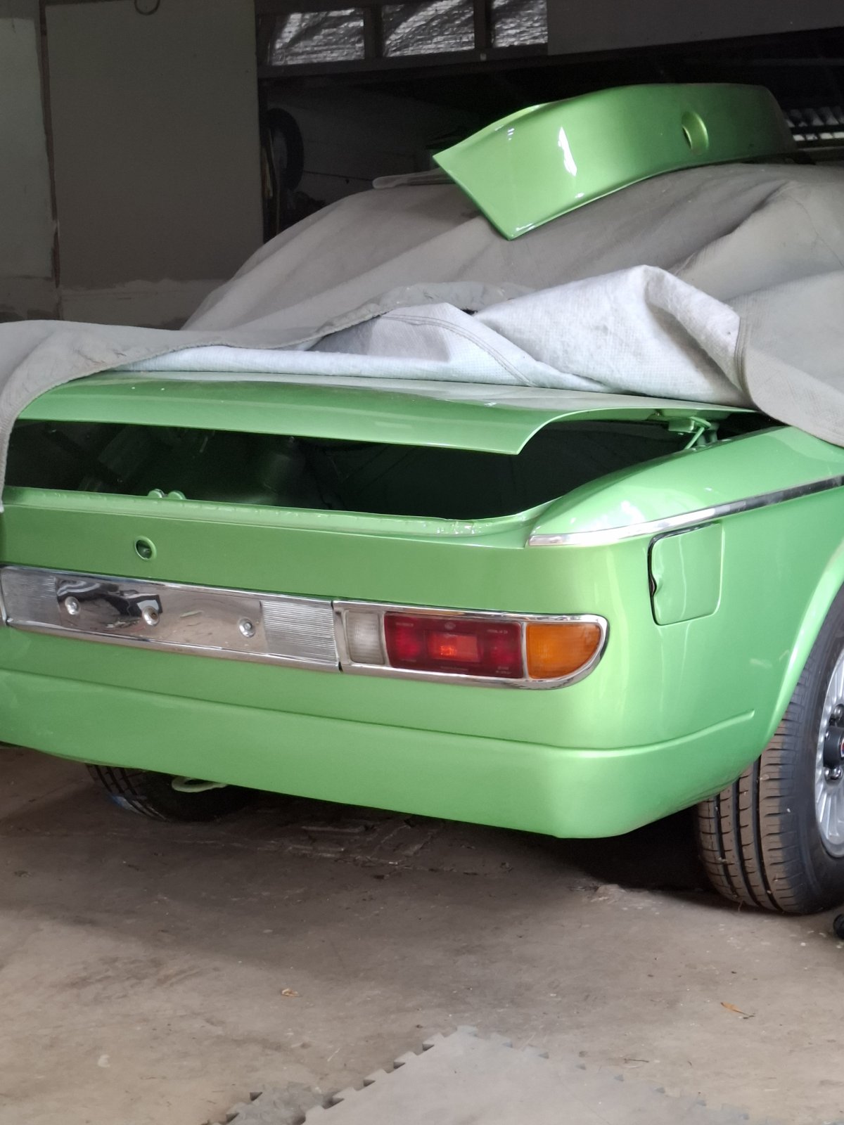

Also rear fibreglass bumper is ready to install but hoping someone can help me out with some dimensions to drill the holes for the brackets as the rear panels are new ones
Looking good!
Wrt the mounting points; are the reinforcements under the rear lights, inside the trunk, still in place? I think they must be, eventhough your tail panel seems to have been replaced.
These internal brackets define the height of the bumper.
All that remains then is the width (are fiberglass bumper 1 or 2 parts?) and the 'pitch' up/down of the corners that wrap around on the sides.
Width just follows the curve of the car.
For the pitch, it is mainly a visual thing. I had to overdrill the side holes of my car slightly to get them to sit nicely. Originally they are 8,5mm holes for an m8 bolt, but I drilled the holes to 10mm so my bumper-end could be lifted ~1 mm to get a nice horizontal appearance.

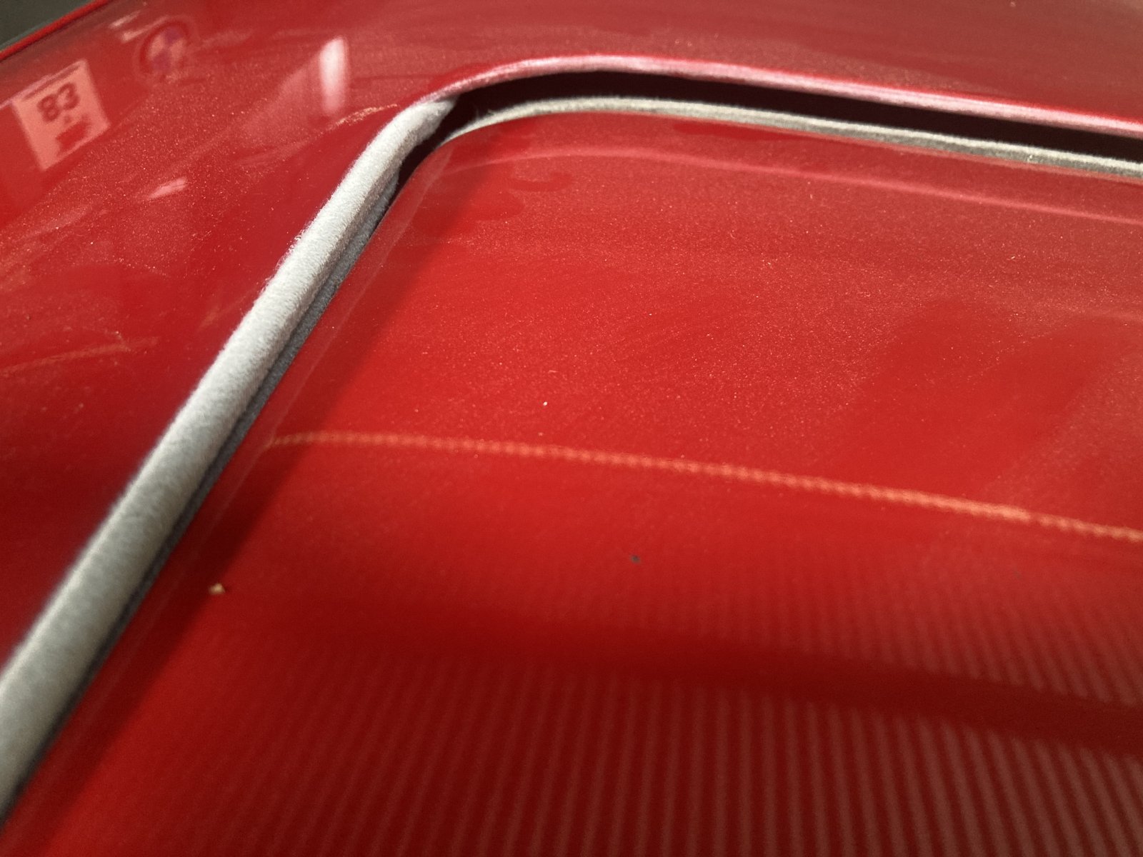

Should be one long one which slopes into the cavity on each side and one shorter one on the back edge of the sliding panel which slopes down after coming round the back corners to overlap the slopes of the long piece. Mine is not quite right, I replaced the long one as it was way too high when I got the car, but its still a bit high. Didn't replace the rear one which requires removing the panel, but I think it doesn't come far enough round the corners. View attachment 171801View attachment 171802View attachment 171803

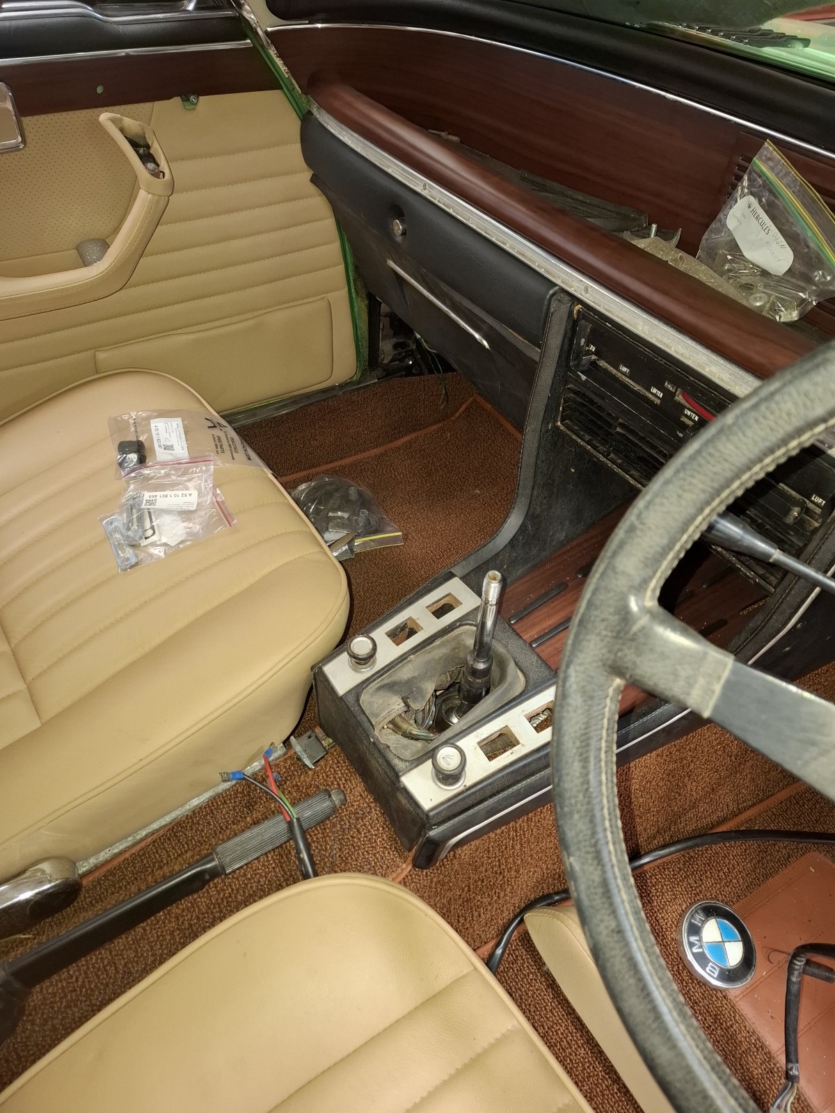

Making slow progress but my next issue is the 5 speed gear lever. I have installed the original e9 one. Should I have installed the 5 speed one. The lever is in neutral in the picture

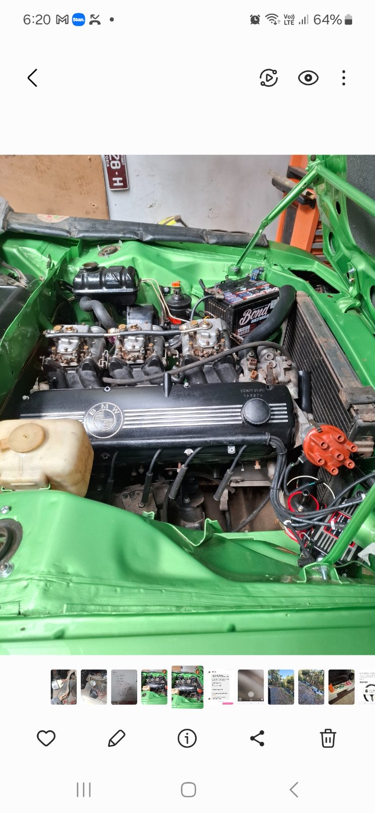

Slow progress but I decided to fit the 3.5 with the triple webers, may put the fuel injected one in my e3 si.
Got to get an exhaust but thinking I might get some headers for it rather than the cast manifold. Anyone know where I can get some from.

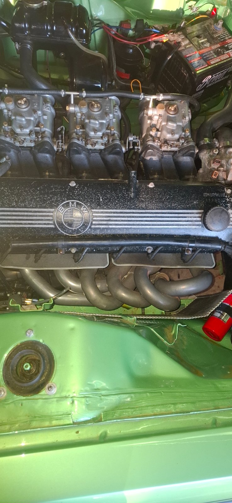

Been a long while but I had some extractors made. Car is now running but hasn't been on the road. I need some filters and was considering the alpina air box.i assume i will need some sort of angle trumpets to feed into the airbox. Are they available
