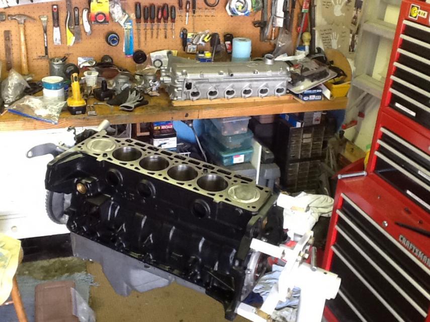

Update
Five months later the block is back in my garage and she's a beauty! Still collecting new parts, I may not pull the old motor until September, too many fun drives to enjoy before then. I will put the head on and get everything ready though. And no, my garage is not as pristine as Gary's, damn it.
I shipped Scott's car today- I expect you to make yours even better....
