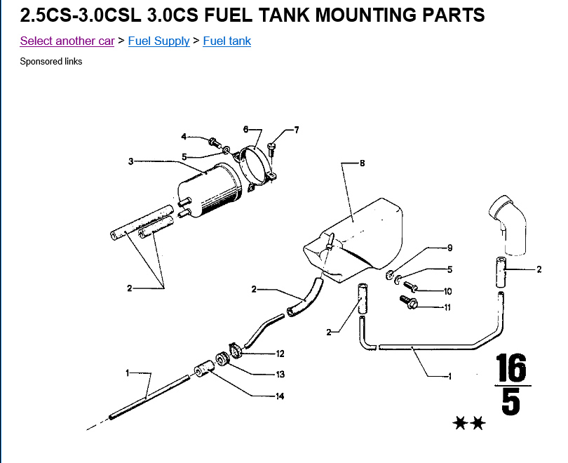

  • Can't tell what this part, see image below, is for? Any ideas? Benny doesn't know where it came from, but seems important.

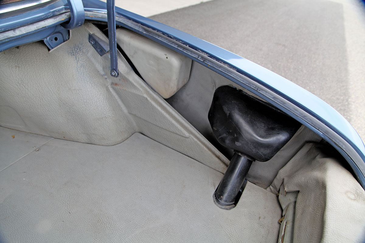

That part is the fuel expansion tank. It goes in the trunk compartment, on the right hand side as you are looking in the trunk (same side as the fuel filler). It tucks in behind the quarter panel. Photo of someone else's car for reference:

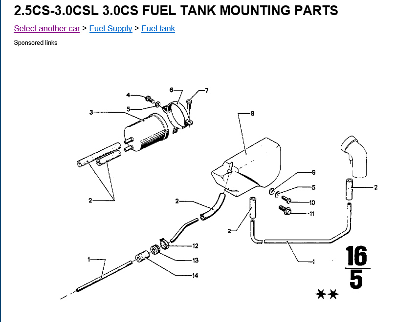

Here's a diagram of its operation (part number 8):
It seems a lot of folks manage to remove this from the assembly. I do not know what is involved with that modification. Hope this helps!
What is the benefit to removing it? Is it necessary?
I wish I had a more comprehensive answer for you. I think it has to do with the overall fuel delivery system - if you use the stock/original pump, canister, carbs and/or injection, ect, this component is a necessary part of that system's success (breathing properly). I can tell you that my expansion tank is currently removed, and the car smells of gasoline all the time. I believe this is because this vapor evaporation tank (and also my charcoal canister) have been removed so the fuel vapors have no where to go but into my trunk/garage.
Only if it's all hooked up correctly which includes the plastic line through the passenger compartment so check that if you want to keep it. I bypassed mine out the trunk floor.
Don’t remove it, it draws gas fumes from the gas tank into the carbs.
