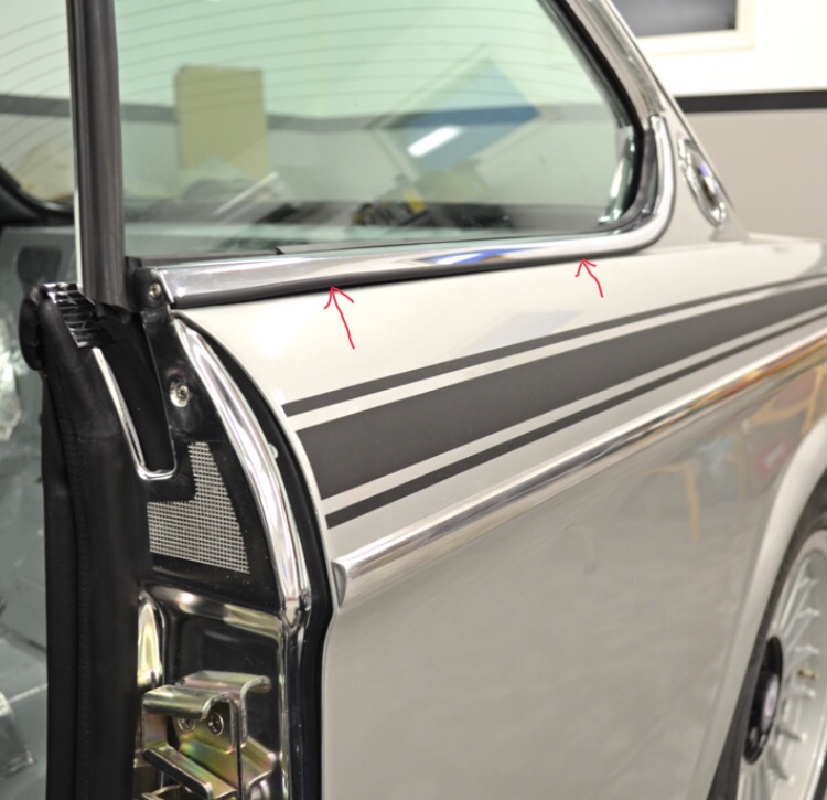

I think the rubber strip you are looking for is -
https://www.wallothnesch.com/en/catalogsearch/result/?order=name&dir=asc&q=54129734126
The strip is a small, narrow 'U-channel' measuring about 5mm or 2/10". I'd guess you might be able to push this onto the exterior chrome window frames without removing them - I hope so!

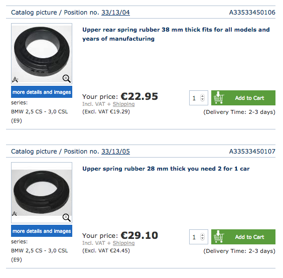

Scott, do you know if you have the 28mm or 38mm upper spring rubbers installed? That's an extra centimeter if you have the thicker ones.
If you have the thicker ones, you can have Benny & co to trim them down to 28mm or even a bit less than that.
I searched for everything ordered but didn't find either part referenced. I will need to ask. I think perhaps i did this bit much earlier but seems unlikely. I will ask Les Schwab?

  • the thin black rubber trim that goes under the door and rear side window chrome sills missing?
    9Iw_9YszIOube2pJJXD7RJIQvwGBRJwcYhpr-1wo5_ILYYrCJBBpineOcaRvH4vwGf6pcDfOdoiIe2JXTmxQSCameJywW-PjjWFjqGe4-HCIGIwsSWAvIvNLTIAd-oGt1kwBLcqw
