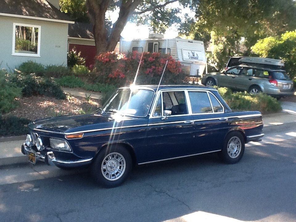

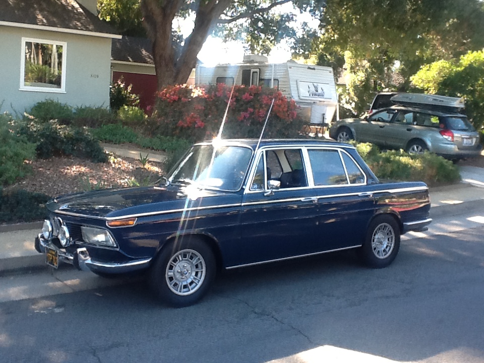

Those wheels were made by FPS in Italy for BMW, I have a set with four bolts on my NK2000 sedan. They also came in five bolt as shown and could be purchased from BMW back in the day.
