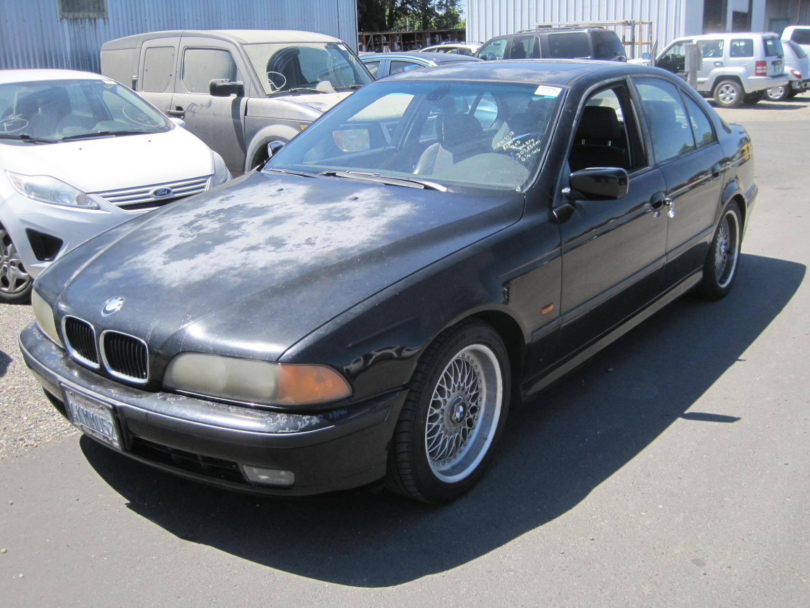

This scrap car was $100. The owner drove it to our place... 207k miles, bad paint, bad interior, needs cats. I'm buying the wheels for $100 and they'll get around $200 for the car in scrap. We don't try to buy scrap since we don't have a good process for it so we usually offer $50 picked up or $100 delivered. Pick n Pull (self serve yard) can pay more because they're a scrap metal company and specialize in it. That means if they offer $125 for cars like that e39 (or nicer) they usually get them. Weird market right now.

This is where/how all the 320iS cars went...for one example. All those Recaros, 5 speeds, and 3.90 LSDs crushed and made into new cars. (this applies to most all of the old cars) In hindsight, we'd have pulled all the good bits and hoarded them decades ago... I see 320 LSDs now at $1000 on the open market. Crazy money for a used/used-up diff.

The one good thing is that typically the self-serve yards can pay a little more so most of those cars end up being picked over before getting crushed. The Recaros in my coupe are from a PnP 320is, along with the other sport parts in storage from years of hoarding. Markos is not the only parts hoarder even though they've put up a statue of him in the local square.

Wow, $100? If the car ran decently, I'd put on some cats (can you put cheap universals on???) and just drive the sucker until the wheels fell off.
I have those RC090s on my DD E39Touring and have picked up used ones from time to time. Of course they are rebuildable, but you have to know if a wheel has been "turned" before. The nice polished lip gets turned and recoated. Price varies. But if it has already been done once, some places will not do it again. Some are bent, and this is fixable too, but adds to your cost. So, choose carefully, as these have a lot of mileage on them by now, but I cannot stop looking for another pair, or that rare and special find, the unused trunk spare! Mike
