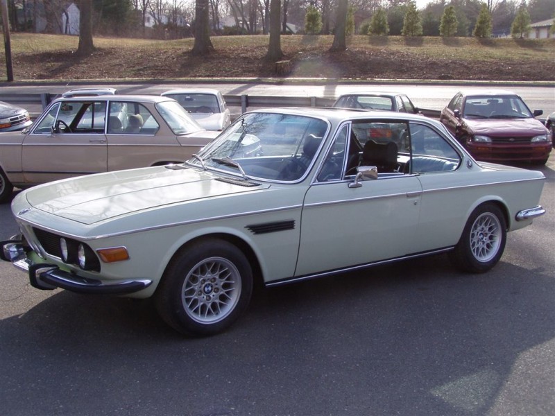

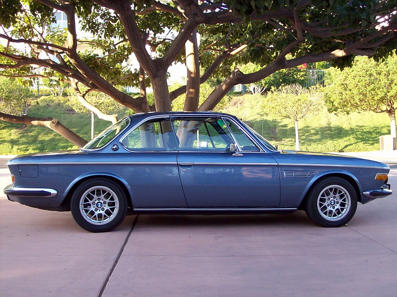

while i tend to agree with you on the modern look ... too modern? here is a pic of a coupe with them.
these are a BMW wheel ... similar to BBS that look similar + less expensive
an affordable wheel is the style 5 wheel. you can still buy them new for 235 or so plus caps ... but they are covered.

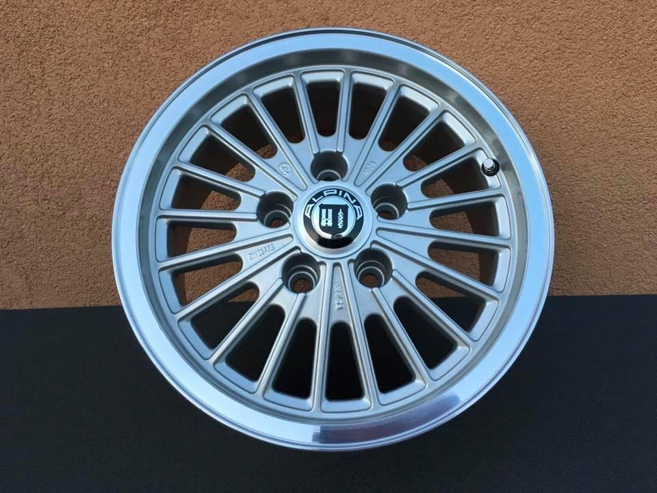

I had them in 15” on my coupe until I recently downsized back to the less modern 14” Alpina's. They are available and still mounted to 205’s with lot’s of tread life if anyone is interested.
