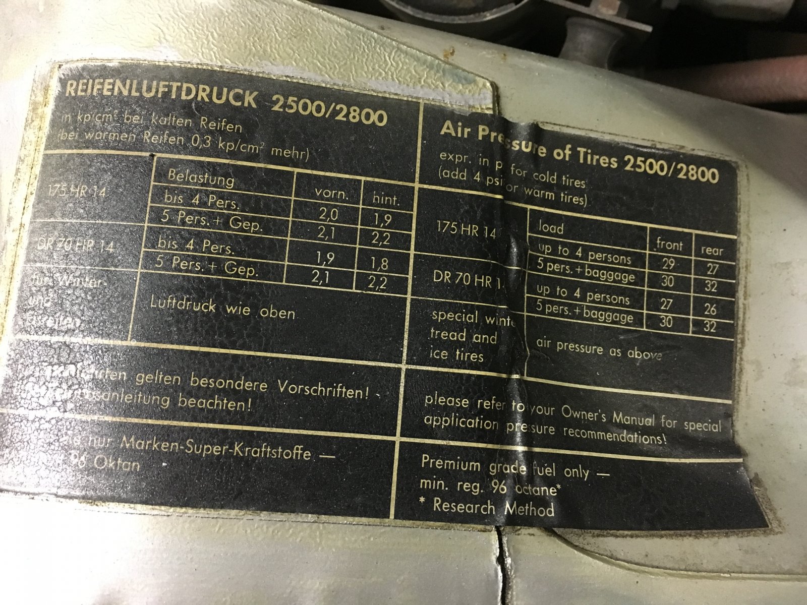

175-HR14 was the original tire in 1970 for the e3 and e9, even the 3.0CS tire sticker lists this tire plus the 195/70-14 tire which was ordered on US 3.0 coupes.View attachment 96541
Chris the 3.0 tire stickers I’ve seen only list the 175 size for a snow tire with the 195 being the standard. You’ve seen otherwise?
Mine only has 175hr14. This thread shows a bunch of stickers with various tire sizes, but all for coupes. Maybe those heavy two doors needed bigger tires!
Luis, See my thread here:
Tire stickers on the US 3.0CS showed both sizes until 1974 MY when only 195/70 was displayed.
