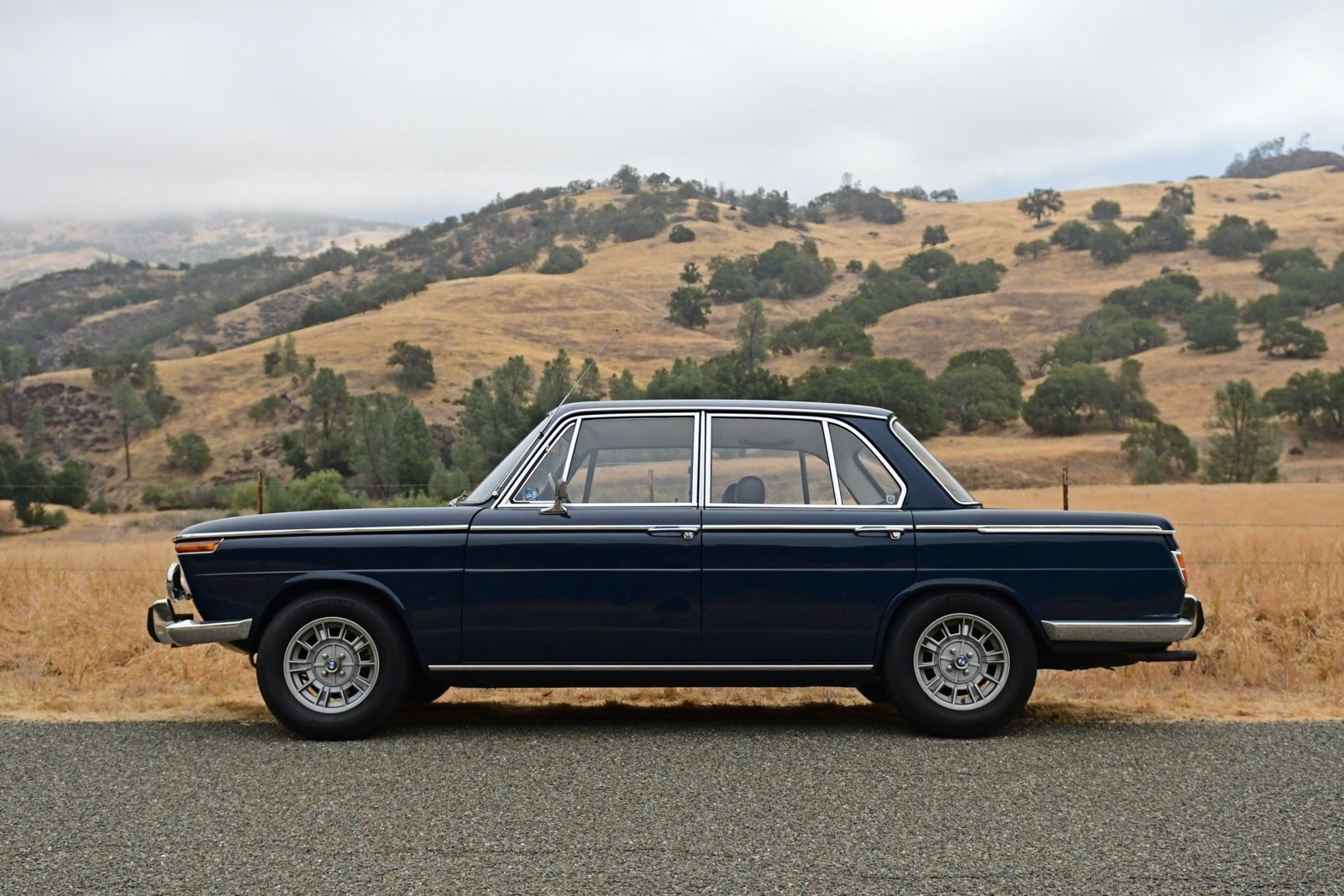

Wheels, tires, ride height and stance are purely personal choices. We all have valid reasons for the choices we make. I outlined the reasons for my choice of 205 70 14s in this thread in posts 16, 20, 22, and 31. The only objective things I can add now that the car is on the road is that my speedometer is dead nuts accurate to my GPS at all speeds and there is no issues rubbing fenders or suspension parts at any time.
BTW, my one pet peeve on wheels, tires, ride height, stance, is using a tire with not enough sidewall to fill the wheel well at least as good as done by a stock tire. It's a little tough to get a low profile tire on cars made before low profile tires were produced to look "right" (to me) without lowering the car. Otherwise, the car (to me) looks like it's pants are too short and its socks are showing :(.
Thank you Mr. Steinkamp. I appreciate your insight. Although I like to throw it around a little, I'm more interested in a comfortable but planted ride for myself and passengers and thus I'm attracted to the 205/70's. Plus my wheels show a lot of rim edge even with 195/70's (not that 205/70's will help that much). Currently I need to refrain from much spending so I'm considering some of the lower prices tire options. I'll let you know what I land on.

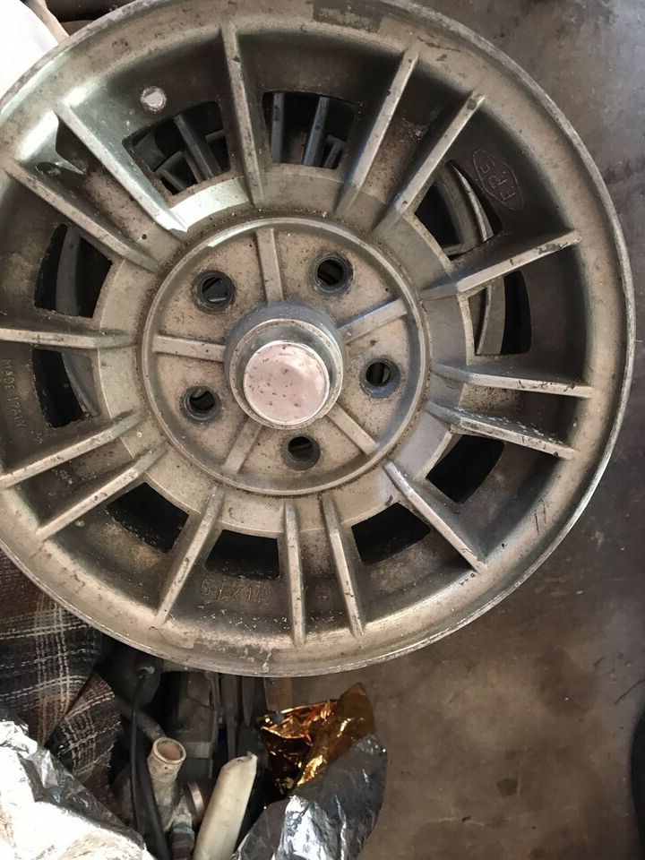

I don’t think the load index will be noticeable. And for those that have noticed, Frederick’s wheels are the ultra rare fps alloys that were used on the even more rare Frua coupes.
love the car + wheels Chris ... really look.

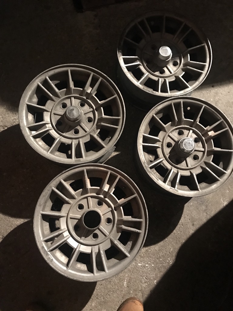

He has the only five lug set I’ve ever seen and I have the only four lug set as well. We are very fortunate.
I have a five lug set as well. I found them on Ebay Kleinanzeigen. Only recognized them because I saw them on your car, Chris.
I'm not particularly looking to sell them, but I'm also not going to use them anytime soon, so if someone needed them for a special car, I would gladly pass them along for what I paid for them.
