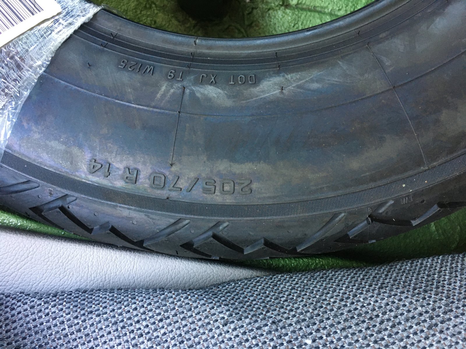

Coincidentally, I need new tires now. Fancy that. What are the odds while this thread is going on. Yesterday I had a legitimate blow-out on the highway. Nothing crazy or scary but man it was loud. I think my hair curled a little more. I never saw the offending object but it caused a 5/8" hole in the tire. It was the drivers rear tire so it shimmied a little but there were no issues controlling it downhill to the shoulder. Now I'm checking out new tires and I remembered that Mr. Steincamp made the the leap to 205/70/14 tires. Hmm. Hey Richard, how does that size tire feel on your e3? Any issues rubbing fender wells when turning into a dip or drive way? They look great I must say. How's the ride?

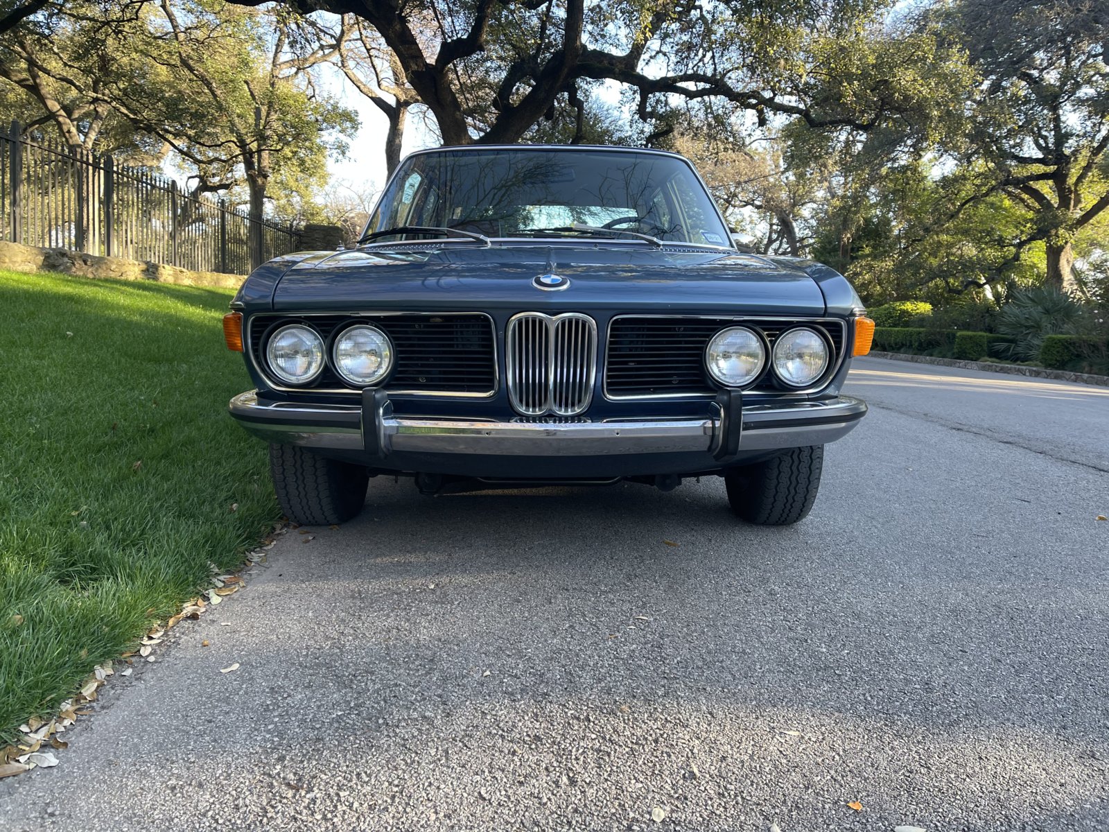

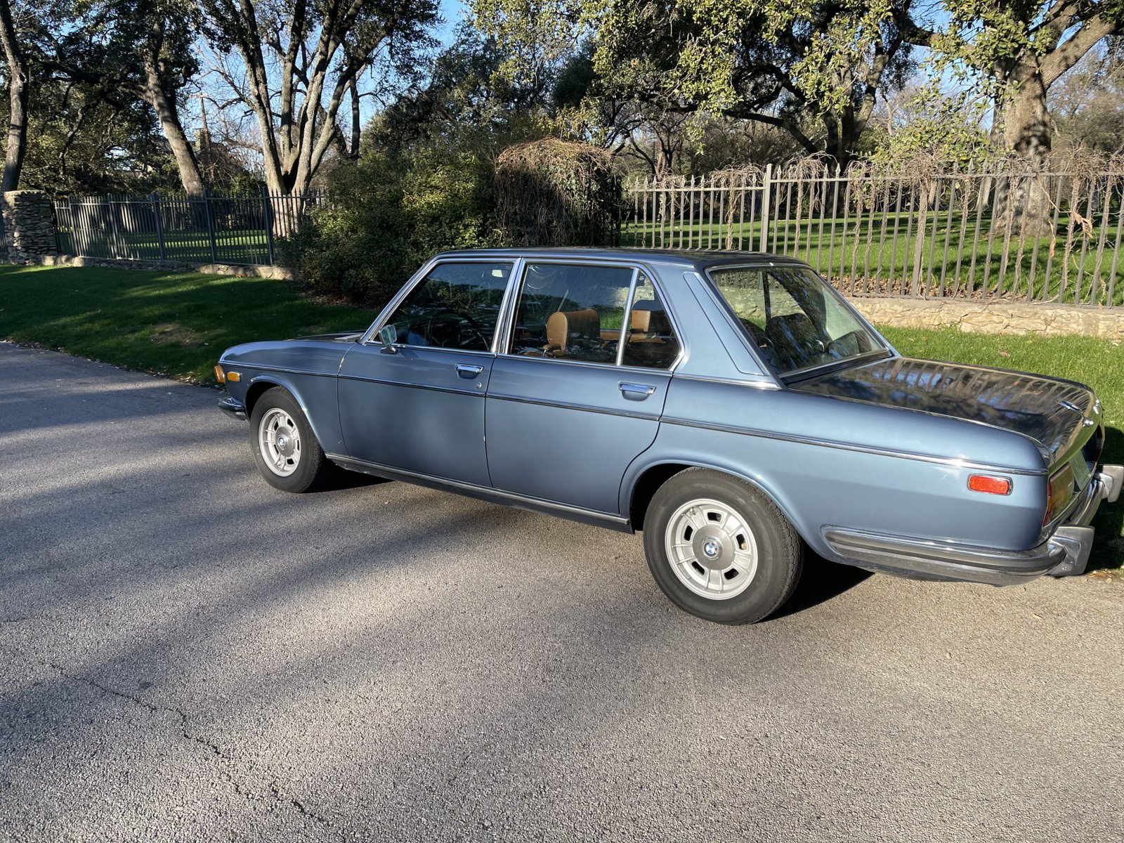

Wheels, tires, ride height and stance are purely personal choices. We all have valid reasons for the choices we make. I outlined the reasons for my choice of 205 70 14s in this thread in posts 16, 20, 22, and 31. The only objective things I can add now that the car is on the road is that my speedometer is dead nuts accurate to my GPS at all speeds and there is no issues rubbing fenders or suspension parts at any time.
I really don't have a good frame of reference for "feel" or "ride". If you get up this way Fred (or anybody else for that matter), you are welcome to take it for a drive to see what you think. The car has new KYB shocks and cartridges. The front suspension has been gone over and has new parts where warranted and is aligned properly. Stock ride height has not been altered. Wheels are stock steel wheels. Tires are Toyo all season touring tires. To me, the car drives like a BMW. Responsive handling, comfortable ride. I am sure there are other combinations of wheels, tires, ride height and stance that work better for other owners, however.
BTW, my one pet peeve on wheels, tires, ride height, stance, is using a tire with not enough sidewall to fill the wheel well at least as good as done by a stock tire. It's a little tough to get a low profile tire on cars made before low profile tires were produced to look "right" (to me) without lowering the car. Otherwise, the car (to me) looks like it's pants are too short and its socks are showing :(. A stock 175 82 14 has a 5.6" sidewall (exactly the same as a 205 70 14). A 195 70 14 has a 5.4" sidewall so the tire is about 1/2" shorter. Probably not enough to make much of a visual difference. A 195 60 14, however has a 4.6" sidewall and is 2" shorter than the stock tire. To me, the car needs to be lower if that tire size is the choice in order to get rid of some of the air between the top of the tire and the fender lip.

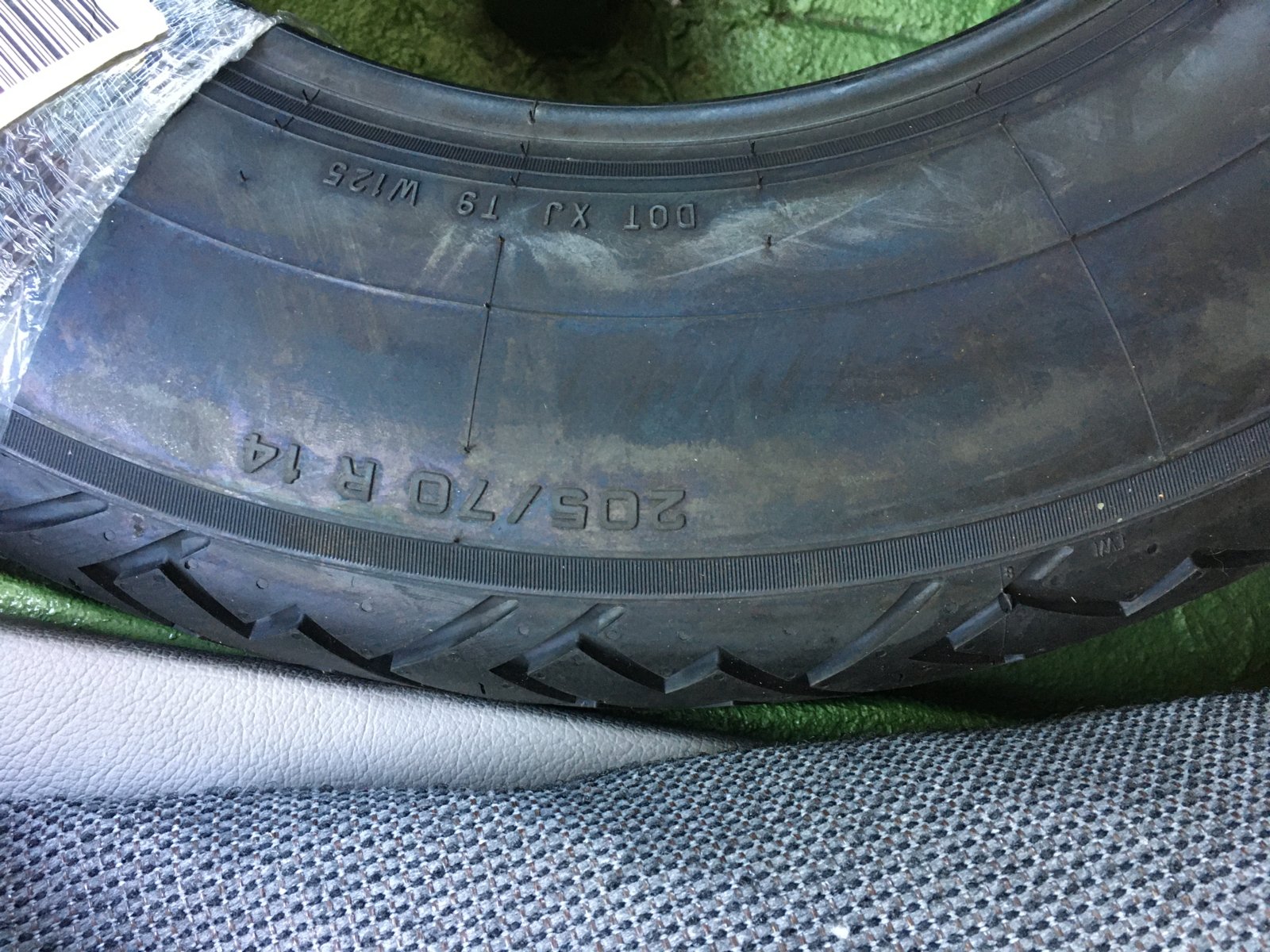

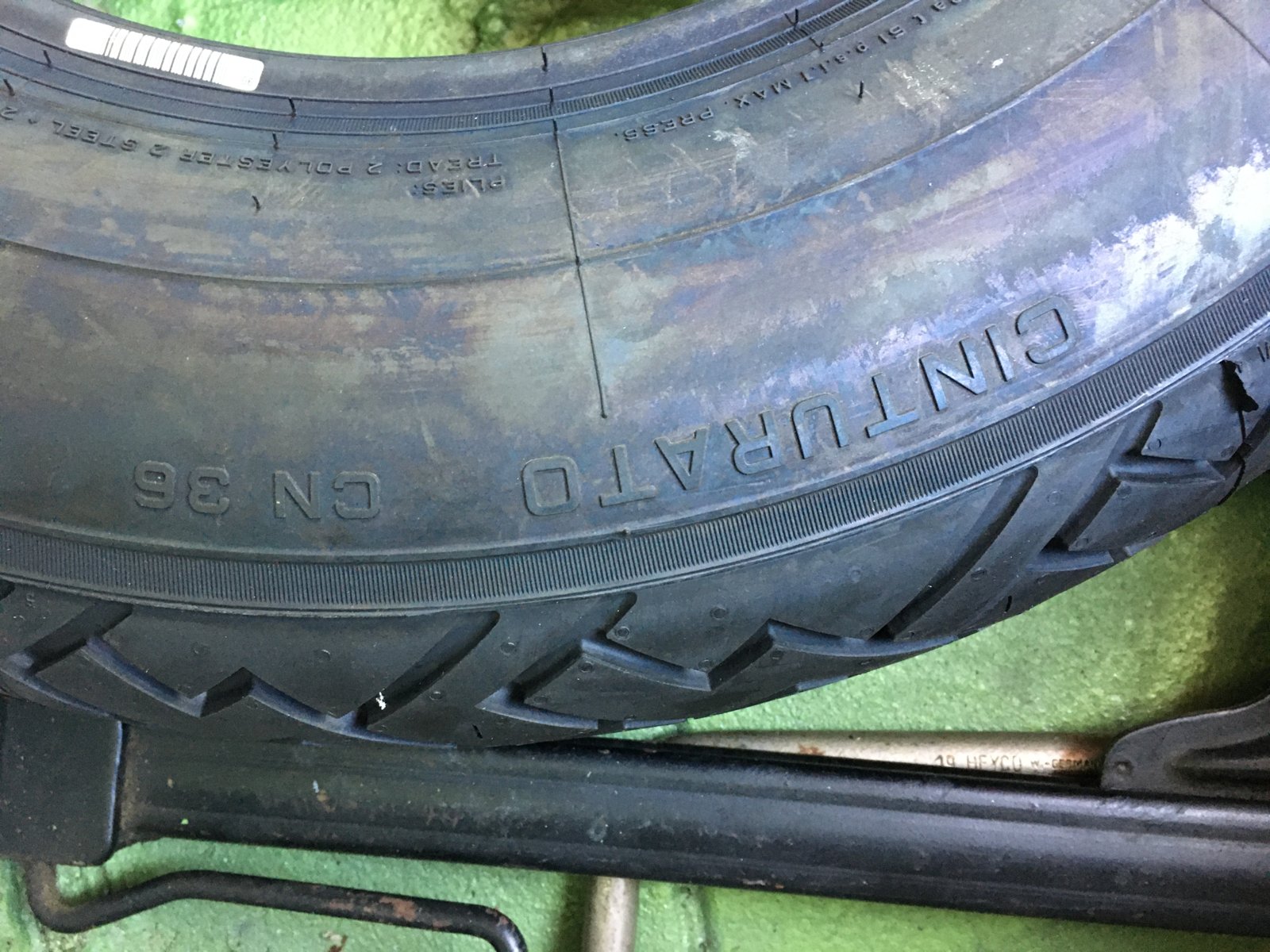

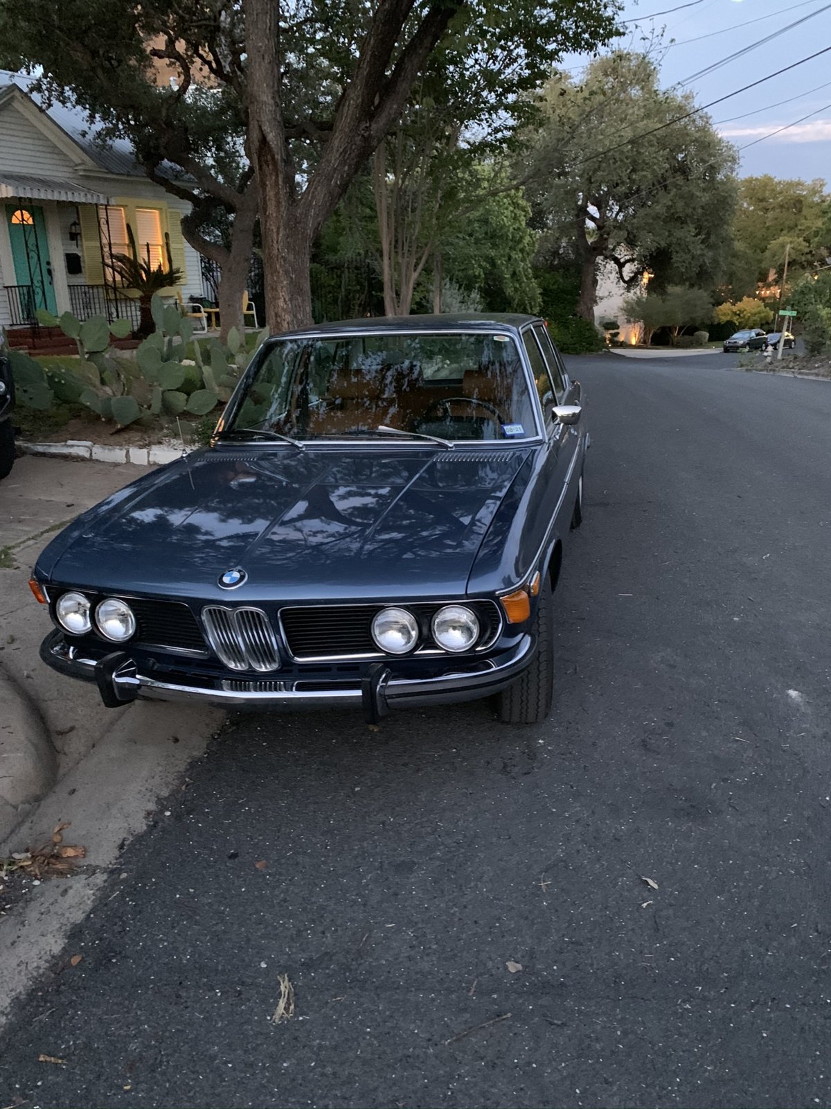

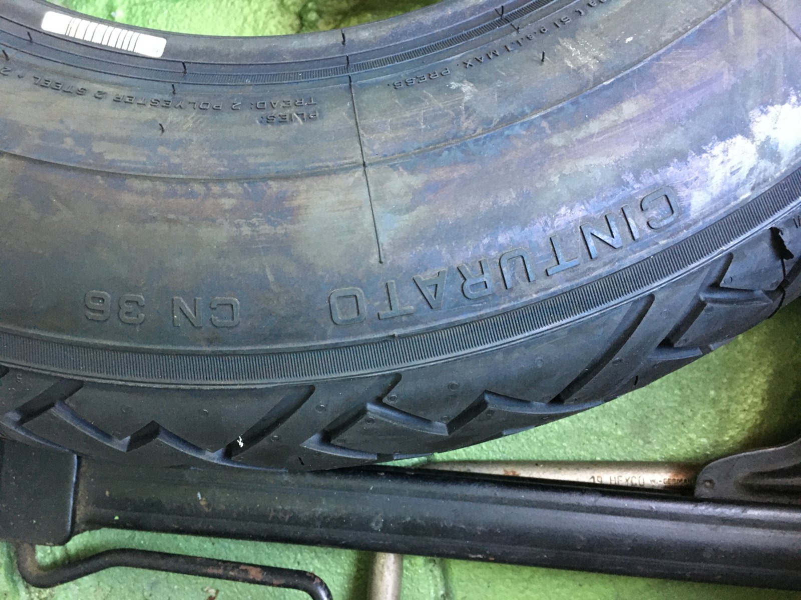

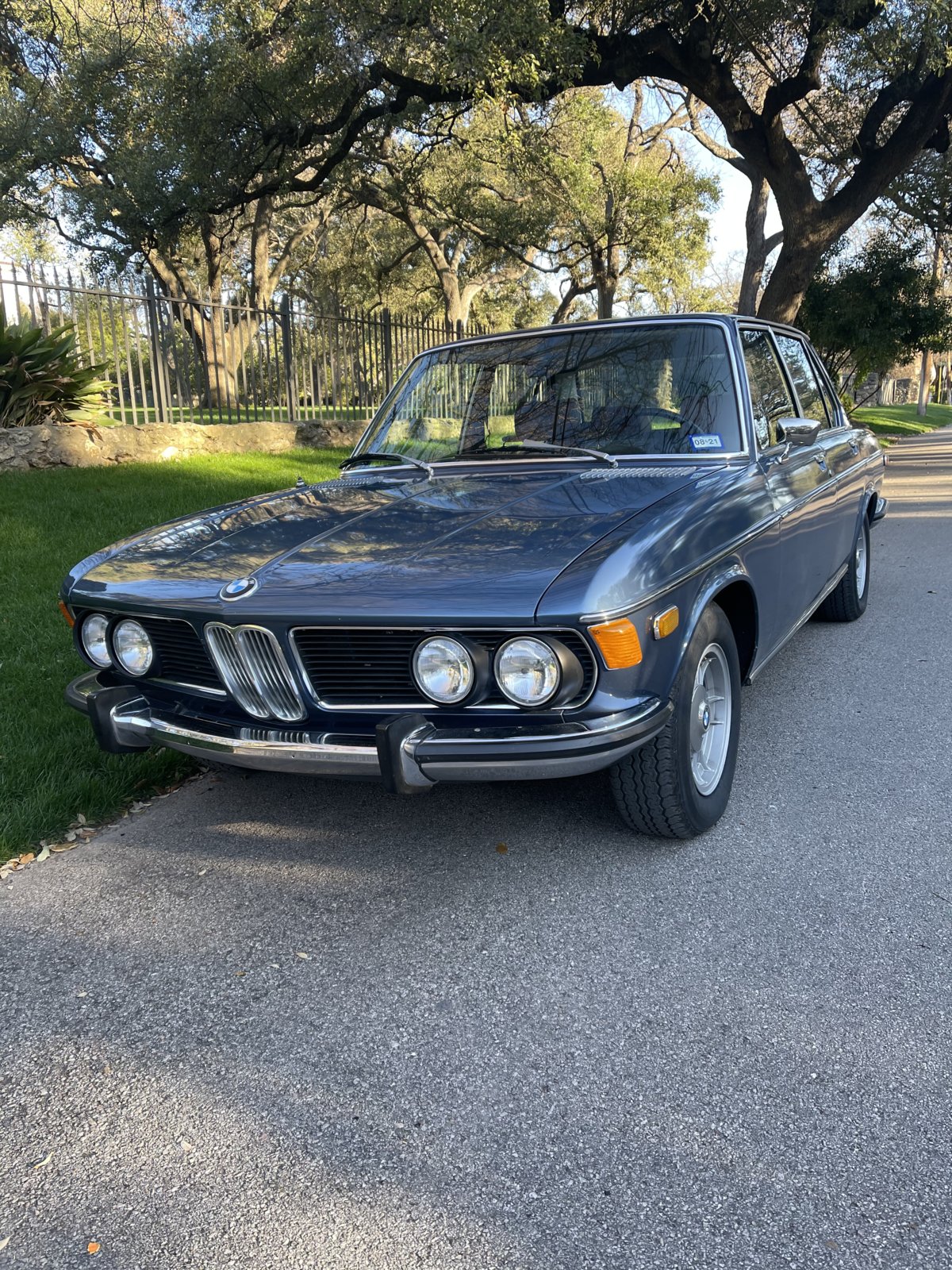

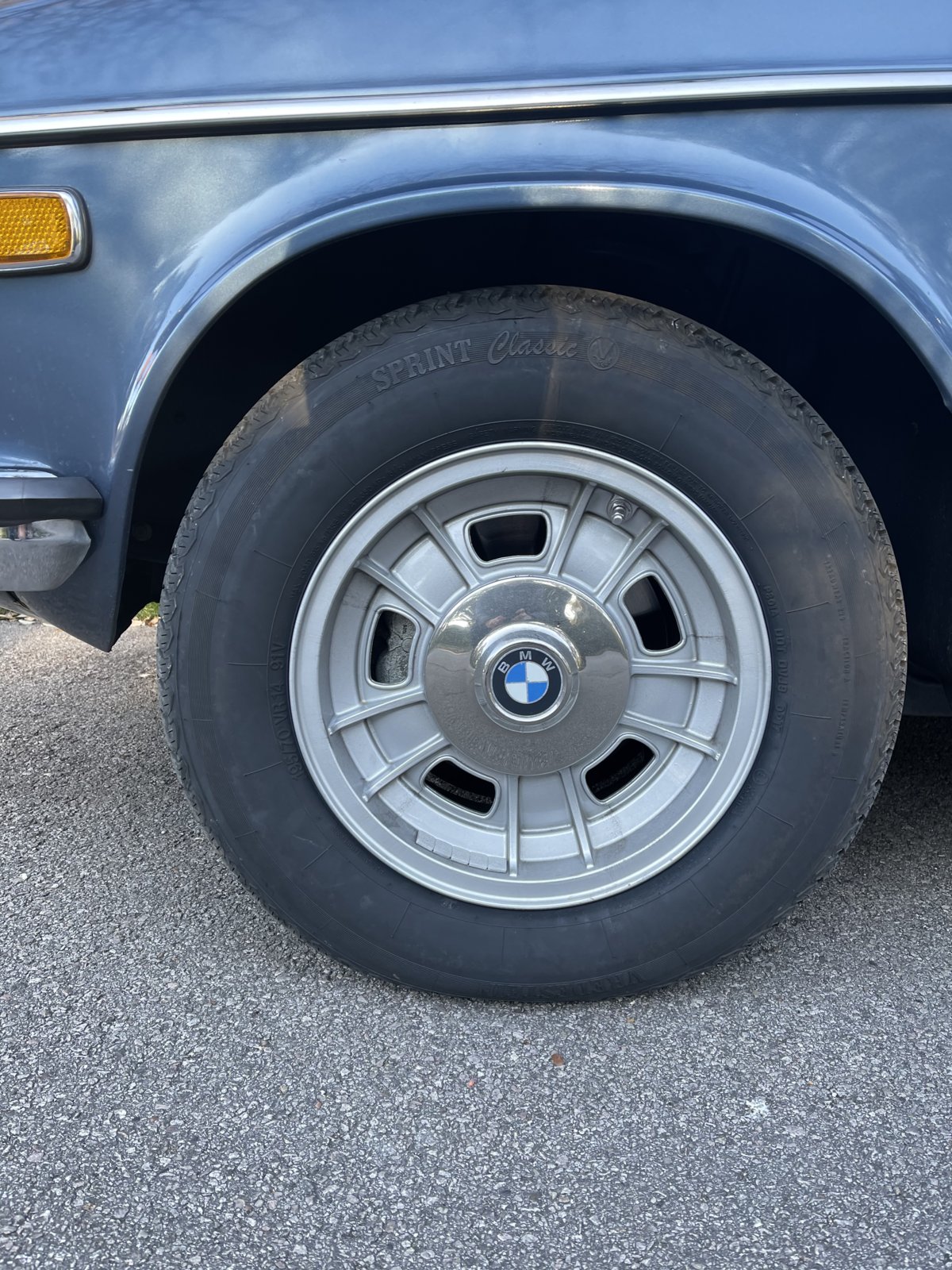

@GPD - Here are photos of the car with Vreds. Tires ride and grip well. You can be the judge on looks. To me, they aren’t as unique looking (today) as the CN36’s on my Fjord 2002. But, I don’t notice them - in a good way.
195/70 VR14
I have more, if you want another angle.
Something is wrong with me. I can just stare at these photos unaware of time. Another beautiful car. With great looking wheels.
Thanks.

The closest you are probably going to get are what AustinOski is running. Vredestein Sprint Classics. They are not under $100, They are still classified as a Grand Touring tire but they have a soft tread compound and are "stickier". They are summer only tires, however, and can't be used when temperatures approach freezing.
