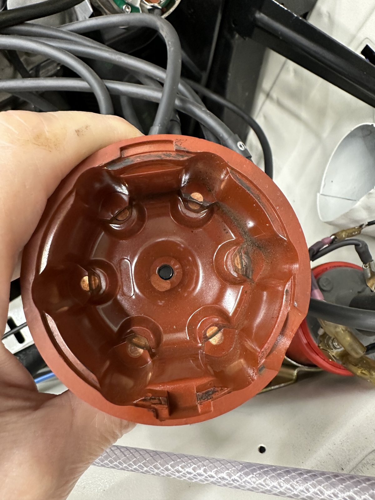

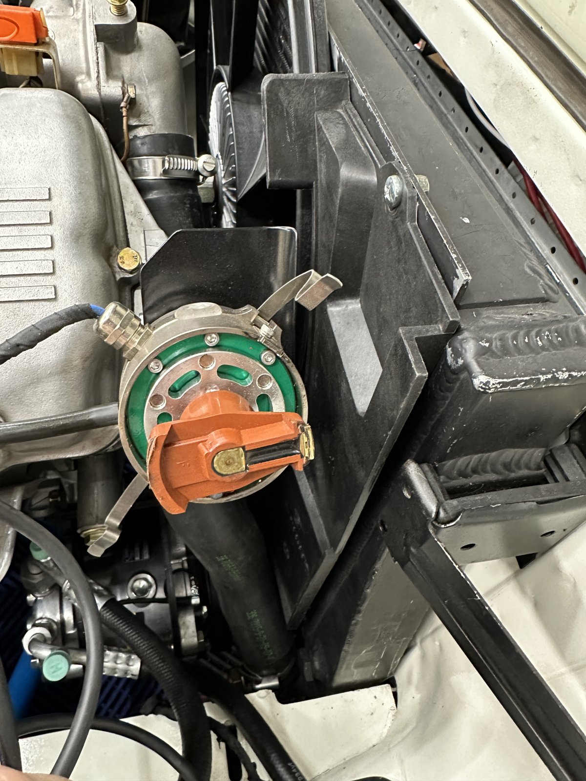

The distributor cap (123 ignition) was moving while the engine was idling. Not engine movement, but the cap itself was moving. It appears that one of the spring clips had lost some tension and the rotor had backed out and was rubbing on the cap. New parts needed here as well, and given that I only have about 1,000 miles on the system I wrote to 123 to share displeasure. Will see what they say.

The 123 weak cap springs are a common, ridiculous design flaw. Take some long nose pliers and bend the clip about halfway down to increase the “snap” pressure on the cap. Every year I redo this. Absurd that they continue to use this clip despite the numerous complaints over the years.

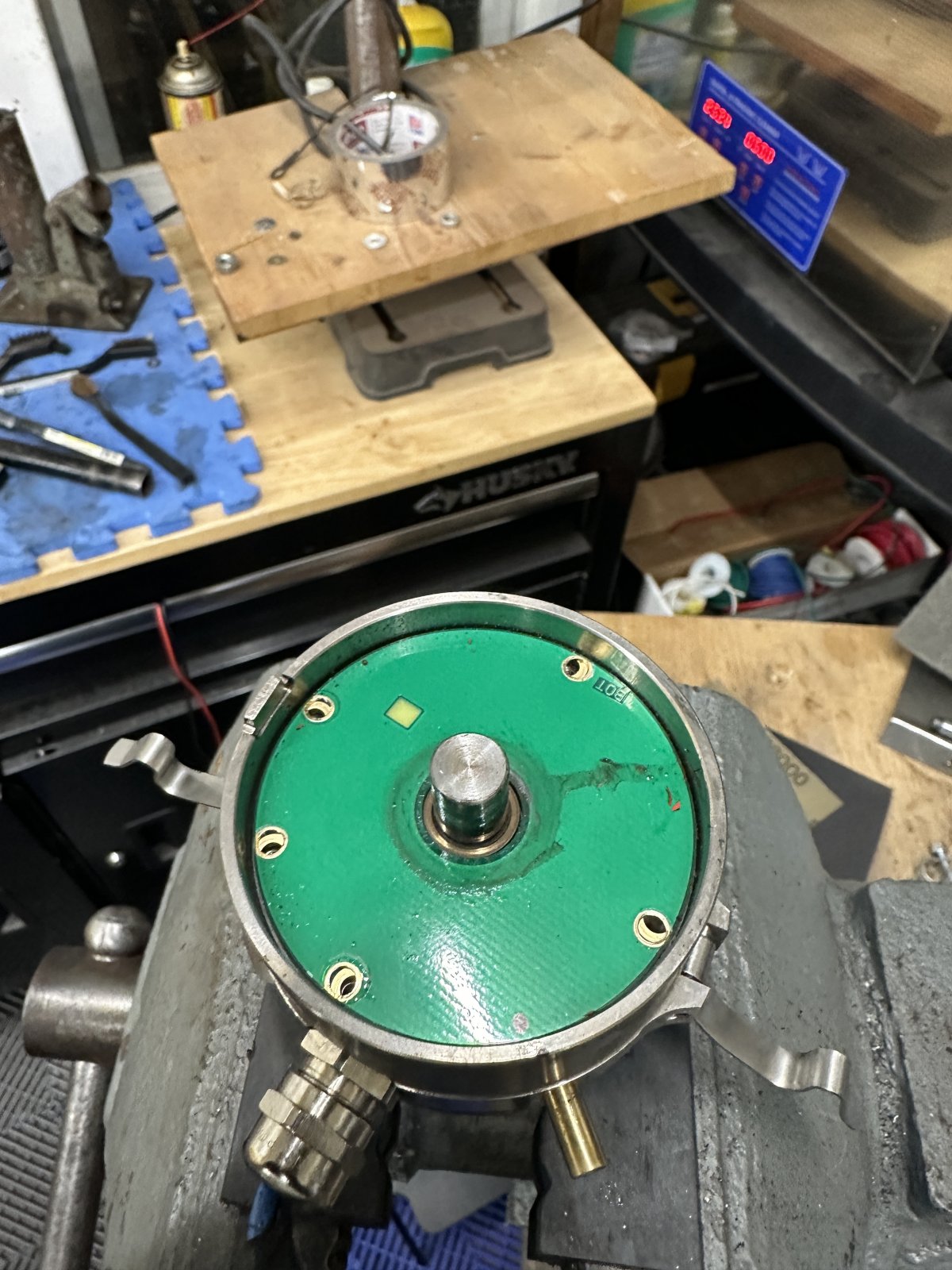

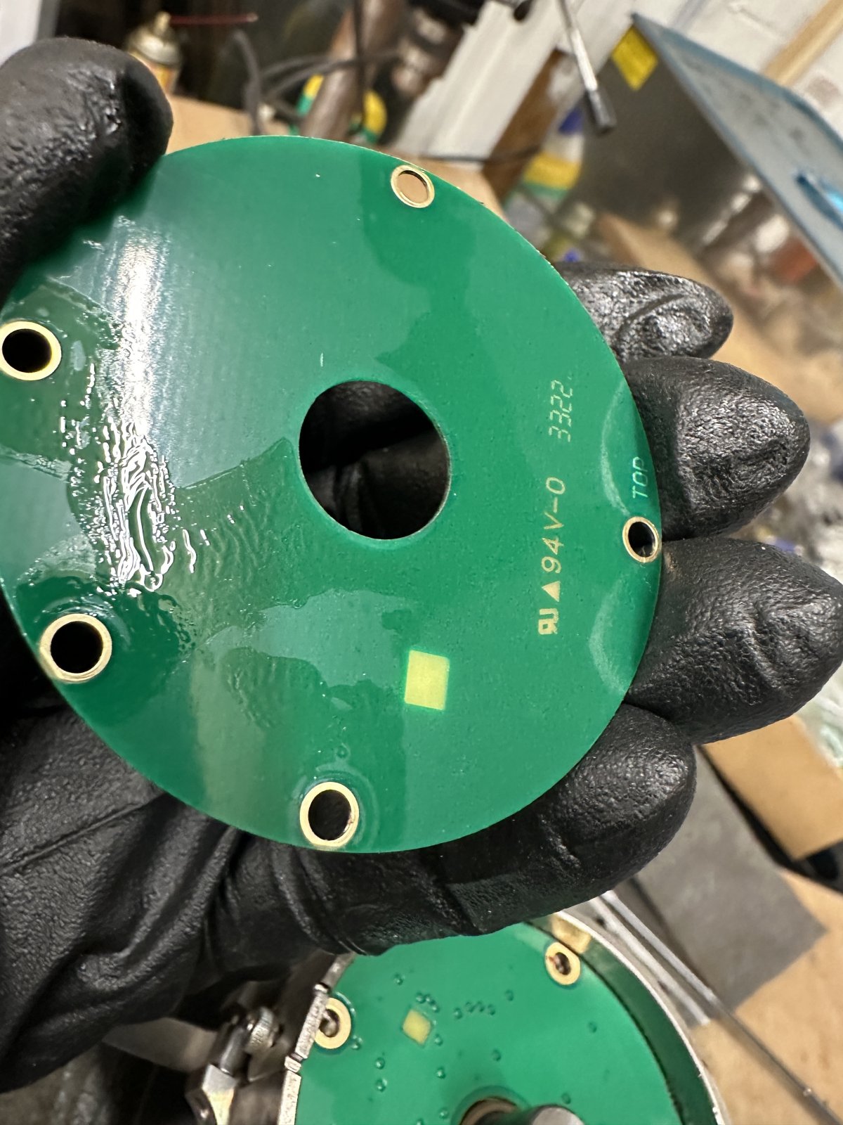

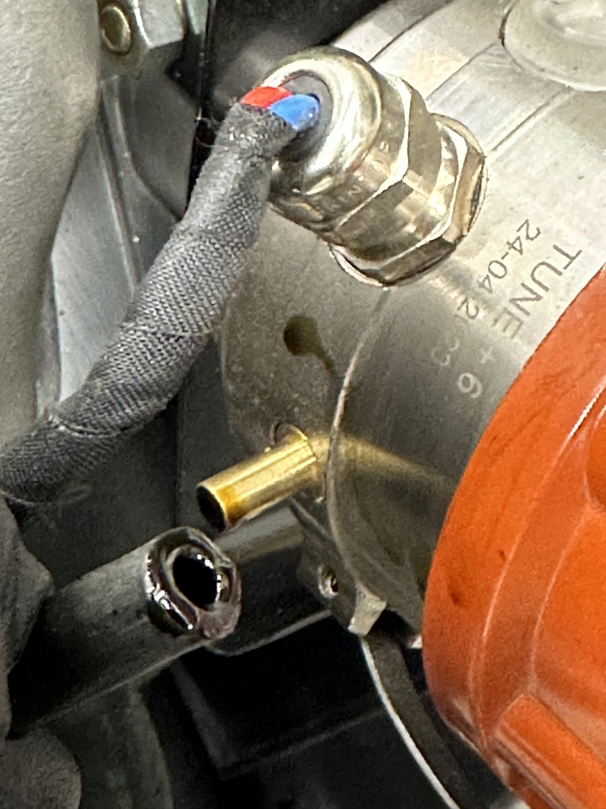

Since I am waiting for parts to rebuild the carb and repair the distributor I decided to use the time to loosen and re-torque the head bolts. Also pulled the 123 Distributor when I found some oil present at the vacuum advance fitting. Distributor cleaned out and ready for the new rotor and cap.

That’s strange to see it at the vacuum port. Did you check the little blue tube inside that it is still connected to the circuit board?
