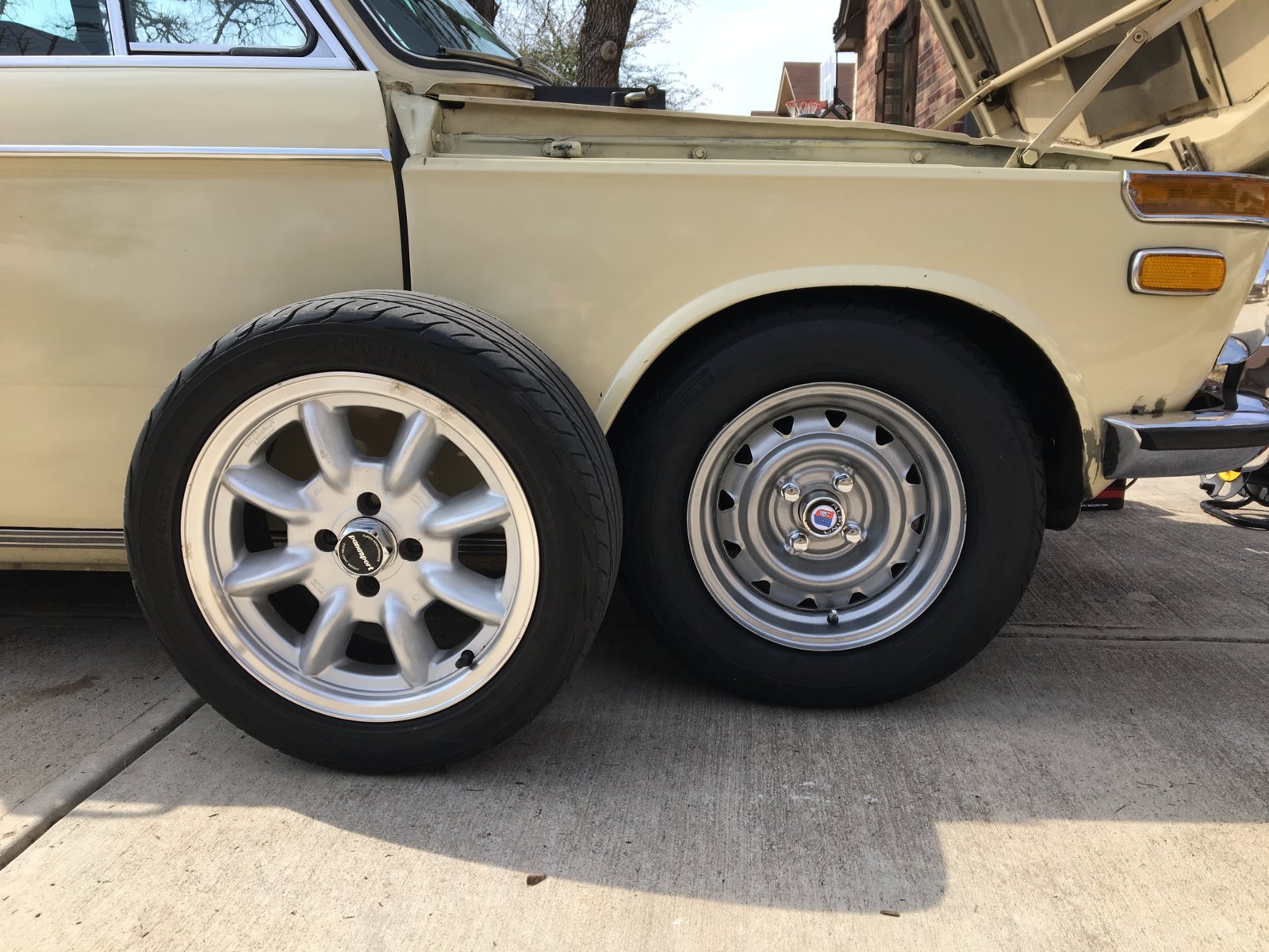

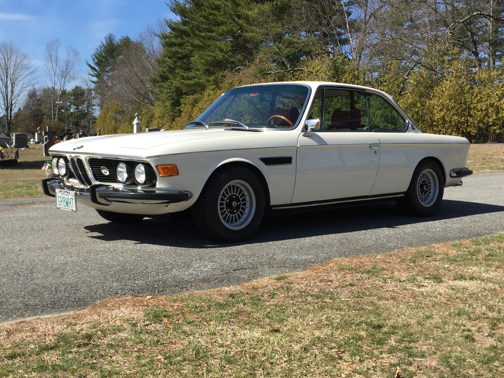

Last year I swapped out my 16" staggered Alpina/Coupe King rims mounted on Continental ExtremeContact's for 14" Alpina 14x7 with Michelin XWX 205/70/14 tires. The ride was greatly improved. Not nearly as harsh over rough pavement resulting in a much more compliant road feel. Another bonus is the great period look which IMO is an esthetic upgrade over any 16" wheel.

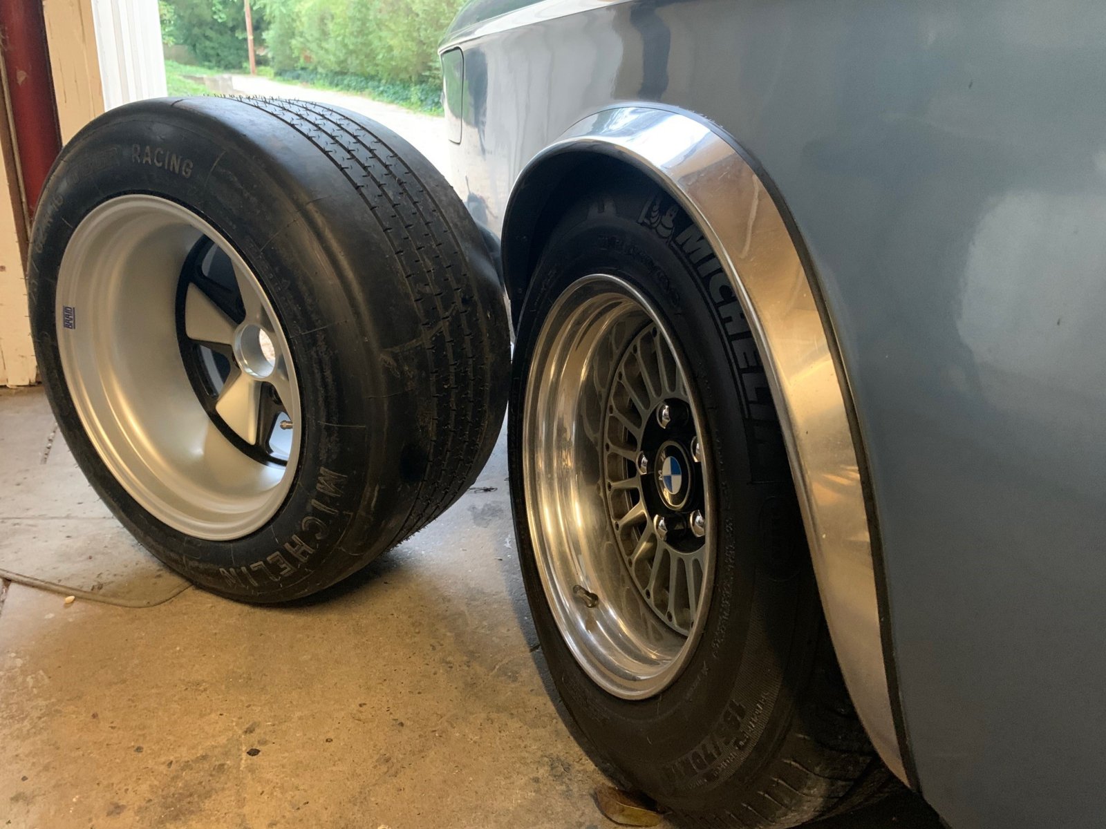

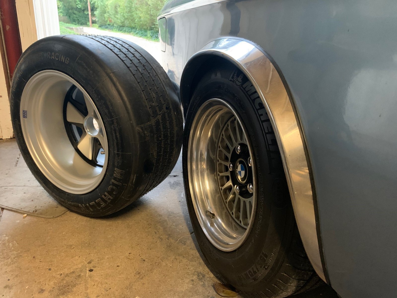

Here is my 14x8 custom Weds (modified from a 14x7 with extra outer lip) with a Michelin Defender 195/70/14 and the 15x11 rears waiting to go on my 911. Small diameter and big sidewalls...it's the new black.

Those are the TB-5,correct. Everyone always gets the 15s which I always wondered why not the 5s if you aren't looking for rain. Beautiful wheels.
Who did the RSR finish?

Yep, TB5’s. They look great but not many other options!
They are Braid BZ’s, so their stock RSR finish.

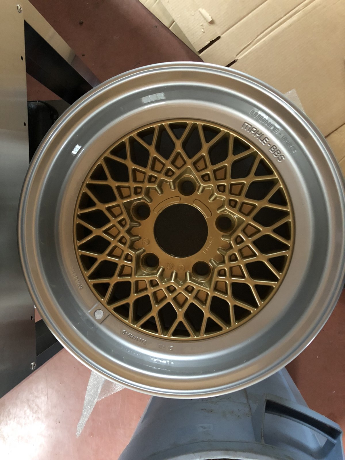

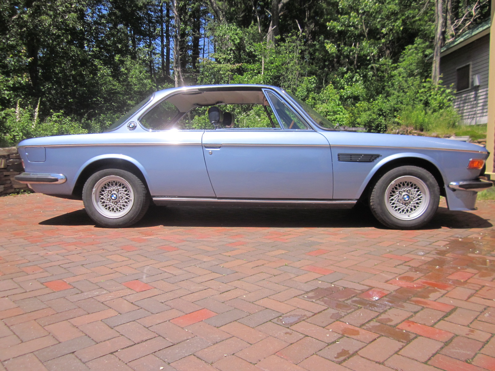

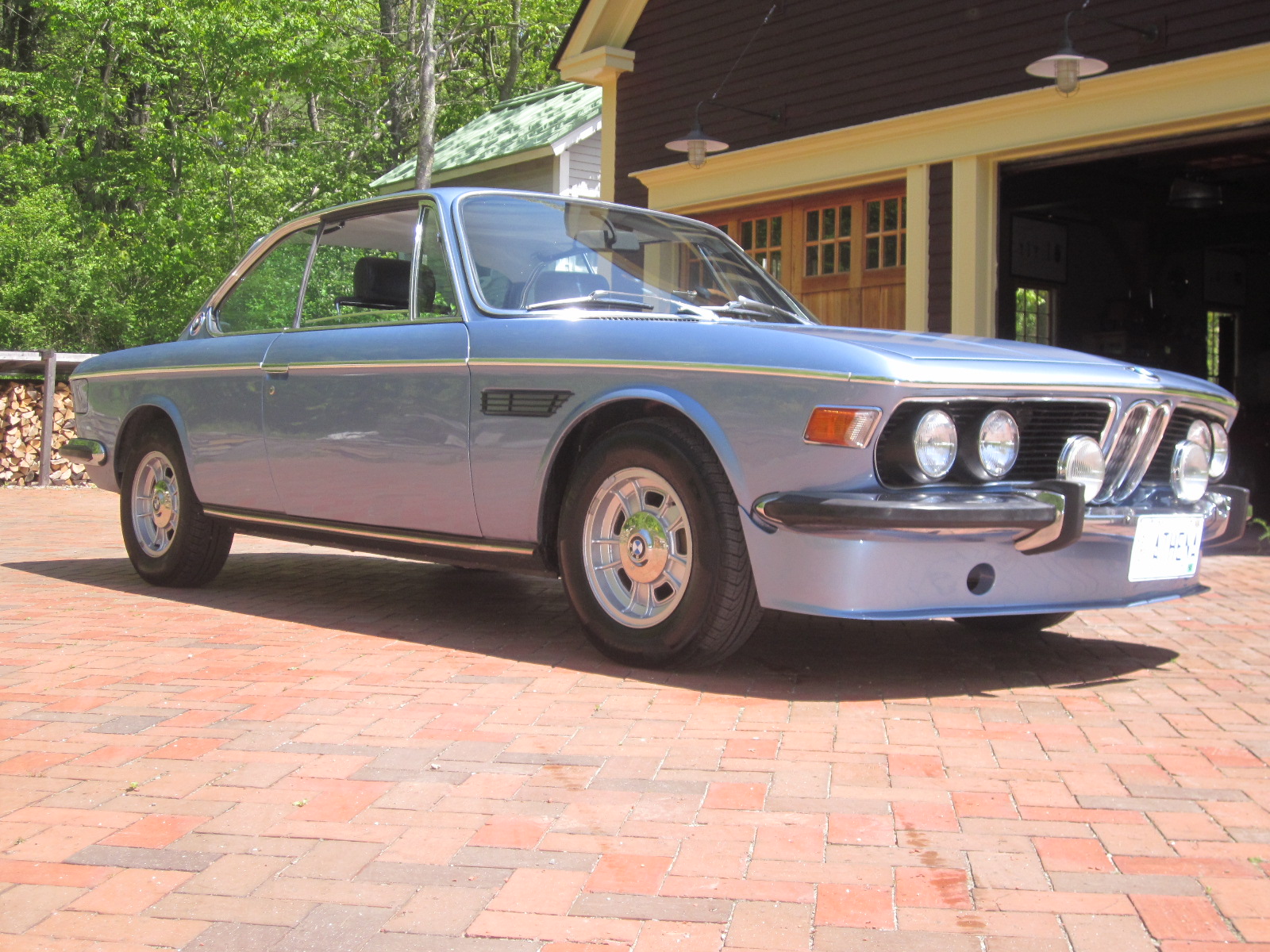

I have 4 sets of wheels for Athena.
14 x 7 Silver BBS Mahles (For sale $600)
14 x 7 Gold/Silver Painted Lip BBS Mahles (For sale $700)
14 x 7 Stock CS wheels (keeping)
16 x 7 Silver w/Polished Lip BBS RS (keeping)
