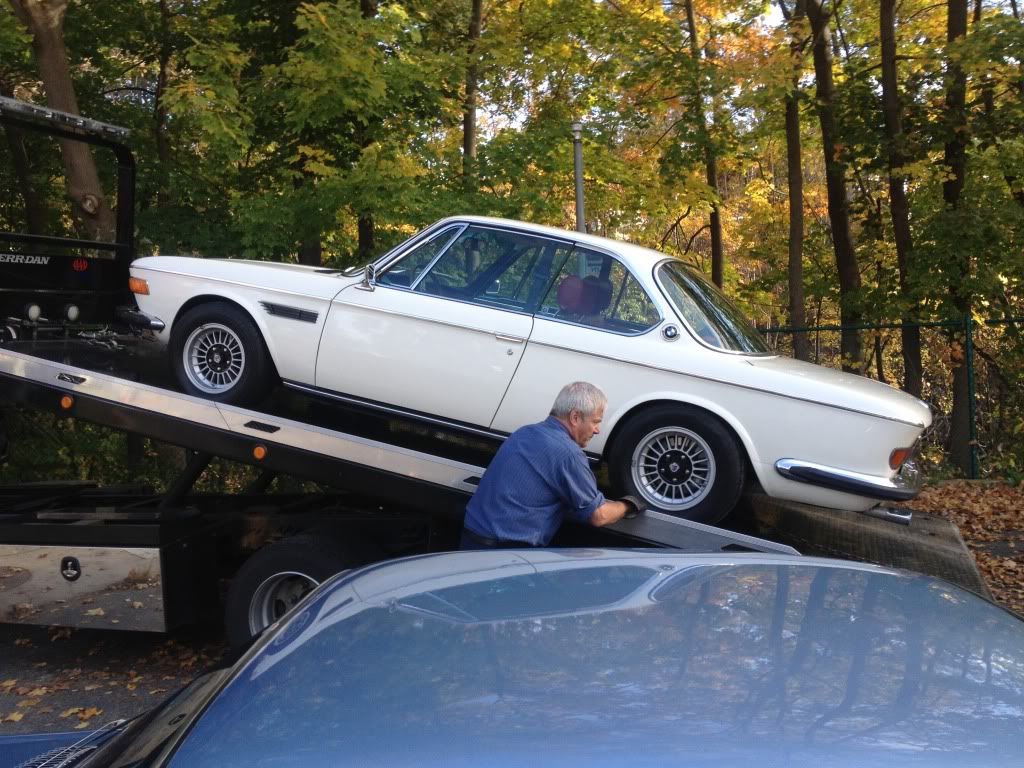

I think you fellow coupe owners jinxed me for not driving my car to Saratoga. I too ended up on the back of a flatbed. After leaving at around 3pm and hitting tons of traffic on 87, I looked down and my temp gauge was pinning red. My friend in his euro '84 M6 and I waited, filled my radiator and drove another 15 minutes or so. He and I take different routes home so I gave him the "all ok" wave and we split up. No sooner did I look down and I was heating up again, 170+ miles from home. I knew I was never gonna make it so I called in a tow to a friends house in NJ, then he came with his trailer and we brought the car the rest of the way home to Philly. BTW, the AAA tow driver went over 80 miles in around an hour. I thought he was gonna flip the truck, Tii and all numerous times. He and I had a great rapport by the end of the trip. The best was when he said to me, "you know what they call me back at the shop?, Speedy Gonzalez"...he certainly was right...so I left Saratoga Springs at 3pm, and arrived home at close to midnight.
I think the culprit is a small coolant hose that cools the Kugelfischer pump during warmup. It is really hard to see where the coolant is spilling from I have not had a real good chance to look yet.

Good to hear we all got home in one piece (more of less). I was also starting to overheat with all the leaf peeper traffic... the car, too.
