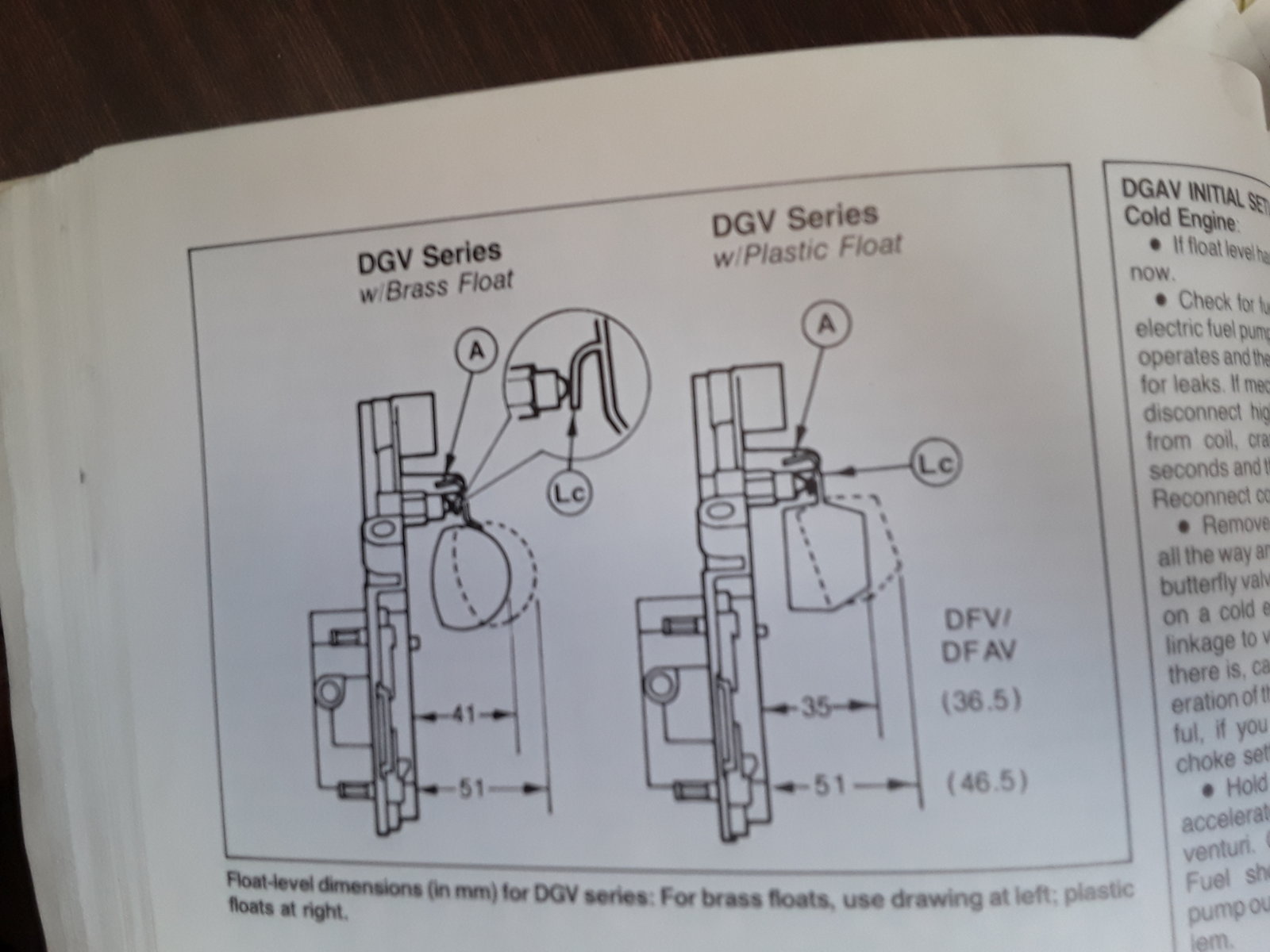

Have you checked the float bowl levels/adj float heights? Checked fuel pressure PSI? Should be 3-5psi.
HTH
I'm using a Facet electric pump right now and it's only suppose to provide 3-4psi I think. I need to get numbers for setting the floats. They need to be checked.

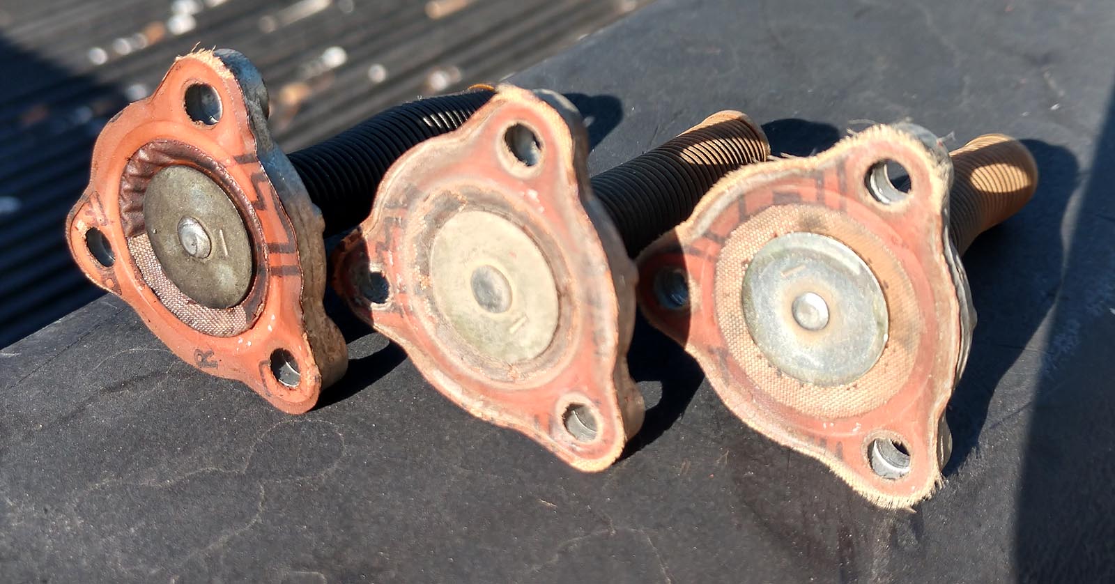

Here's three of the power valves I have. The one of the left has about half of the rubber membrane left and the other two just have the fabric material exposed. There's no way any of these can work properly. I'm ordering two new valves but in the meantime I'll test without them working.
This is so familiar. I look at those power valves, and from here, they all look expired. But I would do the very same thing you are doing. Swap, experiment, evaluate, obsess, and finally spend the money. But we are all very entertained at the sequence of events here. Carry on, Dan! ;)
