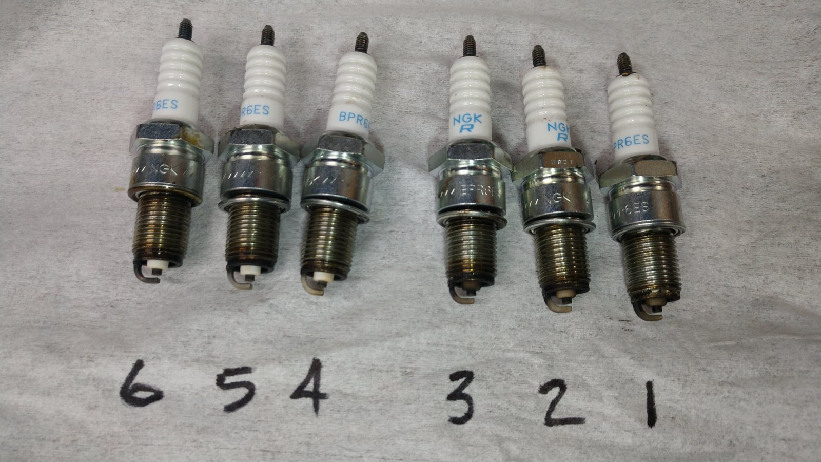

Pulled the plugs. 4 and 5 looked slightly lighter/hotter but they all looked pretty good in my opinion.

Looking at your photo again on a larger screen it sure seems like not a whole lot of fuel is going to the 4 5 6 bank. What do you think?
I think your plugs are telling you something
If the drop in rpm when you pull a front-3 plug wire is greater than when you pull a back-3 plug wire, then back carb is contributing less to the engine idle than the front.2 reasons are the back carb is flowing less air (not synchronized) or is running too lean (cleaner plugs).
