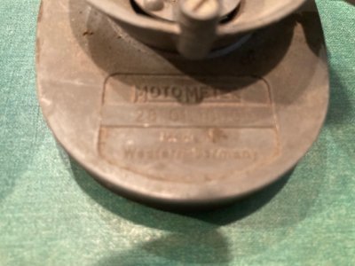

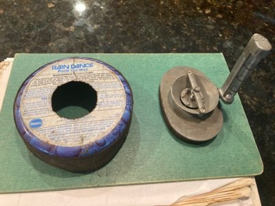

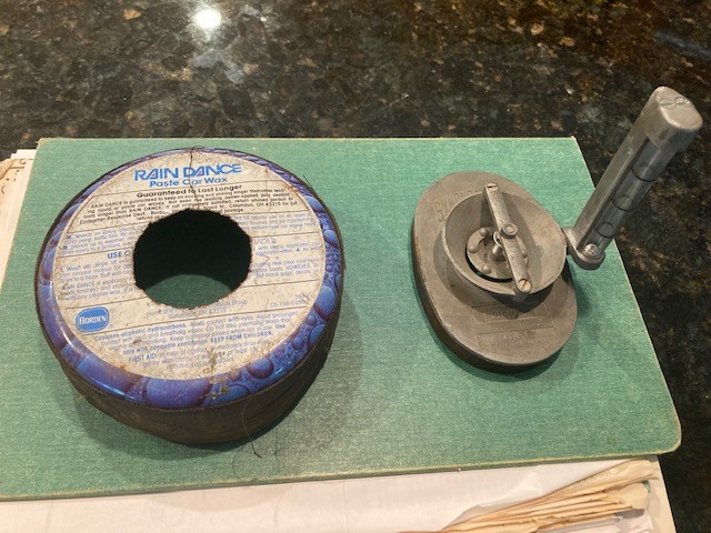

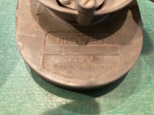

For syncing carbs I use the setup as shown in these pics. It's a Synchro Test made by MotoMeter in Germany. And yes, that is an old Rain Dance car wax can modified to fit over the carb and a hole matching that on the meter. Seal doesn't have to be PERFECT as long as it's equal as you move from carb to carb. You're just ensuring the carbs are drawing equally.
