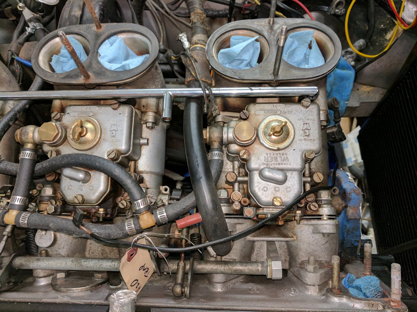

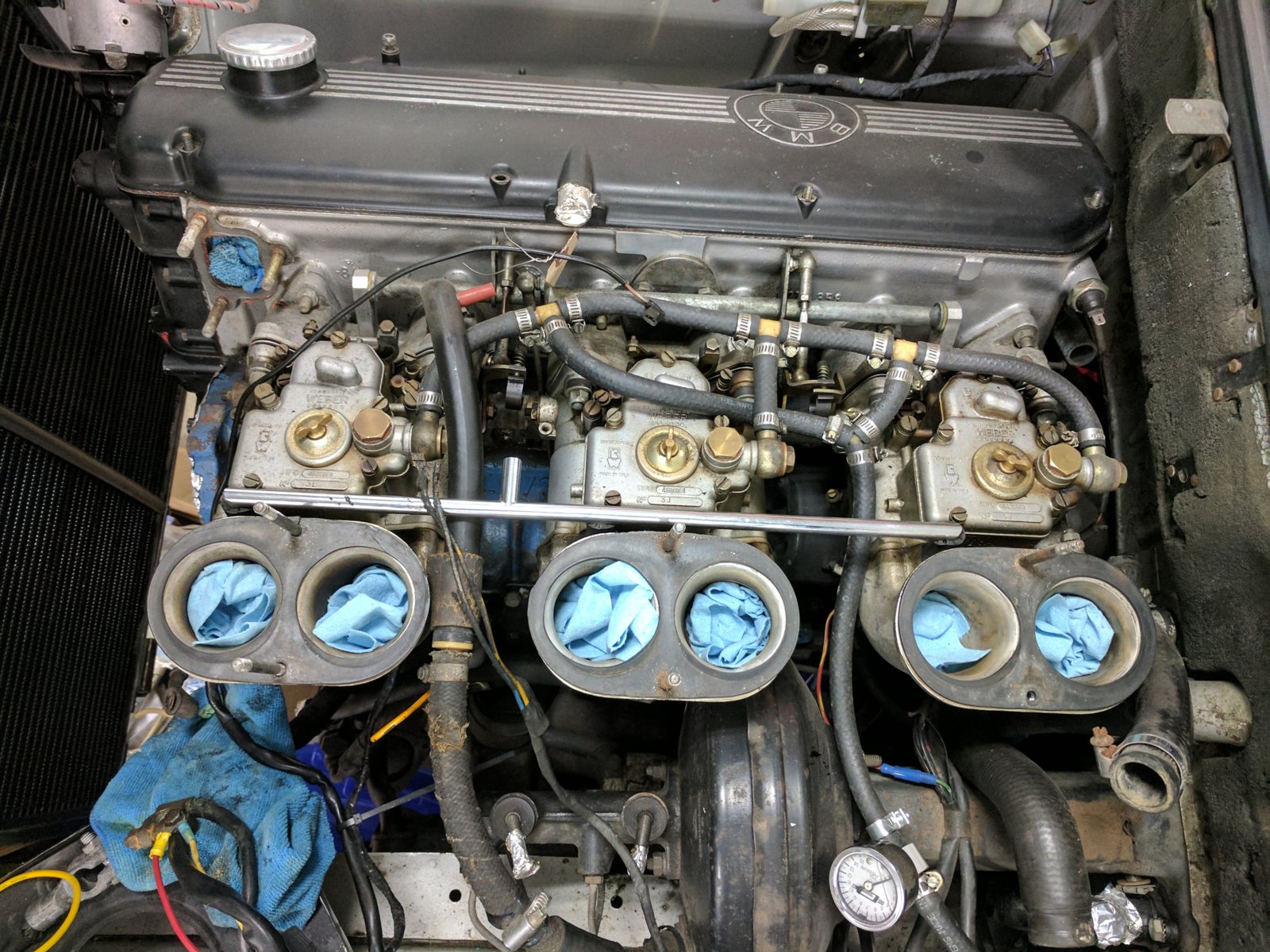

My mechanic fabricated a spacer to get the newer style thermostat to fit when I had the engine rebuilt a few months ago.

Anyway, still for sale.
And the buyer really needs to replace that incorrect Philip’s head machine screw on the cover of the rear carb. It’s driving me nuts looking at it.

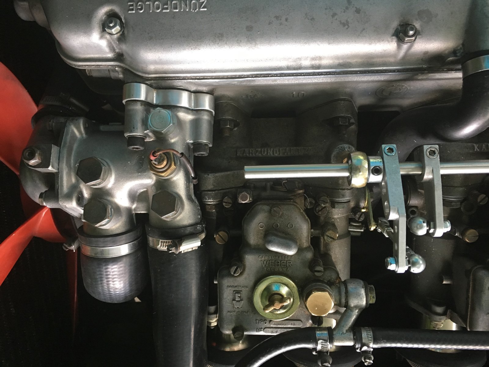

Steve--I only have 1.5 " clearance between the middle carb and the brake booster. The 1" horn and IDF filter caps should work as seen at the Pierce manifold site https://www.piercemanifolds.com/category_s/172.htm Part # 52840.010 and 99217.225 agreed? And where could I see the 90 degree Alpina set-up? Thanks, Drew BTW, the large alum air box that was on the carbs is not going back per the guys at the restoration shop.
Korman sells a modified thermostat housing. Other air filter options besides the flat foam filters (which tend to richen p the carbs) like trumpets will require a Tii brake booster. I think an Alpina setup with the 90 degree trumpets clear the stock booster. My VGS manifold clears the stock booster but they are hard to find. Triple Weber conversions add up $$$ quickly.
Back to the OP, I think this is a very good buy at $1400. Everything I’ve ever gotten from Korman (mechanical, not body), was really good stuff.
This kit will clean up easily/nicely and would be my first choice for going to triple DCOE’s. I’m using a real Alpina setup and the older style DCOE’s only because of the bling factor, not that it will work better than the Korman setup (it won’t).
Nice to see a pic of the alpina setup so I know what the bling factor looks like!
That might be cutting it close, not sure, also not sure on the filtering quality of those screens. Alpina:

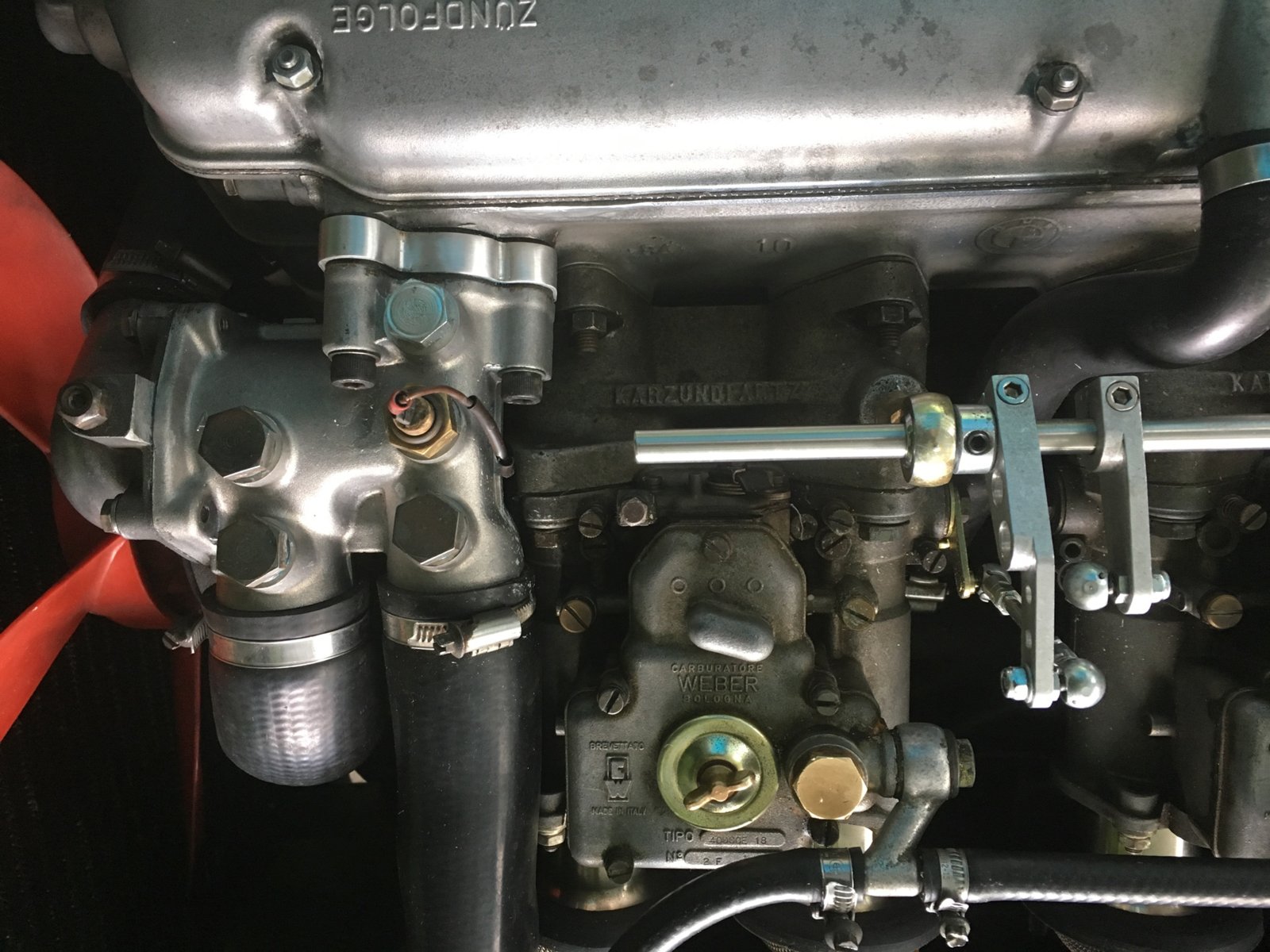

img_20170202_162353-jpg.49050
img_20170202_162614-jpg.49049
The last 2 pics are Nicad's
