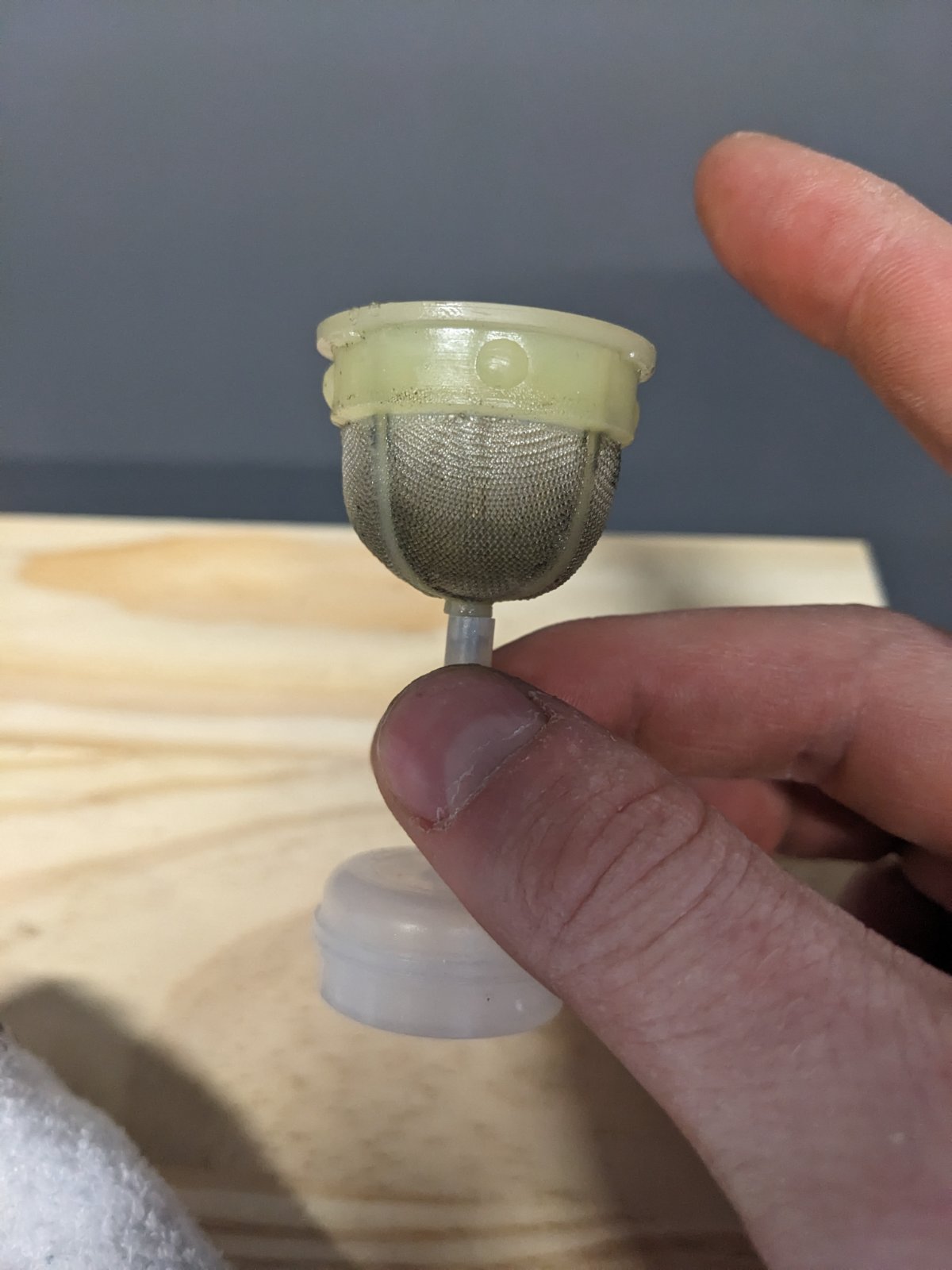

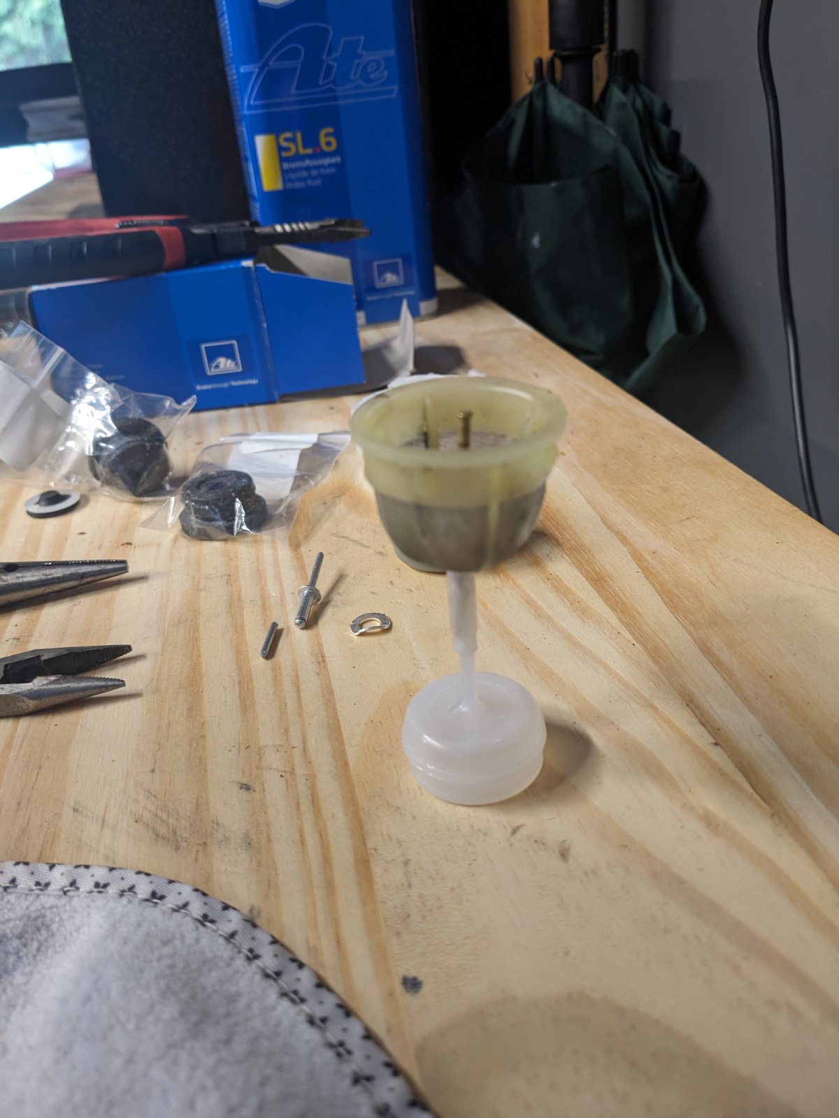

Fixed my brake reservoir float. The old one has fallen off its stem and sank to the bottom. Retrofitted a new ATE float to attach to the original black cap with the blue dot. Didn't want to use the new white ATE cap that cap with the new float part. Had to trim the new float stem and bore it out with a 1/16th drill bit to accommodate the old copper float stem. Old float stem also needed some trimming, maybe 40% was removed. Works great and parking light is now off!

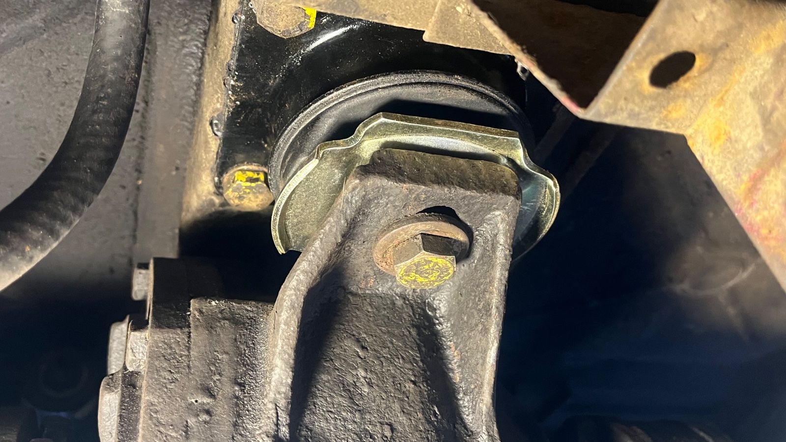

New clutch, flywheel, pilot bearing, rear main seal, and motor mounts installed. Finally time to reinstall the 4-speed w/ new trans mount and exhaust hanger bushings.
Had to get creative with the clutch align tool. The one that came with the Sachs clutch kit was too large in diameter to fit through the pilot bearing. Had to heavily hack that thing up and shove a socket in to fit

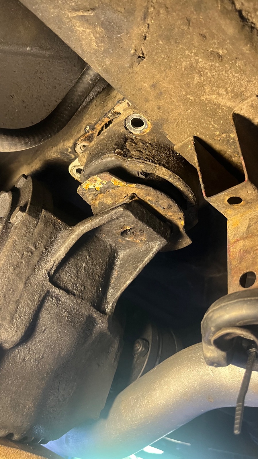

Removed CSB.
That was the Final step before reassembly.
WITH : new to me transmission, rebuilt shifter, installed 3.45 LSD.
It was all easier than I thought.
For the CSB… Once you separate the driveshaft, you can tap the back of the CSB with a punch and hammer to tap it off the driveshaft.
With a different shaped punch you might even be able get the old one off without damage.
I had a brand new one on hand, so I wasn’t worried about the damage.
Looking forward to driving this thing again!
PS. Noted: the circlip is dished and the dishing should face the dust cap.

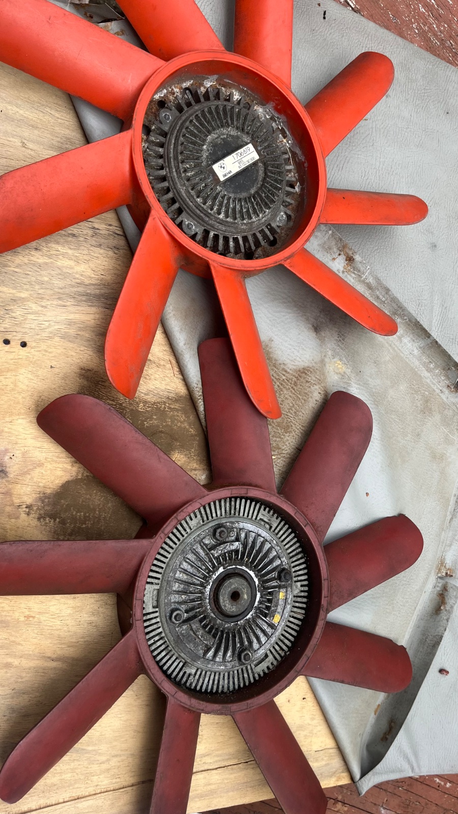

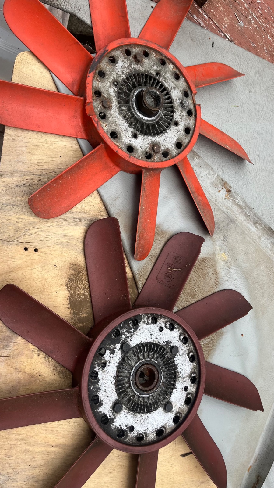

Here’s one: dealing with an
OVER COOLING issue. lol
Not really an issue but I noticed it wasn’t getting warm enough. The viscous fan was stiff and spinning ALL the time.

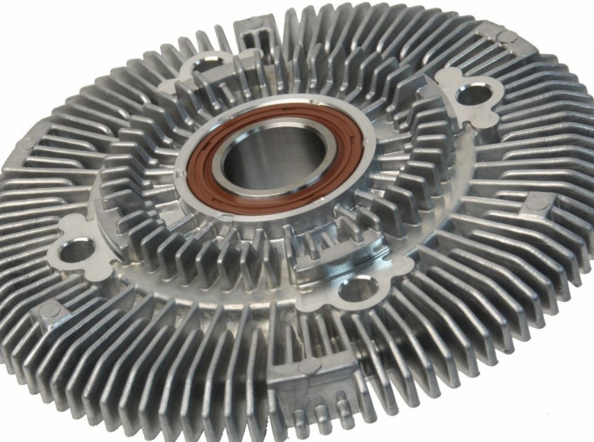

I thought I with be able to swap in one of the good viscous couplings I had lying around but the 2800 has an older version coupling.
Here are pics of the style in my 2800 and the one I thought I would swap in. Nope.
And a pic of what my new one will (hopefully) look like! Found a reasonably priced brand new coupling of the older style! I’ll upgrade to new style when I need to open the front of the engine. Hopefully never

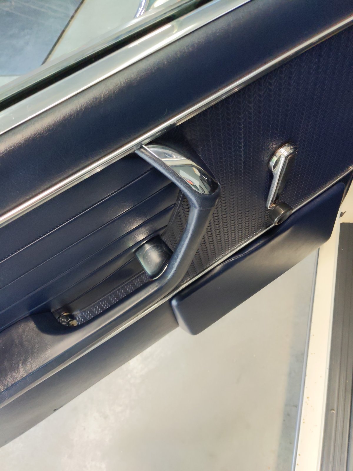

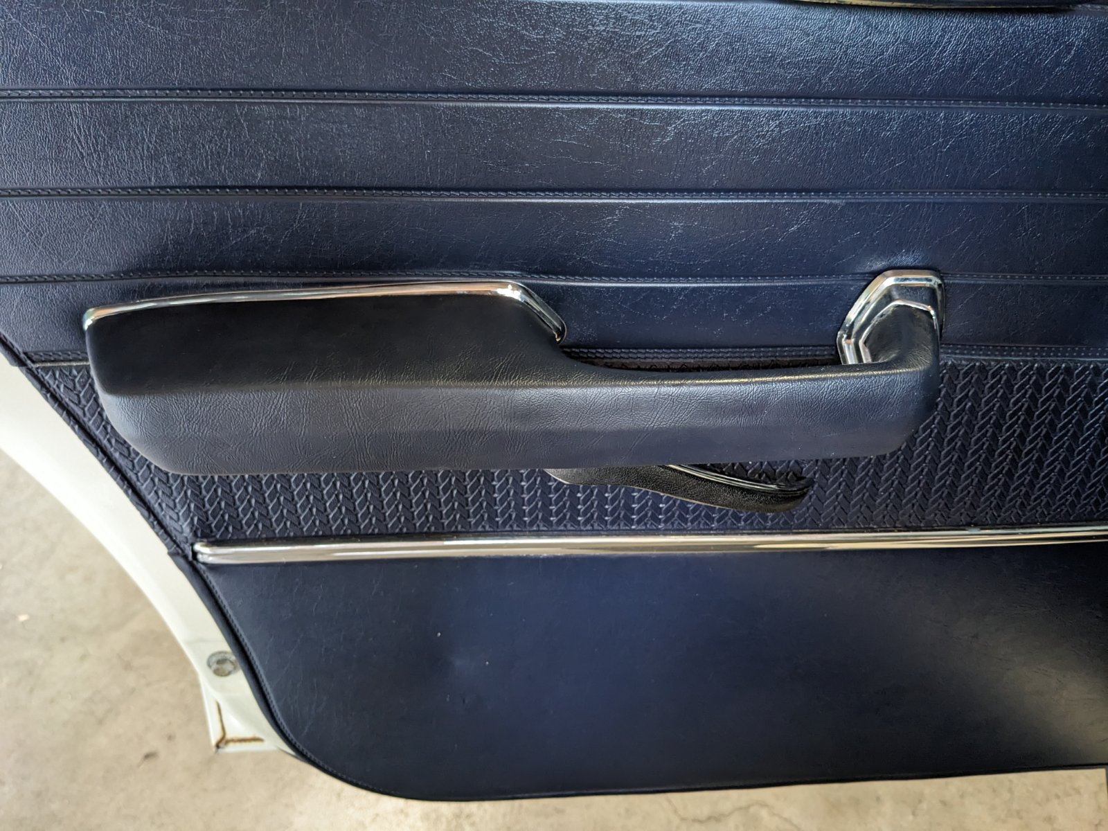

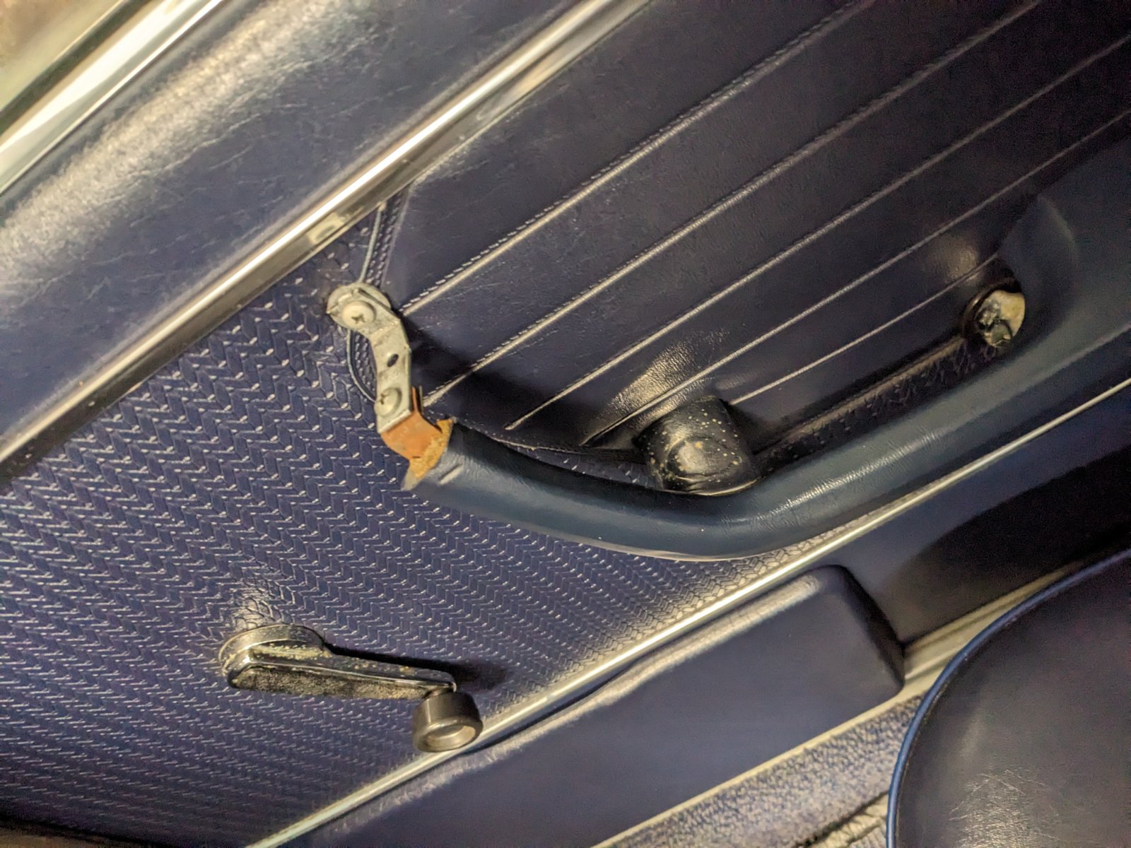

Missing front door pull and rear chrome armrest trim found and installed.
Tool over a year to find the front piece in Marine blue.
