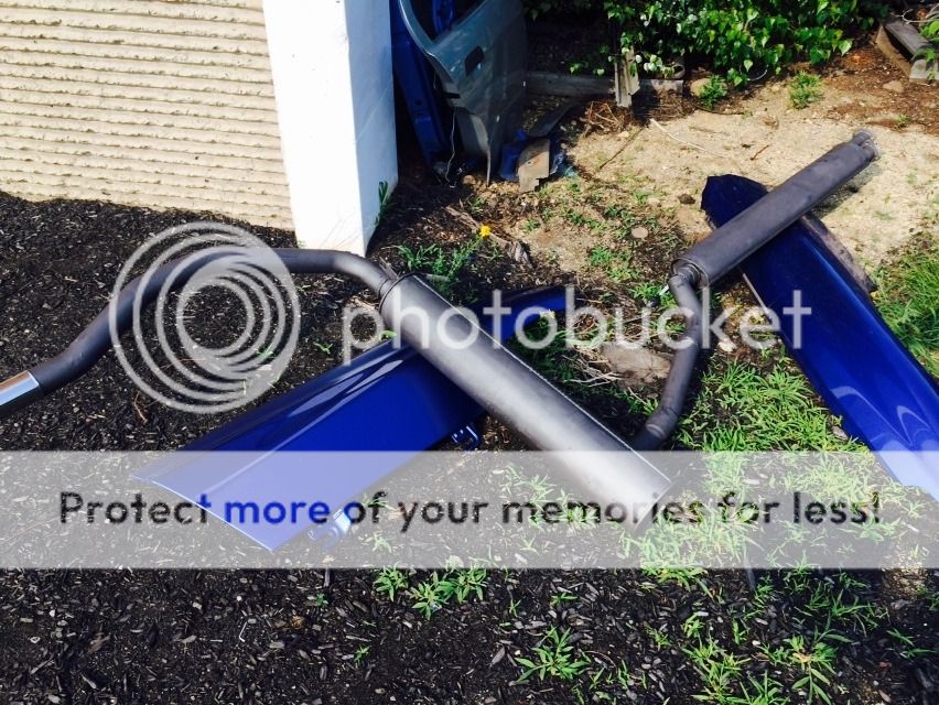

W&N exhaust on, car is lowered, all windows work (though I have some final adjustments to make on the stops), so all she needs is a good detail and I'm ready for Legends.

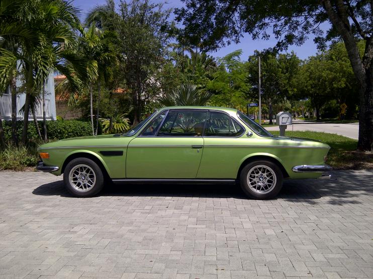

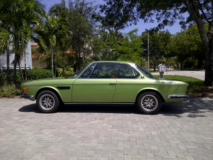

Hmmm. I had never thought of my cars stance as goofy but I have to admit it does look nicer a bit lower.

To clarify my "goofy" comment, I was referring to how these cars typically ride with the spacers in place, the front higher than the back like a boat not yet on plane. Both of my coupes had that appearance before I leveled them out.
Yours does not appear to have that reverse rake and looks level.
Doug
I was only trying to initiate some lighthearted banter. Just checked and I'm actually four fingers on the front and two at the rear so probably could use an adjustment to the front someday.
