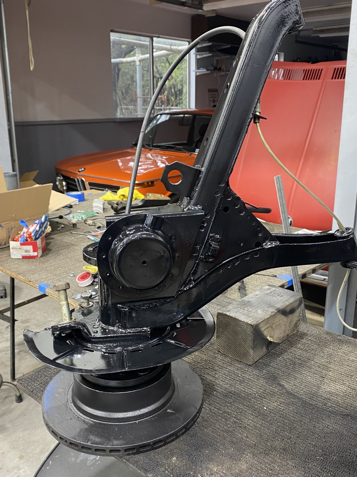

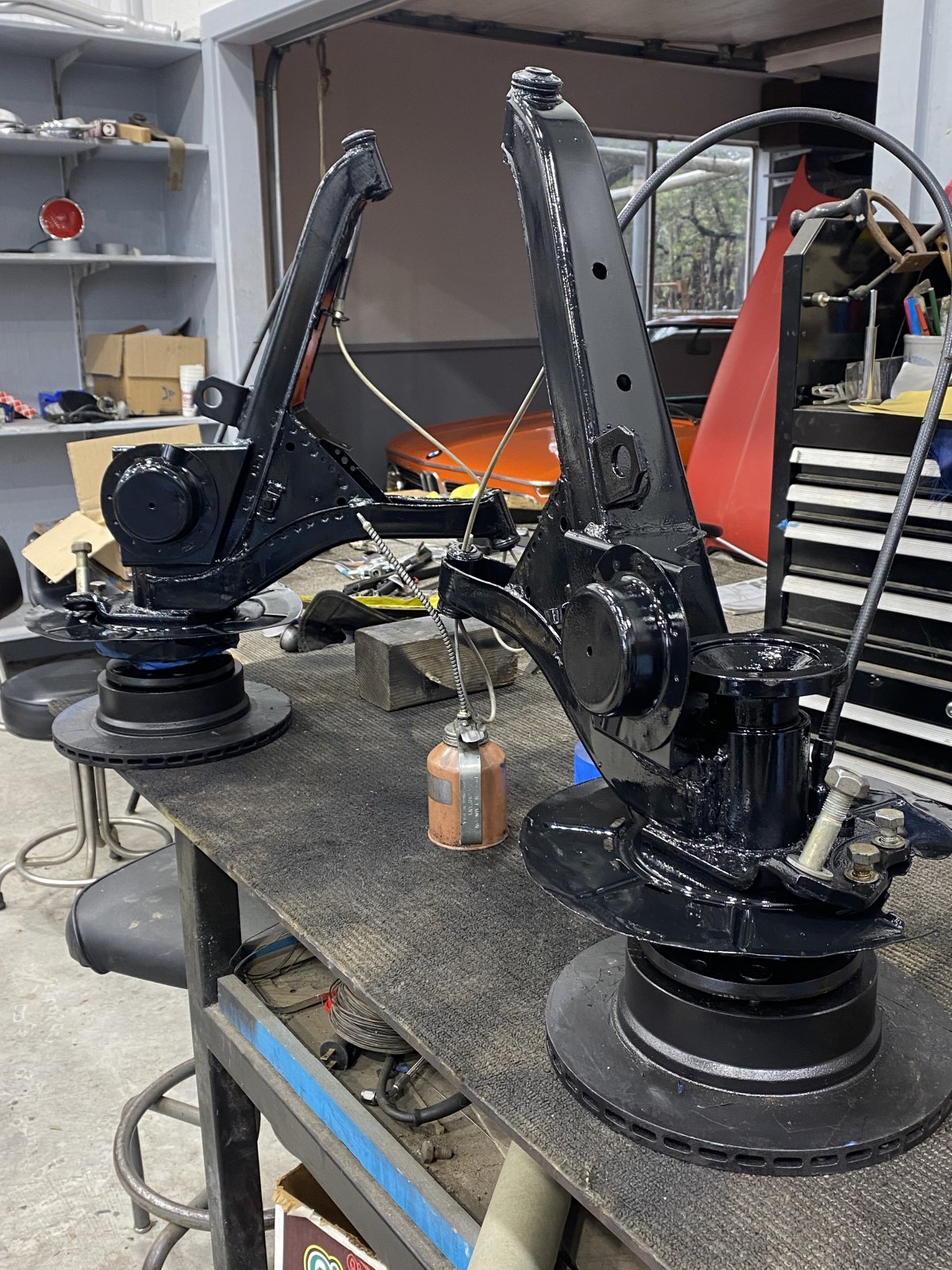

Been working on refreshing these two rear subframe’s I picked up to add rear disc brakes to my coupe.
Plan on starting installing today.

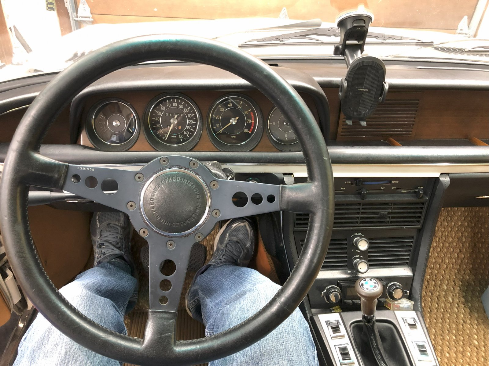

(not today) After storing this Victor Interspeed steering wheel for over a year I finally installed it a few weeks ago. I am very pleased with the change in wheel size and grip comfort.

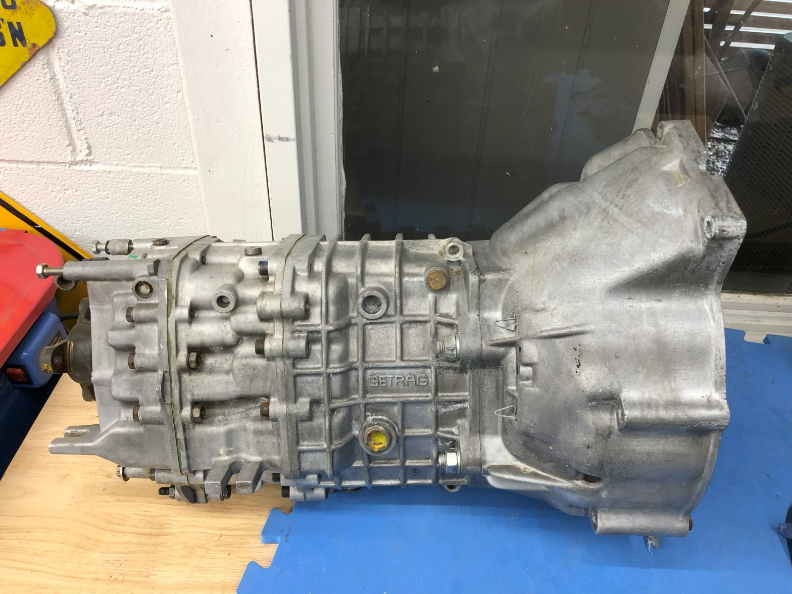

This week I pulled the 5 speed out of long term storage and started preparing it for the winter project. First step was clean up of the case. It was fairly clean already, and only required a little more than an hour to get the case cleaned up.
Today I separated the bell housing from the transmission (those nuts were really tight, I had to fire up the compressor and get out the impact gun) and pulled the front seal housing and installed a new seal.

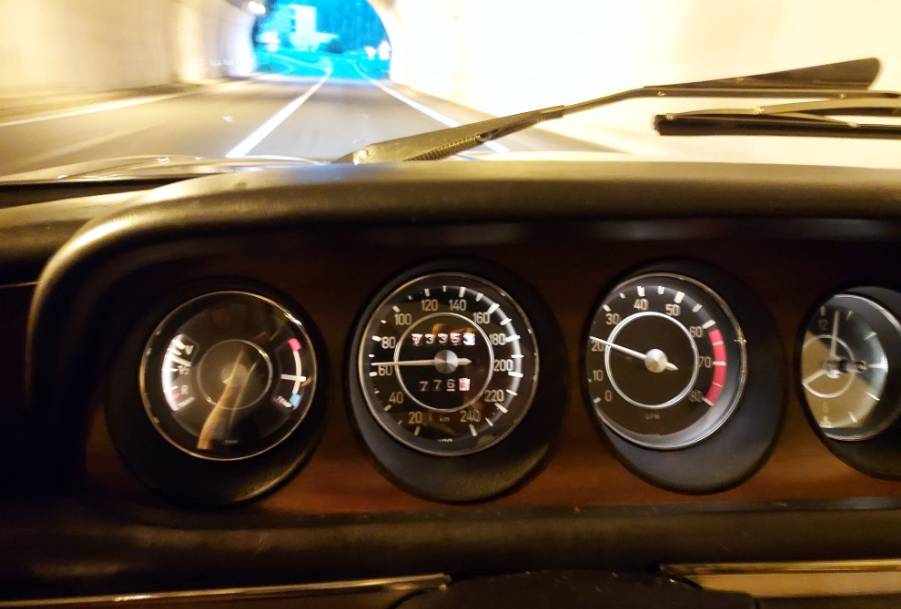

it is interesting, yes
I would not be so sure about anything
mine is a 3.0cs like yours, it is an early car as yours, and it has the same tacho as yours, redline at 6200
there are many things that could be or maybe,
doubt is a luxury that we can carry with us, certainties are thoughless

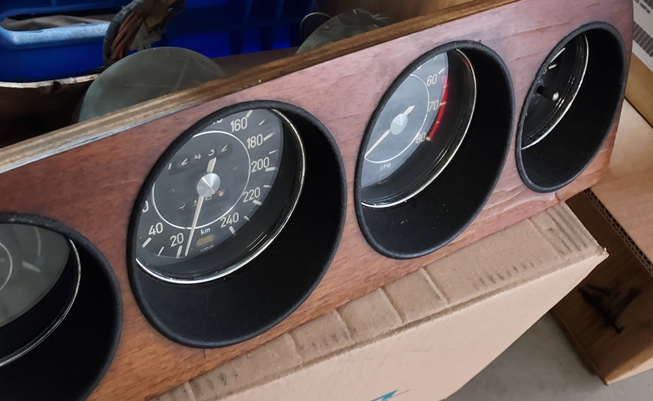

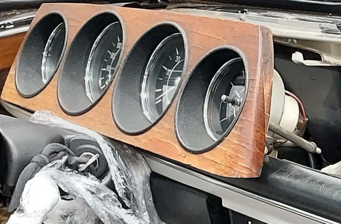

here it is my cluster before renewal project, fully 100% original, correct dates, never dissasembled
a 3.0 CS
6200 and white numerals
when just removed from the coupe

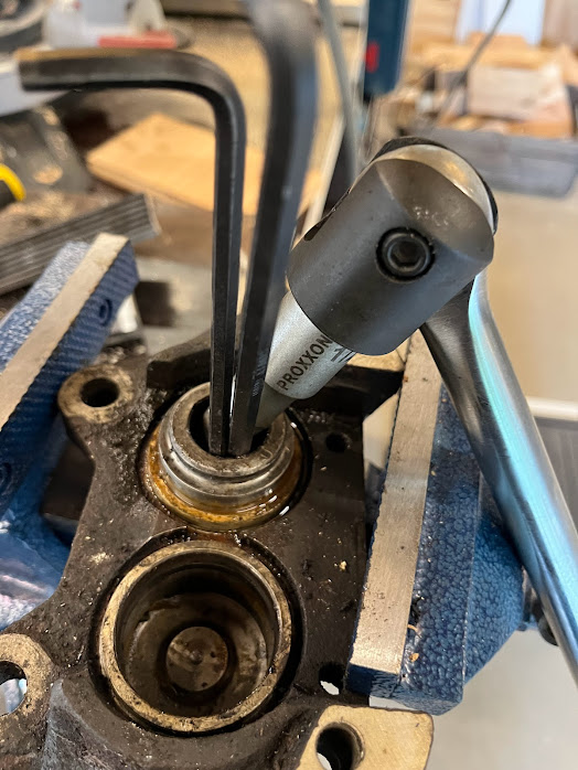

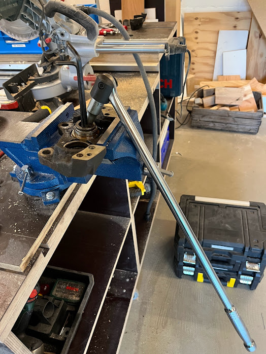

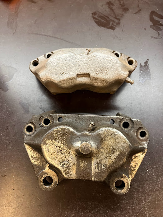

Finally got the brake pistons out. Nothing really worked, not even the trick with compressed air.
This did eventually the job: a breaker bar, some allen keys, lots of turning and patience...
