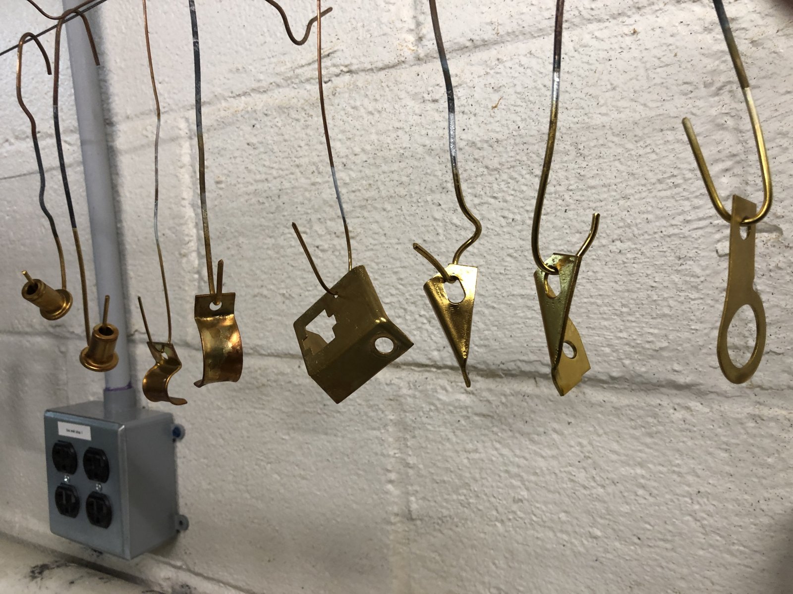

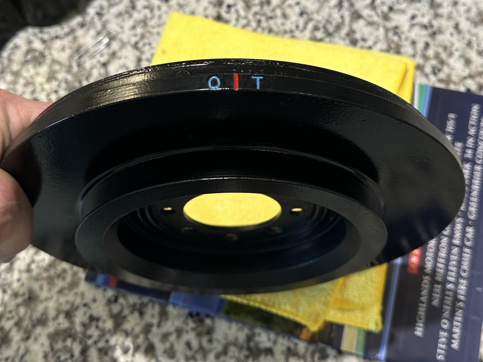

Spent some time in the garage, reorganization and adding some power to a wall where I have moved the zinc plating set-up. I filtered the zinc solution and was able to get some very satisfying results from plating and yellow chromate. The parts shown are a few bits that I removed from the engine compartment earlier this year, knowing that they would go back in once the winter engine bay project is finished.

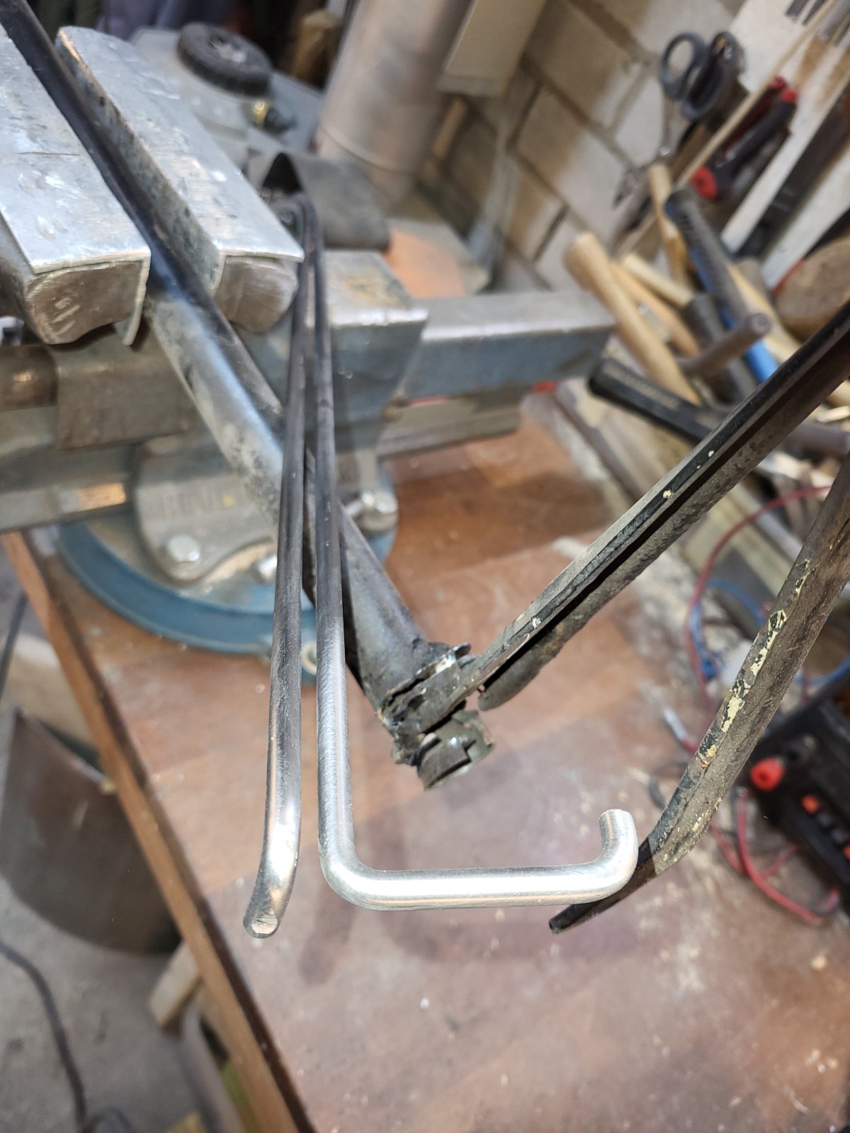

I've never seen that technique - are you using the alan keys to wedge and turning to break the piston free? How do you pull upward on the piston with this setup?
I saw a guy on YouTube that used this technique. The (w)edges of the alan keys seize in the piston when you turn. From then on you just keep on turning with a slightly upward force. Slowly the piston will come out. I removed all eight pistons of the front calipers like that.

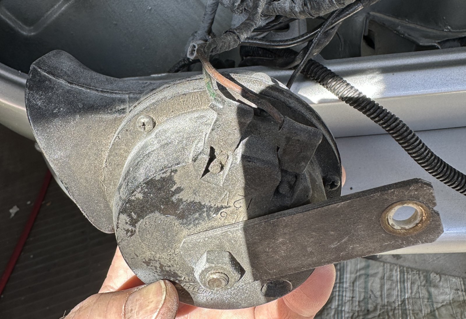

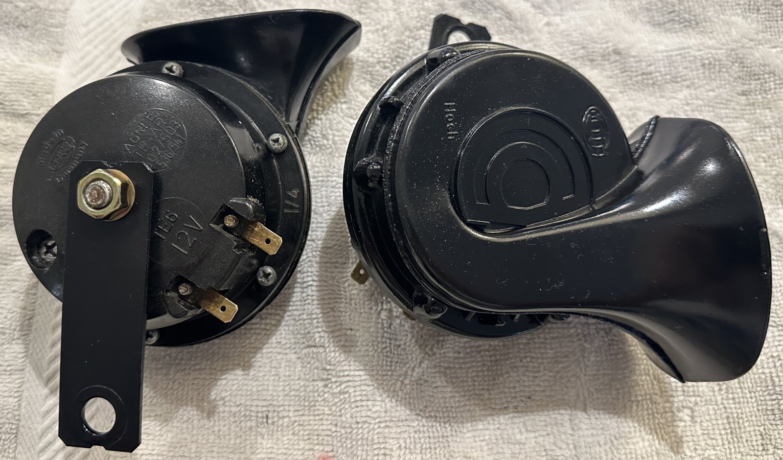

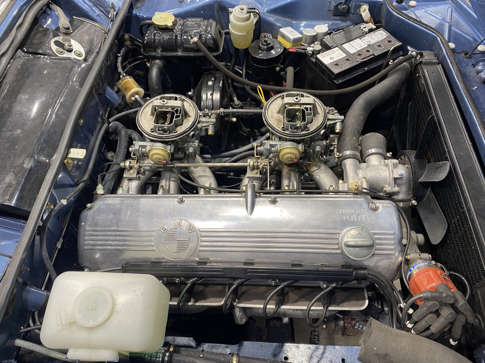

Waiting for parts before the last push to finish my engine project so I disassembled and refreshed the horns from this:
To this:

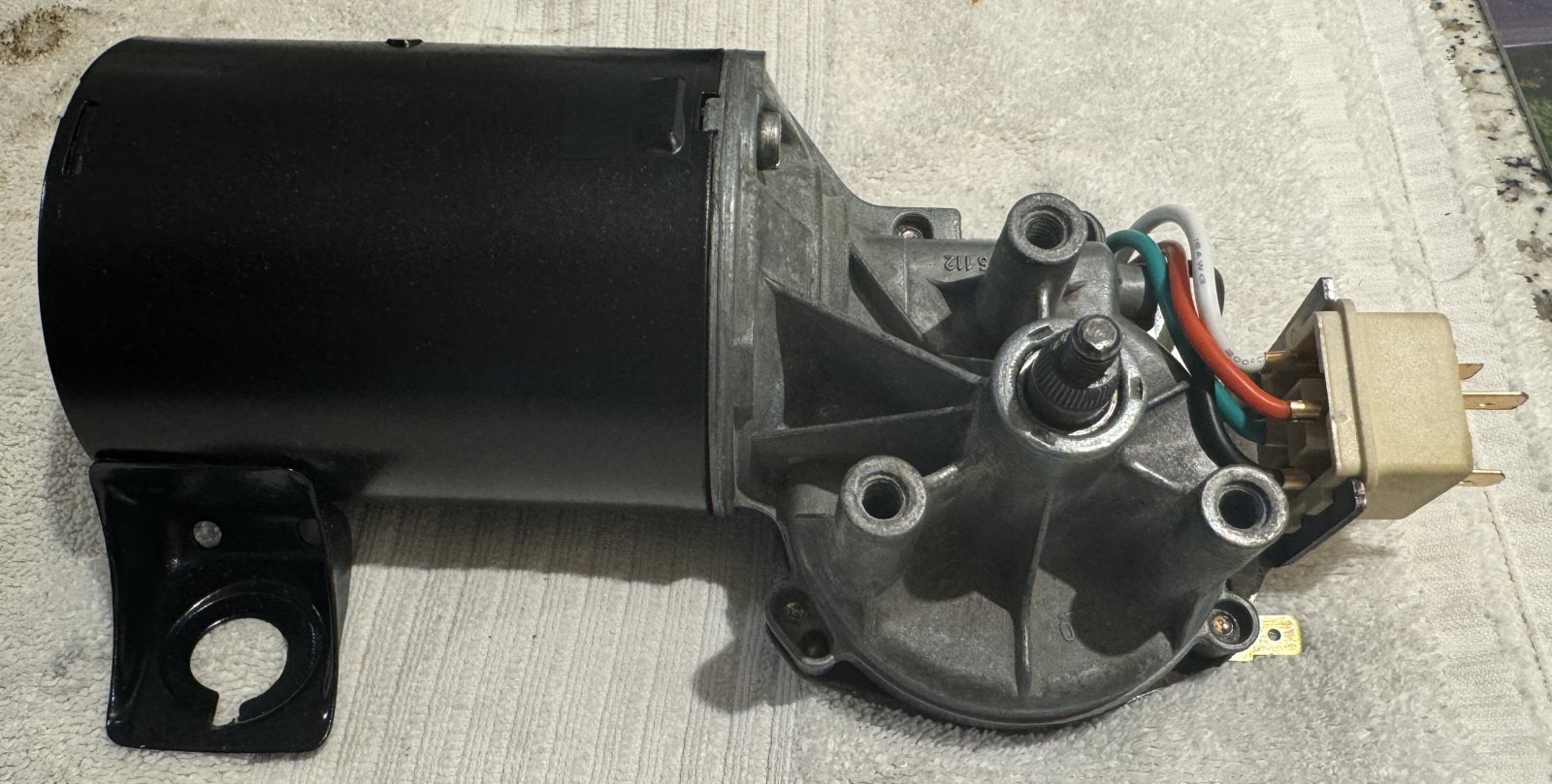

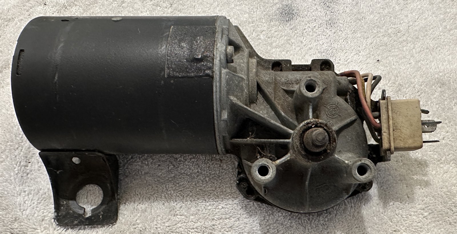

Finished up my early E12/E24 wiper motor rebuild and E9/E3 plug conversion (DIY tutorial coming for this). As delivered:
Cleaned, painted, regreased and rewired:

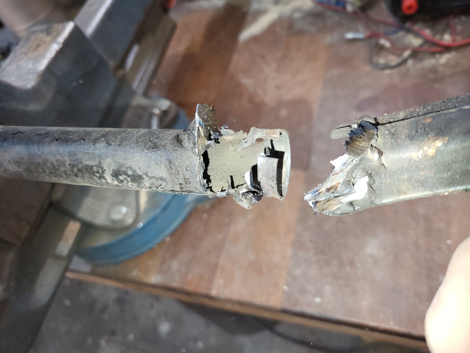

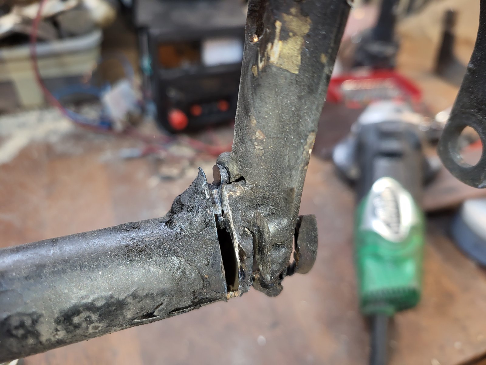

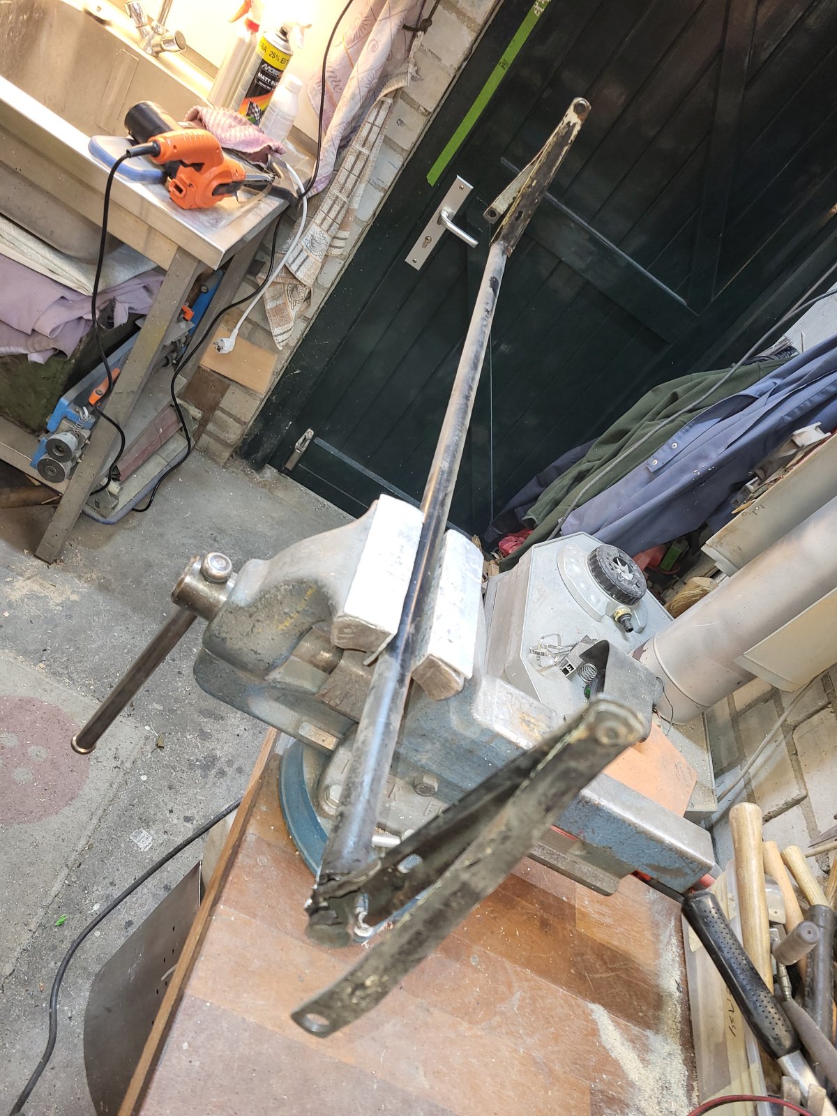

Reviewed what's salvageable on my hood torsion mechanism....
Disassembled the system from the car, in the upright position there is no tension on the system.

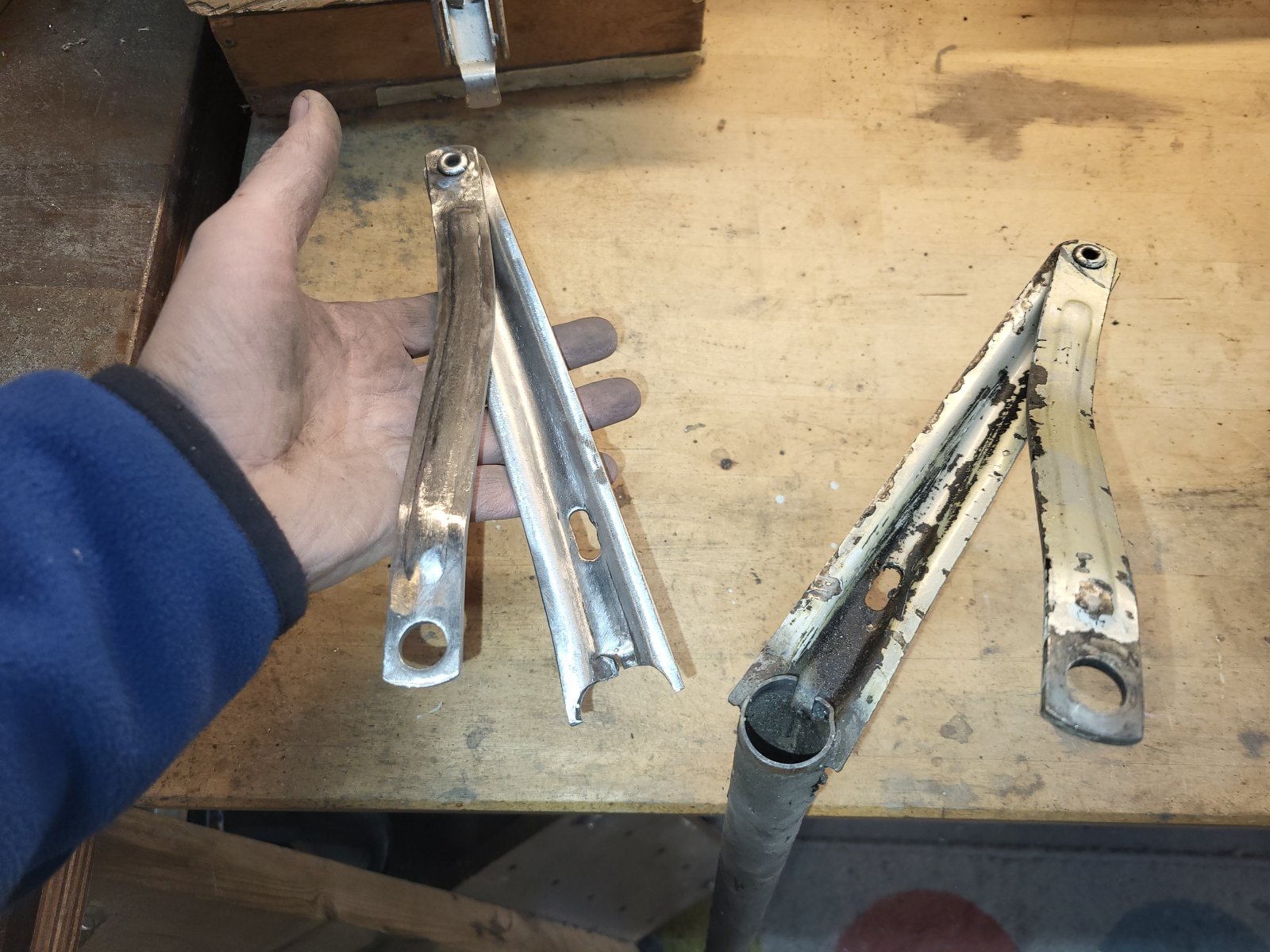

- Chopped 1 of the welded and broken again arm. Cleaned it to see what I had to work with; it's not missing much, but has a tear in the arm itself. I may choose to strengthen the arms as well. I left the other arm still attached to the tube, so i can copy the exact placement onto a new, thicker tube.

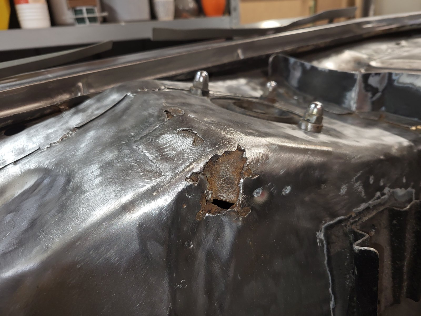

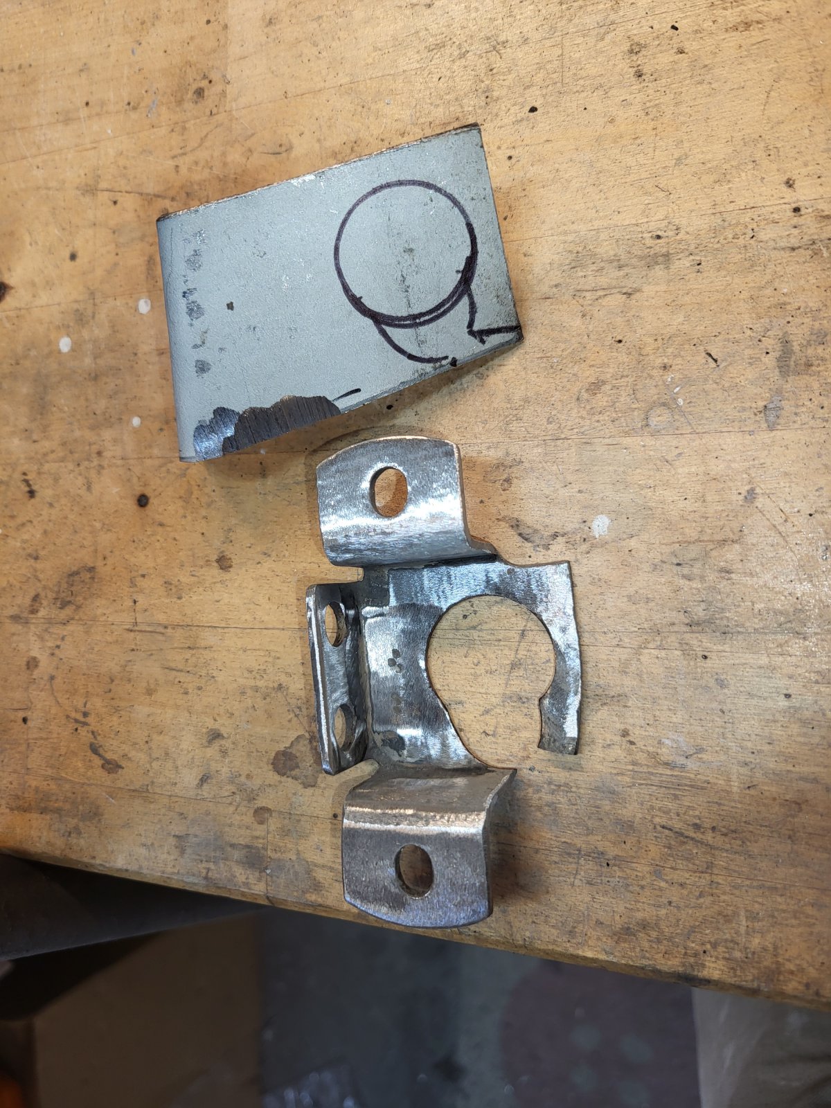

- Cleaned the bracket that holds the soft metal block to the hood. It was (unintentionally?) touched with an angle grinder and welded upon. removing the corroded remains left quite a hole to patch a new piece of 2,5 mm thick steel in.
- cleaned the torsion twist rods. They have not suffered anything over the past 50 years. Will have them electrolytically zinc treated before 2k painting them black (they are originally black from factory) .
Ordered a new 1062x26x22 mm steel tube. I hope to weld the arms to it, and have it re-zinced as well.
One open question to the gruppe: does anyone have experience with setting placing a new rivet like the ones used in the hinge of the arms?
The hinge point is made with a rivet, the two arm sections, and a ring between the two arms.
As Ii would like to re-zinc the system, I think the inside surfaces of the hinge , the rivet and the ring do not coated very well with Zinc due to the electric fields being very weak around these narrow openings. So one option is to drill out the hinge, and place a new rivet.
But I've never seen anyone do that at home - does it needs special equipment to press it to give it it's nice, round head shape? I guess one would also have to have the rivet custom made.

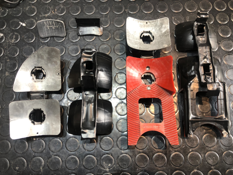

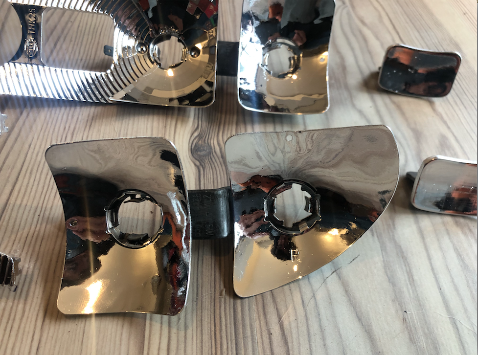

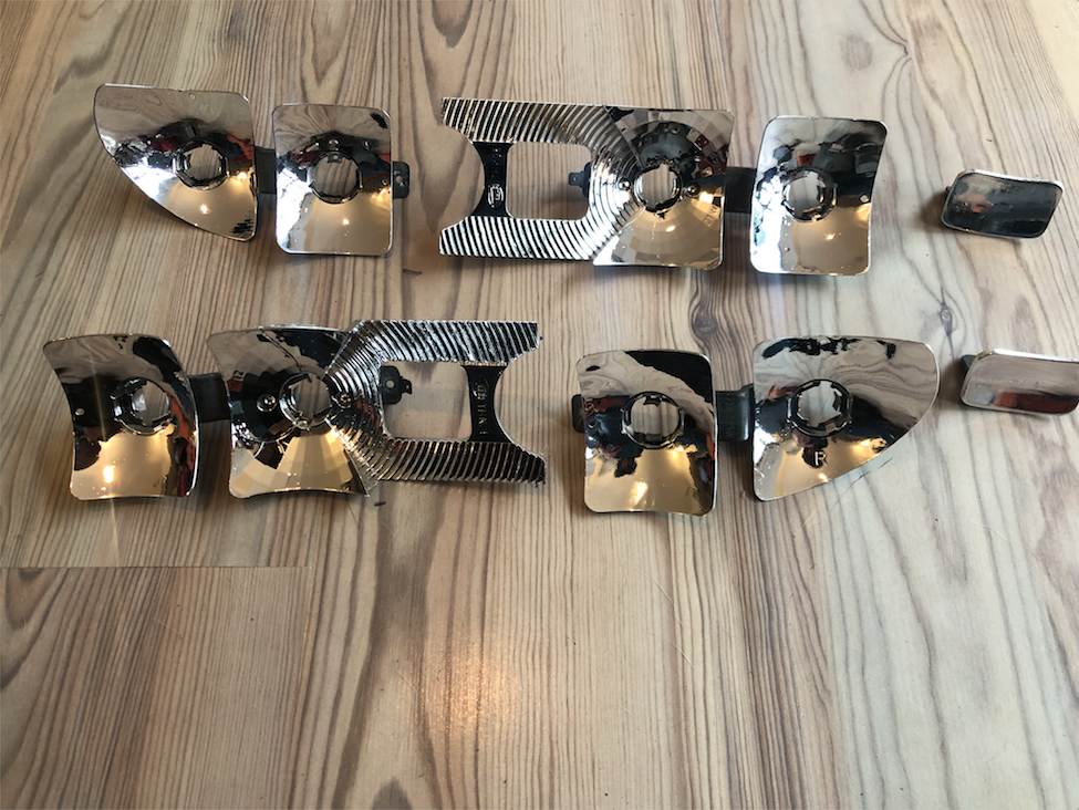

"chrome" taillight reflectors
Erik, Insurance company don't take it as an improvement here…
They call the process metallic, and I know they use a mold like powder cote...

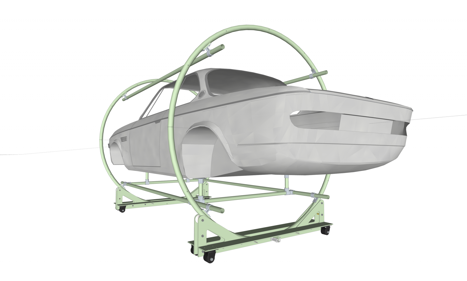

I made a 3D-model for a rotisserie. Don't know whether I'm ever gonna built it. It's probably too much for a one time restoration. But if anyone is interested in the drawing-file, let me know!
It looks really good
Thankfully I have all of my weld repairs finished so I don’t actually need one now.
Did you have to make a 3d model of the e9 also ?
