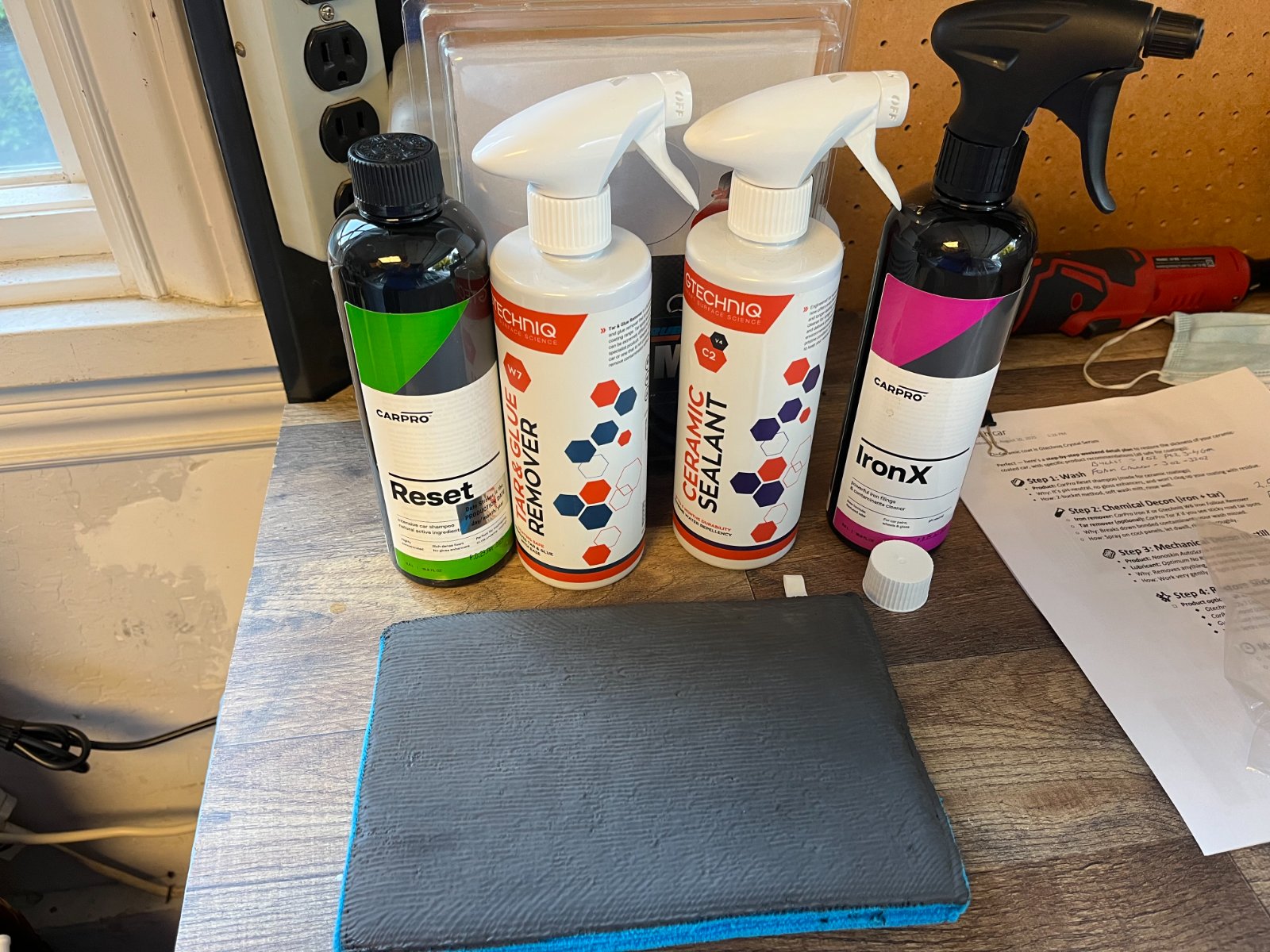

Paint Decontamination My new paint job had developed a gritty feel, and I wanted to restore the slickness of the ceramic coating. Here’s the process I used:
Step 1: Wash
Washed the car using CarPro Reset Shampoo with a foam cannon.
Step 2: Chemical Decontamination
Applied Iron X and a tar remover. In hindsight, neither was really necessary, as they didn’t make much difference. Washed with foam cannon between chemical decontamination.
Step 3: Mechanical Decontamination
Used a fine-grade NanoScrub mitt, followed by a very light clay bar session with Optimum No Rinse as lubricant.
Step 4: Restore Slickness (SiO₂ Topper)
Applied Gtechniq C2 Liquid Crystal to bring back the slick, glossy feel.
Results:
The results were excellent—paint slickness was fully restored. The NanoScrub mitt ended up being the key step, as the chemical decontamination didn’t remove much on its own.

that’s a Wow!
Clay bar does wonders but I’ve found I always have to follow it with swirl mark removal, at least for dark colors. Luckily I don’t have many dark cars :)

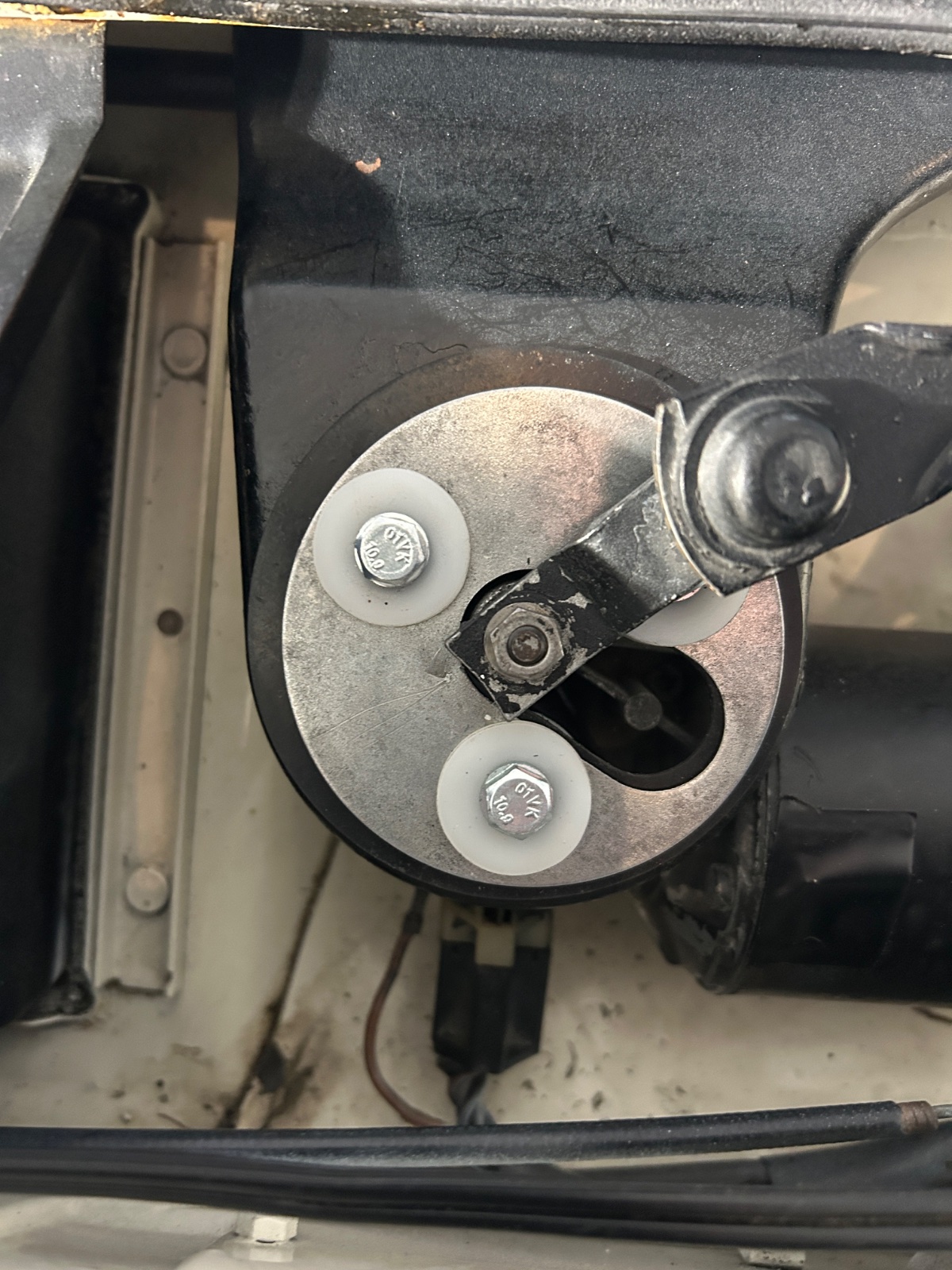

Big day! My 20-year-old son who convinced me to buy the car was home for Thanksgiving and we did the final reassembly of rear window motors, replaced under dash panels that I had cleaned up and flocked, finalized wiring for rear brake light LED, finished wiring up city lights, etc. He finally got to drive the car today!

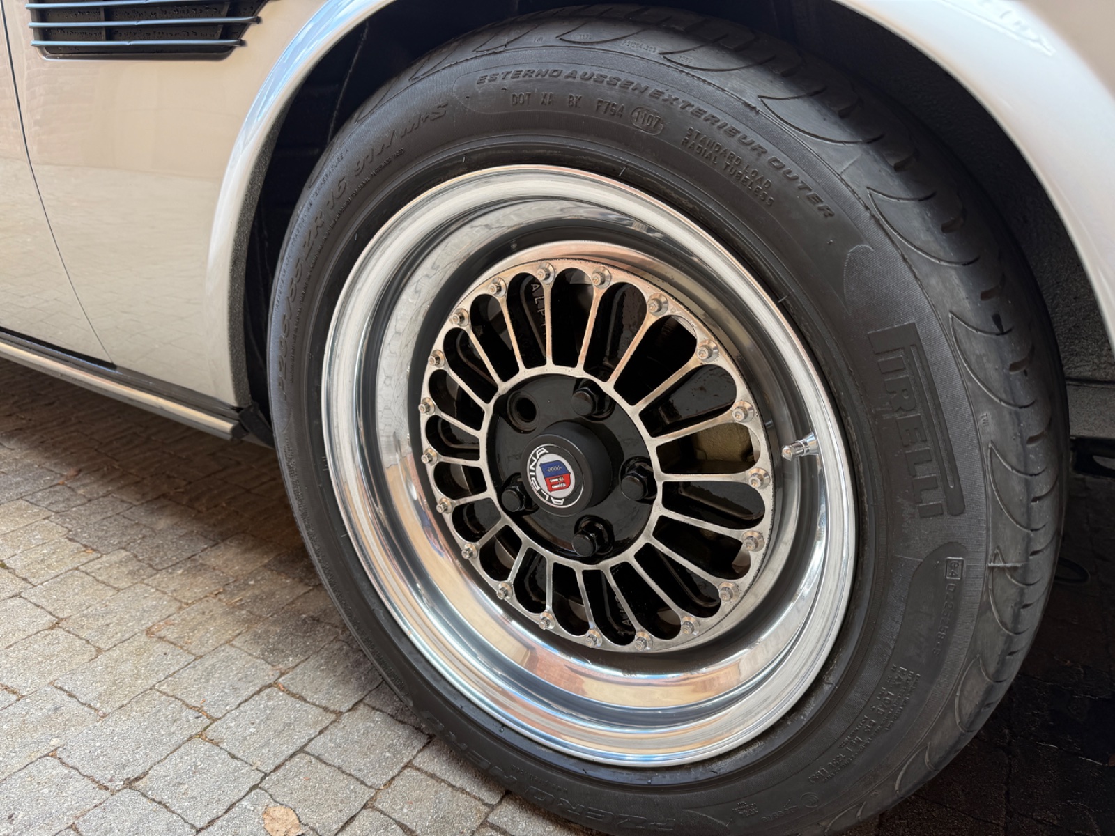

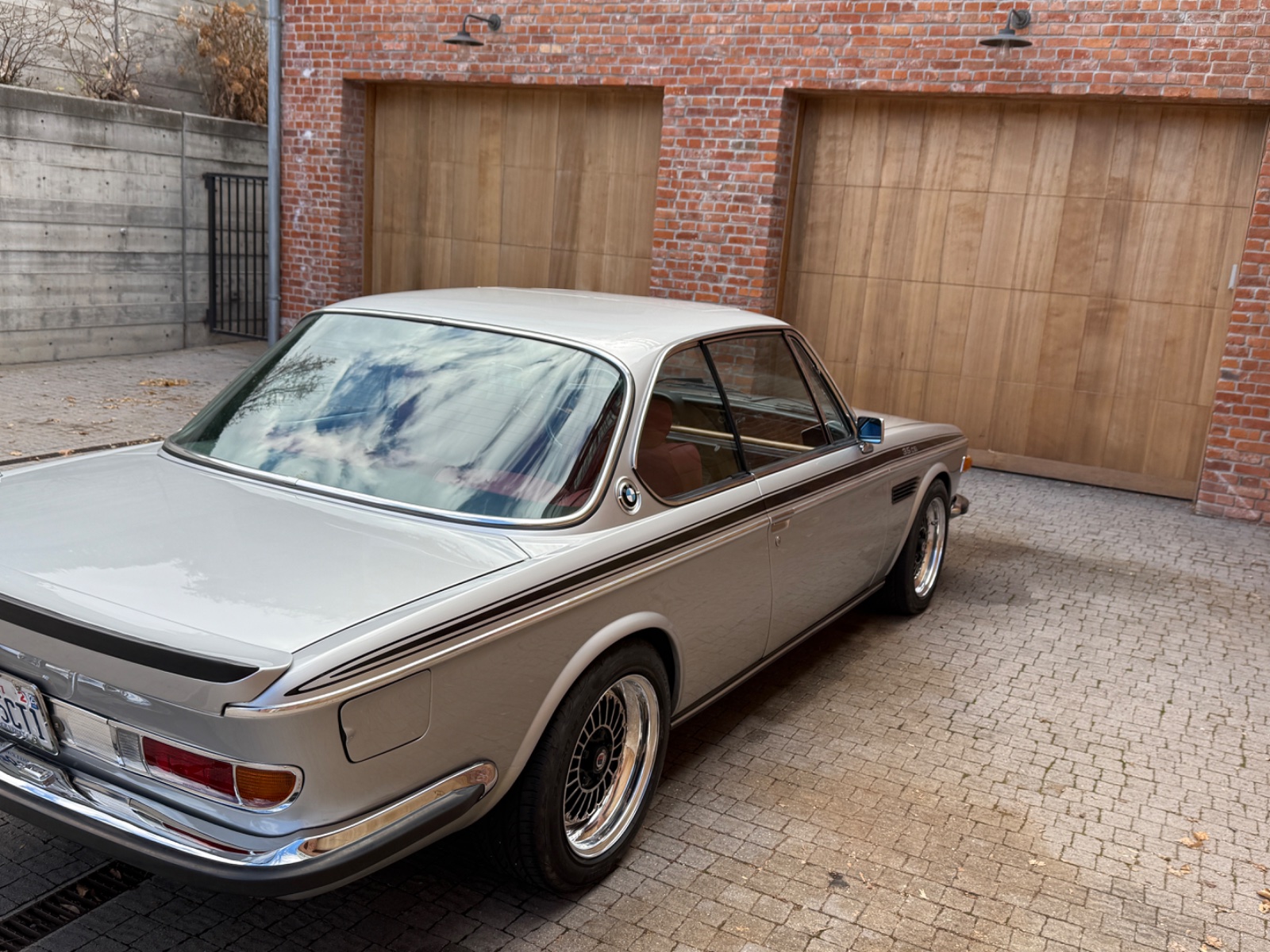

Took Jbbrjaw for a spin on the new 16x7 and 16x8 custom Alpina 3 piece wheels and enjoyed the awesome stereo after listening to the beautiful engine.

Good eye! One stud broke! Don sent me a new one. Car is in the very long queue w my mechanic to get that fixed. Low on the priority list.
the wheels look great! we know the car looks fabulous + performs wonderfully ... great color combination. love the improvements to the seats / door panels with the Singer material (embossed leather?). so here's the only question ... did you look at the chrome wheel nuts vs. the black?
Great idea. I’ll get a set and see how that looks!
