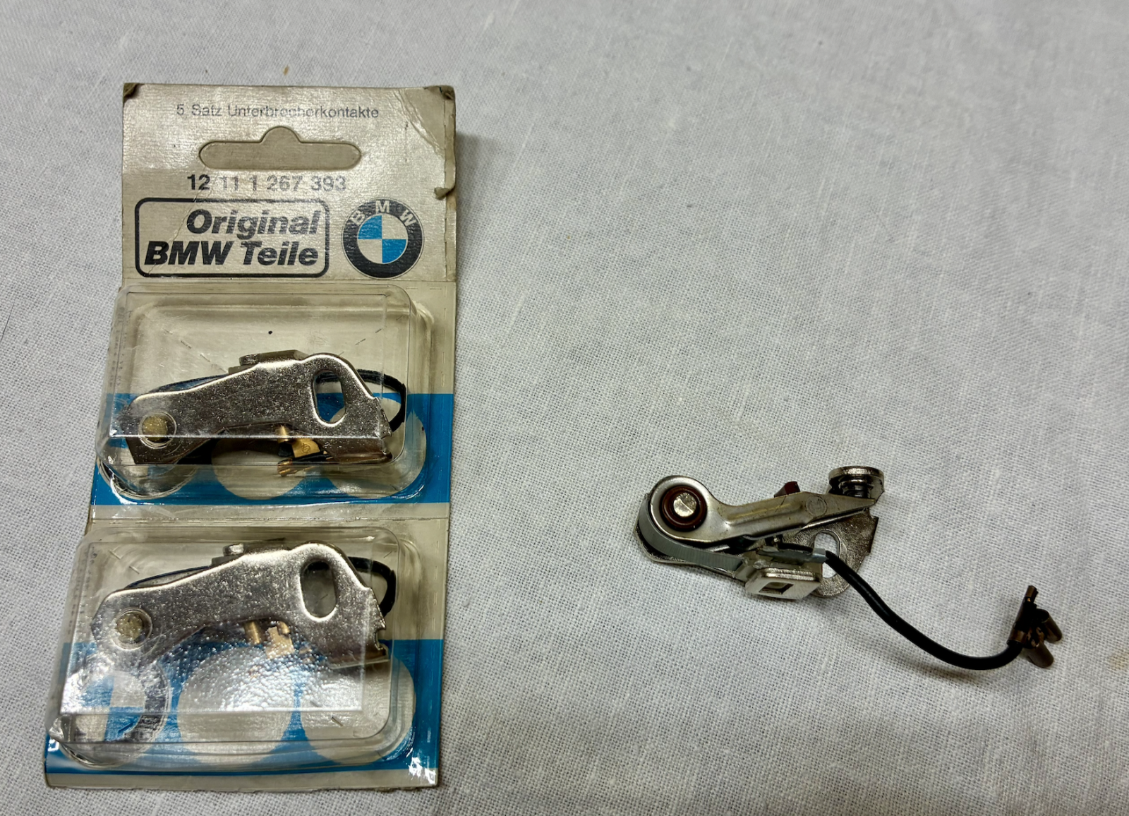

two weeks ago I had a strange encounter getting out of the garage.
I was driving 100 meters, when all of of a sudden the engine would stumble, no acceleration, RPMs would jump from idle to 1500 and then drop to 0, ...Suddenly the engine died and on starting would only run in idle. I got back to the garage, and then the car would not start any more...
I checked fuel pump, carbs, accelerator pump, power to coil and carbs.... and a ton of other things --
in the end got help from my shop:
they quickly found the culprit -the Bosch points (new - installed about 2 years ago) had a hidden break in the wire, that had started to creep in and get more and more prominent, until the points stopped working.
Out with the old, in with the new! Luckily, I had acquired some high quality original BMW NOS points a while ago.
With the NOS points in, the car runs like new - the idle is super-stable , it starts up right at the turn of the ignition, and it accelerates and the auto shifts smoothly again like new....
I would not have believed that the points and properly running ignition have such a broad reach.
I had been observing some small differences and odd behavior over the year, but with a 50+ year old car this can have multiple reasons, so I am super delighted about having my beloved E9 back in shape and running better than before!
Note to self: if you encounter mysterious behavior, consider changing your points.

To quote Rob Siegal: "It's always the points."
It would be a lot easier to replace them at recommended intervals if they were still easily available...
I have a Pertronix setup now and that fixed my points issue, though some posters have taken theirs out and gone back to points.
Certainly, it's a good idea to carry a spare set of points.

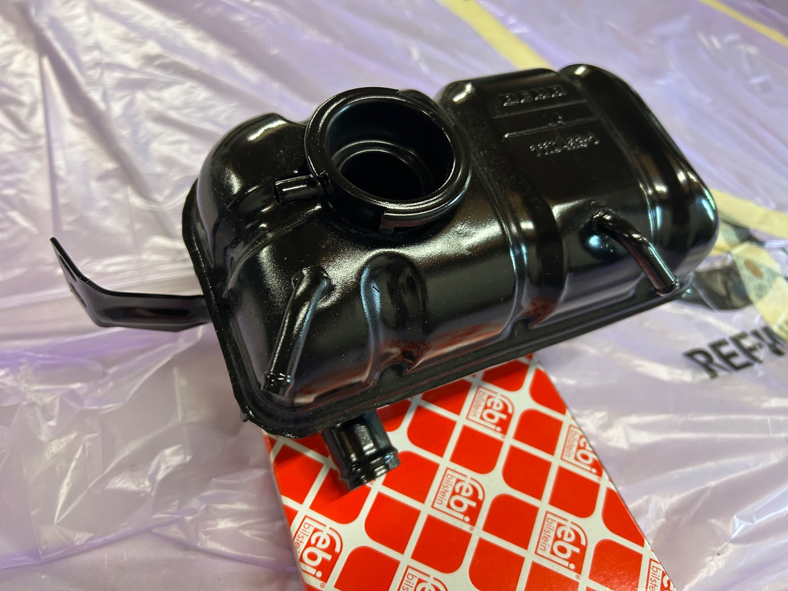

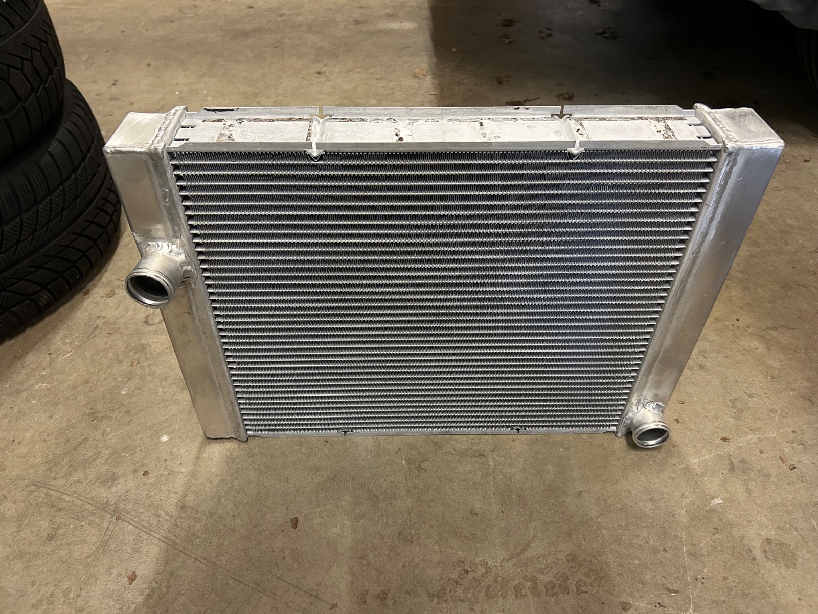

Picked up my adjusted cooling tank and custom made radiator. Fits perfectly in the noose, still overthinking how to attach the radiator to the chassis.

Rad pic is upside down? Lower outlet is higher, was that needed? Expansion tank bracket modified to mount it?
It is indeed upside down on the picture, it’s mounted correct, see my post under projects. And also the bracket indeed modified to mount it, so on purpose ;)
now that looks like MASSIVE cooling power
I have calculated it back from the original m5 radiator so indeed it has even a bit more cooling capacity in terms of core size then the original m5 radiator. Which is a know issue on these engines when you drive them hard.

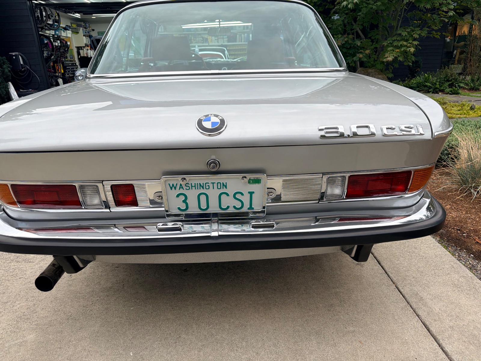

Put in new distributor, a bit of faffing about trying to see the timing mark past all of the heater hoses. Boroscope to the rescue but getting the strobe to flash down there likewise hard. But done now!
And the car got its new license plate, so it’s official. The DOT let me use my personalized 1972 style plate to register it as a collector vehicle so no more yearly registration fee! And this is now a real registered plate.
